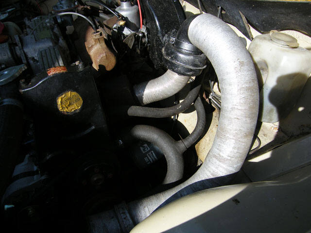

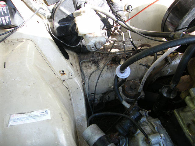

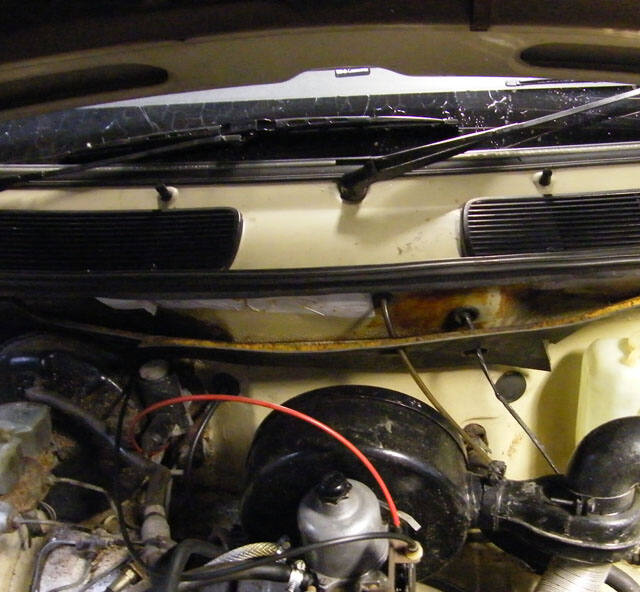

I've been wanting an excuse to get cracking with the engine bay so that I can see how bad it really is, the muck in there hides a fair amount of paint bodgery I'm not best thrilled about. Much of the area between the engine and bulkhead looks like this.
This ducting for the air filter has been sprayed silver, I'm not sure why, and was done in situ judging by the silver overspray all around it. Annoying, as it gives me more work to rectify it properly, but perhaps I can get a better looking section of pipe to replace it?
I want to replace the ducting with something new eventually, but for now I moved it out of the way, disconnected and removed the washer bottle to clean it inside and out and got the metalwork somewhat better looking than before. The washer bottle is actually pretty clean inside with very minimal discolouration to the plastic, but the outside has some very well ingrained dirt that I'm not sure of the best way to remove without damaging the finish on the plastic.

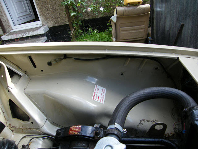

The wheel arch came up great, for all the paint is pretty shocking up close.
Some of the paint bodgery made me laugh despairingly. In this and other areas, new paint has been thickly applied by brush over the old, unprepared paint, minor rust blemishes and oil. Suffice to say, a fair amount of the top coat came off with soapy water revealing what is fairly good original paint beneath with the rust staining being just that, the actual rusty areas being very tiny little spots that I'll treat once everything is cleaned up.

It looks like your bonnet struts have been fitted upside down.
Try spinning them around the right way and see if that makes any difference. It might be an idea to do the same on the Polo too.
This had not occurred to me, I didn't realise that struts had a right way up. I shall give it a try at some point.

First thing I did was turn the bonnet rams around after being convinced they were upside down. This now means the bonnet shuts with much less resistance than before, this is not an improvement.

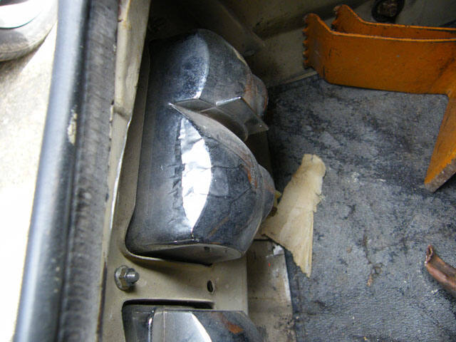

My Dad is, as I've said before, a bit of an electrical wizard as far as I'm concerned. He helped me understand how to read what the wiring was doing and we discovered the cause of the fault in the lights, though it wasn't what either of us had suspected at all. After checking the connectors and the rear light clusters themselves, it turns out the bulb holder parts are conductive while the plugs maintain earth, the bulbs are all fine and the fault wasn't making itself known. We checked and checked again, Dad consulting the rather large wiring diagram for the rear lights while I tried very hard to learn something. After we found the problem was somewhere in the left hand brake light we tried plugging the left hand stuff into the right hand side.
This eliminated the connectors and the right hand cluster as being at fault, it was definitely something about that left hand cluster, but we couldn't see what. The only obvious damage at first was the slightly lifting of the conductive coating.
In puzzlement, Dad removed the light cluster and the lenses to inspect it better, and that's when we found the problem that had, until that point, been invisible. It's likely I caused the problem when I checked the bulbs shortly after getting the car.
The conductive covering had been removed from the plastic base material which meant the brake light couldn't earth properly, causing the disco lights. Now, it had been mentioned that "there's a problem with the earth", but this is not what we expected it to be. This was repaired with the cunning use of Bacofoil and aluminium tape (the glue is non-conductive on the aluminium tape, so the foil was needed).
I also found out why I couldn't get the rear lights as clean as I wanted, the back of the lenses were filthy.
So they got cleaned up. When we plugged everything back together it all worked properly, with none of the previous craziness. Job jobbed! Last thing to do was put the rear lights back together and she's ready to hit the road again, with all the lights on and doing what they should. Success!
