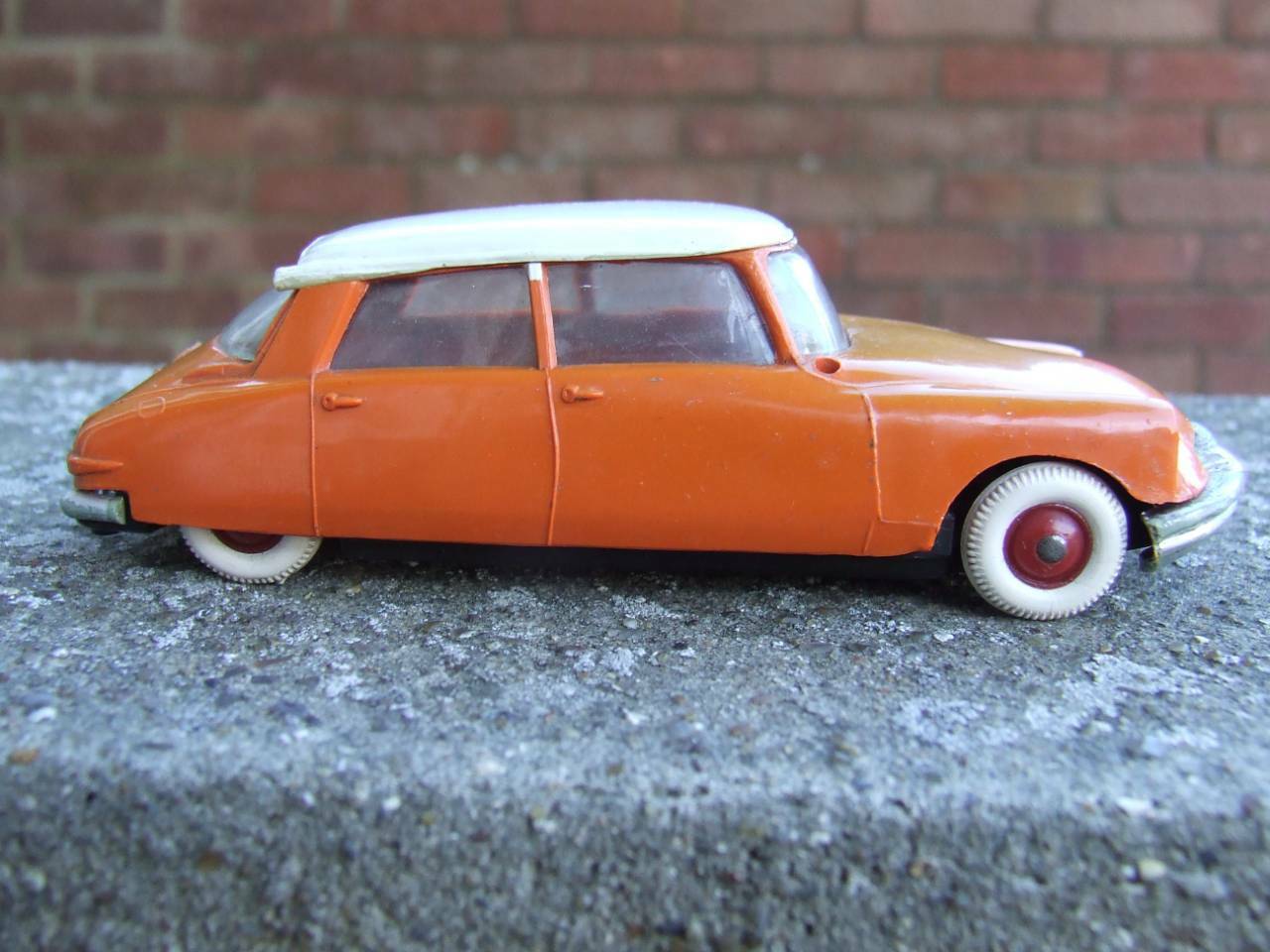

I also found out from that site they did a slot car DS!

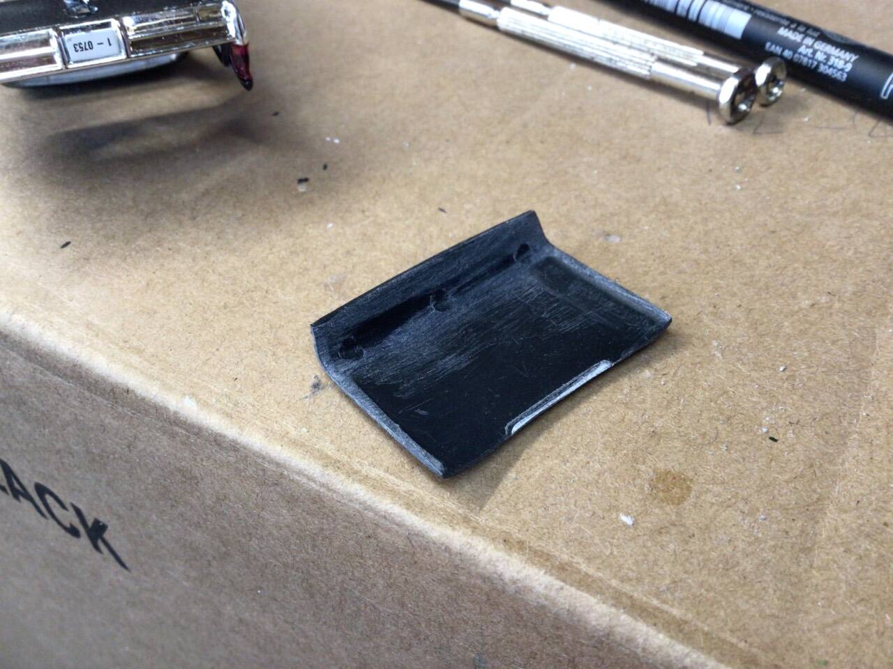

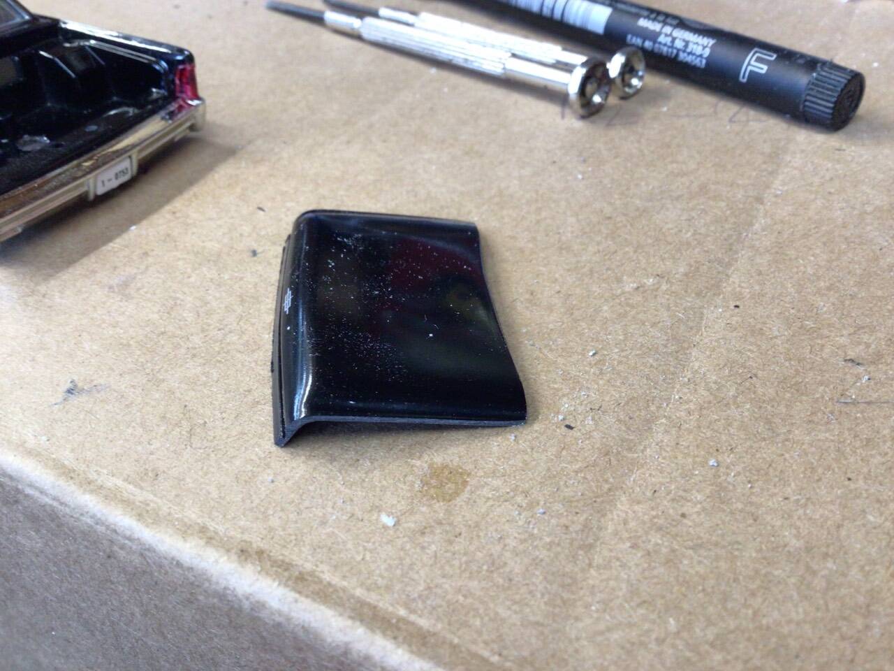

Just given it a wash off to get all the dust off, but I don’t think I’ll even bother repainting this one. Looks nice in black.
Although I might do the interior a different colour so it stands out a bit more. I’ve got a few of these as you can pick them up reasonably cheap and easy so now I know it works well I’ll do more, but in other colours. This should work on the silver Maserati in the same collection.

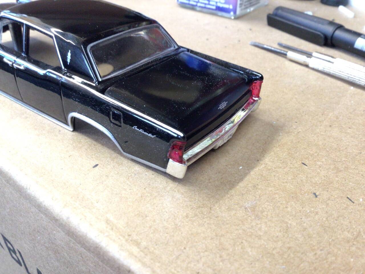

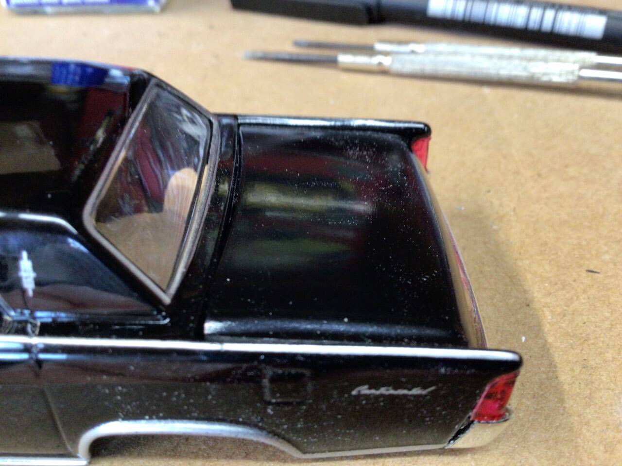

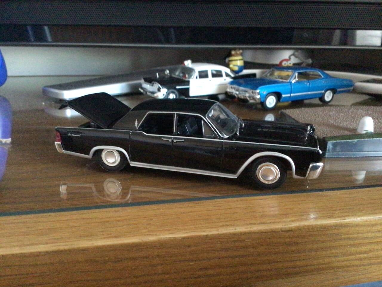

Nice work on the Lincoln. It does seem daft that they have modelled it with an open trunk, but I guess it is to do with the box art.
The car drives to the crusher with the trunk closed, also I think it is metallic blue, not black..
PS Keep the project coming.
Yep, they got the colour wrong with this one. As you say, it should be blue!
Some of the choices for cars in that partwork was a bit odd. There’s some (like the Anglia) that aren’t on screen for long at all yet got a feature in the partwork.
There’s a handful with body damage modelled on them too that needs repairing if your customising them - Sherpa van, Dodge Monaco, one of the Mustangs… etc etc. the open boot cars like this and the Maserati are a pain too.
Although I’m not complaining too much. It gives me something to do!

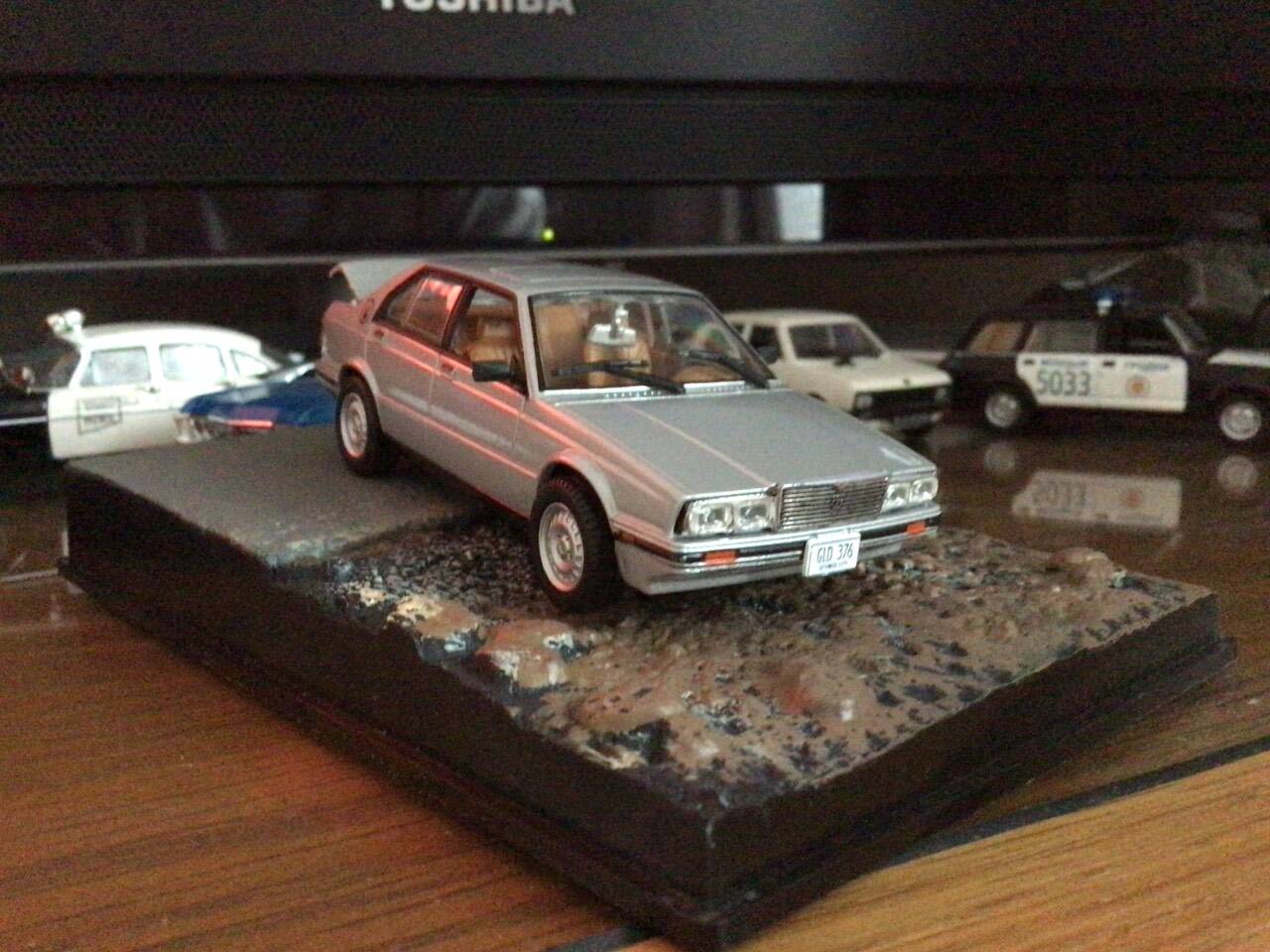

Heres the Maserati.
Not a bad looking model, but the boot lid open does spoil it a bit.
Not sure quite why they did that either, but look inside and you can see there was an attempt to model the armoury:
The scene:
The diorama is modelled around where/how they abandoned the car, although note they did not model the left-open front doors as well:

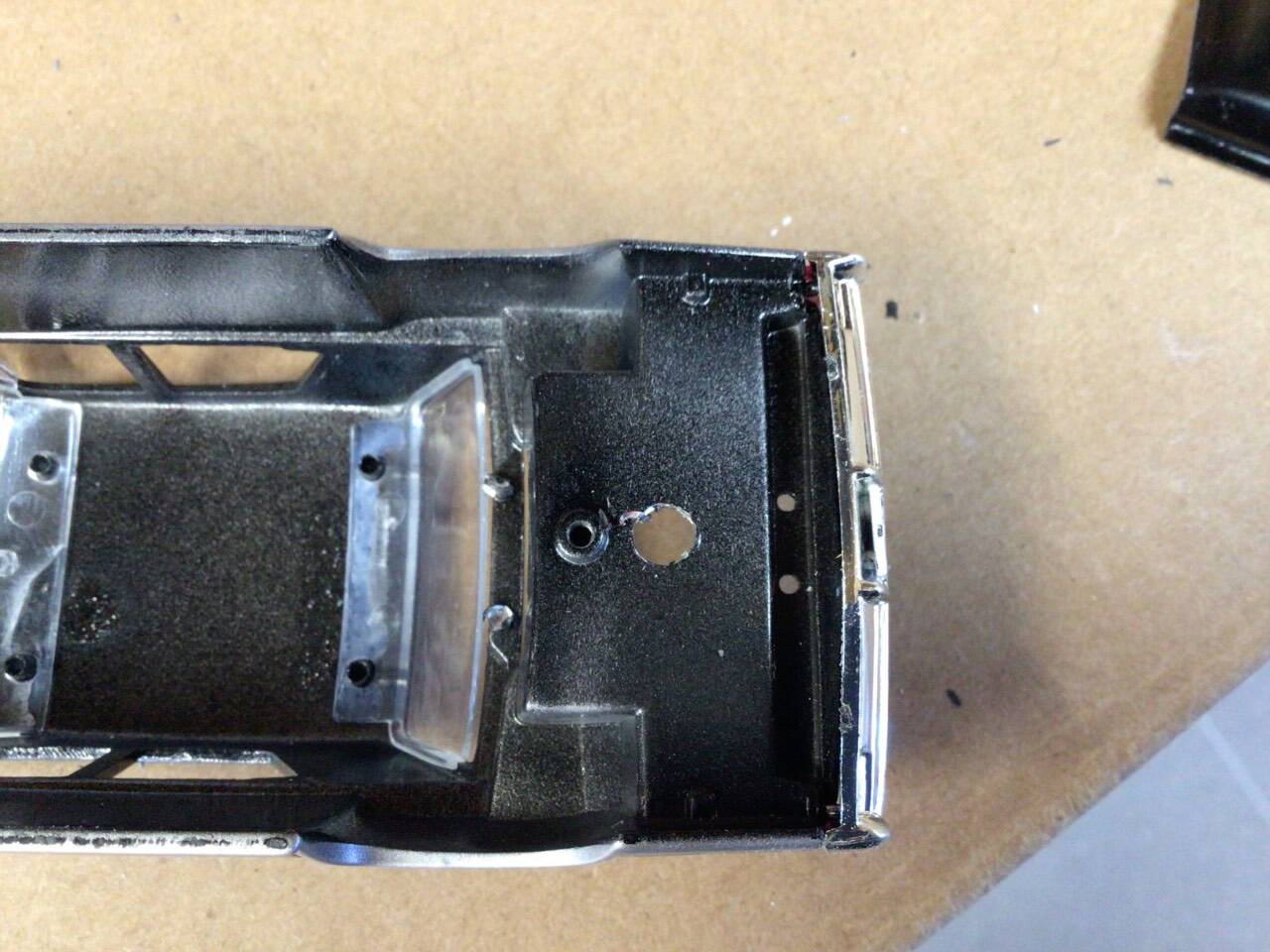

Not only that, the car driving was a '64.  The car being crushed was a '63 (minus engine & gearbox)
Apparently they had to cut down the cube significantly, as when they first put it into the bed of the Ford Ranchero, the suspension broke (unsurprising!) and they had to scrabble to get dealer parts to fix it, in order to film the second take and driveby scene
The trunk lid opening in the crusher scene wasn't what they intended to model I think.  Earlier-on in the film, there was this scene:
Check in the trunk of the model and you'll see the spare wheel and the flight case.

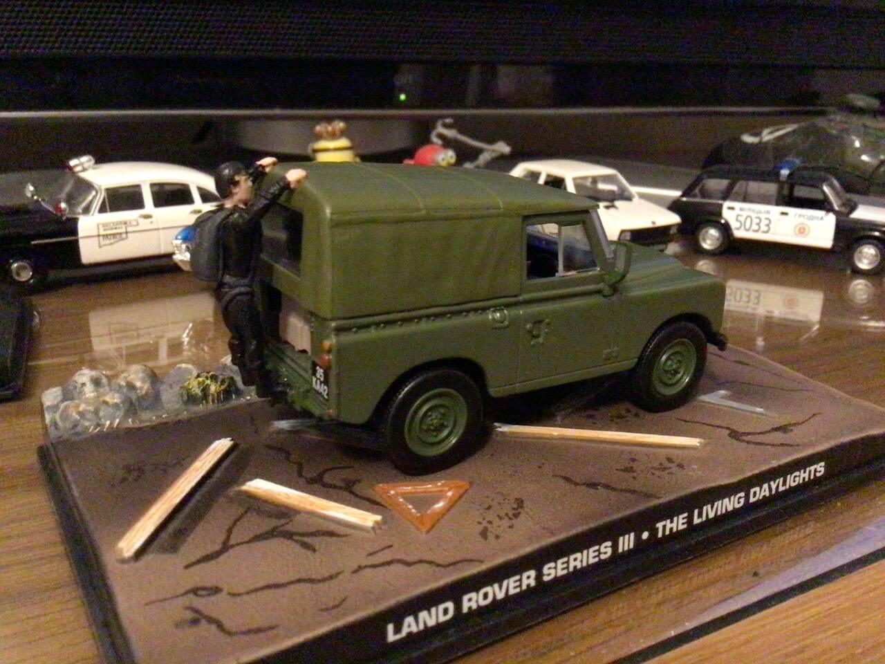

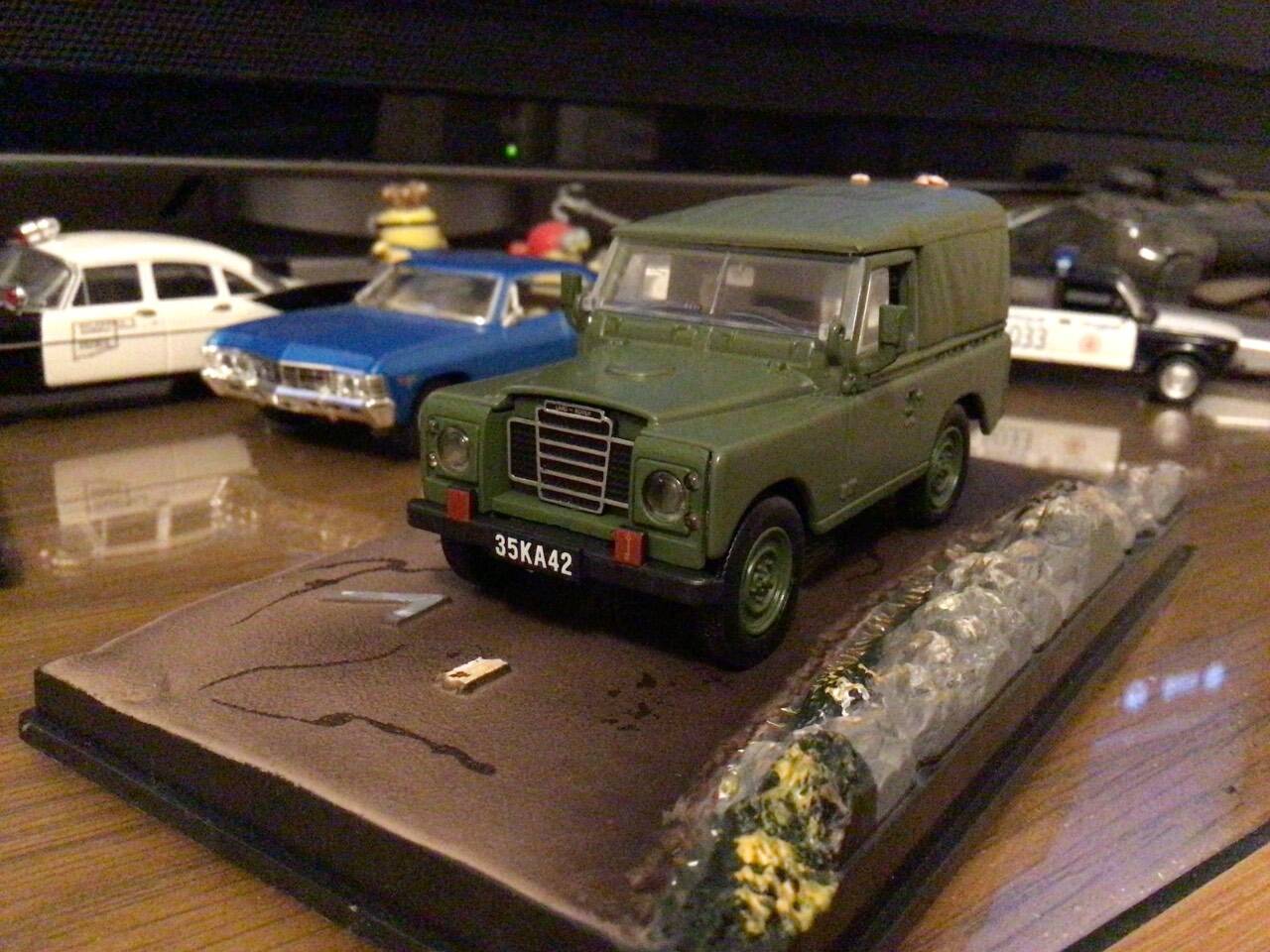

There’s this one too,
Jim hanging off the back and open tailgate aside, it’s not a bad looking Land Rover.

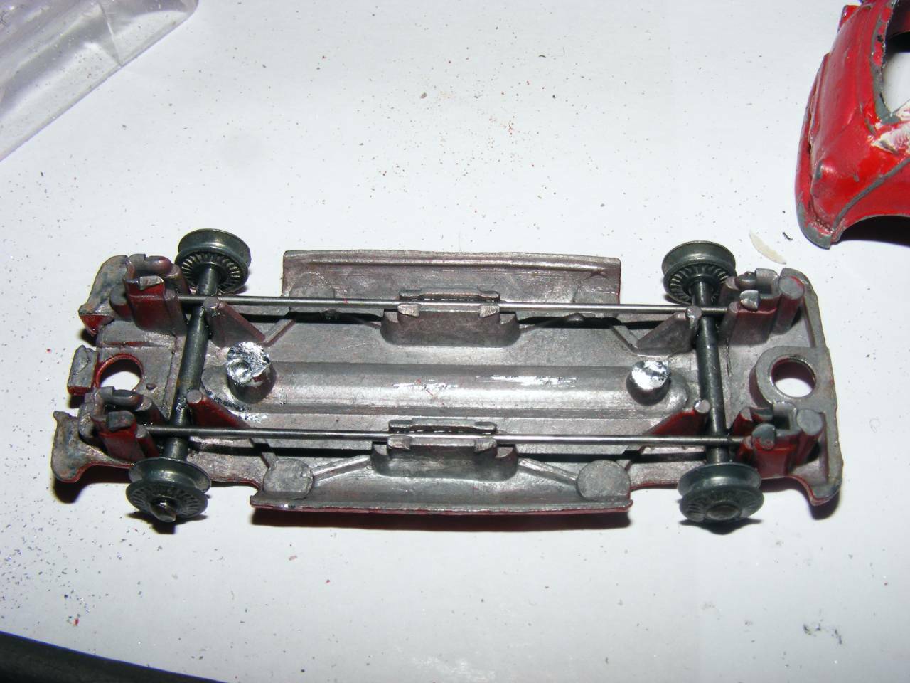

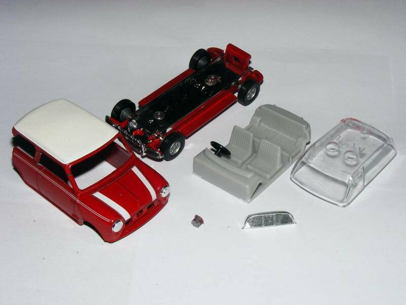

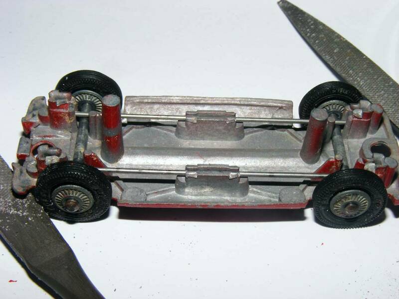

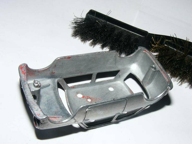

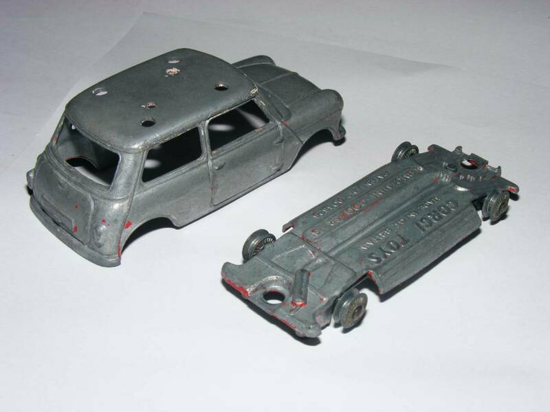

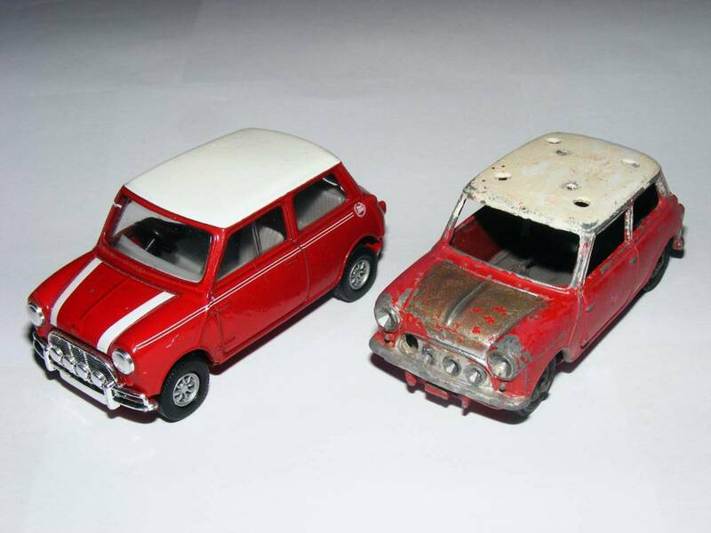

A new  project has been started. After getting the old Corgi Mini from @bunglebus  almost a year ago it is time to start fixing it up with parts from a damaged later Corgi.
Modern Corgi has a cracked screen pillar...
and a big chunk missing from the rear.
This era of modern Corgi must be made from the weakest of Mazak (or is it Zamak) as it took a slight pull on the chassis and the front rivet mount fell off.
A quick push here, and a quick push there, and the parts needed where soon loose.
Bit of red paint on the windows.

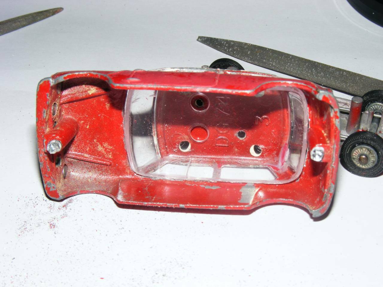

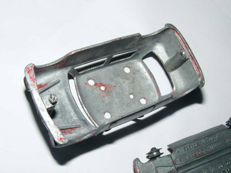

The old Corgi needed the grinding tool to remove enough of the rivets to pull the base from the body. How the original windows and interior went missing I do not know as the rivets looked to be originals.
To get the windows from the modern Corgi to fit some material was ground and filed from the base of the rear window opening...
and the corners of the new windows where filed off.
It is not a perfect fit, but when did 1960s Corgi windows fit snuggly all round?
To help it fit better I carefully filed some material from the front and rear pillars where there were mould seam lines.
The interior went straight in...
but the two large castings in the floor stopped the car going together.
So after some grinding and filing of both the casting lumps it would now fit back together.
I also took the grinder and the files to the grille as I am not restoring this into yet another rally Mini. It will be a model that Corgi did not release in the 1960s, but probably would have sold in the millions. I am doing a representation of an Austin Cooper road car.
That's the basics done...
with all the replacement parts test fitted.
Next thing is to strip the paint and make the shell good.
  • Like 12

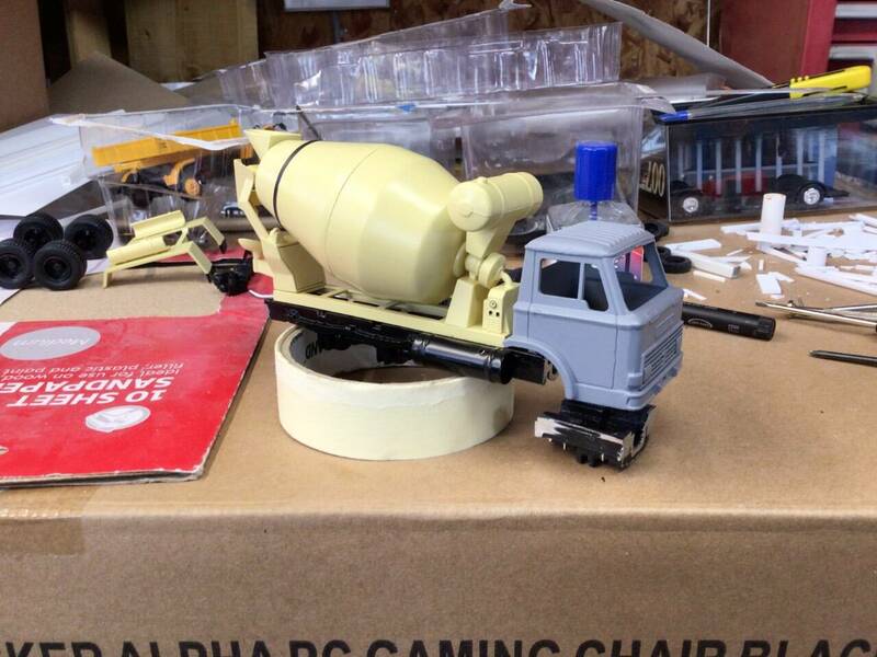

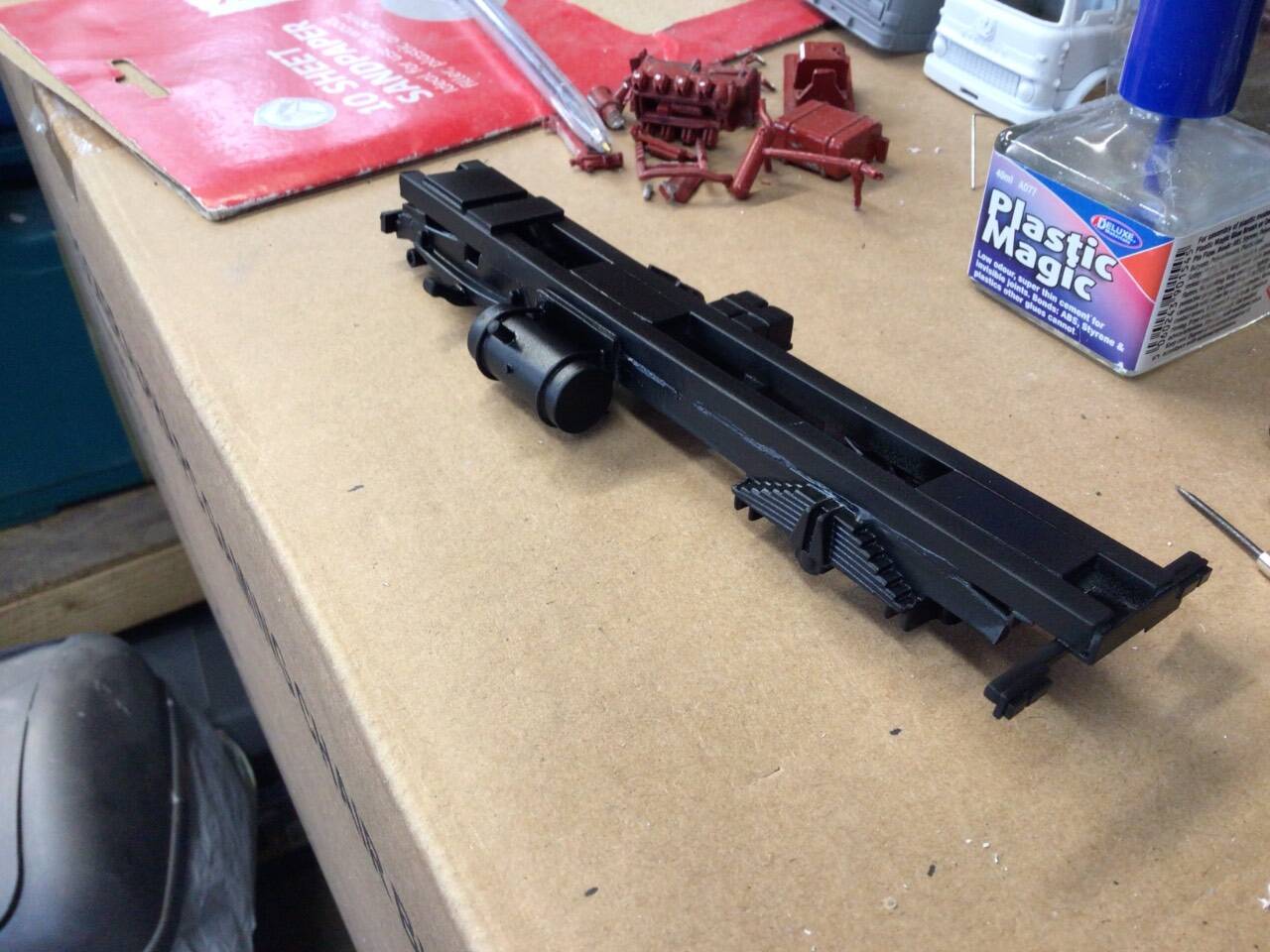

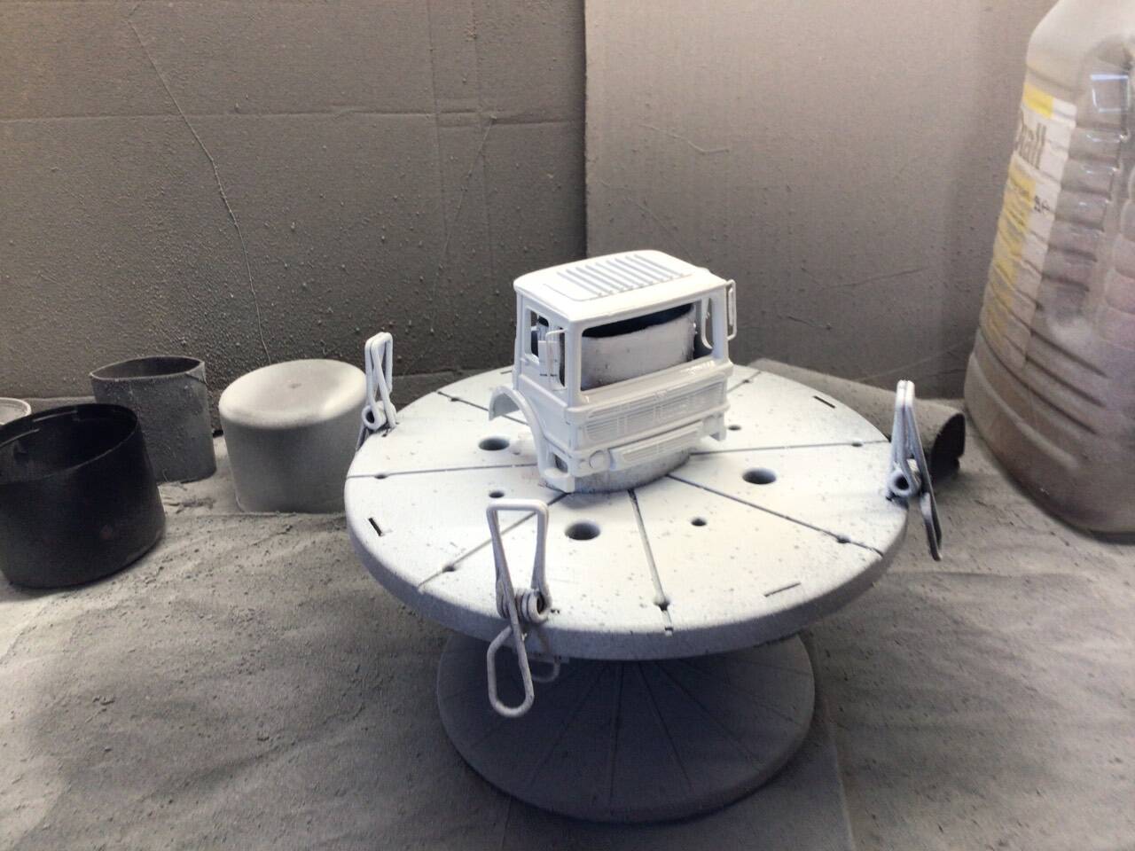

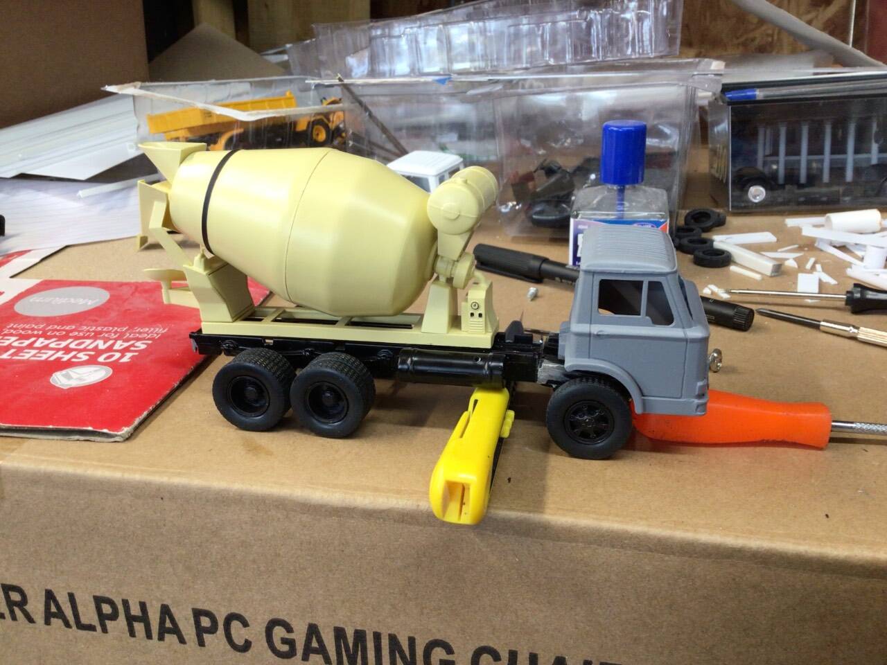

Then decided to start another truck project, having sorted the cab for it out.
A Ford D series cement mixer.
Basis for this being a Dinky D800 cab, with the front modified to improve the look, and a Spanish partwork Berliet cement mixer truck acquired fairly cheap off eBay.
The biggest problem here will be going from a conventional bonneted truck to a cab over style. You can see the massive length difference and position of the front axle.
I won’t lie, taking a saw to this was a bit nerve racking! But if you want these things you have to!
After lots of chopping and filing…
It’s had the chassis stripped down, the front chopped off, then a lump for under the cab chopped off and cut down, and the Berliet wing’s removed. It’s a bit too short as it is in the above pic so I’ve adjusted it and mocked it up to see how it can go together.
The knife and screwdriver are just holding everything at the right sort of height temporarily, but that better!
I’ll make something up the reattach the two halves of the chassis together again, and then make a small cabinet for the auxiliary engine that these often had to power the mixer barrel, which will go directly behind the cab.
Similar to this one (from Flickr)
Shit loads still to do on it but the horrible bit is done now!

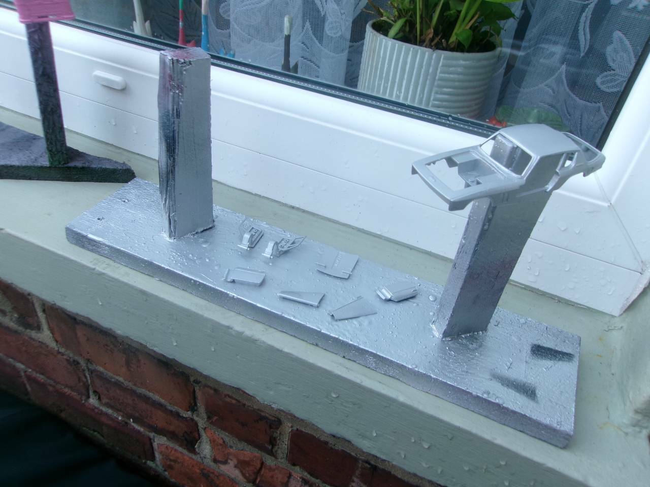

Here's what I got up to this morning...
100_0816.thumb.JPG.11f18e8fbb9f8e8592f86d7d40f18d71.JPG100_0817.thumb.JPG.312d6d2c5c24c894d06d43e33e422336.JPG
That was all for today because I had appointments from then on.  Weather permitting, there might be more tomorrow.

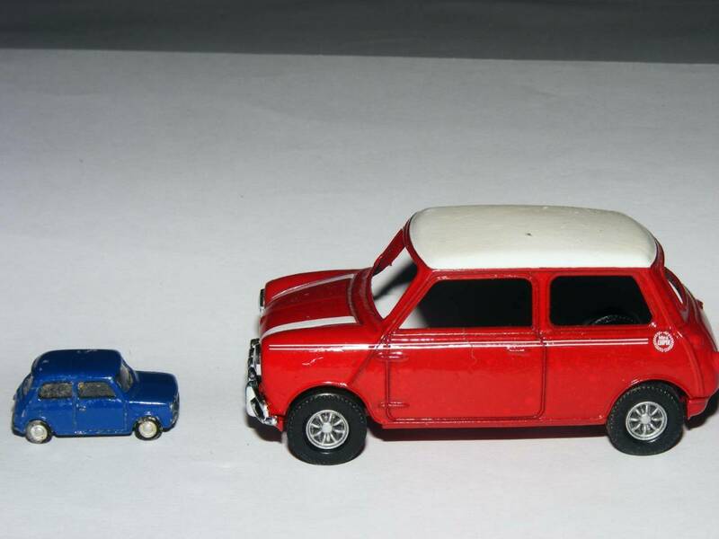

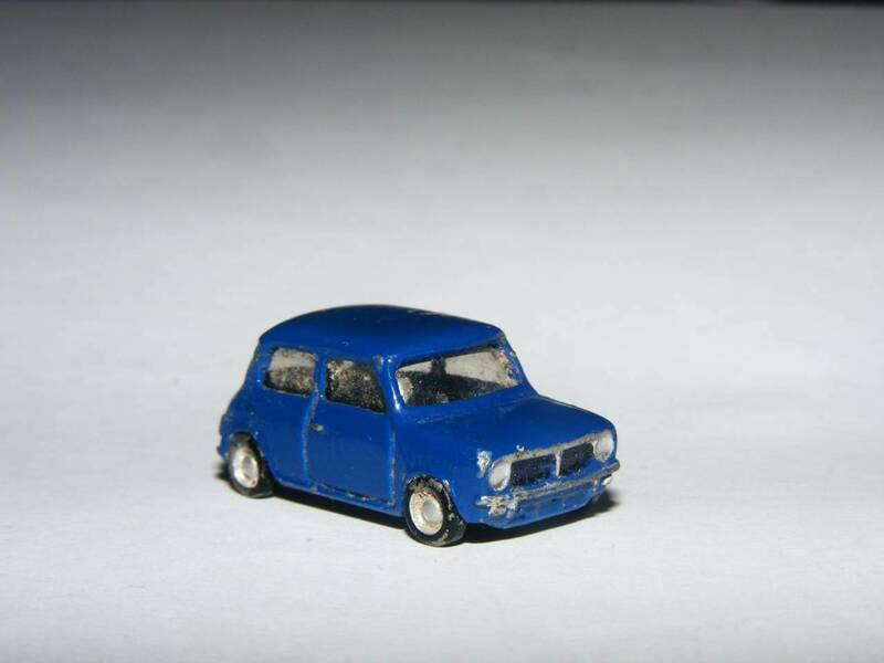

What's the smallest Mini?
Maybe this one.
Compared to a 1/43rd
It is only 26mm long.
So what's the scale. Using the overall dimension from an old BL sales brochure...
it works out at 1/122nd.

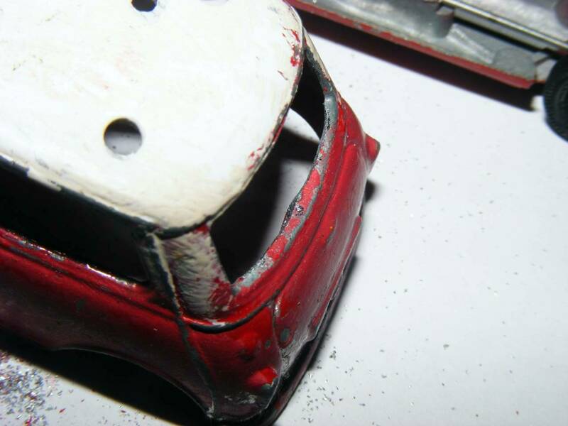

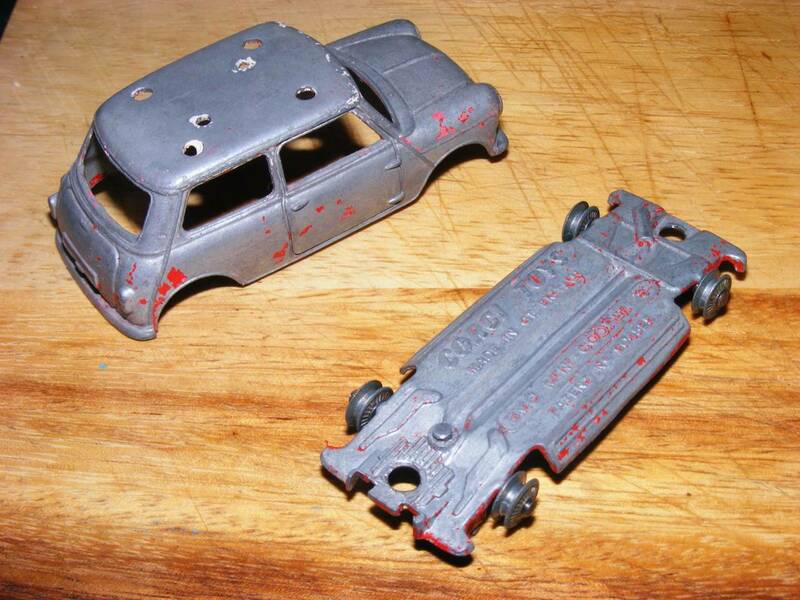

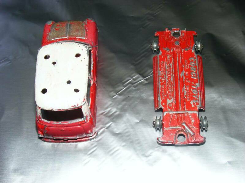

Progress on the project Mini.

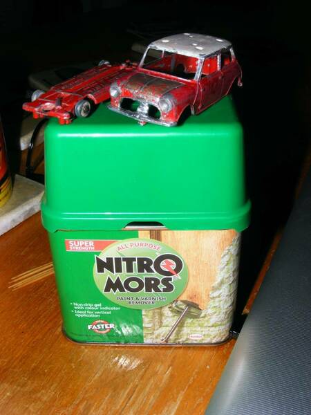

Lets get that paint off.
They don't want you to get into that Nitromors in a hurry.
Place parts on tin foil.
Paint on Nitromors.
Wrap up the foil  and leave to bake at room temperature for a couple of hours. The new Nitromors is not as good as the old stuff, hence the wrapping in foil. It also keeps the aliens away.
After a good baking the skin paint is now all crinkly.
The base seams to have resisted.
After a good stippling and wash with a paint brush there's still a few stubborn bits left.
So it's back to the foil for another bake.
Then a wash.
Then a final going over with some stiff brushes.
Next time it's time to sort the body out with filling the roof and deciding what to do about bumpers and headlamps. The Nitromors might not as good at getting the paint off, but it had now trouble destroying the plastic headlamp jewel sockets.
