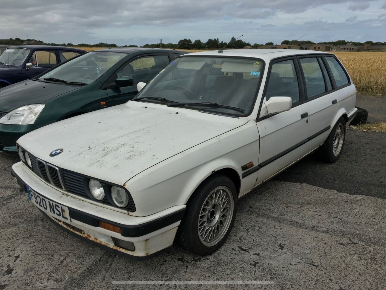

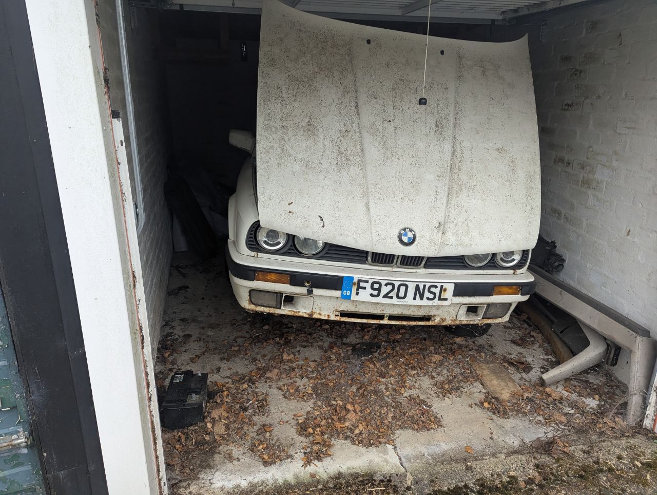

This is the eponymous 320touring.
A vehicle purchased by myself on Valentine's day 2005. A faithful beater that took my arse round Eastern Europe in 2006 and on countless trips thereafter.
Since 2017 it has languished in a lockup.
Ostensibly awaiting simple rectification work to resolve a steering issue.

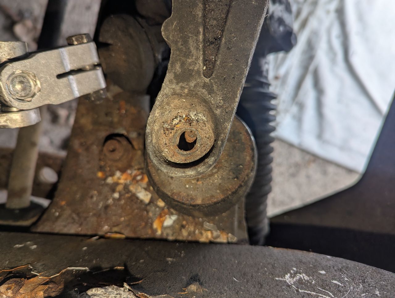

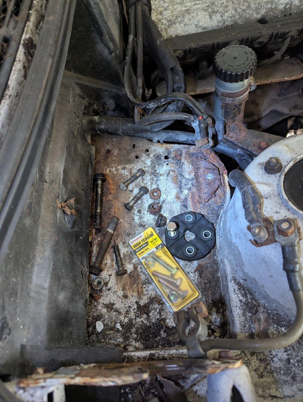

The issue was a failed rubber coupling in the link from the column to the rack. The replacement donut and various bolts can be seen here.

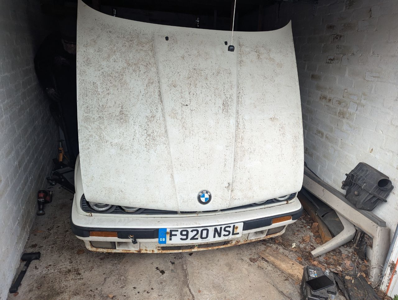

First up, remove some of the detritus

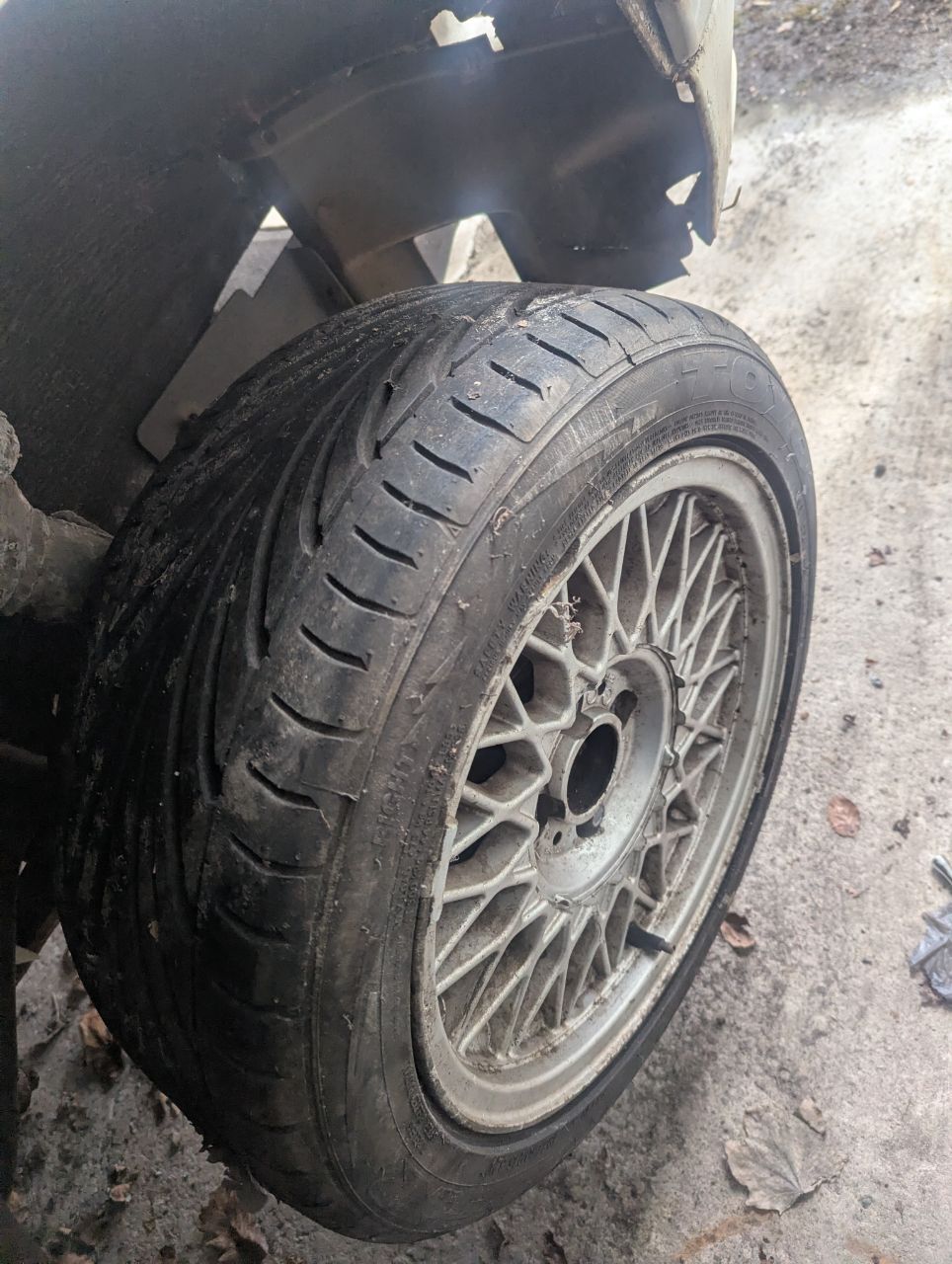

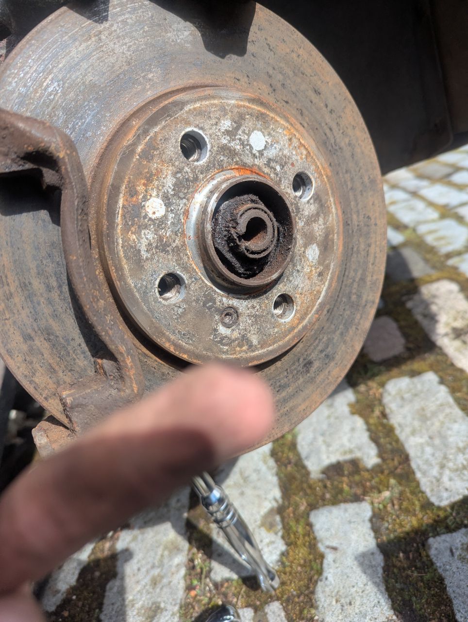

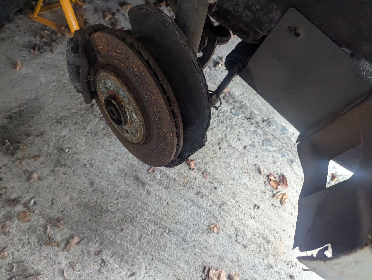

Had a look over the car - front drivers wheel was stuck - brake disc rusted so wouldn't turn

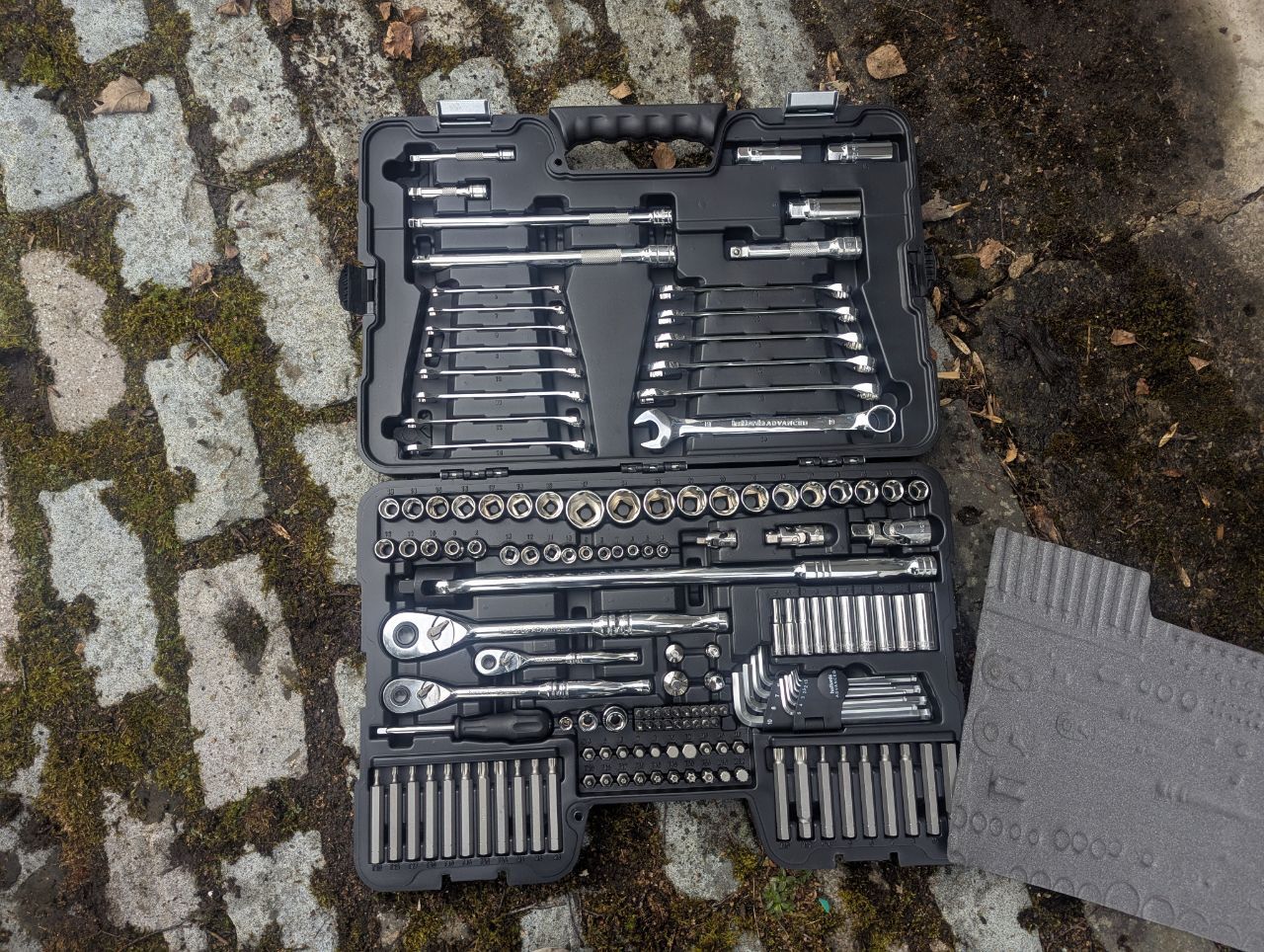

A wire wheel was applied, then the new toolkit was opened
We popped the wheel on and had it spinning quickly.

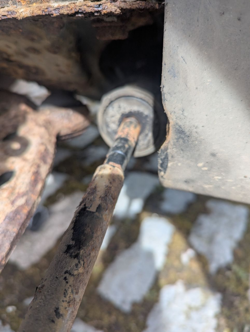

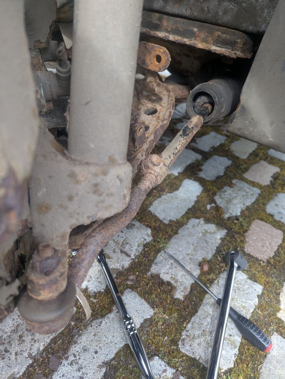

Next up was the steering coupling. Simple in design, but somewhat of a faff in actuality.
Firstly, behold the gap

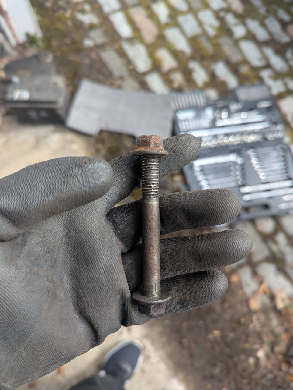

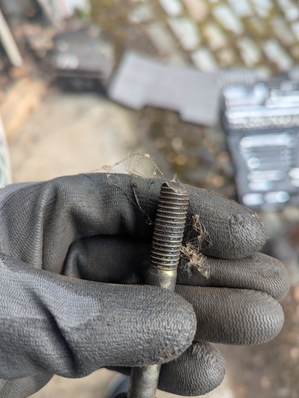

Marvel* at the condition of the rack retaining bolts..
A bit of time with a file got the bolts and nuts to function, but I'll order new ones up - as these are not great.
Lining everything up was a pain until we remembered that there was a trick to it.
1. Fit knuckle to rack end.
2. Fit passenger side rack retaining bolt
3. Pivot the rack, and for the top end of the coupling - drifting it into place with a hammer.
4. Tighten up the 2x 15mm rack bolts and the 2x 13mm knuckle bolts.
We didn't do them up too tight incase they need to come out.
So that was the original issue resolved!

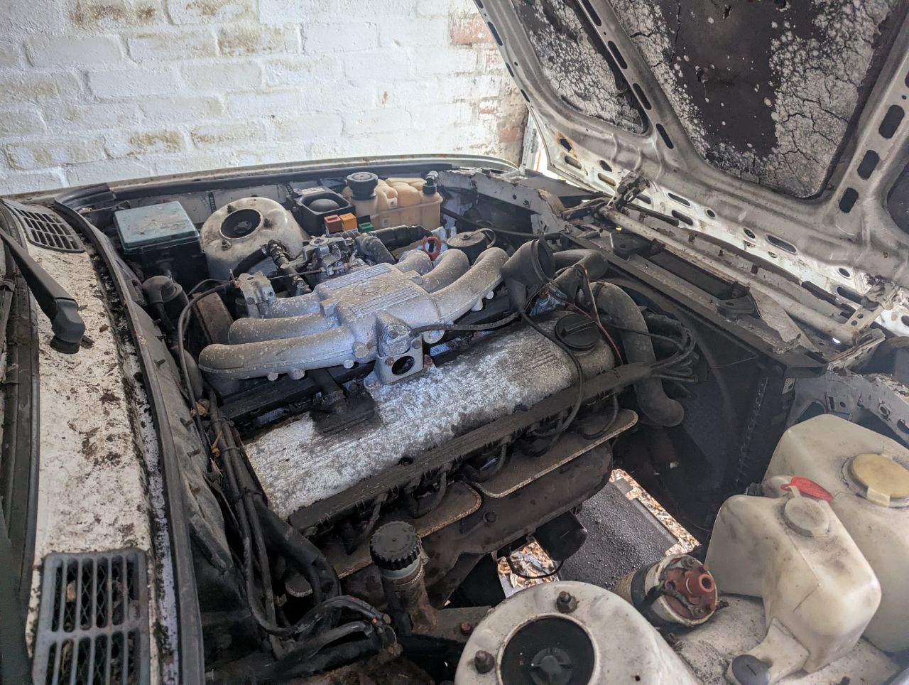

Next up was to re mount the engine - to get the rack out you need to take the drivers engine mount off, and loosen the passenger one to let the engine rise up so the rack can be slid out.
Some jacking and a gentle shove got the mount to seat on the runner and it was lowered back down.
Then the car itself sat on 4 wheels for the first time in 9 years..
Having achieved everything that I'd hoped, @jaypee and I decided to keep going.

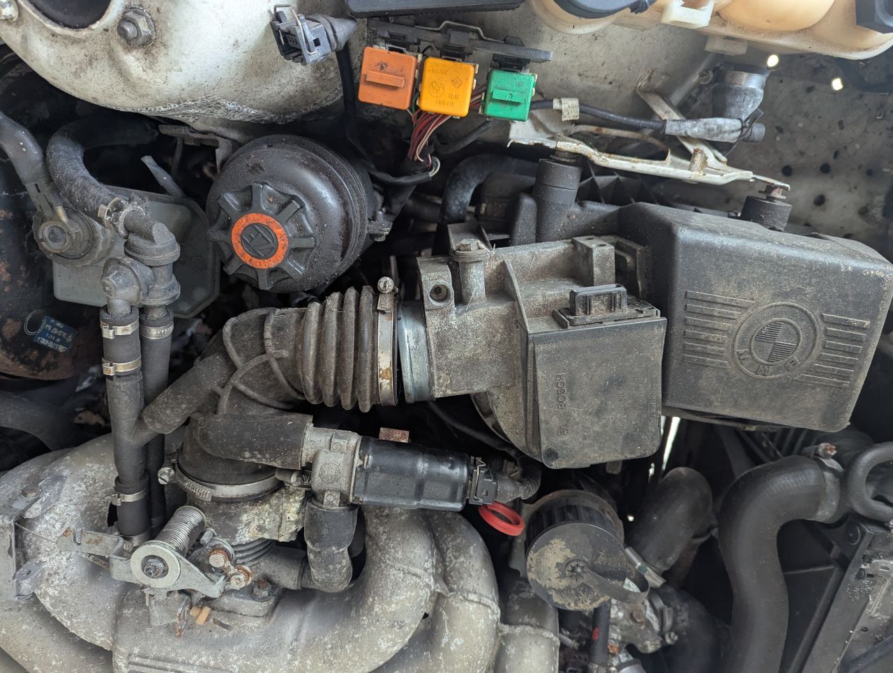

Step 1. Apply the Air Flow Meter and get it mounted and connect to the loom.
Step 2. Wind the engine over with the king lead disconnected to build some oil pressure.
Step 3. Attach king lead and ready the starter tapper
That's it running on 9 years old fuel, didn't even pull a spark plug to check. Running on all 6.

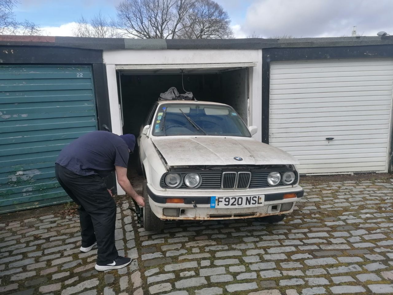

Having ordered a tranche of brake and suspension bits, it was over to the 320 today for some investigation with @jaypee.
To work on it we needed to pull it forward, as the big Halfords jack we have is too big to be used in the garage.
Assuming the position

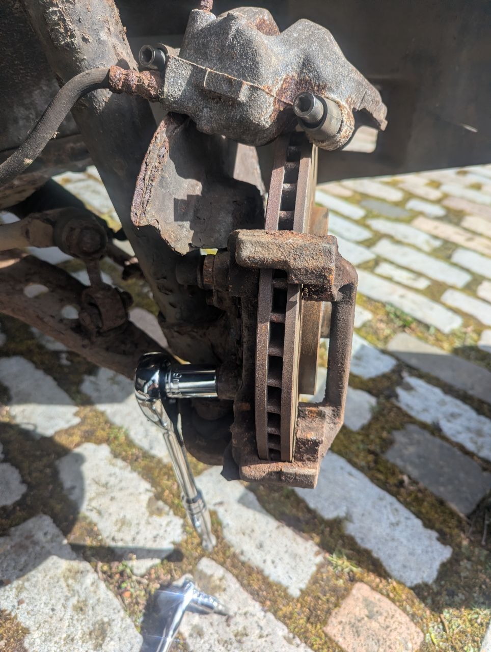

Wheel off and time for a look. Key things we are checking - brakes/arb drop links/track rod ends/bottom ball joints.
First up, brakes.

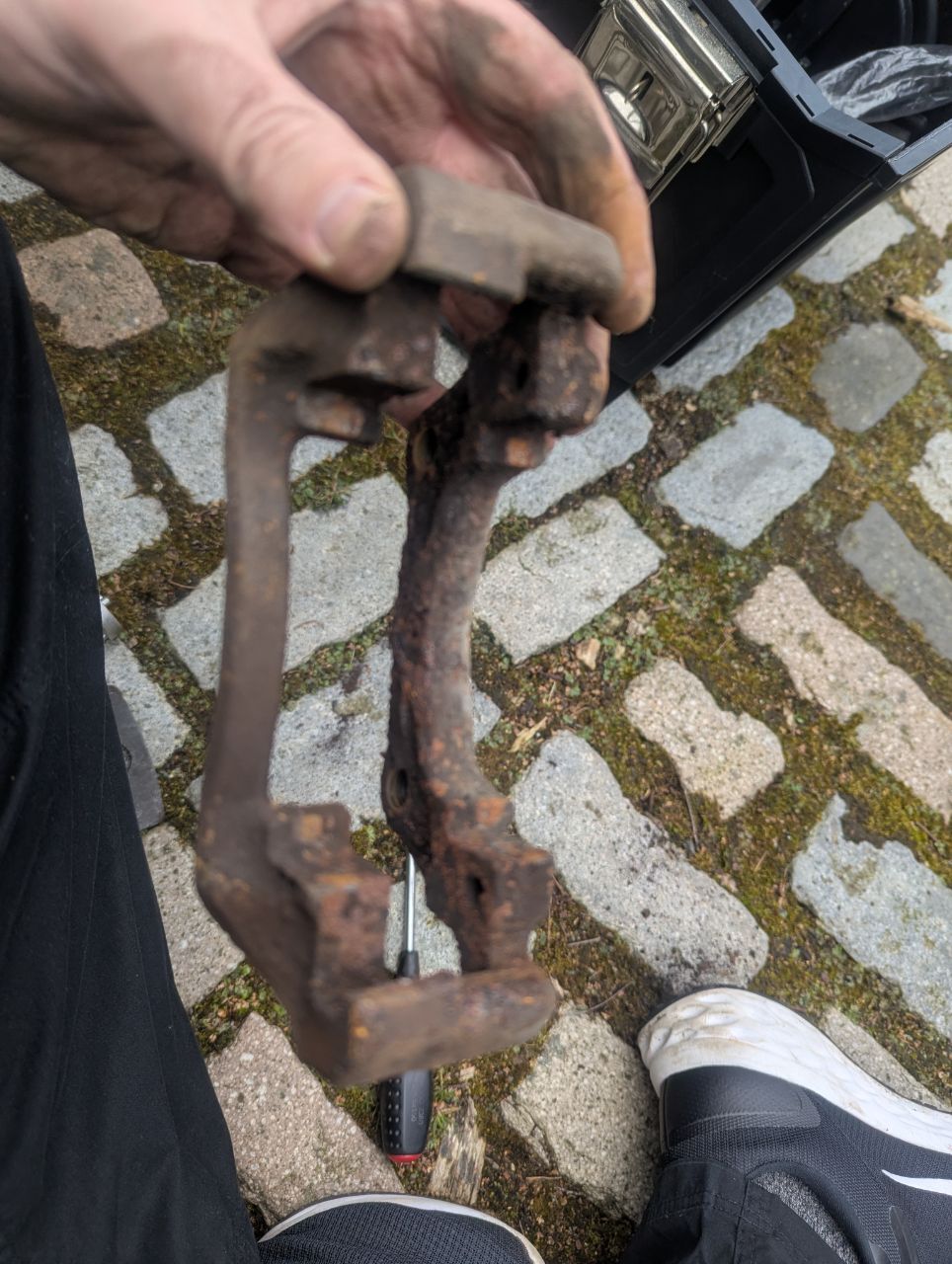

The caliper and carrier bracket came off fine (7mm hex for the caliper sliders, 19mm socket for the carrier bracket)
The piston on the caliper pushed back in fine, and the brake was operating cleanly.
The caliper carrier bracket cleaned up well, and was fitted back on.

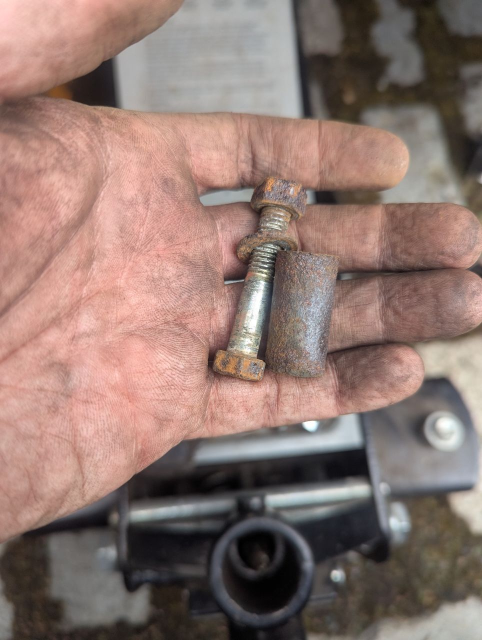

This disc retaining screw however. Absolute bastard of a thing. It'll need drilled out.
However, the good news is that the disc seems pretty much new barring surface rust, so not urgently needing changed.
I do have discs and pads on the way though.

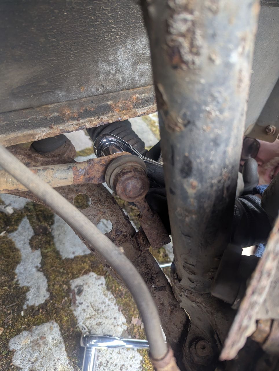

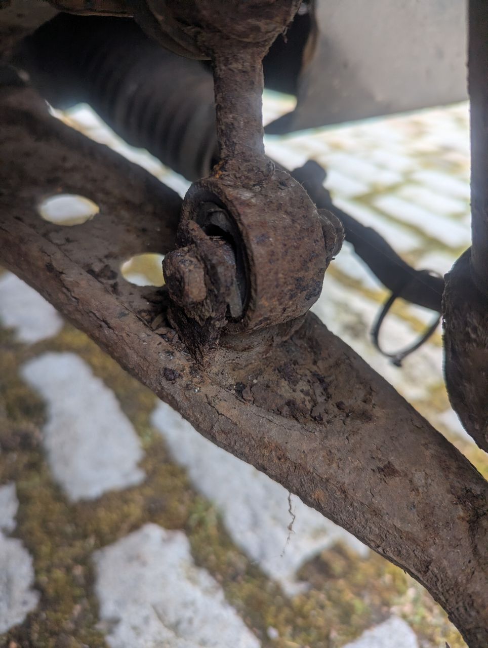

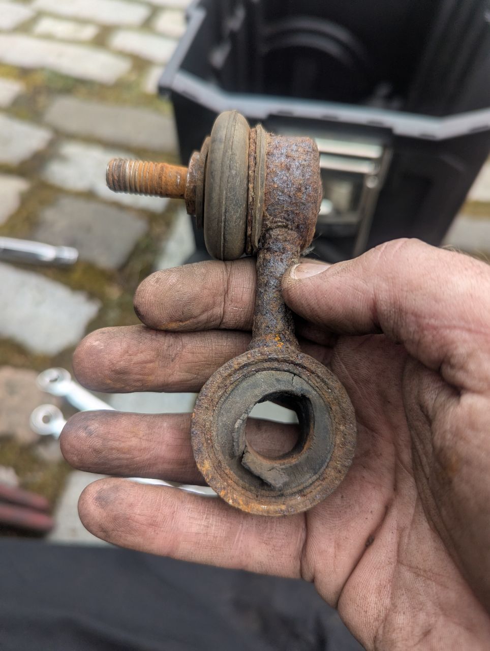

Then it was onto the arb drop link
Not looking too clever. 13mm nut and bolt holding it in, which, despite appearances, came undone ok.
The top 17mm nut was removed too.
I'm gunna say this is goosed

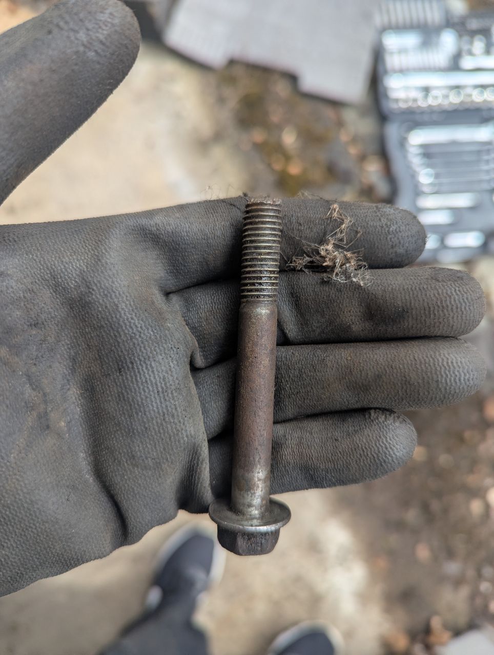

However, the arb drop like was problematic. The 17mm nut starting to round off and the 13mm one actually appeared to be A 10mm bolt.. this will be addressed another day.

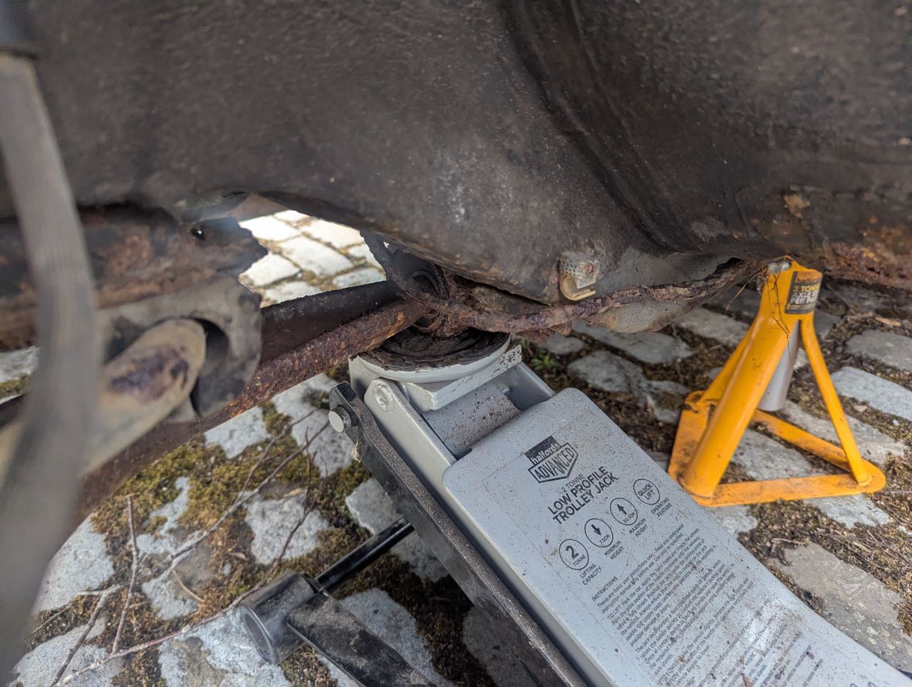

First up, the fuel return line - below the white clip in centre of the picture.

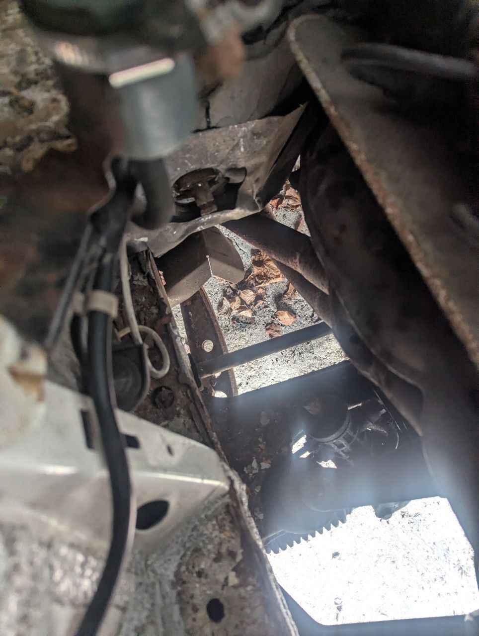

Quite how this is not pissing fuel absolutely everywhere is a mystery to me. I'm going to have to either make one up or see if I can source one (and likely the feed line too) from a supplier.

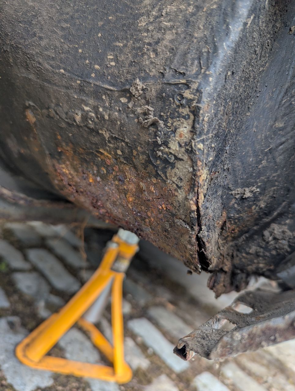

Additional joy was to be found at the base of the foot well..
Aye that will need the sparkly stick...
