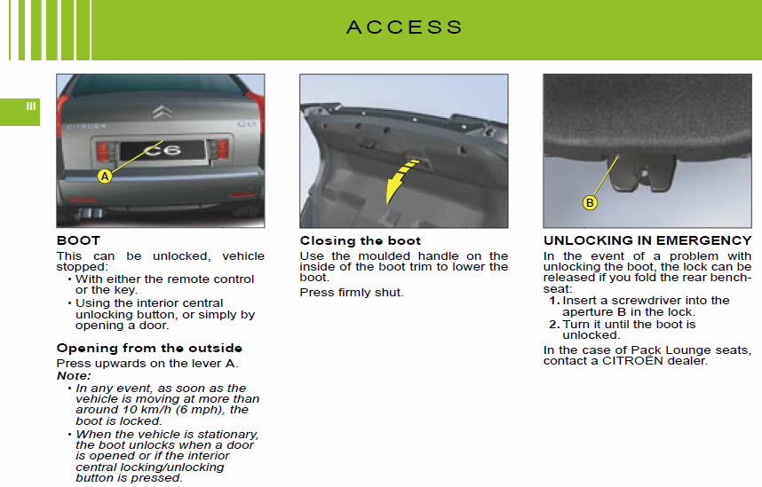

Indeed... found this on the C6 owners forum.  I will go and try that, however as the car is 100% dead, I will need to drop the rear seats, empty the boot and then crawl in with a long poky screwdriver.  It's currently pissing down with rain and the car next to it is about 3mm away, meaning access is poor to say the least.  With the handbrake solidly on and the car in park, I doubt I am going to be able to move it to get space.

I can confirm this works. Have done it myself. Also works on C4...
However, if you have the Lounge Pack, it becomes very difficult to access. You may need to remove seats.
Be very careful closing doors when window drop does not work, tends to break the glass.
There is a mechanical release for the handbrake too, in the centre armrest - pull the rubber liner out.

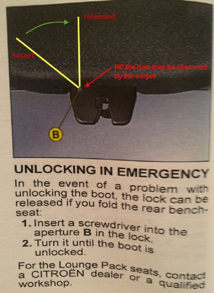

As you have the folding seats, the emergency opening boot method is quite easy.  Put a thick cloth over the latch when you've opened it, to save you having to do it again  two minutes later.
That is very useful (and wise... not your first rodeo?) advice.  I may be able to get to my work laptop at the very least now..

If you are able to fold the back seats - IE not the lounge pack or electric ones, this is how to open the boot catch:
1350302325_786_FT11874_worzel_boot_release-33_.jpg.796b33da1dda13fb0dd25fa8bf3935e9.jpg
