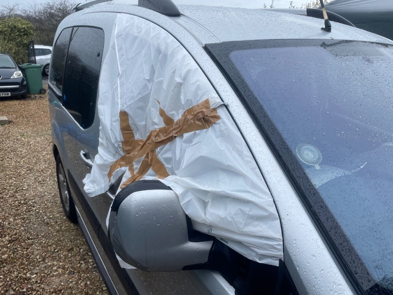

I went out to it today with half an idea of doing the barrel. Even if to just see if it is that. Tried starting it and this is what I’m presented with:
Tried the cabin switches again and the fucking window works going down and it refused to stop. It’s currently down, and it started to rain. So I did the only thing I knew how and placed most of this hateful thing in to a bin bag.
Stormed back inside anyway and started drafting an email. But looking at the responses it’s very clear (and I know not binding) “this is it now we’re done” with that car. So I can draft and send this email as per the ever helpful @rusty_vw_man (and I do appreciate the advice), but I do feel on a hiding to nothing.
Plus as my ever helpful wife pointed out, not fully knowing what’s been done (which I suppose puts her like the seller) “why aren’t you taking it back to the garage who fixed it?”. She said all these bits that don’t work have worked before they got it. She has a point tbh. Plus I would need to get this thing to Chepstow (where I bought it, fuck it) near Newport which is 60 mile I think from me. Fine happy days if they fix it but I’m having to fuck around getting back at distance. I won’t be doing this distance buying from an dealer again for sure.
Then has the BCM/BSM/CJD/HIV whatever got soaked from the steam cleaning. Theres a sign saying don’t do it on a cover that’s fairly loose.

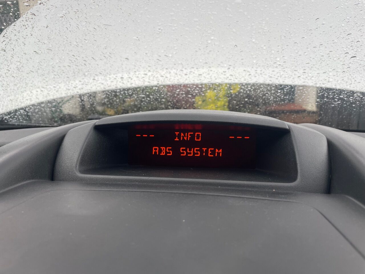

Question to the hive mind, regardless of emails, am I alright to drive the thing even with the ABS fault? As I’m inclined to drive it to them but don’t particularly want to risk it given the error. It’d be a 13 mile trip one way basically but country/A roads.

Is it actually an ABS fault or a faulty warning?
We had the latter with our Roomster which turned out to be wires chewed by mice.
No idea, it’s just turned up like that since I parked it up.
It brakes fine, well it did the last time I drove it. And I noticed it more than usual as the brakes are really really good and sharp. Compared to the Subaru. Somehow.

Assuming it's wiring/sensors and not something like low brake fluid then it'll just be like driving an old school motor - you'll be able to lockup/skid as much as you want
I'd start by chucking a volt metre over the battery,  because French.
If its a decent voltage, disconnect it and leave it while you have a quick brew, before re connection have a little nosey if any is unplugged in the engine bay.
Then give the garage a shout and see what they say, just incase they have seen it before.
At the risk of muddying the waters even further - as said, voltmeter on battery, but what you really need to know is the voltage across the battery with engine running at say 1500 rpm with all the lights on.
