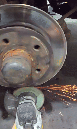

Despite the fact that it does stop quite well, the front brakes aren't looking the best 👀
This side was rubbing a bit. The wheel bearing was loose, but they're a taper so I nipped it up a bit and "reconditioned" the brake disk:
That's shut it up for now. I'll order some new stuff off Autodoc, at some point. The old calipers off my pickup are in much better condition, so I'll give them a spruce up and swap em over.
