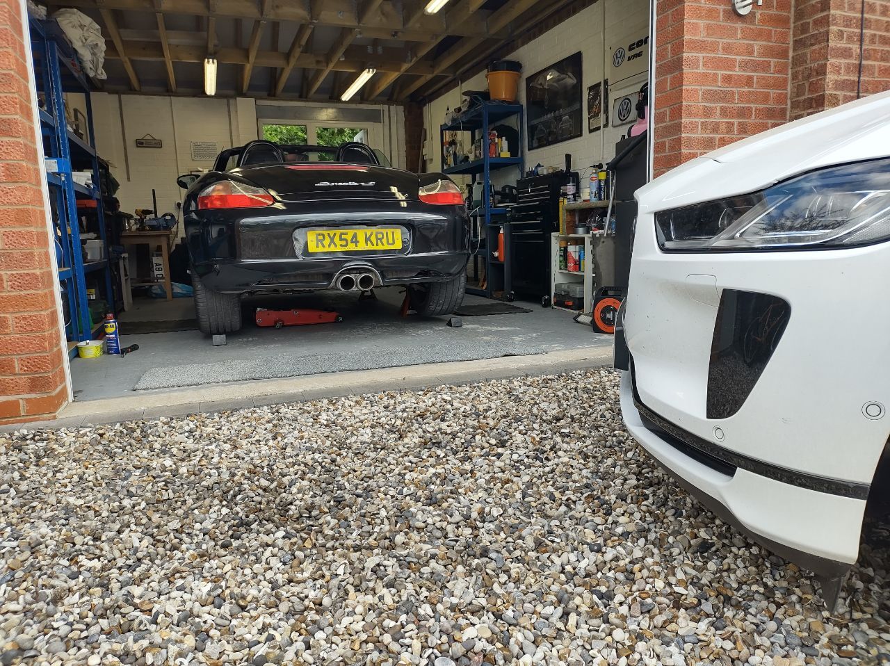

I spent some time this afternoon getting the Porsche lifted for front suspension/knocking noise investigation and the oil services I want to do. I took my time, getting it solid on the stands etc... Assume the position!:

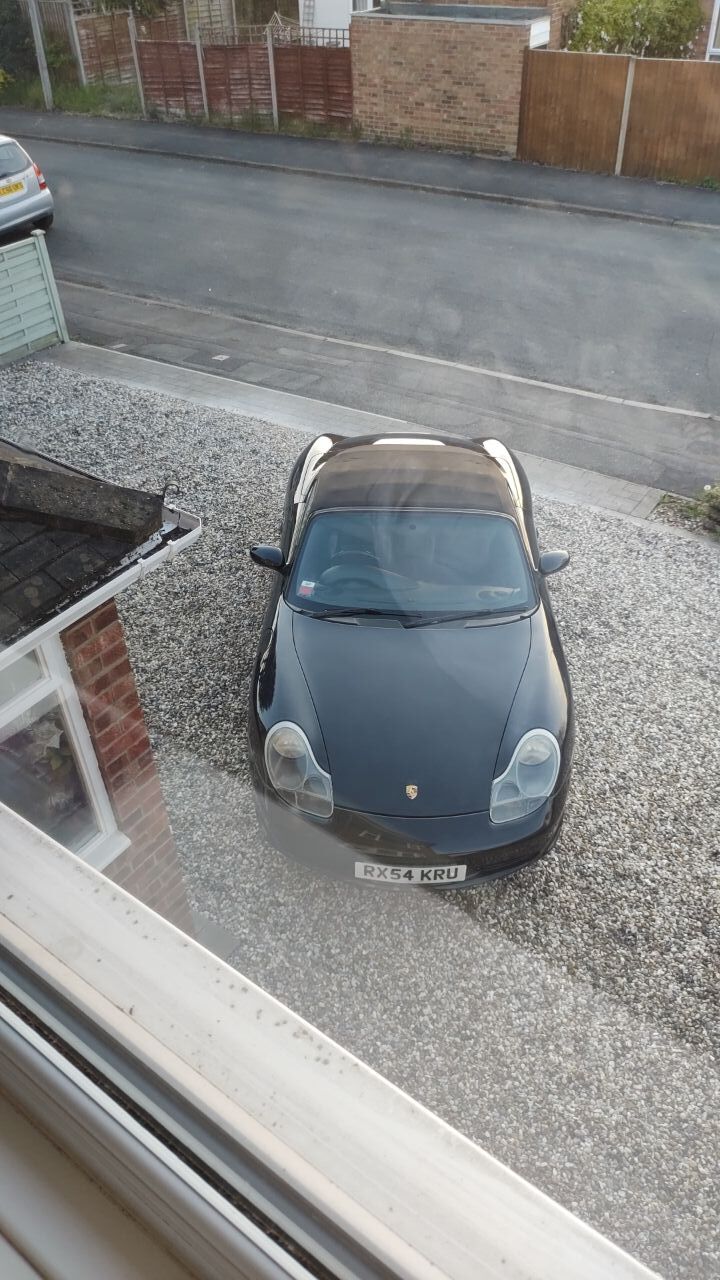

Have a terrible picture from an upstairs window to show it being back to Frontline duty...

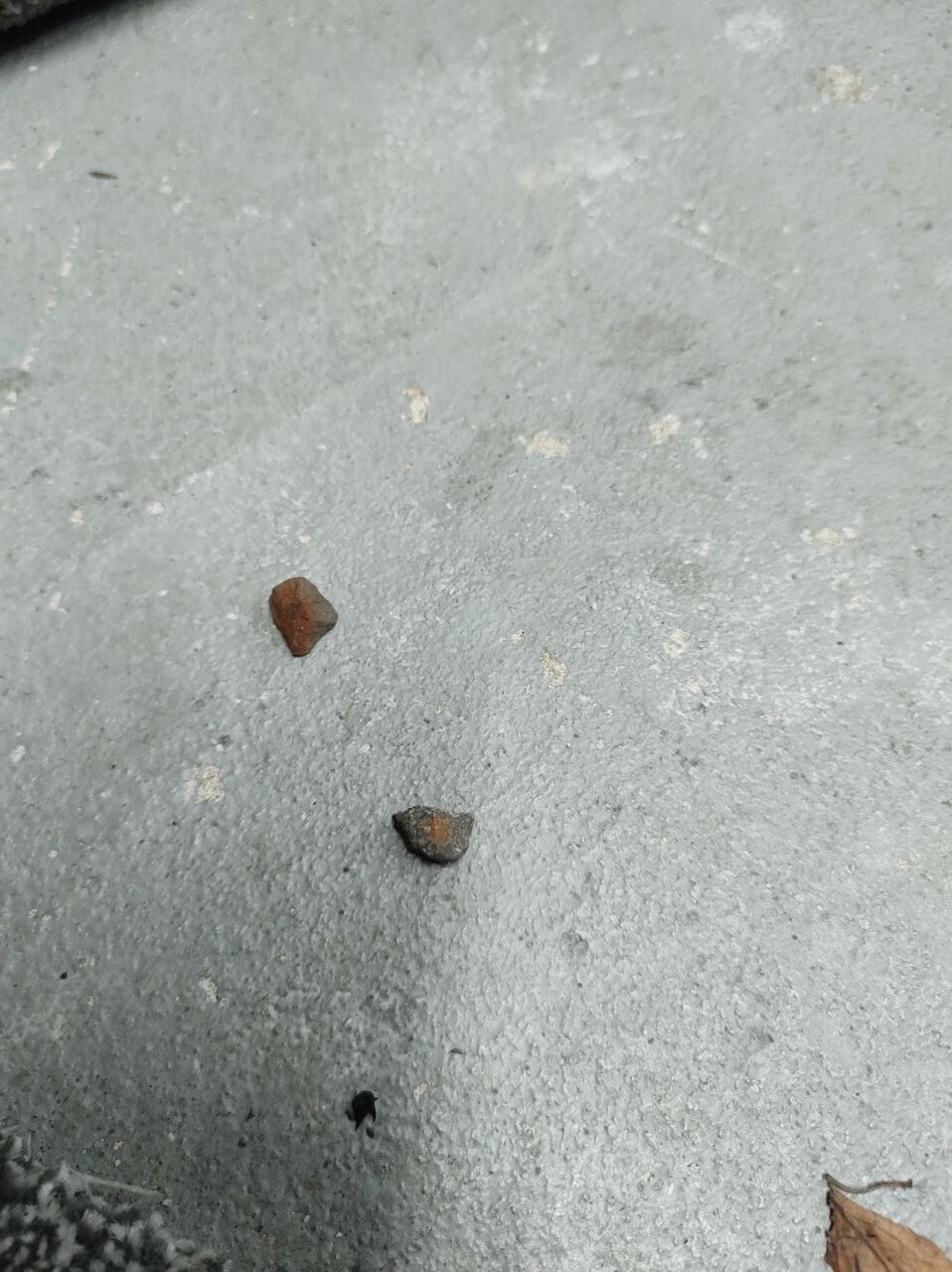

WELL....
After removing the passenger side strut today (thanks to Mrs C for the assist..) I randomly moved the anti roll bar to find the exact noise I have been experiencing all this time...!
What was it? Bushes looked fine, but on inspection, these two small stones were jammed against the bar:
Now it's completely silent... I'm 99.9% sure that this has been the problem all along...
I would normally cry at this kind of thing, but to be honest, I'm just relieved. Yes, I could've not gone to all the trouble, but given I've looked over it and shaken things for hours now, plus my mechanic had... Who knew!
