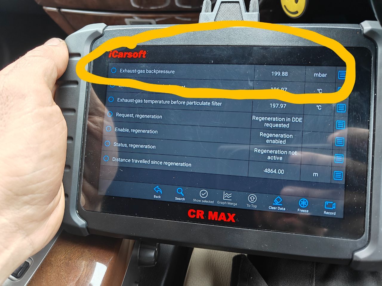

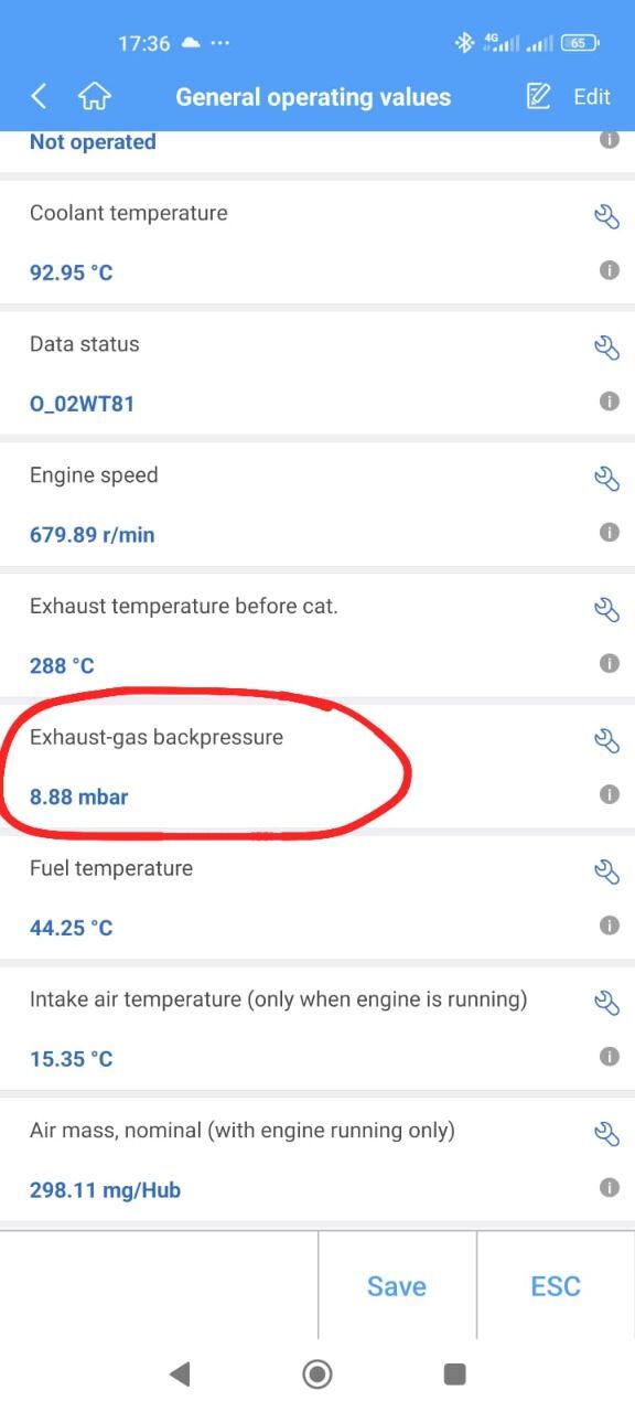

2 minutes ago, dome said:
I suspect this would take some cleaning, 200mb back pressure at idle compared to a healthy one (my old 530d in fact) which has 9mb😳

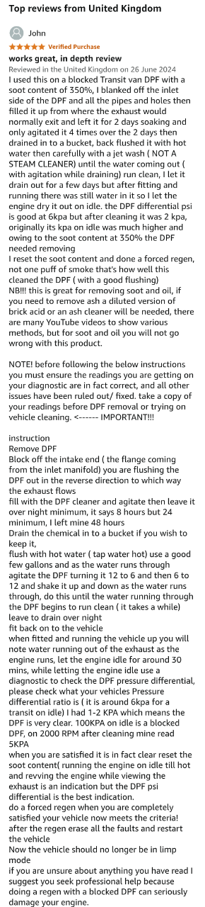

This chap in his review of that Wynn's off car dpf cleaner reckoned his vehicle was at 100kpa (1000mbar) back pressure
The other key thing is to fix the error codes (possibly thermostat too) so it can regen in the future.

I can't imagine professional DPF cleaning is that special a process nor that special chemicals. I wouldn't be surprised if that Wynn's fluid is probably pretty much the same as they use just being forced through to speed the process up and then baked so you don't get plumes of smoke when the customer drives off for the first time. They get cleaned all the time, especially on lorries where a DPF is much more expensive but also easier to access.

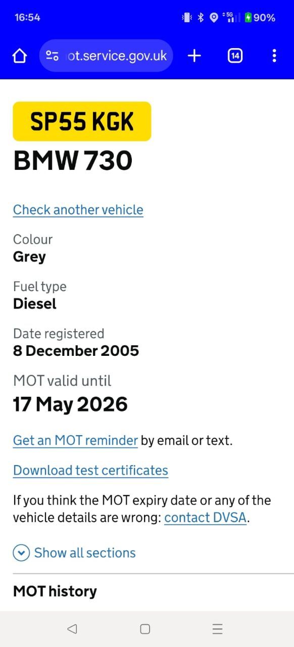

It was coming up on a month to go before it's MOT was up so I did zero prep and chucked it in.
The results...
Yep, I'll take that :) No issues with the emissions either.

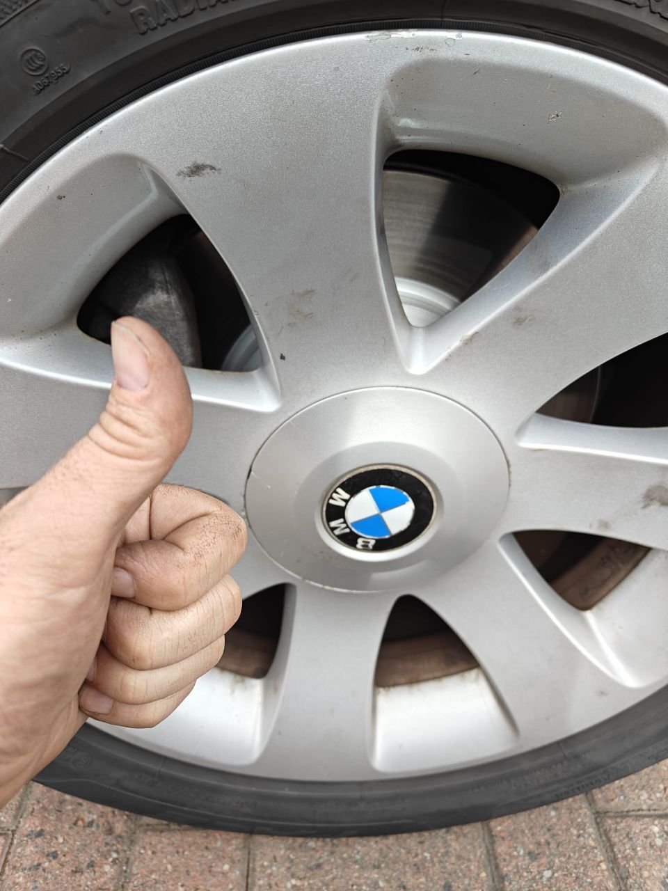

It got advisories for the same 2 front tires as last year, also brake pipes and front discs.
At some point I'll pull the wheels off and have a look at it. There's a slight shimmy under light braking which I was hoping would be picked up on, if the MOT test doesn't pick it up I doubt I'll have much chance though.

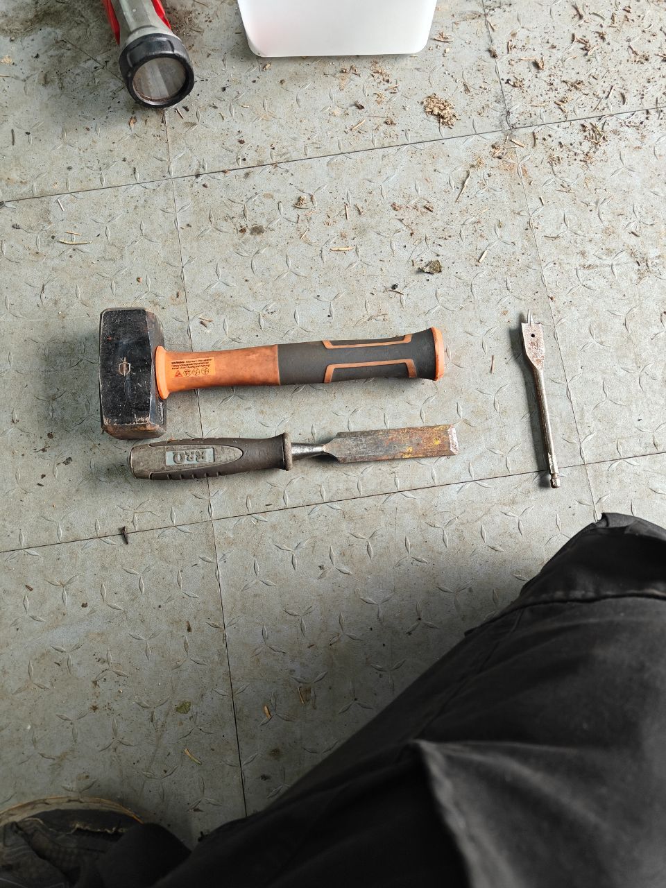

I used some specialist cleaning tools.

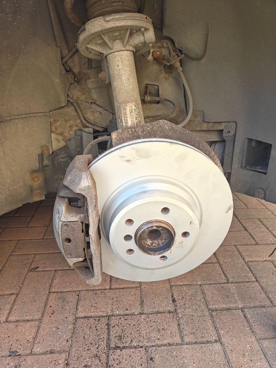

Time for an update on this. It continued to waft around very well but the vibration under moderate braking was annoying. Slightly confusingly it went away under heavy braking.
I'd hoped the MOT might turn up an advisory for a bush or two but all nothing was forthcoming. A quick fondle of my brake discs revealed a bit of unevenness and wear on the back half of them so pads and discs were ordered up-Halfords trade card FTW here as it got me Pagids from Euro cheaper than Euros regular discounts
This thing came apart remarkably well for a Scottish car, in no time at all I had it all fitted

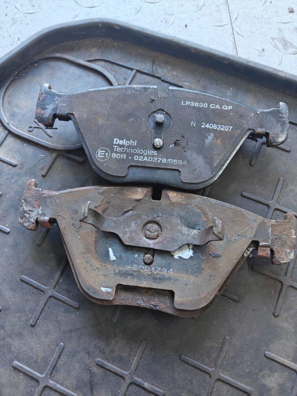

A quick test drive round the block revealed a random noise on light braking.
At this point I spent about 2 hours checking everything until i eventually worked out one of the new pads was moving around in the caliper.
Here's the new outer pad vs the old.
As you can see it has a locating spring on the old one which the new one doesn't What a ballache that was, sucking 2 hours of my life I'll not get back🤦‍♂️
I'd used REALOEM to get the part number, turns out it's hit or miss as to whether or not they have this spring or not. I managed to find a set of Ferodos which did so ordered them up and waited a week for them to arrive from 35 miles away🤷

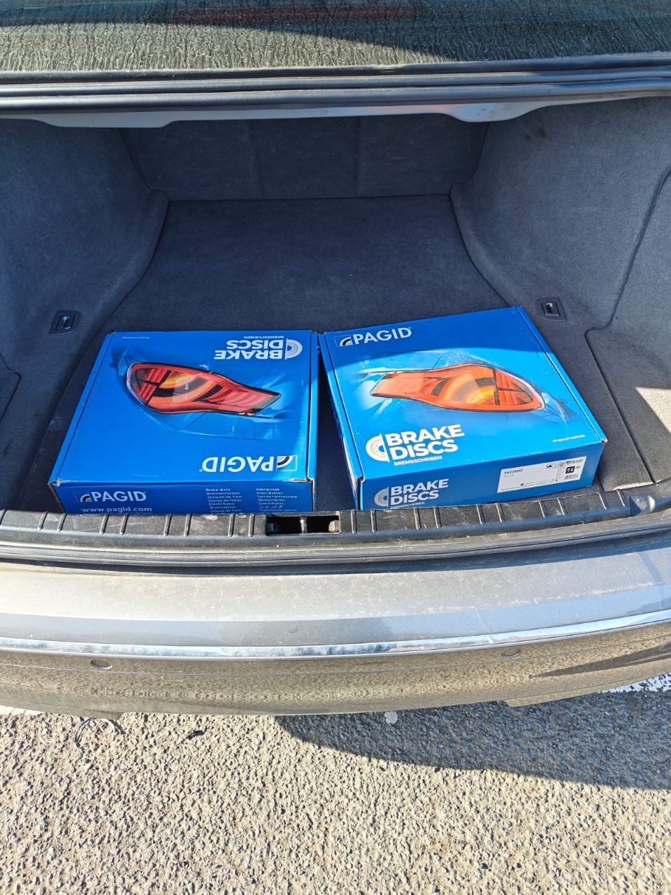

Fast forward to yesterday afternoon and they finally arrive.
Swapped in and a test drive revealed all was well
And here's old vs new discs for comparison
Yep, they're fucked. Minimum thickness is 28mm, these were down to 25😶

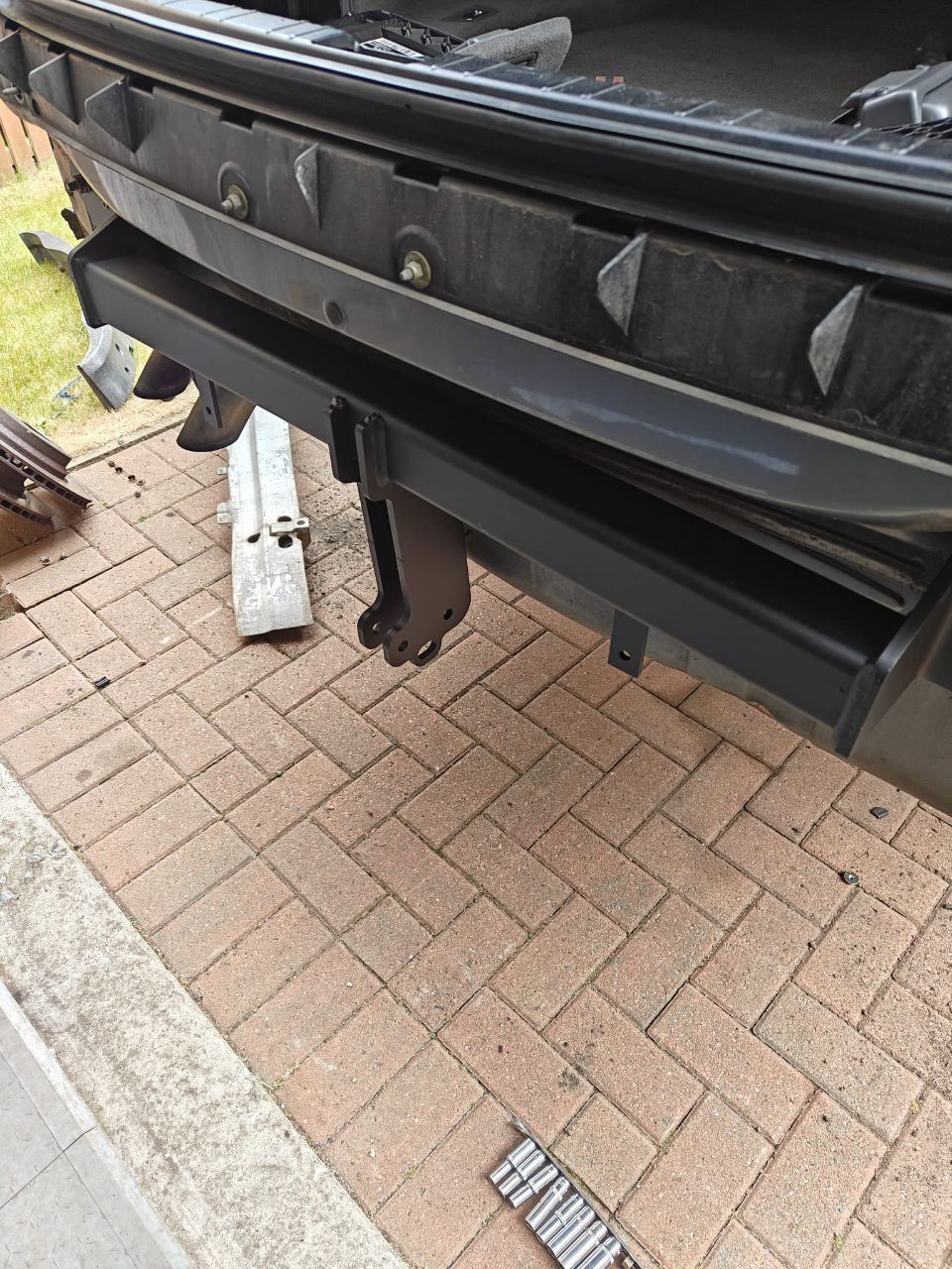

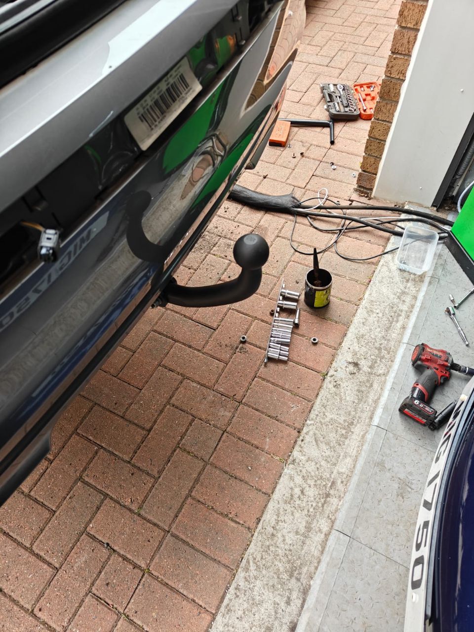

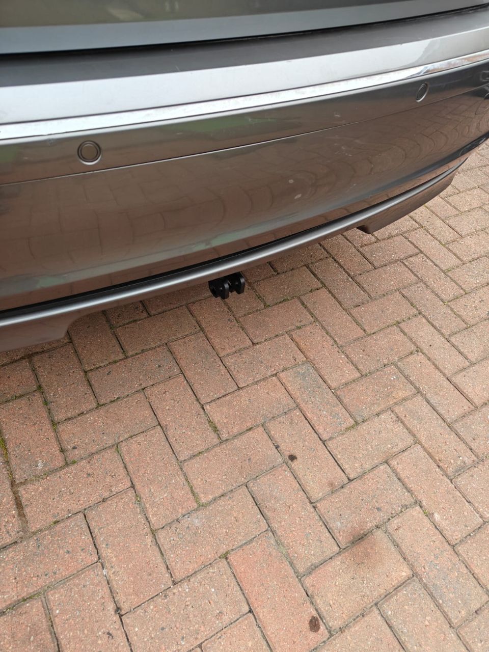

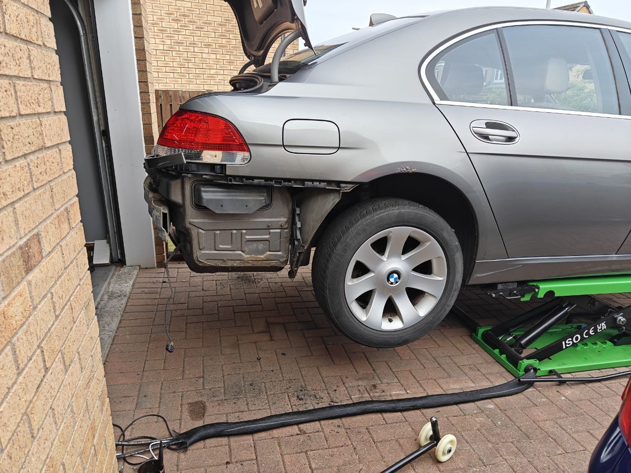

I could then move onto the next mission-towbar fitting.
Looks pretty decent for £160 from ebay. It's removeable and only needed a small cut in the bumper which is barely noticeable as it's underneath. I've got the wiring kit to fit, that's next.

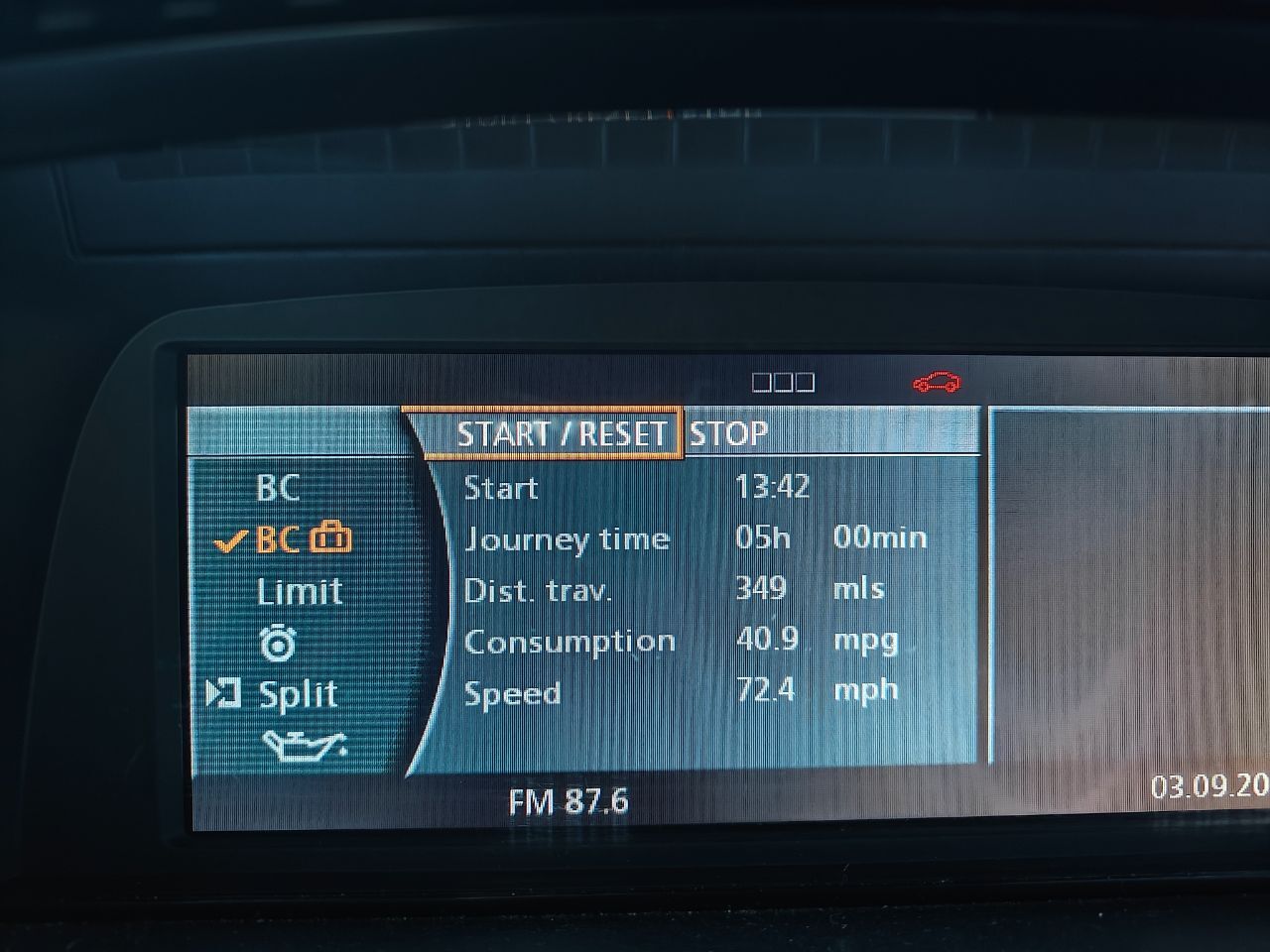

Back home after 6 and a half hours and here's the stats for the full trip.
Pretty impressive mpg for something the size of a small bungalow, although you'll notice mpg was the exact same on the way down at a higher average.
