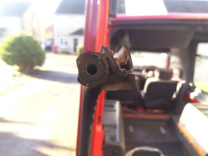

I also spotted some damage to the rear door vertical seal, looks like something has been chewing on it, that would explain the little bit of water getting into the back of the van when the rain is in the right direction.  Looks to be a generic profile, shouldn't be too hard to get hold of or too expensive.  A new seal might make the rear doors rattle less too, that'd be nice.
