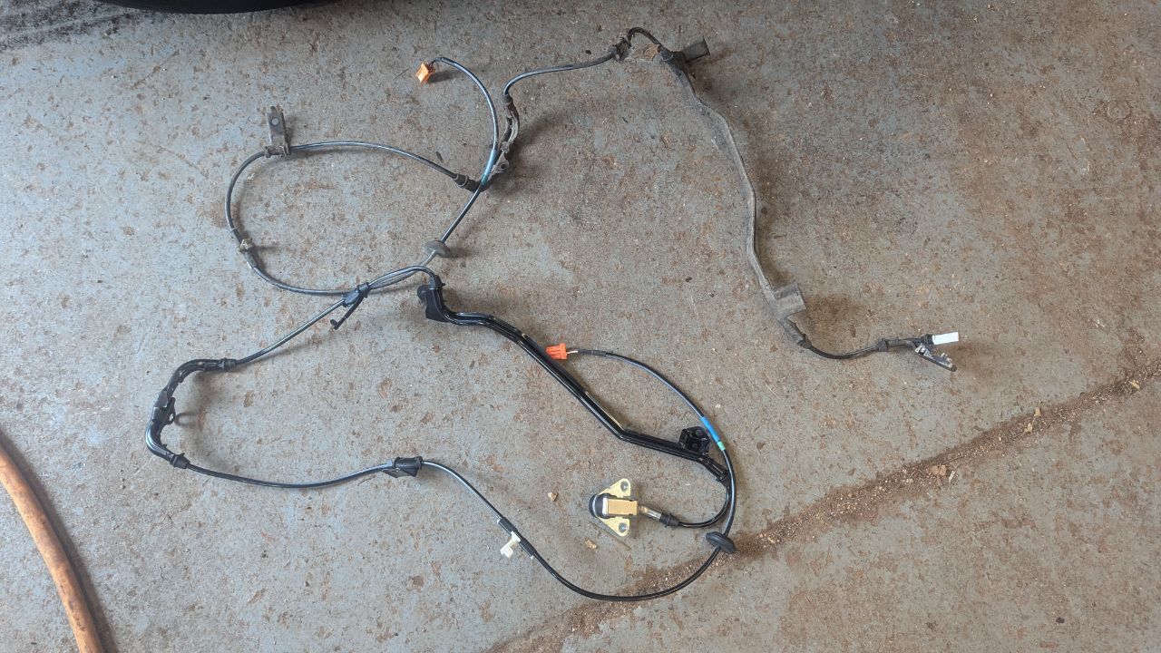

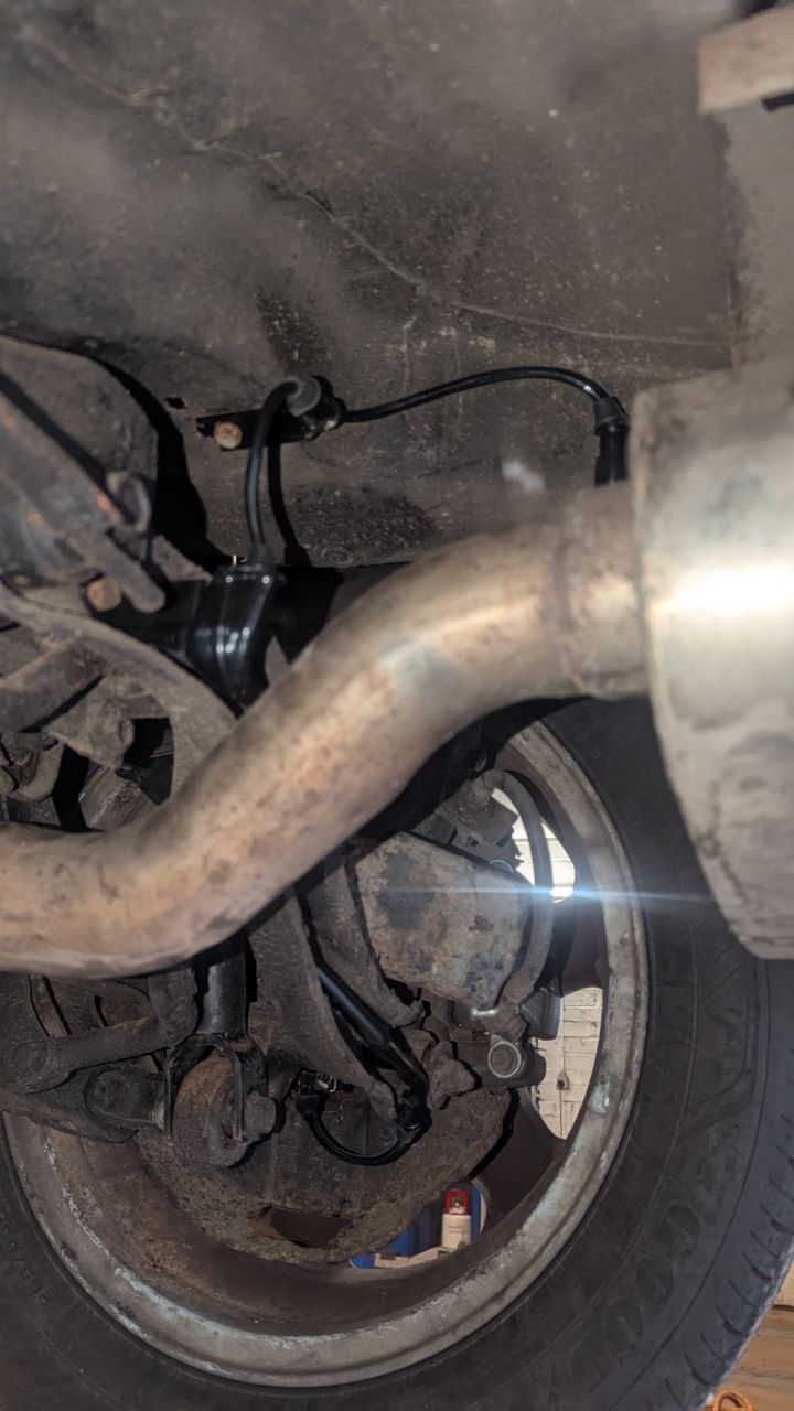

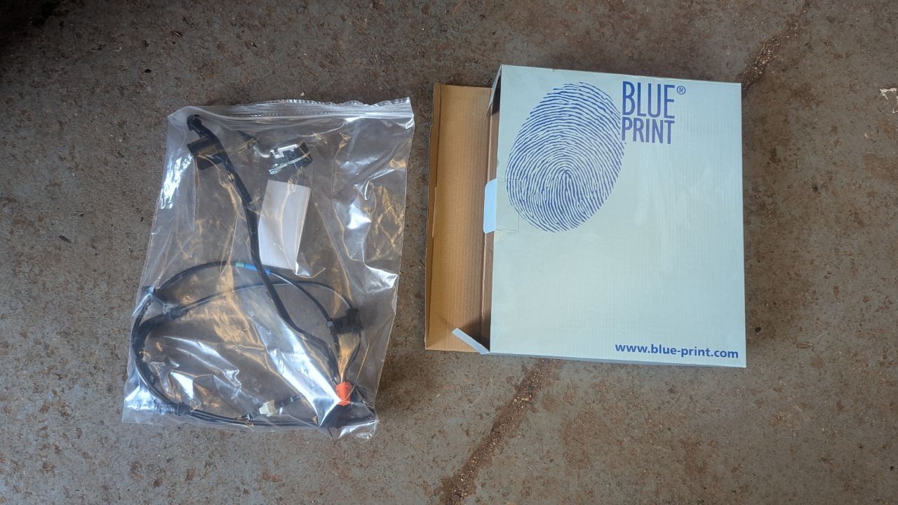

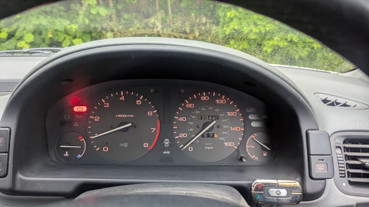

This looks handy...
Looks like a match!
Shiny!
And evil amber glow of doom be-gone!
Happy :)
  • RoverFolkUs changed the title to RFU rescues a Rover 620ti! ABS borked, then fixed

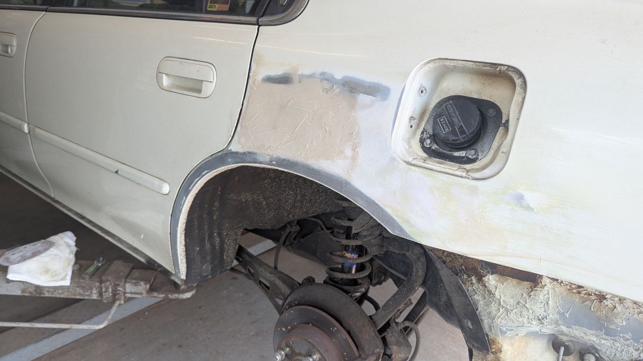

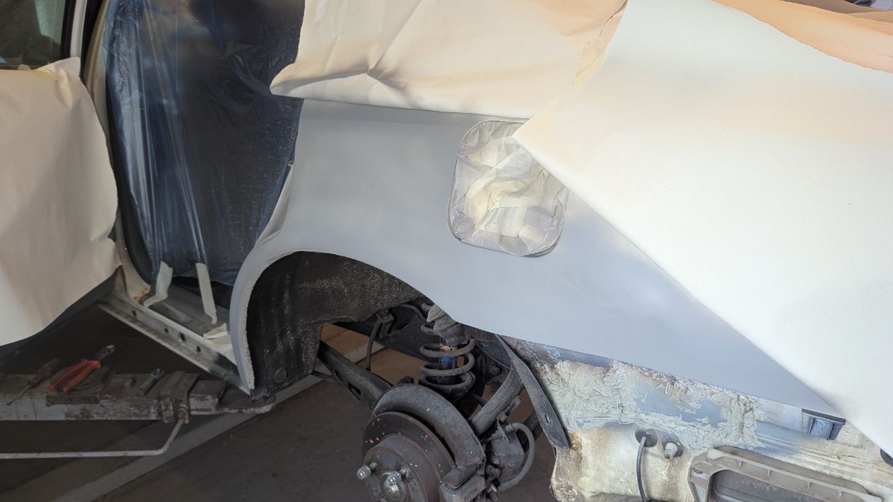

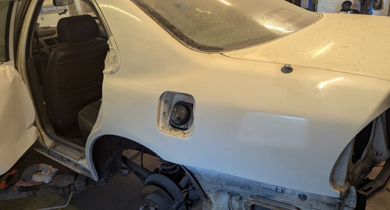

Now the weather is a bit warmer, I've decided to have another go at tackling the bodywork.
Went to a specialist paint suppliers and gave them the fuel filler flap to help match up something better than the previous cans I was supplied elsewhere.
I found a high spot on the nearside, to the left of the fuel filler flap, which explains the awful finish I had previously. Not sure how I didn't notice it before, although admittedly I was rushing around prior to the MOT trying to get it road legal and out of the way. This is warpage from where I'd welded in the new panel. I gave it a gentle* and precise** love tap with a rubber mallet which nicely popped the panel back to create a low spot I can rectify with filler.
Is this ideal? Of course not. But I'm doing this with a spend of about £50-60 so my expectations are minimal.
There was a horrible low spot on the offside, just above where the bumper finishes before the arch itself. I think I've levelled it adequately with a skim of filler, and I've now smoothed it off ready for a coat of high build primer tomorrow.
Spent a fair bit of time on the offside trying to get it smooth and level.
Layered up with high build primer, it's looking much better. Not perfect when you look close, but I'd say 90%. Which is actually better than the rest of the car anyway.
Gave it an initial dusting of base coat and the colour match looked a lot more promising this time.
Applied the final coat of base coat
And then lacquered up. I'm much happier with the colour match! Top marks to this paint supplier for getting it this close. (Ignore the white reflection in the middle of the panel)
That'll be ready for a wet sand and polish tomorrow :)

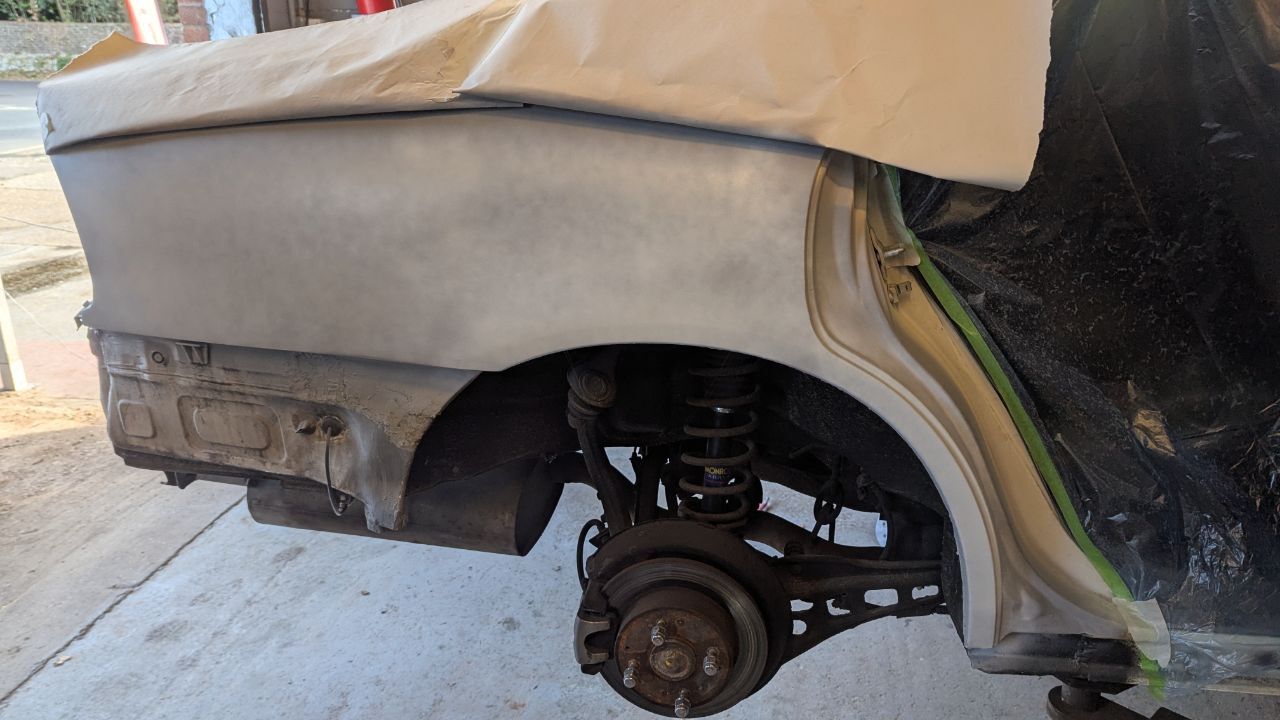

Turned attention to the nearside:
There's quite a bit of panel warpage here unfortunately so combined with my questionable filler skills, it's proven a bit challenging.
My final attempt. Much better than it was previously. I decided to give it some high build primer at this point.
I'm not totally happy with the finish here, there are a few impressions in the filler which I don't think the high build primer is able to deal with. I'm probably going to end up rubbing it back and trying again.
Tried another layer of primer and I'm still not totally happy. I'll decide tomorrow on whether to give it some base coat or rub it back and do another skim of filler.
The grazes on the front bumper were bugging me, rubbed them back with 120 grit sandpaper, to make them flush with the bumper surface. Skimmed the gouges with filler then smoothed it all off with 400 grit.
Gave it a localised dusting of base coat. Much better! It would probably benefit from another dusting but I'm very happy with this for the minimal effort required.
That's all for today, just a bit more to go tomorrow and over the weekend and hopefully it'll be looking much better and I'll finally put the sill covers back on!

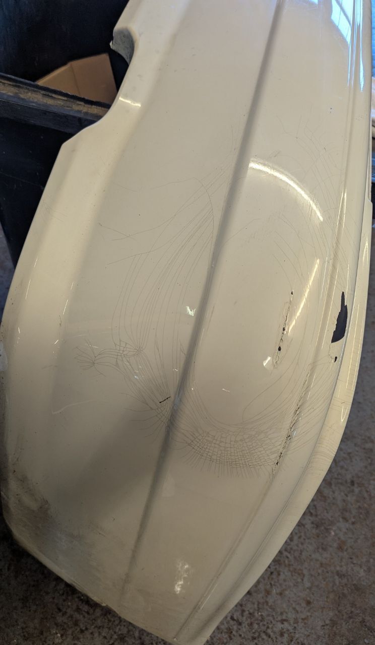

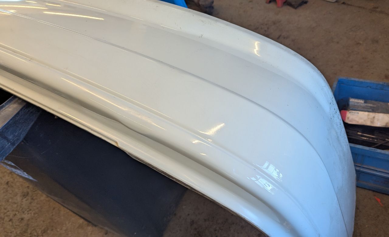

While I had the bumper off I thought I might as well do something about the cracked paint
And scuffs
Didn't go totally overboard, just rubbed it back and dusted a coat of base coat on it. Didn't bother lacquering it, was just looking for an easy improvement
It's not perfect, but nor is the car.

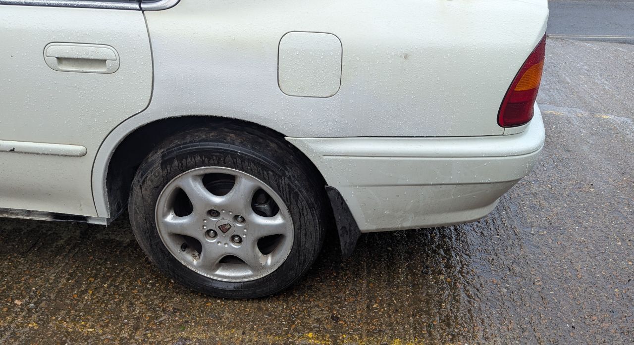

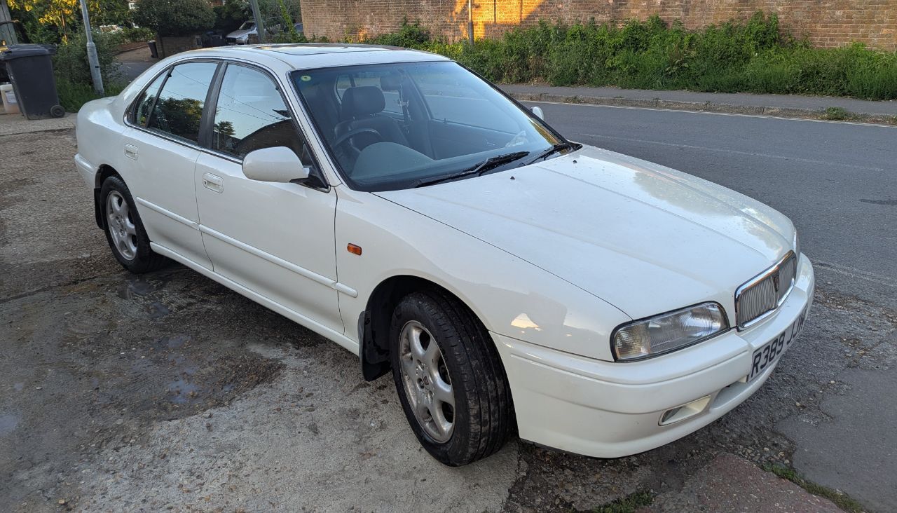

And here's the final result! :)
(Yes, rookie error, I forgot to paint the fuel flap 😂😂, I'll do that another time if it bothers me enough)
Finally refitted the side skirts and gave the car a wash, then followed up with a machine polish all over. I'd say I'm pretty pleased with how good it looks now! The paint match on the rear quarter panels is nearly spot on. I've still not done an absolutely perfect job but I'd say it's about 90%. Not bad considering I'm only using rattle cans
The worst areas are now the bonnet and roof, the rest of the car is relatively ok considering it's age. The paint seems to have gone all crazed, there was a tiny improvement after using the machine polish but realistically I think it's too far gone and needs at least sanding back, or simply repainting.

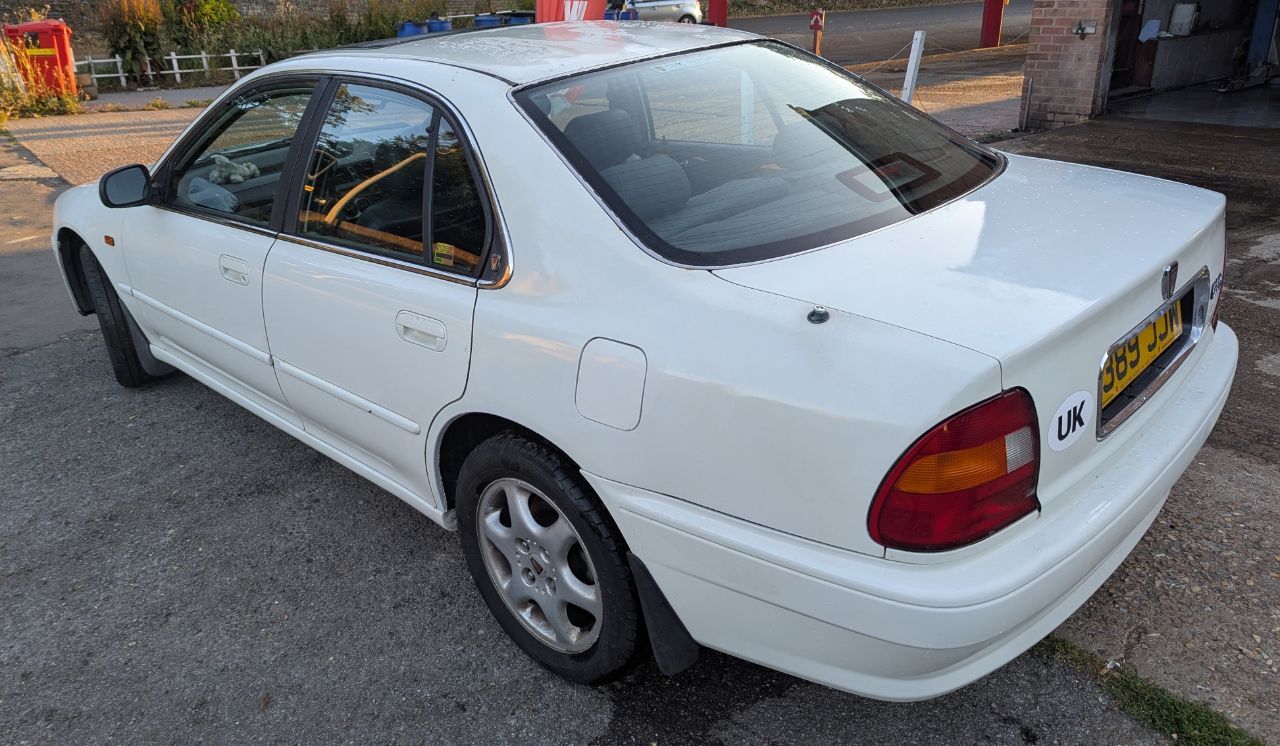

Compared to what I started with - the wrong colour and questionable filler work!

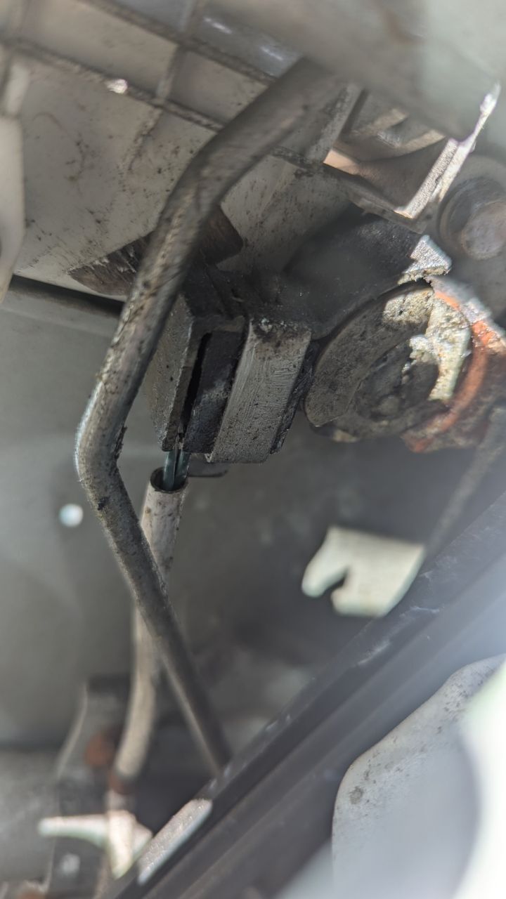

Finally had a chance to investigate the central locking which has been inoperable for a few weeks now, first I pulled the driver's door panel off as this was my prime suspect area.
There's a micro switch behind the outer door handle which gets operated by that eccentric cam on the back of the key barrel. I tugged on the wire and and fiddled with the position of the switch, lo and behold the central locking starts working on the key again! Very happy.
The remote fob is still dead as a dodo, but I think I can live without this. There's a service online to get a new one supplied and paired to the central locking module, but this is around £100 and feels like an unnecessary expense. They were always prone to failing so I think I'll just leave it at the moment.

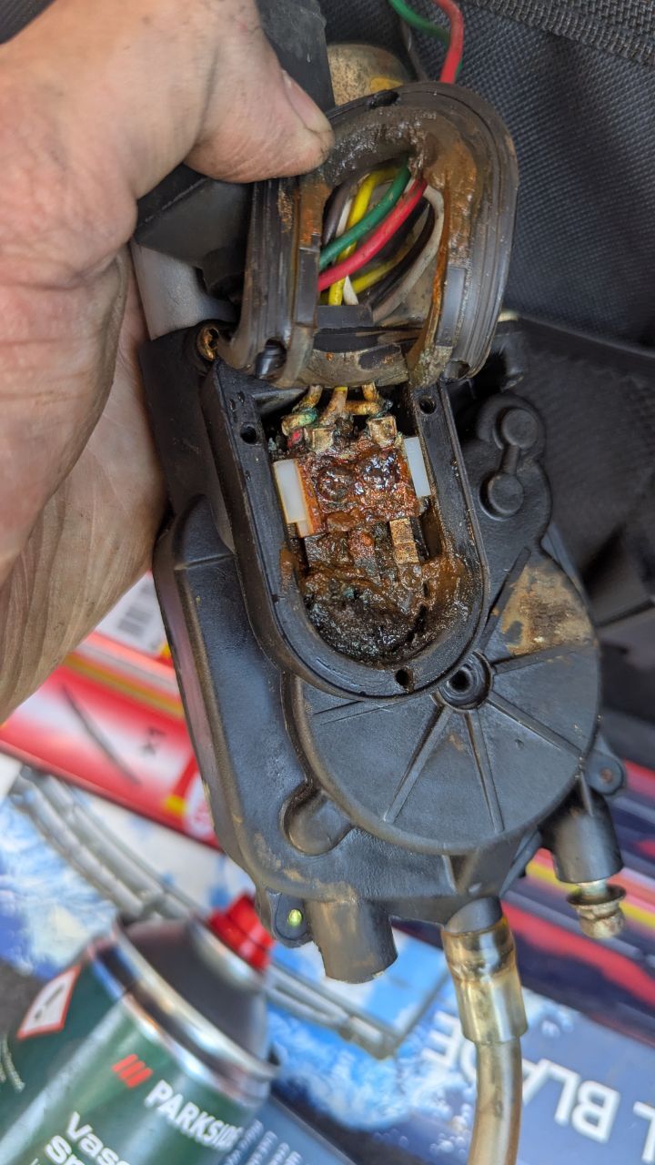

Next up was the electric retractable aerial. The one that was fitted to the car when I acquired it simply hummed away but didn't do anything. I replaced it with another unit from a breaker, but it soon stopped working again.
Ah, that might be why...
I found another 600 being broken and asked for the aerial mechanism. The seller said it was broken but I'd be welcome to it for the cost of postage.
I found it was in much better condition, in fact it looked like a relatively new replacement part, but the aerial itself was broken. Crucially, when I plugged it in, I could here the motor running, so I knew I should have enough spares between these 2 units to make a working one.
Stripped my old unit down and extracted the aerial from the motor/gearbox and transplanted it into the donor unit.
Forgot to take a picture, but I now have a working aerial :)
