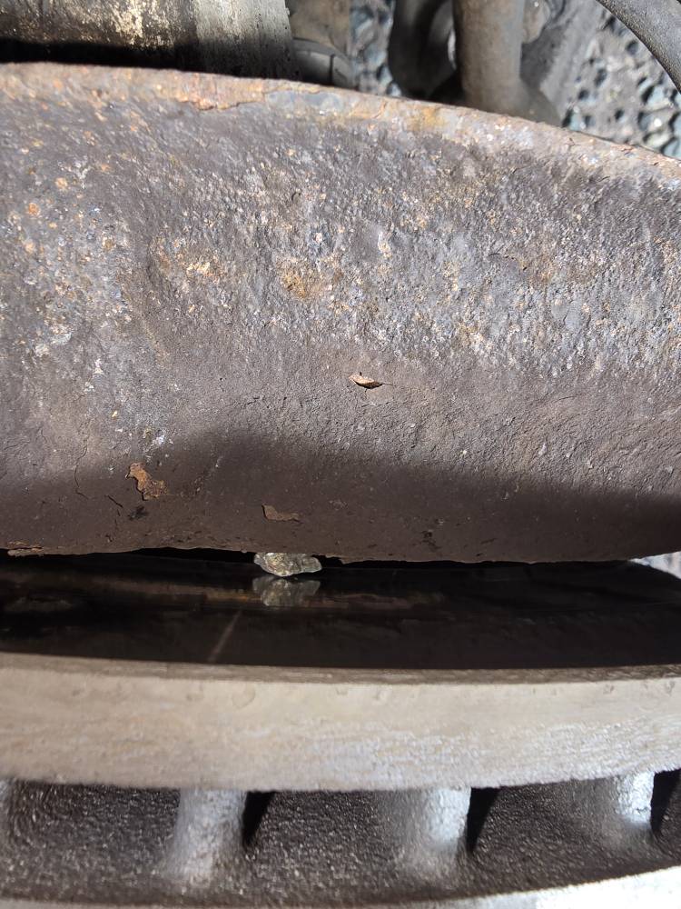

Todays task was a very simple one. Replace the nearside front brake pad sensor...

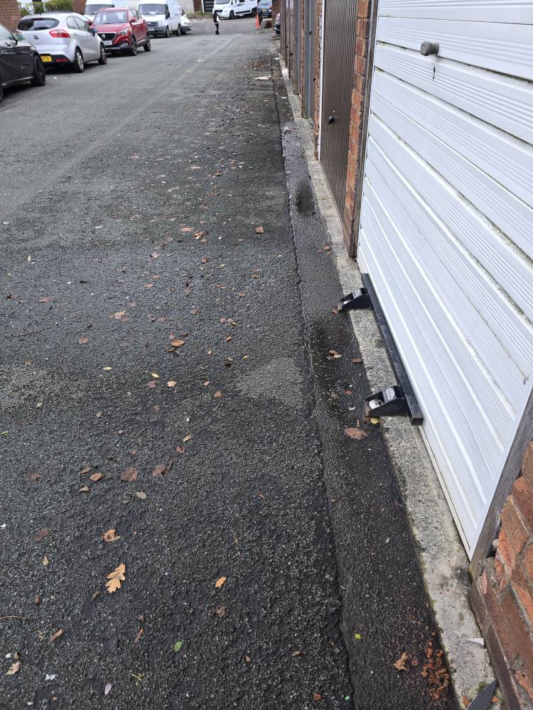

I go to the car and open the passenger side door to put the sensor in while i maneuver the car to somewhere suitable for jacking up. Since we just had the storm i thought it wise to see if the A8 was keeping the water out. I was greeted by the passenger front foot well being completely saturated. I switch up and decide this is the new priority and begin by looking at the bulk head to see if its holding water. It was and it was a lot. Getting to the drains is underneath the fan assembley which is actually quite the involved job, i go about taking off the scuttle panel and drop a 10mm in to the bulk head and it evaporated presumably. As a result i couldnt be arsed taking it all apart and took to google. Quickly realise most people say the big reason for it is the aircon drains being blocked. I therefore go to halfords to buy a new socket set (overkill to replace the 10mm but i decided i am worth it) and got a few tools to try and unblock the drains on the scuttle. Back to the car and carpets up, i take one of the two drains off and water GUSHES out of the drain, thats confirmed it was blocked then. PITA job to get the drains back in after taking them out to unblock but some silicon spray helped. I then go back to the scuttle and use a magnetic claw thing too get to the hard to reach drain and pull out all the muck, slow going but worked. Finally then managed to get around to replacing the pad sensor, which turned out to be the wrong one so i just bypassed the sensor as it has all new brakes anyway. Currently mopping up the excess water with the heater on full to the carpets. Never simple.
For reference the ground was completely dry before i started and the puddles are all from the A8!20251115_123019.jpg.efabc5862588d411e0327e1576e3b07d.jpg20251115_124711.jpg.804ac6898d9e742acebedde3f22f9c66.jpg20251115_124718.jpg.b3c247cb6dc1701072e3ba4198268a55.jpg20251115_124721.jpg.0b2f7382e3c6f767cf6df1ab946433c1.jpg20251115_125636.jpg.d1156831d1e0e626c699b8c2e1d156cd.jpg20251115_122419.jpg.c89094a0060bb764716ed31a413bd6d6.jpg20251115_134359.jpg.b4713d35dc26e482e83ce54beaac1f4a.jpg20251115_134409.jpg.b88bafe4de173959b2d0c2a0a87892dc.jpg
One of the first things I did on my D2 S8, a very similar setup and definitely worth doing. I don't wanna know what they look like on my D3...

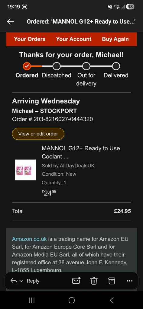

Just watch out that Mannol G12+ ready mix is weak as piss. According to the SDS datasheets it's only 18% to 20% anti-freeze so good to around -10c and fine in the UK for the most part. However I wouldn't weaken it any further with water if it needs a top up.

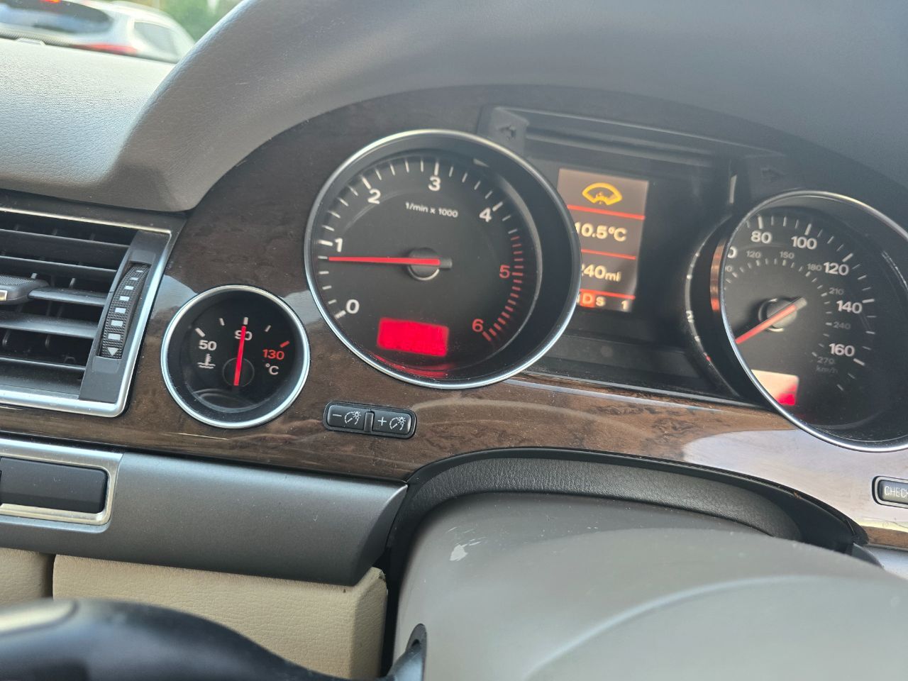

I fitted two new thermostats for the A8 today first one was the main engine one. Removed the old one without having to remove anything on the car, just a fiddly thing to reach at the front of the engine.
Old on the left, new one on the right. Oem audi on the left with the date stamp april 2005. Ill be honest it looked fine and was fully closed, i suspect this was working fine but while im changing one i thought i may as well change both.
Quick side bar to say how happy i am with these cheap tools. The clamps on these are in tight spaces for the gearbox cooler and i dont think i would have been able to get my pliers on it so god send for this job!
Now for the gearbox cooler one and this is a classic case of "i hate working outside, in the rain, in the cold, on my back underneath a car" because god it was miserable. I am looking at buying a house next year and i am going to get a big garage and its going to get a lift because every job will be so much faster. Took probably 15 minutes of getting the car up sufficiently and with a jack stand in an appropriate place before i even went underneath. 20251206_103712.jpg.d88aac086bdfb638f047188222a8eb17.jpg
See however i got there and new tools removing the old thermostat.
That was the easier one to get too, the one above was a pita. However all changed over and i took for a quick drove and before long.
Holding 90 degrees as it should. I took on a fast drive as the high speeds tended to drop the temp dramatically and still all good. Good result in the end.

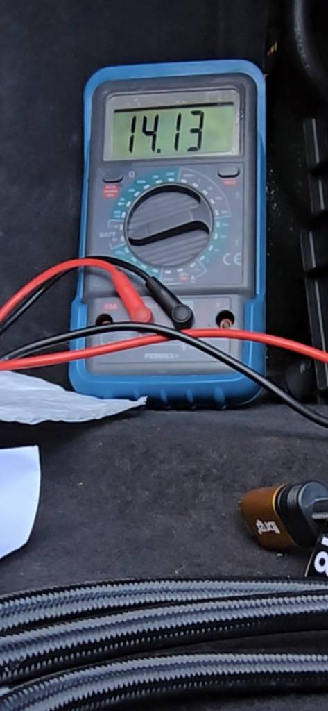

Recently when turning over it seemed to be struggling a smidge, my rubbish fm transmitter gives a voltage when you first put it in and it was showing just 13.6v when running and then 12.0v when off and no ignition on. So 13.6v seems low and suggests its not charging the battery appropriately. Tomorrow i will have a better look with my multimeter and see whats happening. Ive been smelling a smidge of burning oil smell when stopped so maybe an oil leak on the alternator could be causing it to fail. Only time will tell. 20260104_115721.jpg.1fac55974cb9450005a17589a5b3289f.jpg
Please note those lovely headlights still looking clear!
Well the result makes sense. I checked for an oil leak and it looks fine. Maybe a slight weep from the cam cover but nothing to make me start tearing it down, it looks fine immediately underneath it.
I checked the voltage first thing and its at 12.08v which is low.
I started the car up and it went to 14.13v which is good.
I then turned the car off and the battery immediately fell to 12.11v. I have been driving the car a bit to work and back but never more than 20 minutes so i suspect the battery is just a bit tired. Ive had heated seats, heated rear screen, heater, lights etc. On for a lot of the journeys so i suspect the battery is feeling it especially with the cold snap. As the cold is on its way out now though hopefully i can give her a good run and all will be well.
