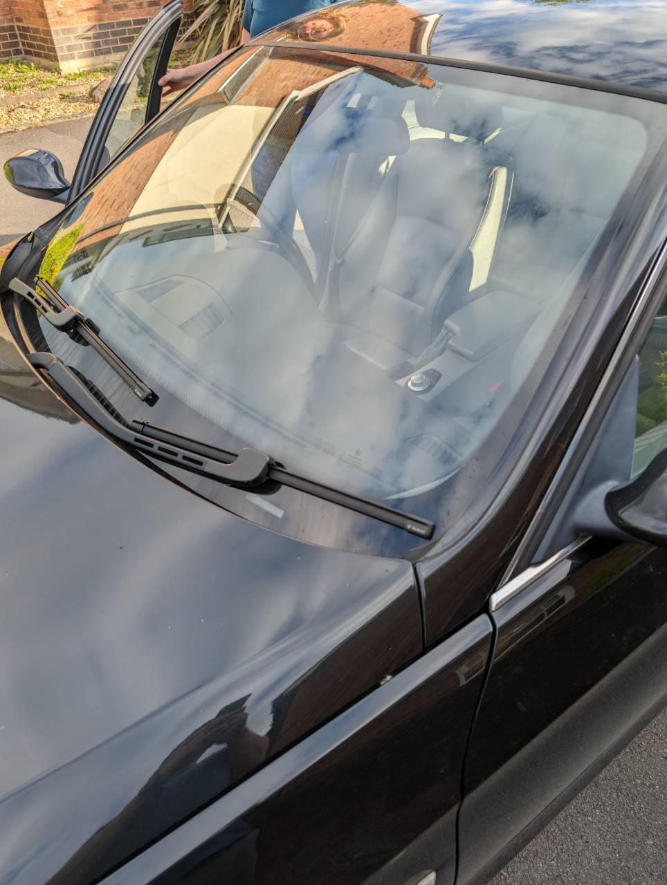

The wipers on the 330i don't park properly. Always with a gap. Google says that the wiper control relay fails and causes this issue. It lives in the fuse box behind the glove box.
Easily enough pulled out.
Looking inside it was all blackened on the contacts. I tried cleaning it but testing the relay found some of connector contacts were failing too. I think the act of removal killed it off.
I raided my relay stash to see if I had something to replace it.
Found this one which had the correct number of contacts and just importantly has the flyback diode to protect the driving electronics. Not sure if the right amperage on the contacts but at least gives a chance to make my wipers work again.
I think this was from a fusebox on a haunted Laguna II that Hooli scrapped but kept the fusebox control unit which he gave to me when he bought my old Saab 9-5 (the one with the dodgy changing auto box). Yeah I have a pretty specific memory at times...
Anyway that fixed it and it now parks properly.

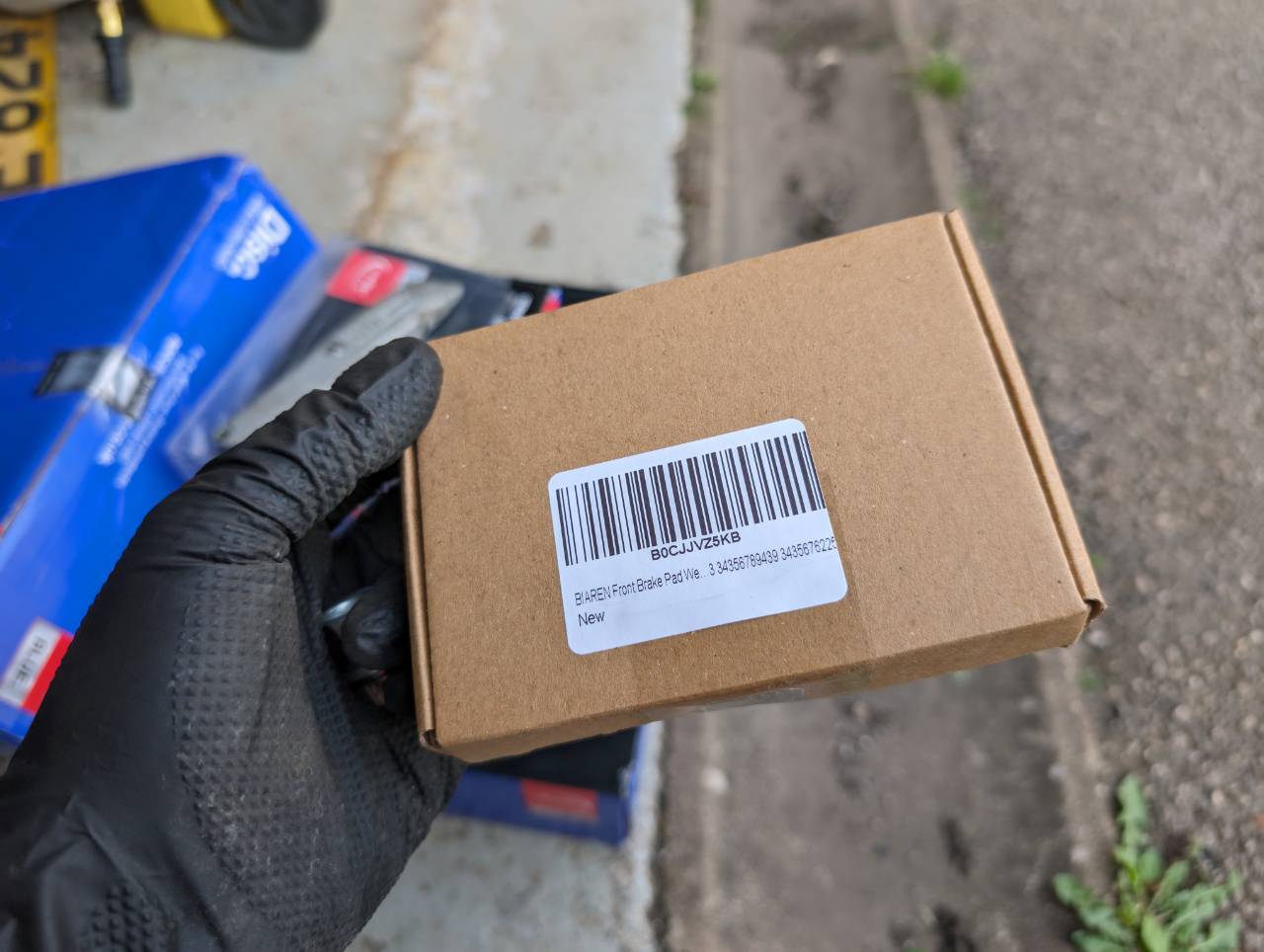

Parts arrived late yesterday afternoon.
I bought an Amazon special brake sensor. Tbh I am not sure why I didn't spend the extra £3 for a Febi. It doesn't have to do much though as it's basically a bit of wire moulded in plastic. Just if it fails, I'd rather not be doing this again.
Looks alright to be fair.

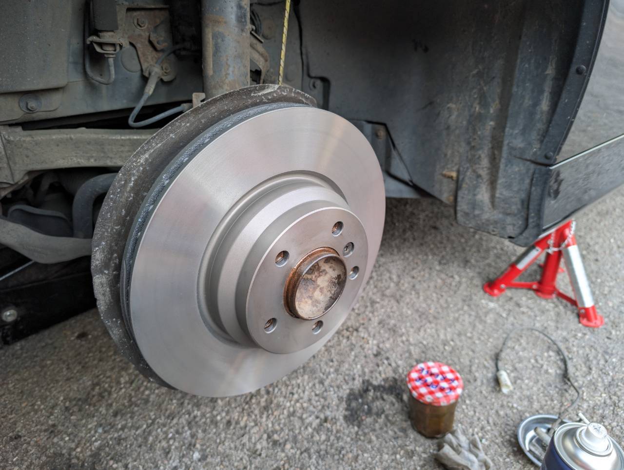

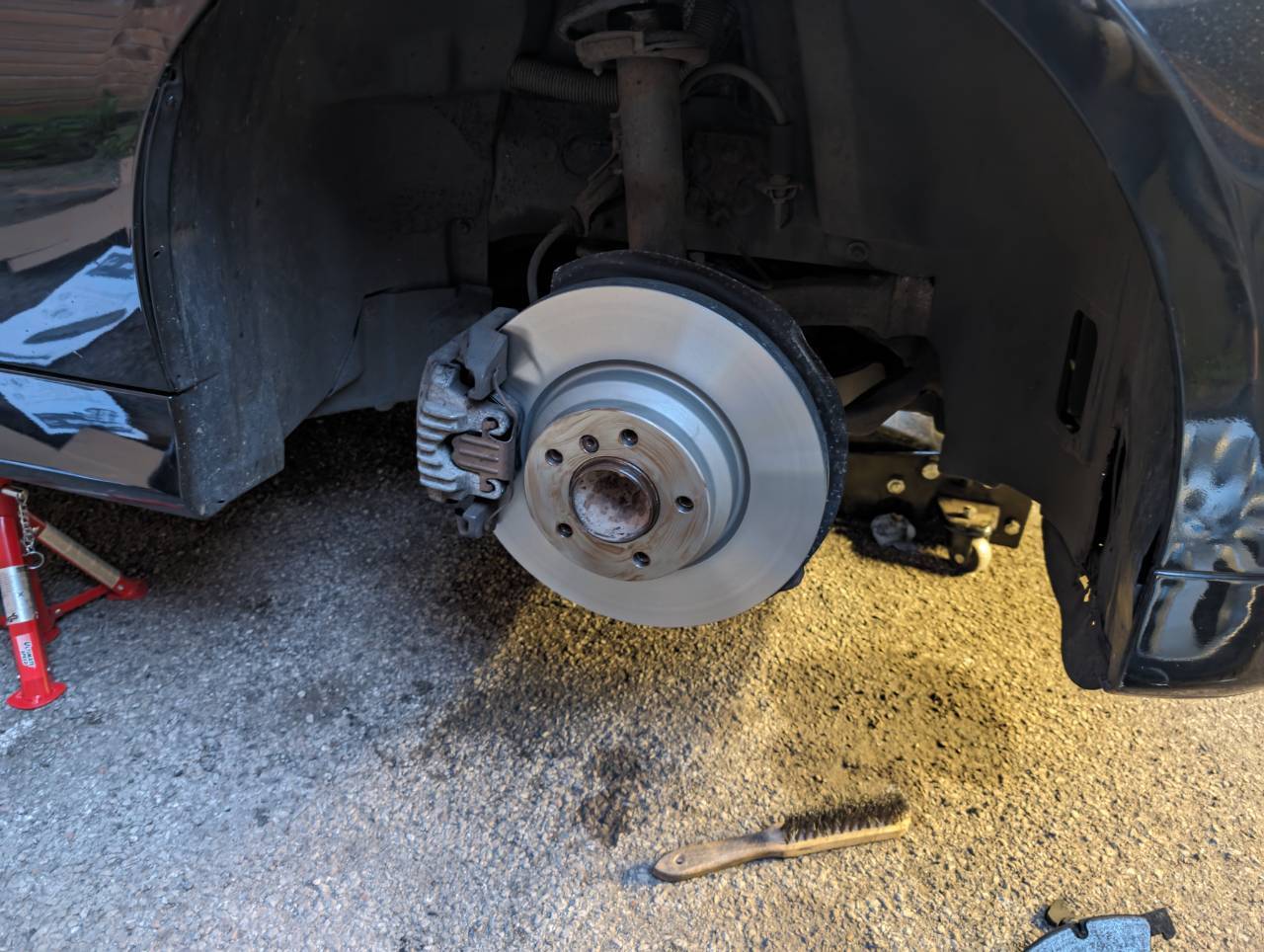

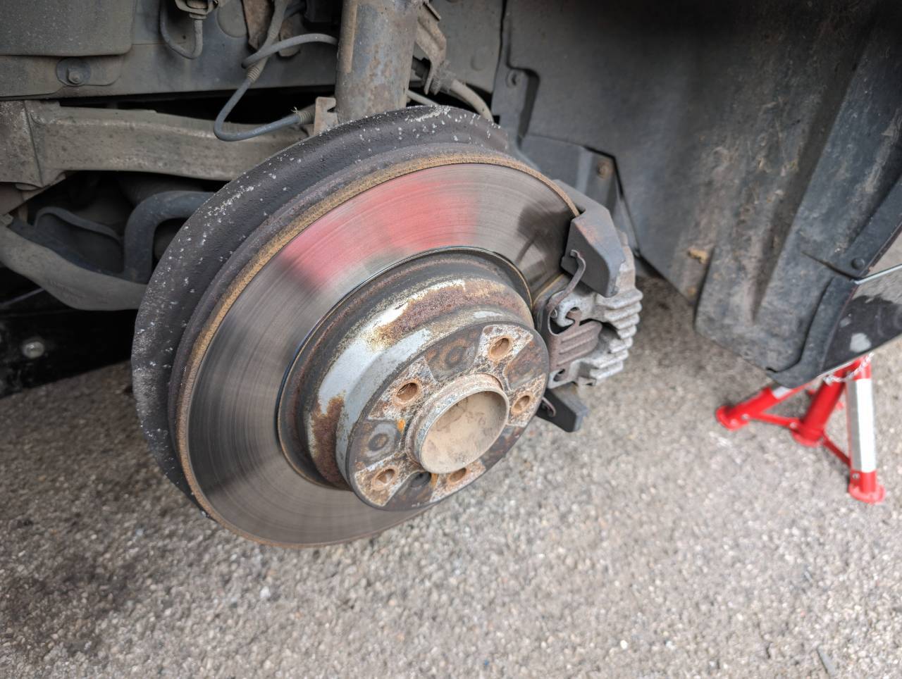

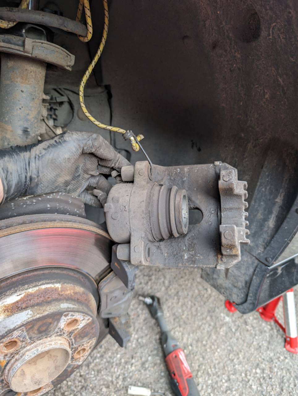

Front up. Little jack is to get enough rise to get my big jack in. I really need to invest in a low profile jack.
Wheels off
Genuine BMW brake pads and discs!
Not a lot of meat left on the pads.
However I reckon I could have reused these discs as not that much of a lip on. Oh well.
Caliper off. These are massive.

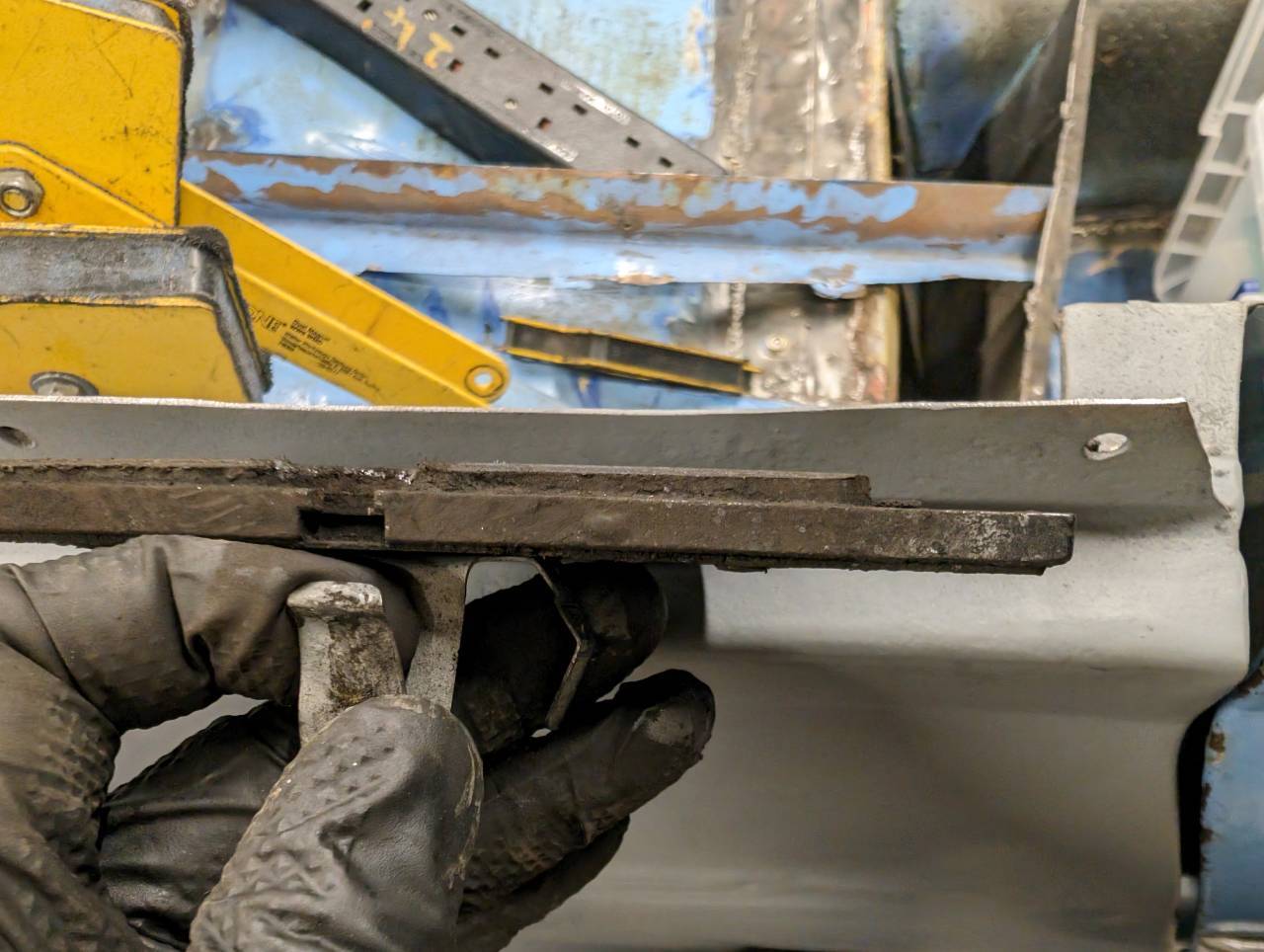

Pad retaining screw was a bit of a fight. Just about did it without rounding it off. I should have ordered replacements really.
Clean up and copper grease the face.

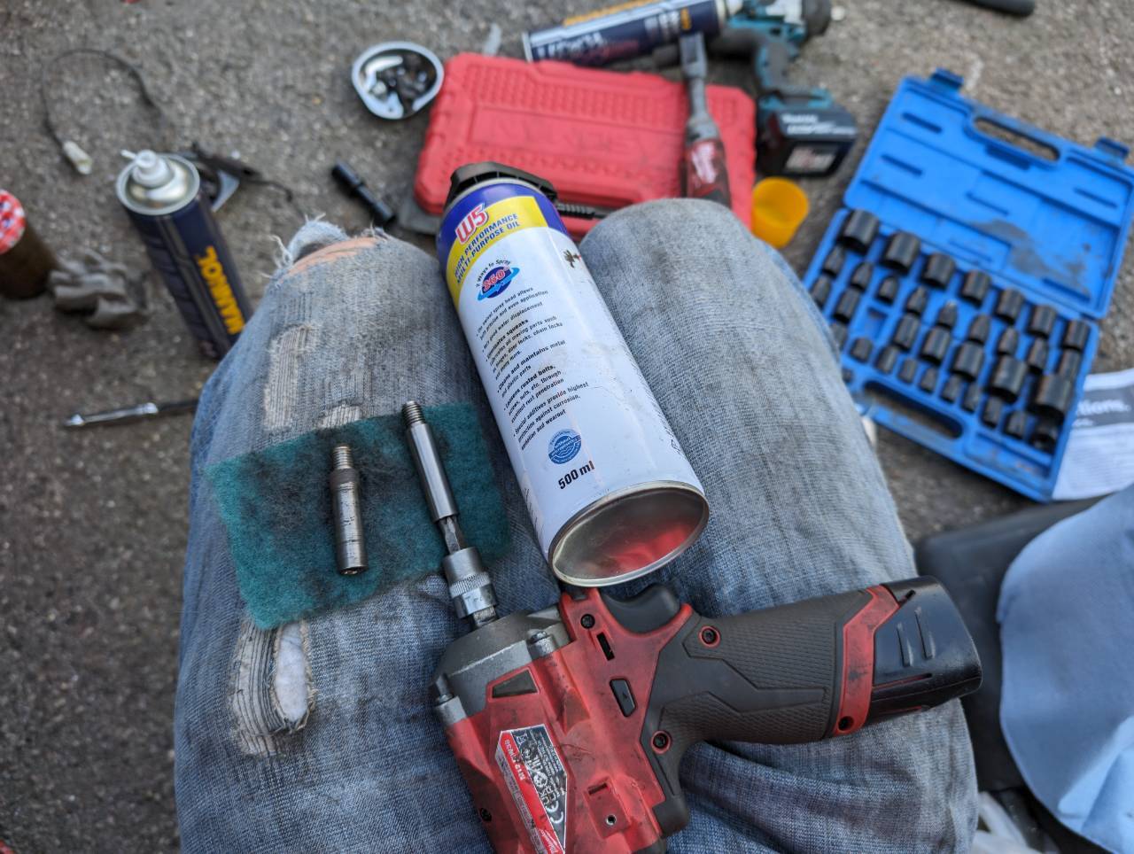

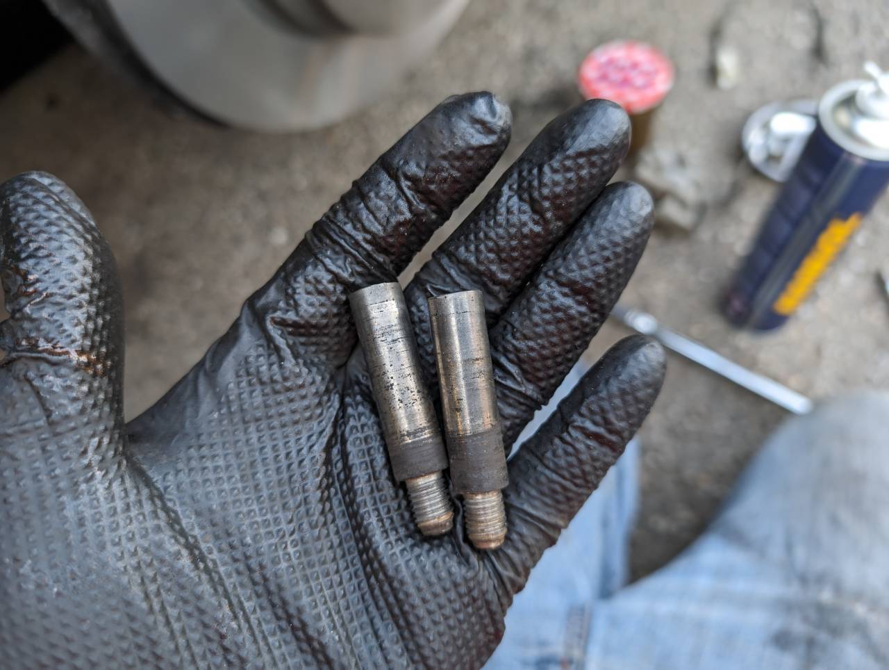

Slide pins I cleaned up. Trick I learnt is to use WD40, scouring pad and spin them with the tool to undo. Gets them clean in no time.
Re-assemble. Pins came out dry so I put them back in dry. BMW recommend to have them in dry. Tbh if they've been greased, I've found it hard to ungrease the lot. So I would have put them back in greased.
Same job the other side.

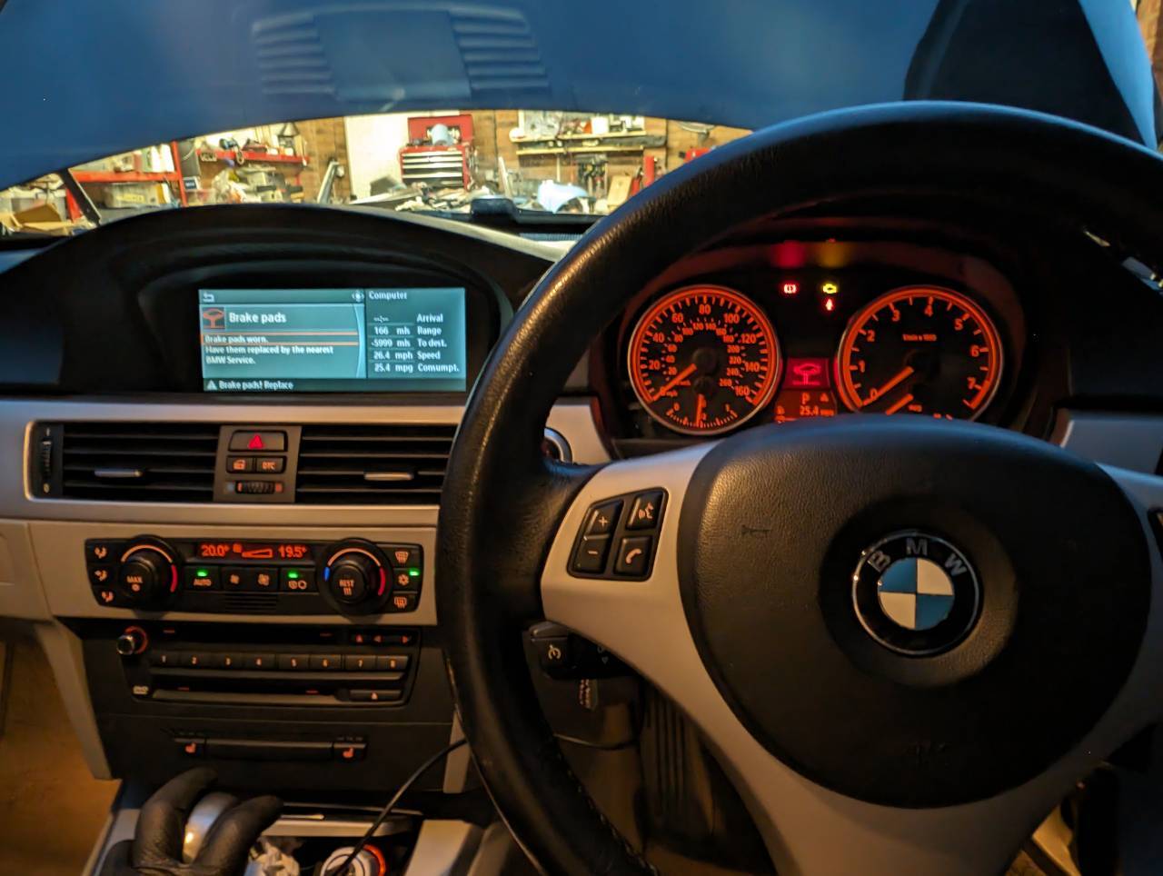

Reset the service warning.

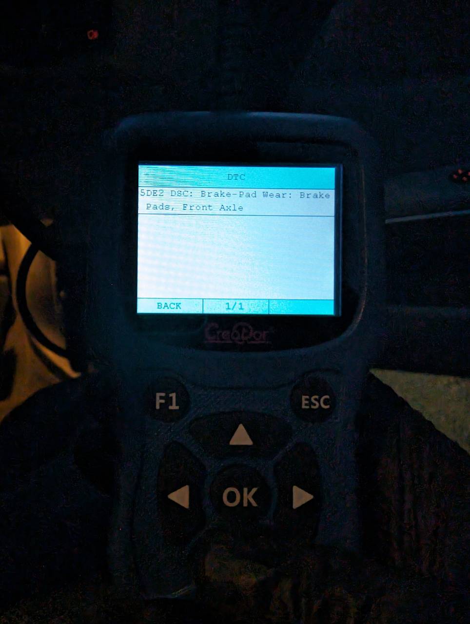

And clear the ABS code for it.
Finally went for a test drive.

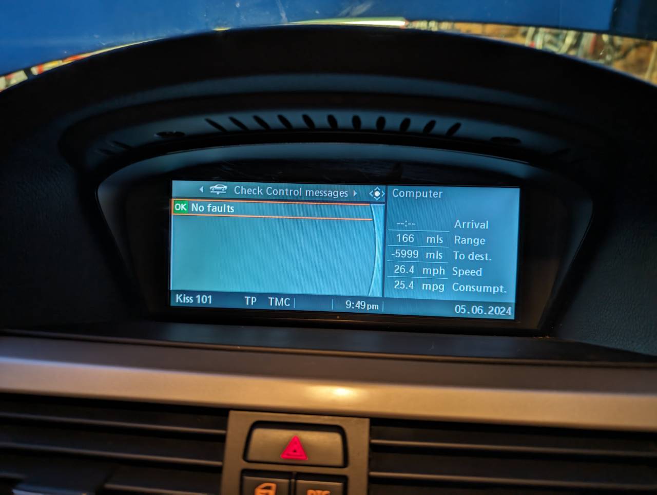

Got home and literally turned into the drive. *Bong*
REALLY
I've only just cleared all the warnings, you bugger.

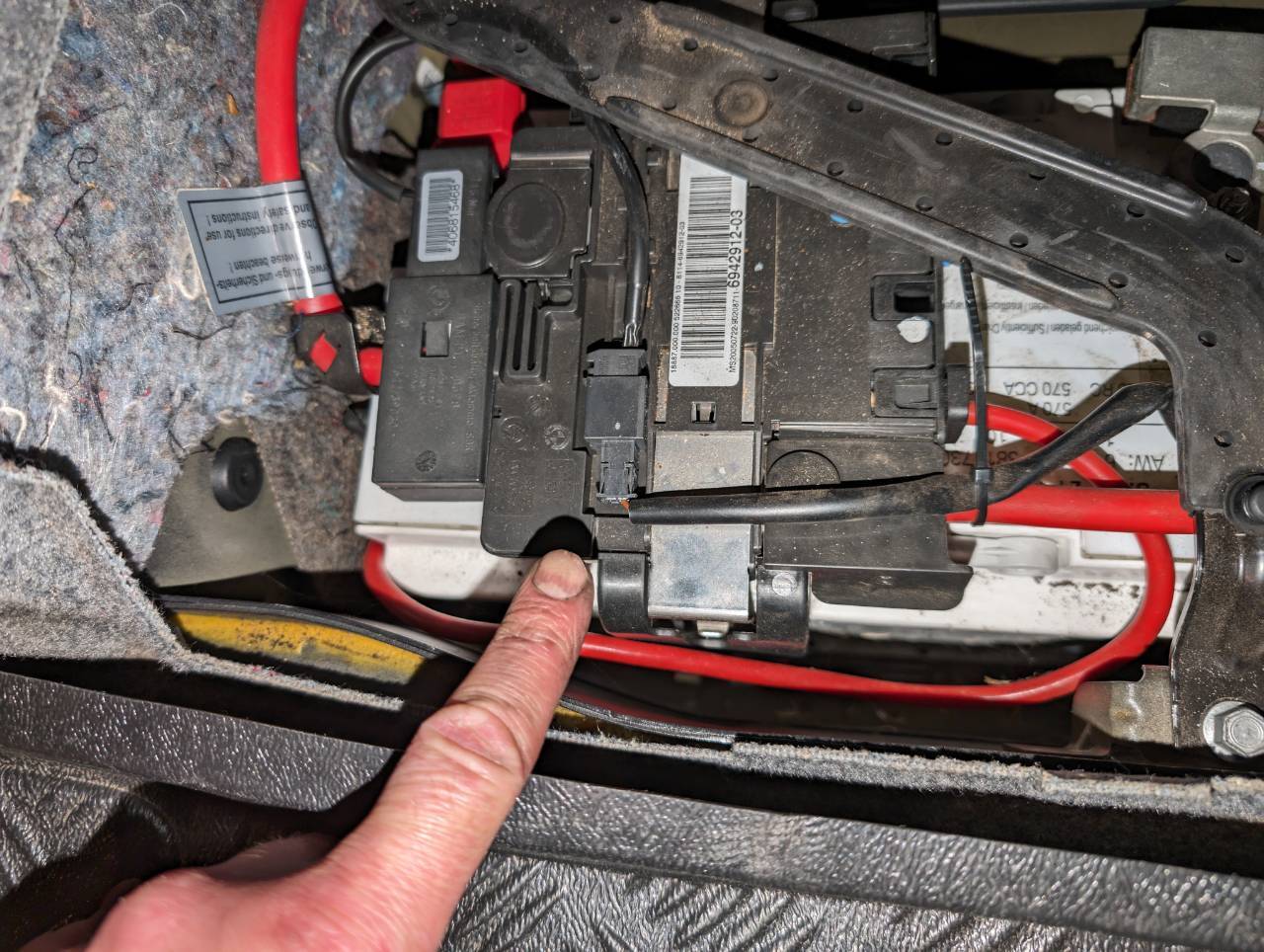

Plugged in the code reader again that permanently lives in the glove box.

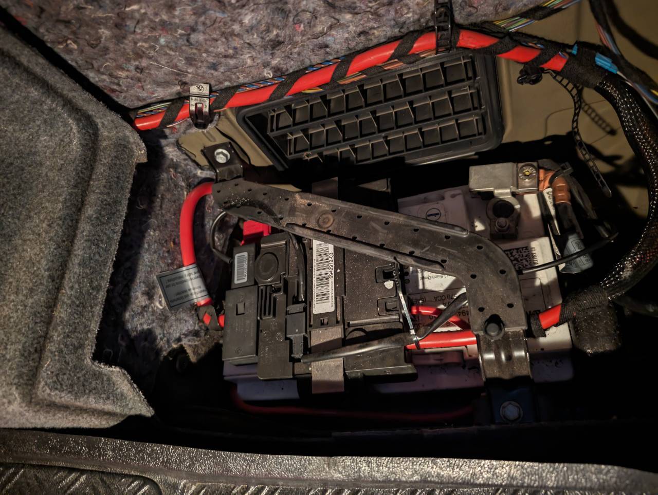

Basically it has a emergency disconnect on the battery terminal to shut off power in a big accident. Like everything BMW electrical this age, it appears to be a common problem. Yes there is just about a battery under there.
This connector is what causes the grief. I disconnected and reconnected which seemed to allow the code to be cleared. I suspect this won't be the last of this problem...
This is why I'd hate to be a professional mechanic. Fix one thing and another completely unrelated breaks just after the first job is done. Also I guess this sort of shit is why these age BMWs gain a reputation to be expensive and complicated to run. No doubt most dealers would have shoved a whole new battery disconnect and battery computer on this.

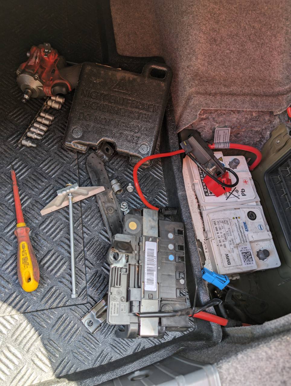

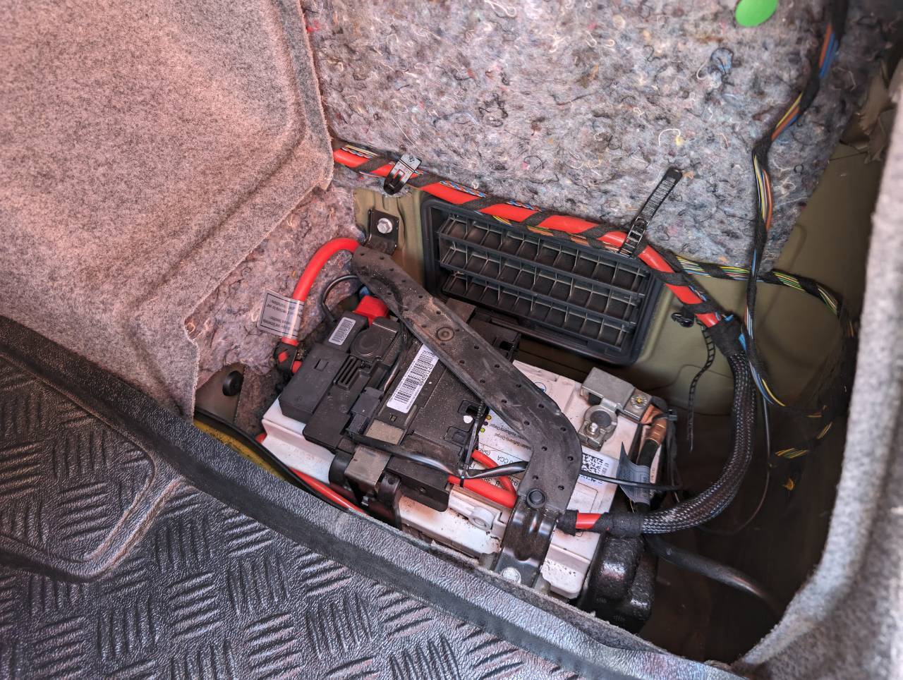

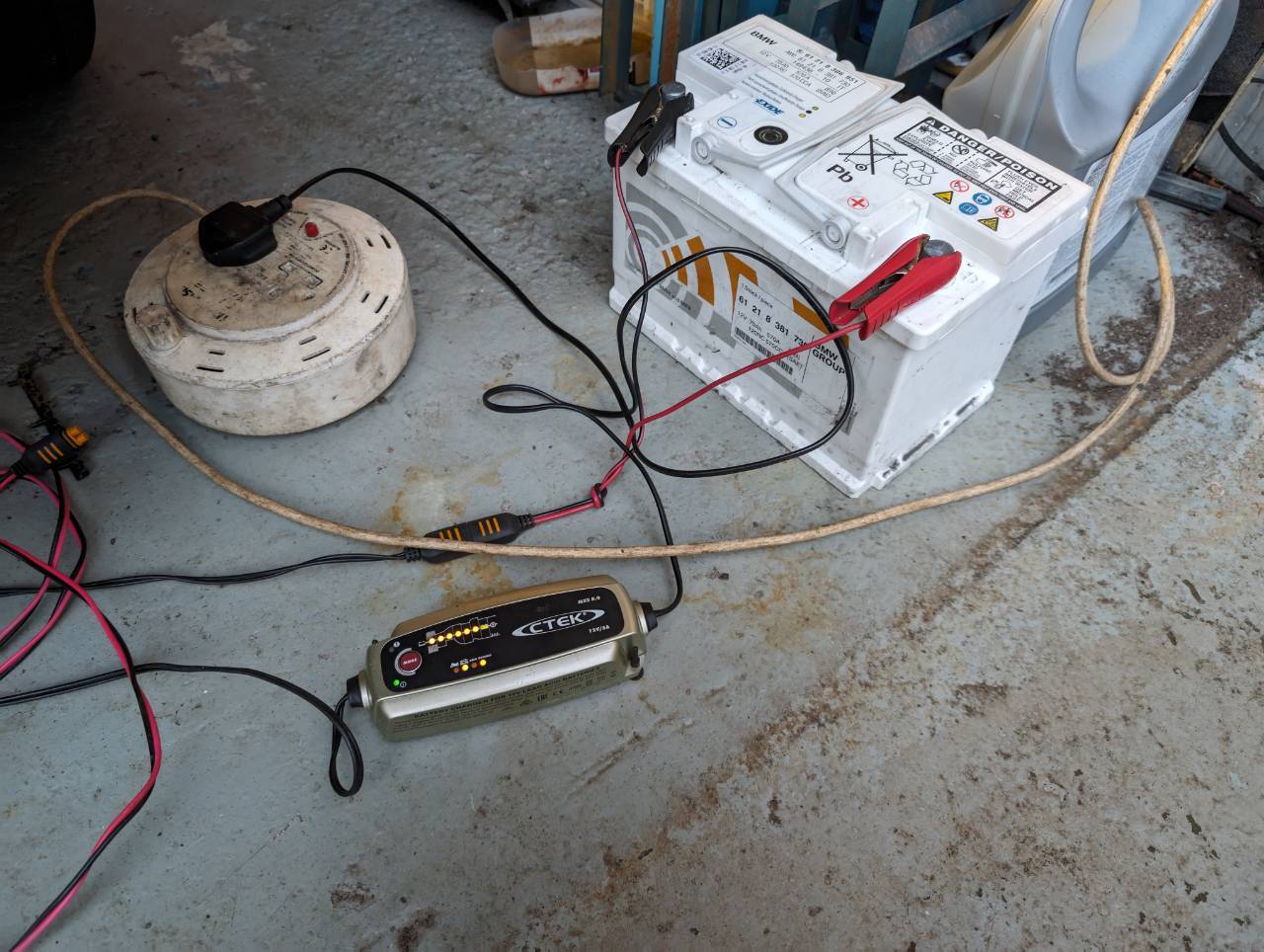

Unexciting update. I charged the 330i battery last week, it broke again so I had to fix it and drove both cars!
You're supposed to do charge it up using the points under the bonnet rather than directly on the battery in the boot. However those seemed to not play ball properly with my ctek and it's fast charge mode. It needs a charge as I'm getting the occasional battery low message on the iDrive if I've sat in the car for 15mins with the radio on but engine off.
So I removed the battery.
All this bollocks needed to be removed. Battery computer, fuse board and pyrotechnic disconnect.
Despite using this regularly and on some longer drives, I've found that the battery computer seems to only have got to 75% max charge in the time I've had it. I've had this before where a discharged battery takes a long time to get to full just by driving. Usually a charge only put a few tens of amps max in. Couple that with the power to start the engine and shutdown power from sitting, it doesn't always get a chance to fully charge.
Hence using a charger over the space of a few hours to properly charge this pack. I also think this battery is a bit on old side and lost some of its capacity.
A BMW "Value" battery ...
Once fully charged I put it all back together.

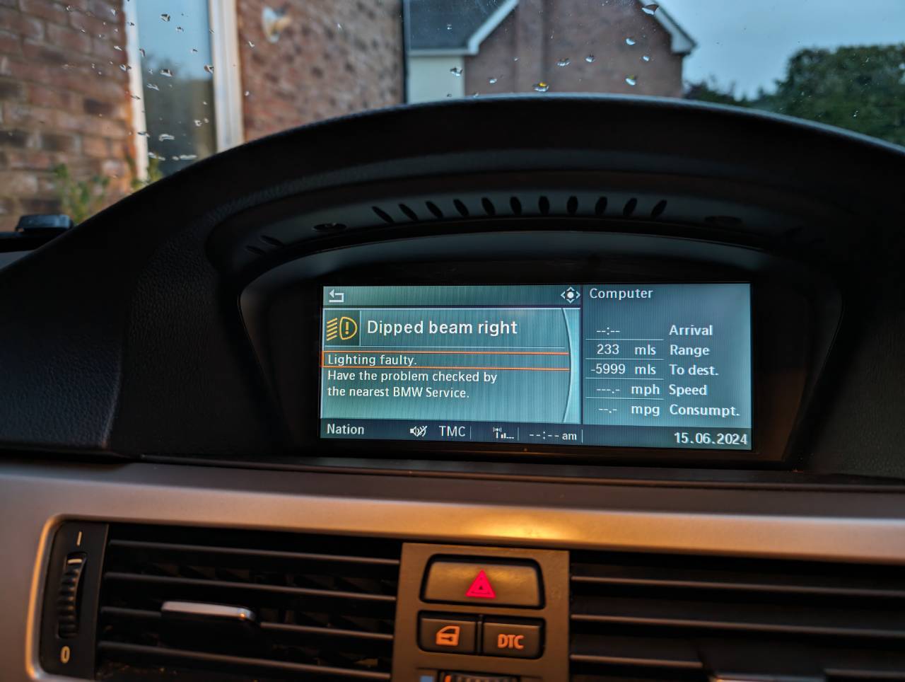

Turned the ignition on and heard the chime that modern BMW owners dread.
FFS. I only reconnected a battery. Yeah I know minor but this car really likes to test my patience.
New bulb for £4.50 from the local petrol station was acquired and fitted. While I usually like to go for Osram night breakers, I wanted to use the car the next day. I've also experienced when one bulb goes, another goes shortly after. Having two dipped beams out is really not ideal.
