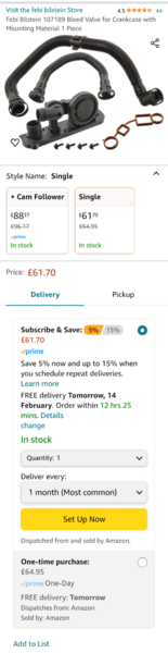

SiC Posted February 13, 2024 Author Posted February 13, 2024 Amazon offers the PCV setup as a Subscribe and Save option. Gives confidence that the most chosen option is a new one every month. 🤣 Carl1981, Cookiesouwest, GrumpiusMaximus and 3 others 6
