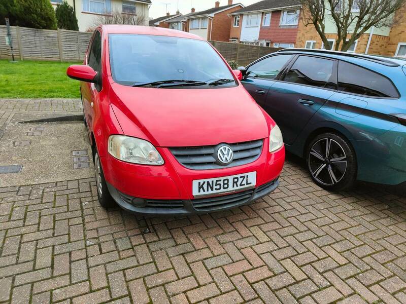

Sadly we've had our first falling out due to me leaving the interior light on!

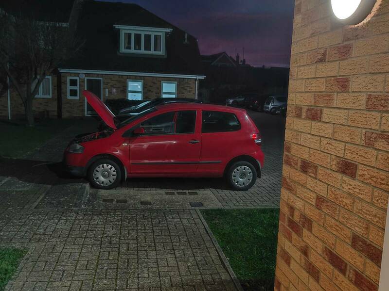

Got jump started by a neighbour but as I went to pull away.....
Oh.
I didn't want to turn it off, so soldiered on with really heavy steering. Turned it off on the A127 and did a rolling bump start and all is well now. 🤦‍♀️

So, is it electrical power steering or something? Battery low, therefore you can FRO?
The best cars fix themselves anyway. 😀
  • Agree 1
These are electric I’m sure, PAS pump is only accessible by removing the wing IIRC?
Totally different car but my wife's panda has electric steering and if it's sat for a week or more it will always start but will throw up the orange steering light. It's a common issue on the panda as the steering likes a fully charged battery. Light goes off after a few miles and stays off if the car is used regularly. If there's a genuine fault the steering light comes on red. Could be the same with the fox??
You say totally different car, but the patent is probably owned by TRW (now ZF ?).  Which came out of a project at Lucas Car Brakes Fen End near Solihull in the 90s.
Would think there could well be a battery issue.Scarlett,as she is now named,had very little use in recent times and if the battery had been flattened as well.I'd either give the battery a good  charging or just replace it, whichever was most convenient to do.Probably done more miles in the the last couple of days than in the last year! Regarding the steering electric hydraulic steering and electric steering are very different.Should be a good little car for Amelia.Not my place to mention money,but she shouldn't lose out on it if she needs to move it on when circumstances change for the better,ie another company car.
Is that 'apparently 73bhp' because you don't believe it? 😁
Anyway, following a flat or changed battery, turn the steering from full lock to full lock, that should recalibrate the sensor and switch the light off.

Probably just wanted a slug of juice into the battery, use it regularly and take it for the odd decent run and the steering should be OK. I had the same issue with the E-Pas in a Punto when the battery was dying.
At just over the tonne it's fairly heavy for such a small car so maybe that's why it doesn't feel especially sprightly with only 75bhp.
Most modern cars use some sort of can network for the various modules to communicate, an Epas system will take signals from the brake module (road speed) probably the engine control module (battery voltage) and steering wheel angle. When the car is turned on the modules wake up in a prescribed order such that they see all the signals they are expecting at the right time.  When you have a flat battery the car wakes up fine then when you crank it the voltage drops so low that a module may drop out this causes the others to throw faults.  As yours has they will often clear once they have seen a good signal for a period of time, if not disconnecting the battery, leaving it for 5 minutes then re-connecting (with the ignition off) will usually fix it.
