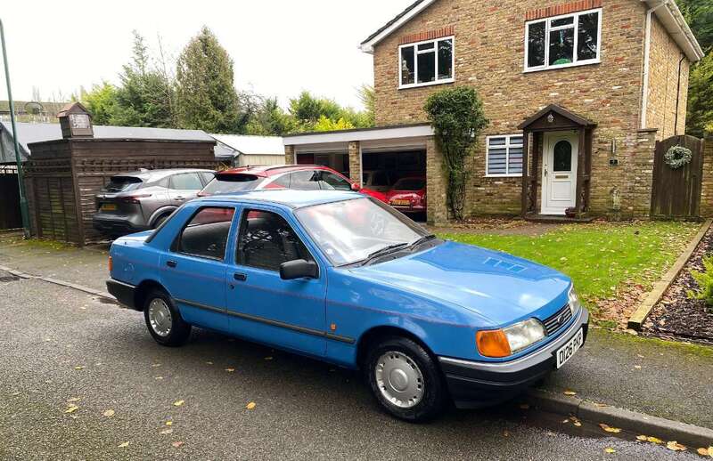

The first and only time that I washed the Sierra was the day it arrived, on the 30th January. Since then, I've cleaned it with a brush and rag to get the dust off it but after standing outside under the carport, exposed to moisture for a couple of months, it needed a deep clean.
It got one today.
Looking rather splendid again, the Sierra is now tucked away in the garage.

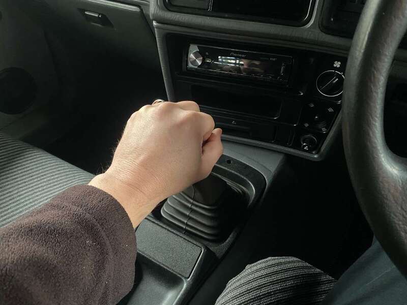

I wasn't happy with the 2nd to 3rd gearchange. If I held the gearstick like this and engaged third gear:
I could feel resistance and if engaged too quickly, a little crunch.
However, if I pushed the gearstick forward like this:
The change was a lot smoother.
Evidently, there was an issue with the selector mechanism. Some time ago, I removed the gearstick and put some washers between the top of the gearbox and the gearstick fixing plate, which lifted the base of the gearstick by a couple of millimetres from the selector mechanism.
I'm pretty sure that the gear selection was smoother but still not perfect. Today, I doubled up the washers.
I refitted the gearstick, all gears still engage fine but I won't find out whether this has improved the gearchange until I undertake a test drive, which I am planning on doing tomorrow.

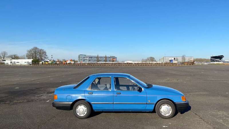

As planned, I’ve just completed a 48 mile drive to Silverstone.
The Sierra is an absolute joy to drive, it’s comfortable, quiet and gets down the road without fuss. The recently upgraded ICE, which I haven’t told you about, sounds amazing and makes trips like this more fun.
The gears are slotting in ok, I think that fitting the additional washers to lift the gearstick has made a difference.
The car park at the track is empty. If I was half my age I would probably take the opportunity to burn some rubber, not today.
