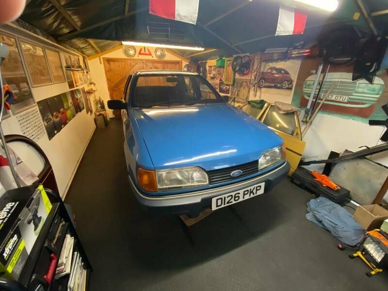

My G ref 1.6 pinto 'laser' no rev counter, no central locking ans very stingy spec
@stuboy
Love it! A proper Sierra. Apart from the facelift rear lights and wrong colour front indicators.

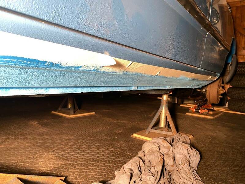

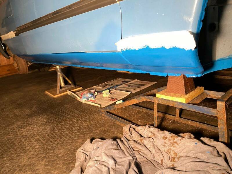

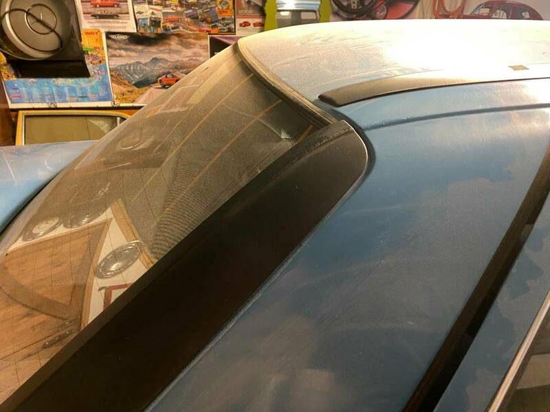

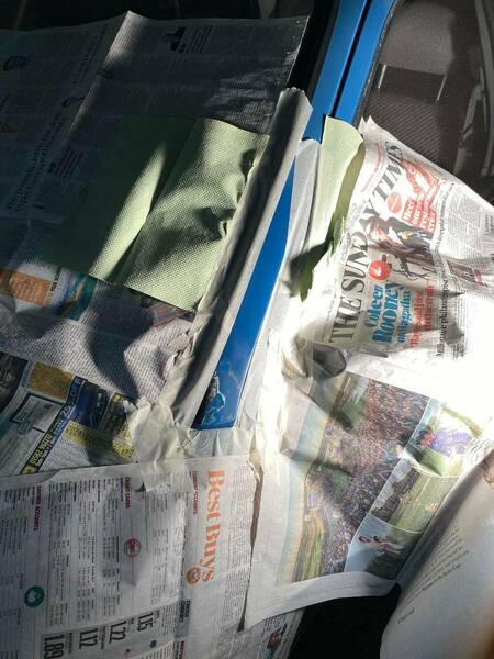

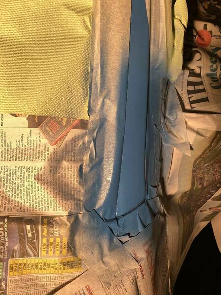

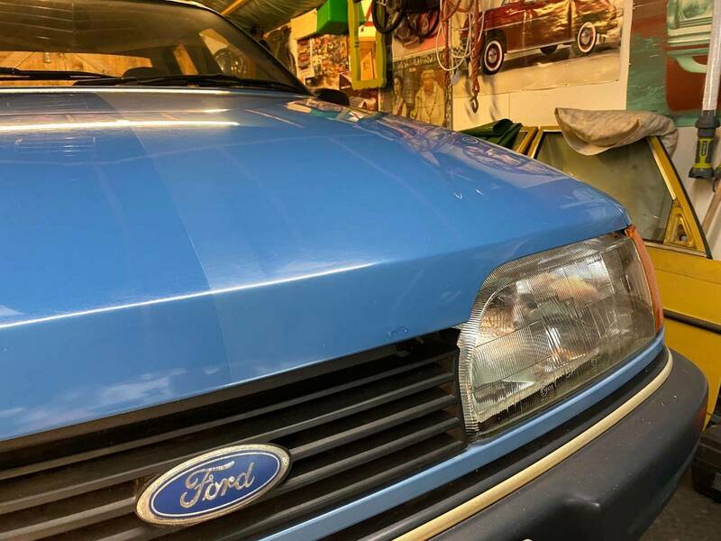

I made good progress with the bodywork repairs today.
I got the Sunday Times out again and had another go at spraying the windscreen pillars.

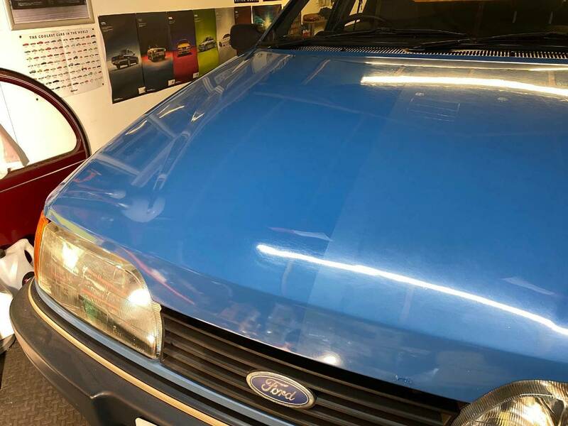

Success, this time no more chemical reactions. The paint match is approx 95% correct.

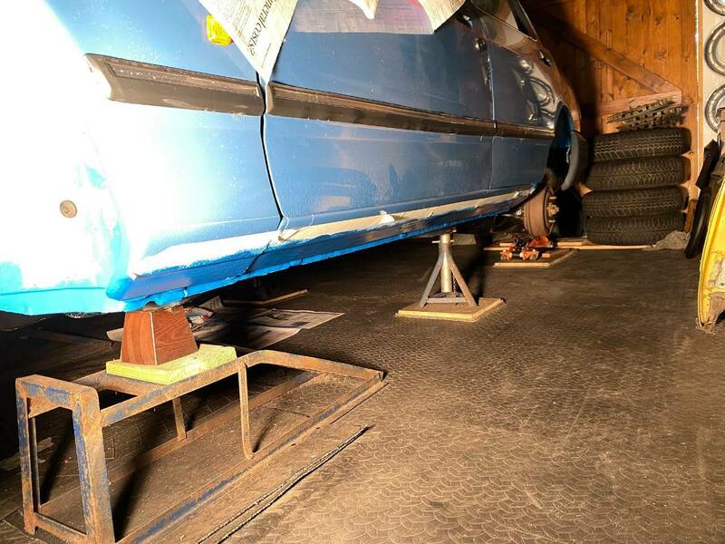

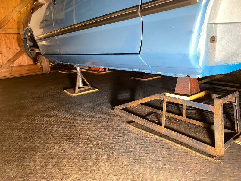

I had a third attempt at spraying the bottom of the offside rear door. This time everything went ok.

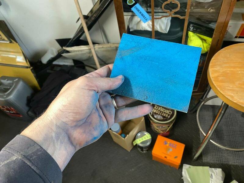

I used a 240 grade padded sand paper to take the shine off the sills. Messy business.
But a good result.
I painted both sills with the new paint I bought on Monday. The previous colour was too loud, it looked more turquoise than blue. This shade is darker than it should be but looks less offensive.
As previously advised, my iPhone's camera struggles to correctly present the original blue paint. The flood light doesn't help either. The paint match is actually a lot better.

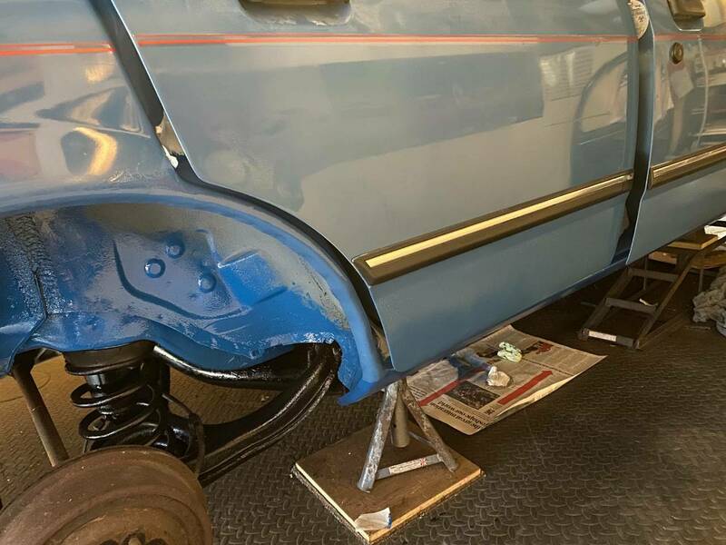

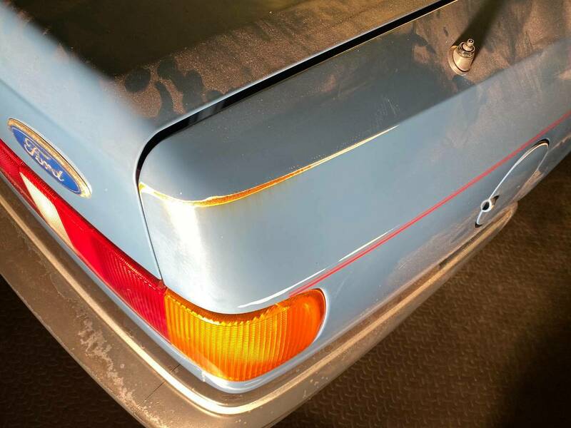

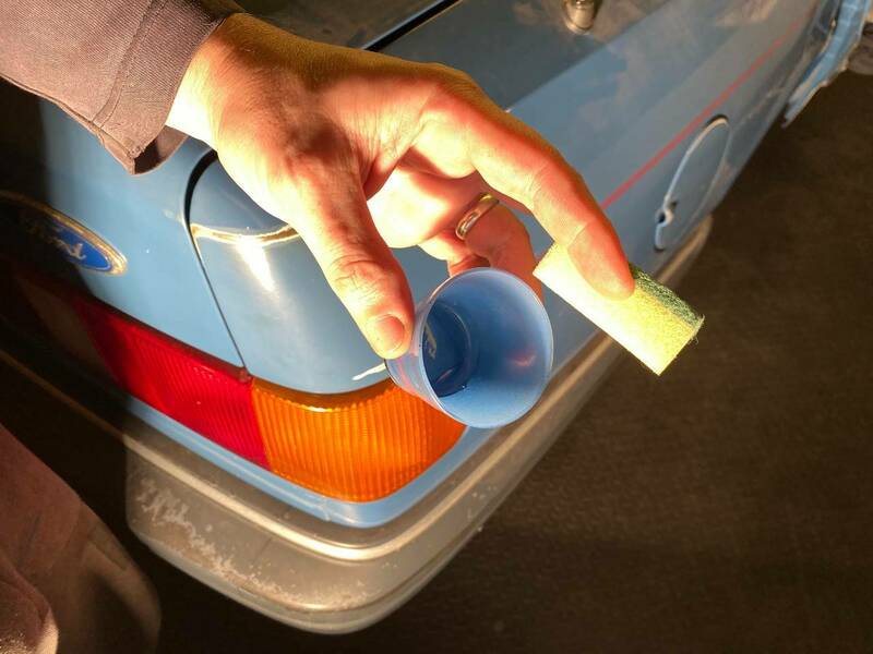

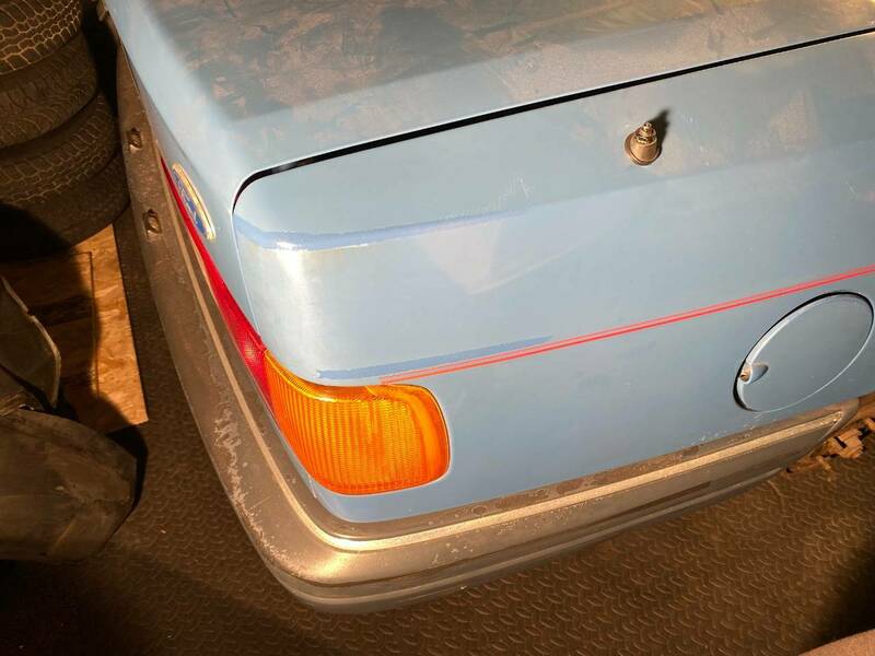

Next, I had to sort out these storage scars.
I rubbed down the corrosion down to fresh metal.
I masked up the scars to keep the repair patches as small as possible.
I then squirted blue aerosol paint into a pot and used a small sponge to dab multiple thin coats of paint over the masked off patches.
I did this wherever the paint was damaged.
With the masking paint removed, you can see where the paint was applied, however once cut back and polished, the repairs should look ok.

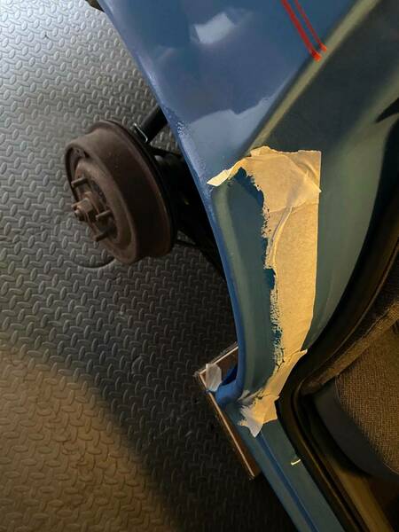

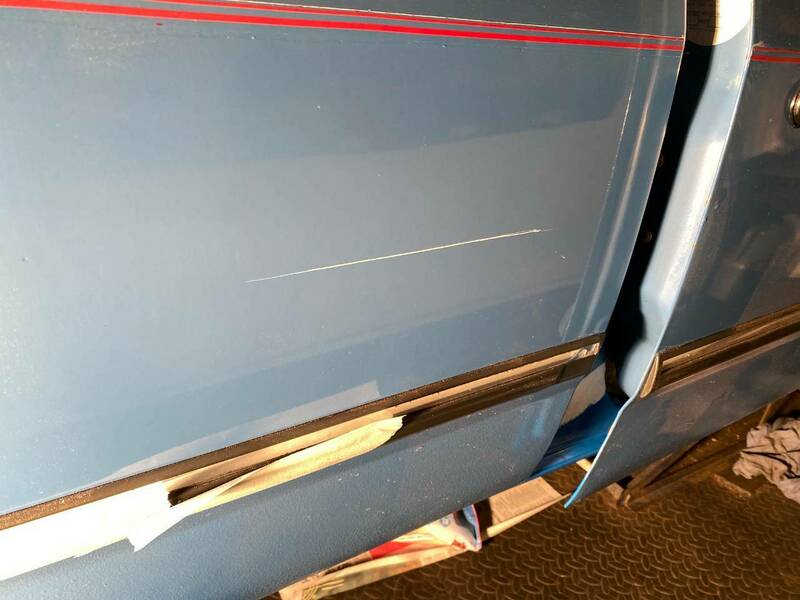

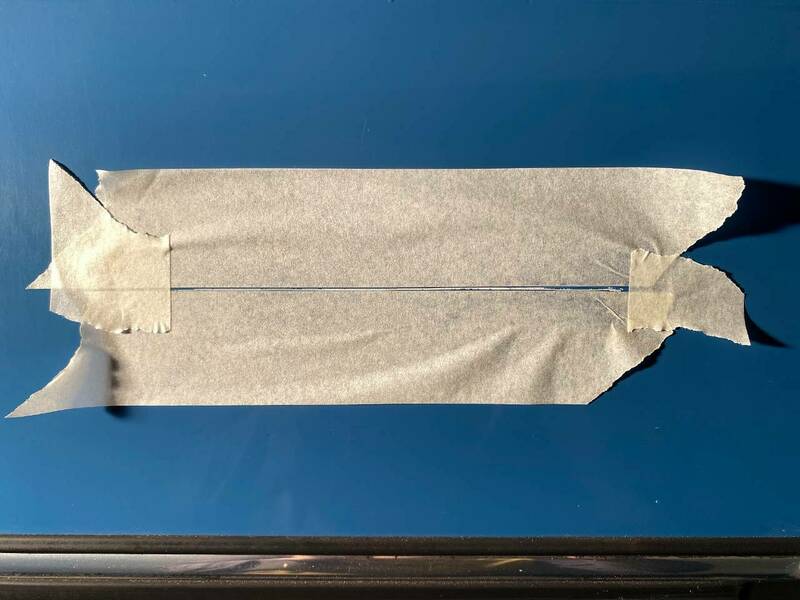

There was a deep scratch in the middle of the offside rear door.
I applied masking tape close to the edges of the scratch.
And applied numerous thin coats of aerosol paint.
With the masking tape removed, the scratch is almost invisible and will look better still once the paint is cut and polished.
The rear screen side plastic panels were also damaged during storage.
I dabbed some matt black paint onto the plastic. The paint was still wet when I took this photo.

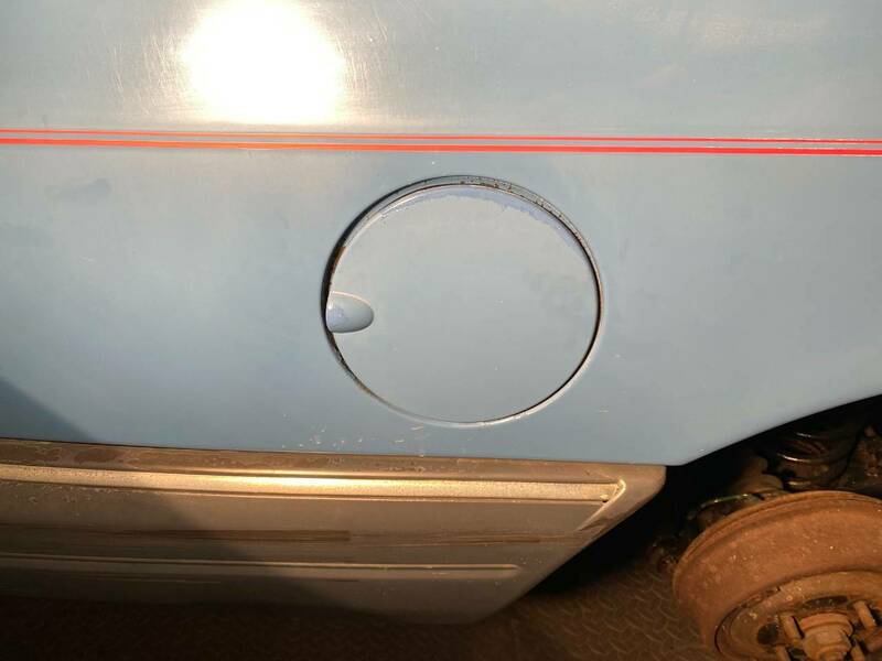

Last week I found out that acrylic primer and aerosol paint reacts with oil based paint and causes wrinkles and cracking. Today, by chance, I discovered that dabbing the blue aerosol paint over the oil based paint that was applied 3 hours earlier, without using primer, does not cause any problems. Very odd. I dabbed paint over the offside rear arch, which now looks a lot better.

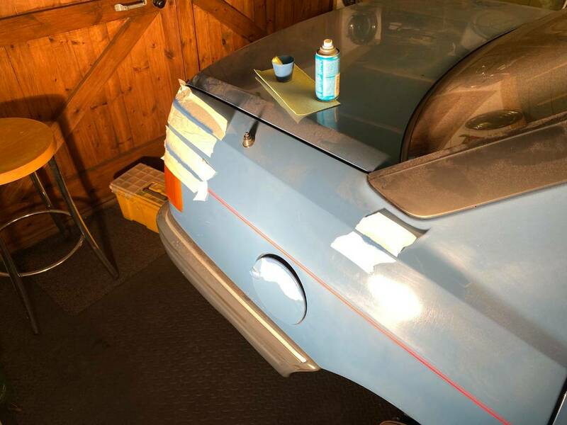

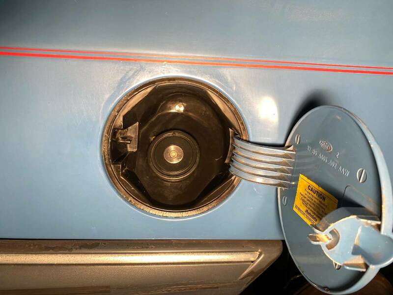

The fuel filler panel seal was covered with blue overspray.
Five minutes with a stanley blade got the old paint off. Much better.

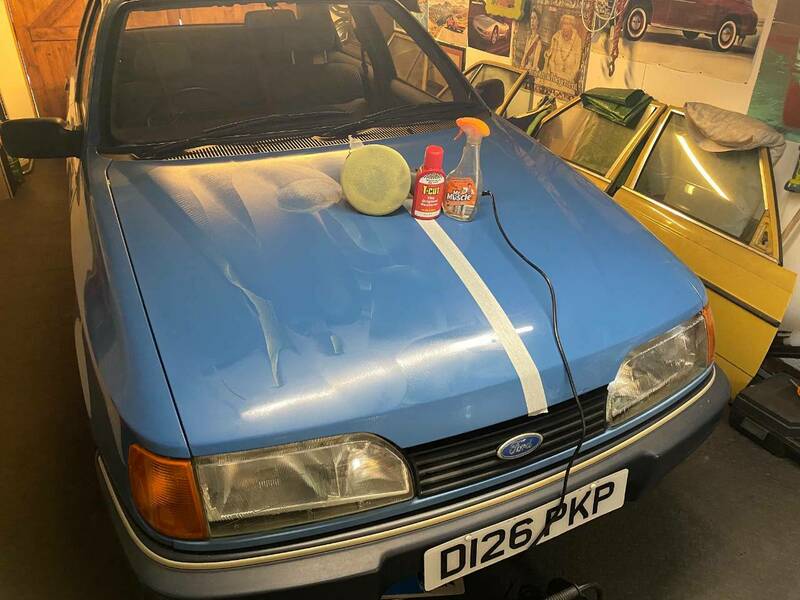

I will leave the paint repairs to dry overnight and tomorrow I am getting busy with this stuff.
I hope the paint will respond well to a good cut and polish.

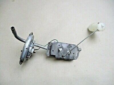

The fuel gauge is reading way too high, I think.
The sender unit looks like this.
Aa the boot floor doesn’t feature any access hatches, it looks like the only way to get to the sender unit is to drop the fuel tank, which could be a world of pain.
I’m not going to bother doing this for now. Once I start using the Sierra, I will know more about the fuel gauge’s behaviour and chances are that a few full to empty tanks may wake up the sender unit.
9 hours ago, GagaStan said:
Would there be access under the rear seat base?
I'm not sure that the fuel tank extends under the rear seat, it's located towards the rear of the car, under the luggage compartment.
  • Agree 1
  • Peter C changed the title to 1987 Ford Sierra Sapphire 1.8L - Shiny but still a bit scratchy - see page 17
It does not extend under the rear seat.  You're right that you have to drop the tank to access the sender.  There are three screws that go through clips.  It isn't that bad but certainly one to avoid without good reason.  I think people sometimes used to make a hole in the floor to access but probably best avoided especially on such a clean car.
Petrol tanks.  I fitted a new one to my Sierra and patiently painted the outside.  The inside was bare steel and went unbelievably rusty very very fast.  I replaced it (again!) and used an expensive tank sealant on it.  This seemed a bit mad, but I reckon it was the right thing to do.  The tank sealant sticks really well to the fresh metal.
Just sharing this as it was so painful finding a newish tank basically full of rust so I don't want you or anyone else to end up the same way.  Not that you've mentioned any problems with the tank.

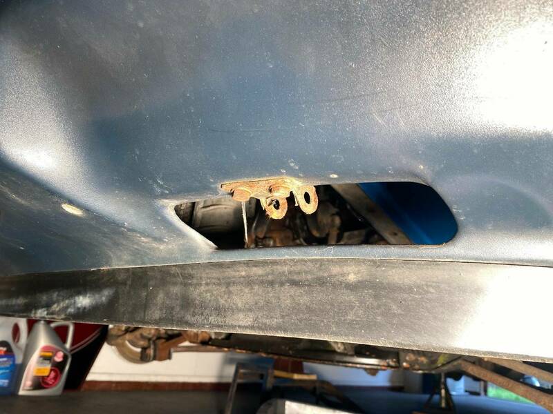

I wanted to remove the redundant front fog light brackets.
I, incorrectly, assumed that undoing the two nuts and bolts would enable me to remove each bracket. Yes and no. The bracket also forms part of the bumper support, which is fixed to the chassis above. In the end, I just bent back the parts of the bracket that secure the fog light.

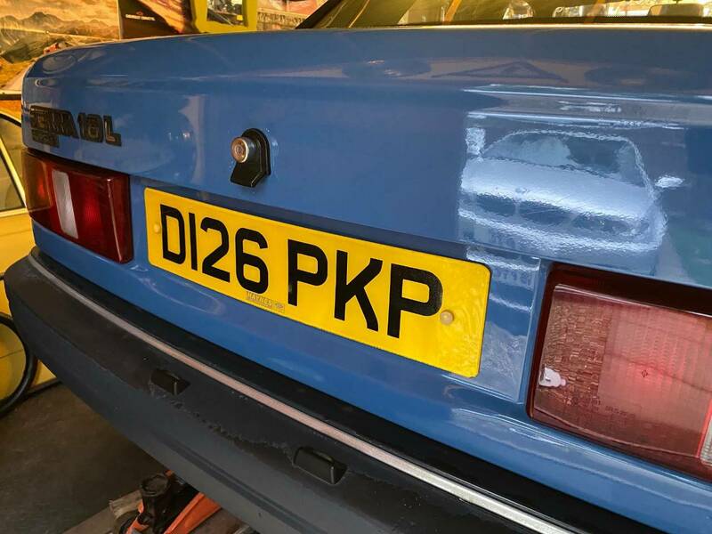

Next, was a simple job of refixing the rear number plate. Or so I thought. Turns out, whoever fitted the replacement number plate drilled two new fixing holes in the rear panel and the one on the right side is located exactly where the jack abuts the inner side of the panel. This explains why the screw that I removed was angled at 45 degrees. I put it back as it was for now but to sort this out properly, I need another rear number plate.
Note the reflection in the boot lid of the E46 parked outside.

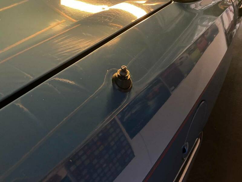

I re-fixed the non-factory aerial. It fits ok but to make it fit, the mast leans towards the front of the car. I might have another go at aligning it but ideally I would like to source a Ford factory aerial.

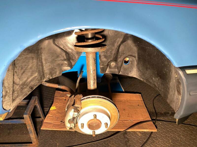

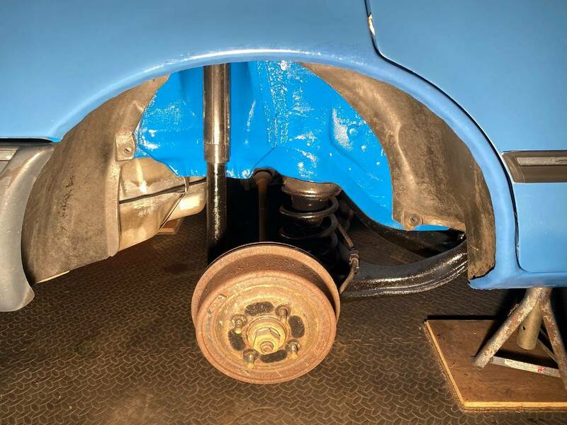

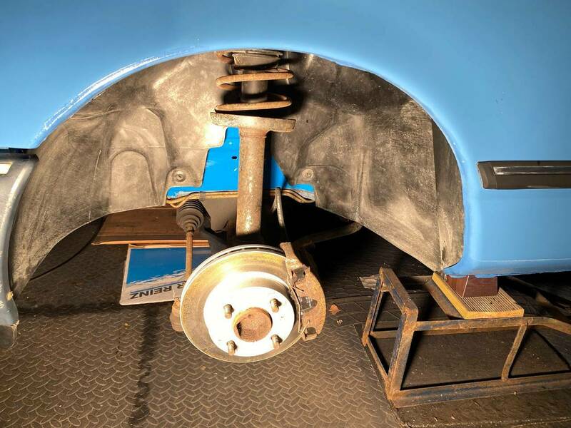

As the paint in and around the arches was now dry, I wanted to replace the arch liners.
I spent a fair bit of time cleaning them and removing overspray but they still look shit. I cleaned the front ones with a pressure washer, a stiff brush and soapy water and with neat paraffin to remove the overspray. I am not happy with how they turned out. I know that they won't be visible with the wheels back on but that's no excuse to leave them looking dirty.
Any ideas what else I can try to make them look cleaner? I don't want to paint them as the paint will flake as the wheels kick up stones etc.
All being well, I will respray the front and rear bumpers this weekend.
5 minutes ago, Rod/b said:
Hot air gun treatment on the arch liners?
Won’t get the dirt off.
9 minutes ago, Hertz said:
Back to Black or similar?
That would cover up the dirt and attract dust.
My wife has suggested a 50/50 water and vinegar mix to get the dirt off.
Hot water, fairy liquid, green scouring pad, elbow grease.
22 minutes ago, cort1977 said:
green scouring pad
Scratchy scratchy!
