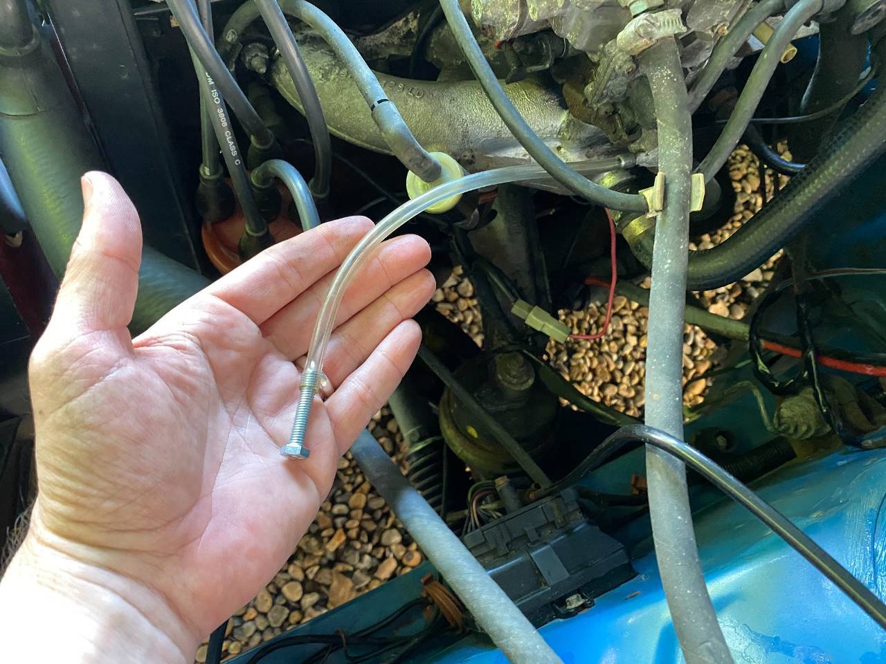

Peter C Posted May 19, 2024 Author Posted May 19, 2024 Went out for a 50 mile drive in the Sierra today. New problem, smell of petrol from the engine bay. Windows up, driving along, no smells inside, wind the window down and I can smell fuel. I’ve parked the Sierra up half an hour ago and I can still smell it. But no sign of any leaks! Any idea what this does? It looks fuel related. The Sierra is now living outside, under the car port. And the E46 is back in the garage. rm36house, RayMK, mercedade and 3 others 6
lisbon_road Posted May 19, 2024 Posted May 19, 2024 20 hours ago, Peter C said: Pretty much and possibly not a good investment for Ford. By 1993, Sierras were very old fashioned and with the Mondeo launch just around the corner, why did they bother? Because cars like a Sierra are made in such huge volumes that the cost of tooling is easily lost in maintaining sales. And I'm convinced that hatch and saloon rear lights are different. Peter C 1
egg Posted May 19, 2024 Posted May 19, 2024 12 minutes ago, Peter C said: Any idea what this does? It looks fuel related. one of these? https://www.ebay.co.uk/itm/274843390347 edit: would make sense if a fuel vapour system is leaking to have fuel smells... Peter C 1

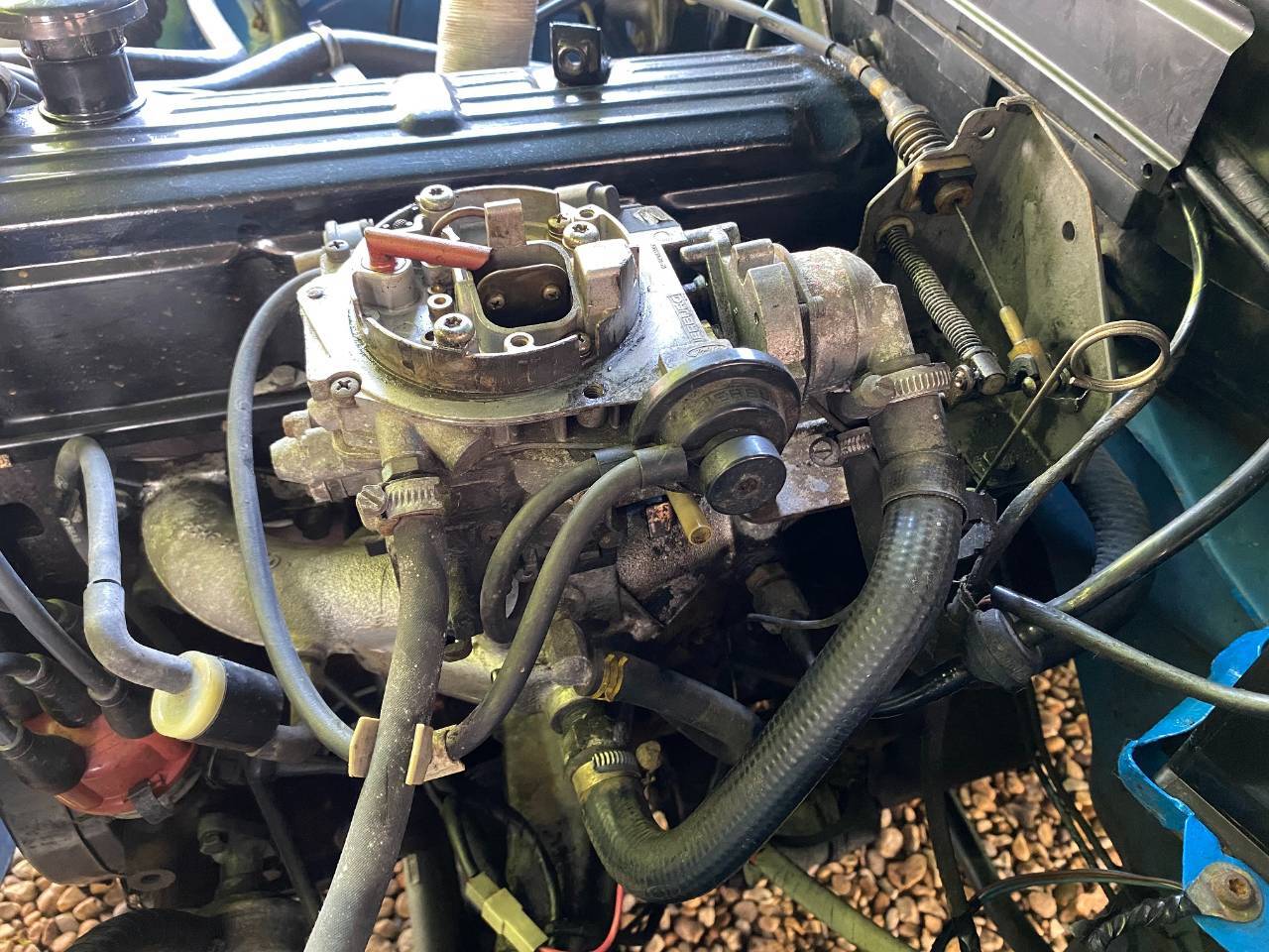

Peter C Posted May 20, 2024 Author Posted May 20, 2024 It was time for some alfresco tinkering today. I wanted to investigate the fuel smell issue that I noticed yesterday. I removed the air filter housing, which revealed bugger all, the carb looks fine to me, unless I'm missing something? To enable the engine to idle, I blocked this small inlet pipe, which would usually mate with a small hose that extends from the air filter housing. I ran the engine for ten minutes, all good, no sign of any leaks. The only fuel smell that I noticed was coming from inside the carb, via the inlet port, which I presume is quite normal. There are definitely no fuel leaks anywhere around the carb or the fuel pump. I thought that the air filter housing may not be on securely enough, as it is only held on with two out of the three original bolts. The third bolt has snapped and remains inside the thread at the side of the carb. It can stay there, I am not drilling into the carb! Anyway, with the two fixing bolts that secure the top of the air filter housing and the side bolt securely fixed, the air filter housing is definitely not loose to the point where fuel vapour could be escaping from where the air filter housing locates on top of the carb. An inspection of the underside of the air filter housing cover revealed that the cracked / damaged part of the cover is located directly above the carb inlet port. Whilst my repair was of sufficient quality to disguise the missing chunk of plastic on the outside of the cover, I suspect it is not sufficiently robust to prevent fuel vapour from escaping. I fashioned this repair. I thought about using chemical metal or wob to seal the underside of the cover, however neither is flexible when set and I don't want a solid chunk of something dropping directly into the carb, so I used flexible sealant, which I covered with a piece of plastic, secured with the same three screws that keep the outside bodge in place, albeit made stronger by introduction of three metal securing tabs. Not pretty but hopefully sufficiently well done to prevent fuel vapour from escaping from inside the air filter housing. On the upper side, some of the sealant escaped via gaps between the broken cover and my bodged piece of black plastic, which is probably a good thing. I'm not sure whether I have fixed the problem but I reckon I have sorted out at least one. Morris 63, Mrcento, Popsicle and 3 others 6
Zelandeth Posted May 20, 2024 Posted May 20, 2024 I'll check my preferred motor factor for lights next time I'm there. I know they have a couple of Mk IV Escort front indicators sitting on a top shelf, next to a radiator that I'm bloody sure I recognise every time I see it but can never quite pin down what it's from. Fuel smell I'd be pointing at breather issues most likely, especially with the weather having gone warmer. I doubt sealing of the air filter housing will make a huge difference. If that were mine I'd put a blob of sealant on the clips inside too, that gives me the fear of one vibrating itself loose and getting ingested by the engine. It will be absolutely fine, but it would worry me nevertheless! Peter C 1
junkyarddog Posted May 20, 2024 Posted May 20, 2024 37 minutes ago, Zelandeth said: one vibrating itself loose and getting ingested by the engine. That's exactly what I thought too. Peter C 1
Peter C Posted May 20, 2024 Author Posted May 20, 2024 1 hour ago, Zelandeth said: breather issues Has crossed my mind but I can’t see anything that could be the issue. I’m going to study the Haynes manual that I bought last weekend for some hints and tips.
