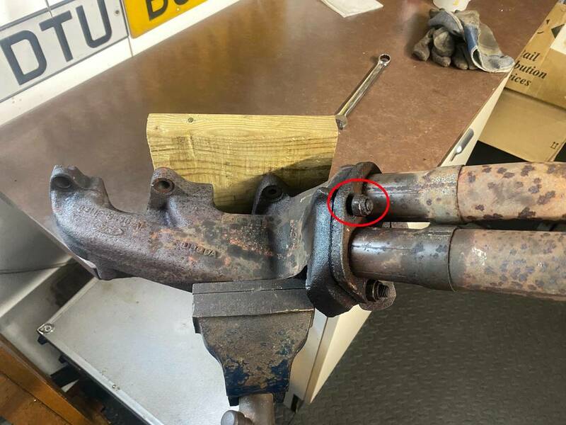

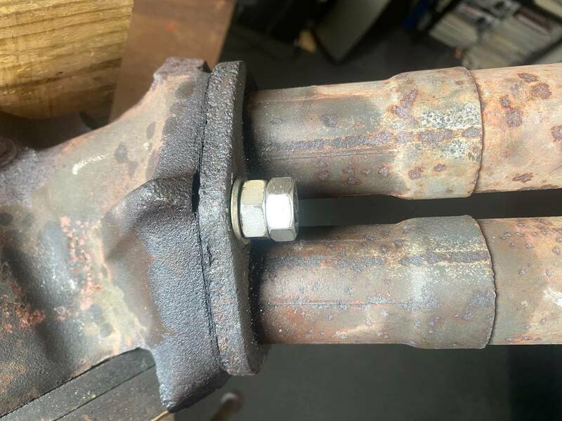

Peter C Posted February 1, 2024 Author Posted February 1, 2024 The WD40 had no effect on the seized nut. I decided to take advice from our resident experts and grind the nut off the bolt. I clamped the manifold in a vice, it's always good to have a safe and comfortable working environment when working with abrasive tools. Using an angle grinder, I reduced the size of the nut up to the point where the remaining metal got thin. Out came a more precision tool. More of the same but now with finesse. I got enough of the nut off to enable removal without causing significant damage to the bolt thread. I fitted a couple of right sized nuts, job done. As I tightened the new nuts, I could see the joint getting narrower. I made sure the new nuts were tight without overtightening, breaking the bolt and fucking up all my hard work. I fired up the unsilenced Pinto (the exhaust system has been removed). Amazing how an OHC Ford four banger can sound like a top fuel dragster. Despite the deafening noise coming from the end of the downpipe, I couldn't hear or feel any blowing from the manifold to downpipe joint. Win. I'm off to order a new exhaust. In other news, the V5 arrived today. I now three pieces of paper in the service history. The seller apparently posted the service history documents yesterday. All being well, I will get them by the end of the week. I have SORNed the Sierra as of today. Christine, djim, Coprolalia and 44 others 47

garbaldy Posted February 1, 2024 Posted February 1, 2024 2 hours ago, Peter C said: I couldn't hear or feel any blowing from the manifold to downpipe joint. Win I'd be amazed if that lasts as the blow would have eaten away at the gasket, personally I would replace the gasket as your well into it now. bunglebus 1
kevins Posted February 1, 2024 Posted February 1, 2024 If it comes to it you should be able to get couple of aftermarket mufflers anx clamp them into your existing pipes. Peter C 1
Peter C Posted February 1, 2024 Author Posted February 1, 2024 3 minutes ago, garbaldy said: I'd be amazed if that lasts as the blow would have eaten away at the gasket, personally I would replace the gasket as your well into it now. That would involve grinding off the other four nuts, which is not an experience that I want to repeat anytime soon. If the repair lasts, great. If it starts to blow again, I will take further action. Removing the manifold and downpipe is a piece of piss. djim 1

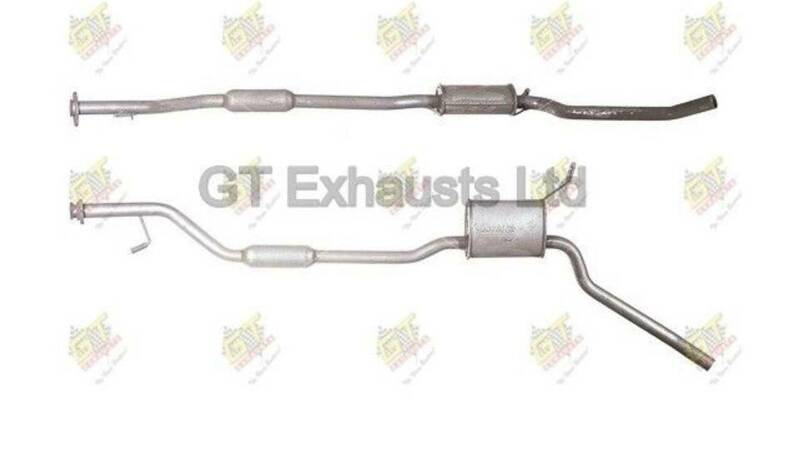

Peter C Posted February 2, 2024 Author Posted February 2, 2024 I have found an exhaust supplier based in Northern Ireland (how lucky!) via eBay that has both exhaust sections in stock. This is my exhaust: This is the new tail section: And the new central section: I'm £150 lighter but if both fit, then that's one less thing to worry about. I wonder whether it's worth keeping the old exhaust. Most of it is in great condition and with a couple of patches, it could last for another few years. The service history hasn't arrived yet but it's only been two days since the seller allegedly posted it. Maybe tomorrow.... Coprolalia, Sunny Jim, Burnside and 7 others 10
jim89 Posted February 2, 2024 Posted February 2, 2024 2 minutes ago, Peter C said: I have found an exhaust supplier based in Northern Ireland (how lucky!) via eBay that has both exhaust sections in stock. This is my exhaust: This is the new tail section: And the new central section: I'm £150 lighter but if both fit, then that's one less thing to worry about. I wonder whether it's worth keeping the old exhaust. Most of it is in great condition and with a couple of patches, it could last for another few years. The service history hasn't arrived yet but it's only been two days since the seller allegedly posted it. Maybe tomorrow.... Even to my amateur shiter eyes those new exhaust pics look very promising Peter C 1
Dobloseven Posted February 2, 2024 Posted February 2, 2024 Seems you're thinking the same way I would.Everything you're doing at the moment is going towards making it a usable vehicle.Get it running nicely,use it, plenty of MOT left,get the feel of it and decide what's next.Bodywork wise,that screen pillar would concern me.Wouldn't start poking it till I'd fell in love with the car and decided how far I wanted to go with it though.
BorniteIdentity Posted February 2, 2024 Posted February 2, 2024 That exhaust looks almost identical to the full length that I bought for my 1600 pinto hatch. Near enough that, in future, someone would be able to make it work. £150 is fair enough, I think I paid about £120 for mid and tail. Still haven't put it on mind, I'm saving it for best! Peter C 1
