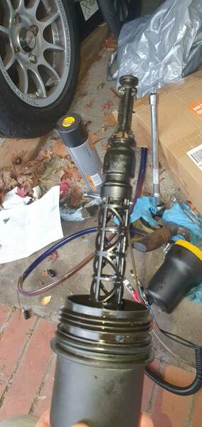

wesacosa Posted January 14, 2024 Author Posted January 14, 2024 I'm starting to think this car doesn't like me I wanted to tick the final scheduled job off the list today by doing the oil and filter change having replaced the other VCT magnet yesterday. Easy job, yes. well no actually. This is what the oil filter carrier is supposed to look like this is what it actually looks like with the rest of it well and truly wedged down here its quite brittle plastic so can't seem to get enough purchase on it with long nose pliers without risk of cracking it Grr
SiC Posted January 14, 2024 Posted January 14, 2024 Perhaps cracking it might be the way of getting it out? It's going to have to be a replacement job by the looks of it anyway.
wesacosa Posted January 14, 2024 Author Posted January 14, 2024 im worried about cracking the top part off and giving me nothing to then pull the rest out if its still stuck
SiC Posted January 14, 2024 Posted January 14, 2024 If that happens then could always go medieval with a screwdriver and crack the remains down in there. Then use a wet vac hover or similar to remove the remnants. Is it possible to unbolt the oil filter assembly or is it part of the block? Would risk less contamination if it could be removed to be worked on. wesacosa 1
SiC Posted January 14, 2024 Posted January 14, 2024 I imagine it's the o-rings that are grabbing and stopping it begin removed. Can you get you fingers down there and try twisting it out? Might break the bond of the rubber/plastic and metal. Also fingers are a bit more gentle than pliers. wesacosa 1
SiC Posted January 14, 2024 Posted January 14, 2024 At least if it goes completely tits up, the complete housing can be had pretty cheaply. Even if it means more expense. https://www.ebay.co.uk/itm/256347478207 (I put a new o-ring on that though) I think there is a Febi new for about £90 from a quick search. wesacosa 1
wesacosa Posted January 14, 2024 Author Posted January 14, 2024 well a stroke of luck I removed all the oil in the housing with my oil pump and the set of long nose long handled pliers I needed for the vac hose job had a 90 degrees one which fitted perfectly under the shoulder of the stuck bit. It came out in one piece and wasn't actually broken, I guess the lower o ring had stuck and the two parts unclipped from eachother instead of pulling out in one bit Pat Earrings, Rust Collector, Coprolalia and 6 others 9
Back_For_More Posted January 14, 2024 Posted January 14, 2024 So you'll replace it...... Or do the same again next service?
wesacosa Posted January 14, 2024 Author Posted January 14, 2024 17 minutes ago, Back_For_More said: So you'll replace it...... Or do the same again next service? it seemed ok so I just did the O rings this time and tried again. I suspect that next time if I twist the housing before pulling it then it might not get stuck . The two parts are clipped together so nothing has actually broken it just unclipped itself N Dentressangle, rob88h and Pat Earrings 3

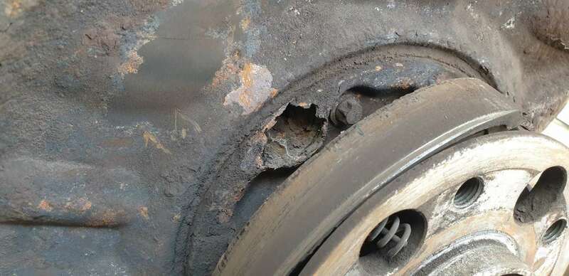

wesacosa Posted February 19, 2024 Author Posted February 19, 2024 still no milf or abs lights so calling that a win the vct jumper harness from @Stankynever was found by Mr Postman so I had to bite the bullet and pay the extortionate price for a new one, which given its there to rectifying a poor design in the first place is a bit galling In exciting new news its developed a horrible scraping sound The backplate has seen better days so assuming its that. They are a bastard to change though but think there is a cheat involving cutting and shutting the new one, although could be handbrake shoes if im unlucky I also need to investigate the high frequency bearing type noise at idle too which seems to be coming from the alternator/supercharger area of the belt. worse cold and disappears with slight rev increase
Stanky Posted February 19, 2024 Posted February 19, 2024 Re scraping noise, on mine it was the pin that held the handbrake shoes in position has pulled out of the backplate and allowed one of the handbrake shoes to flop and rub on the inner surface of the disc - take the back wheel off, lift the caliper out and pull the disc off and you'll see what I mean. It sounds serious but is easily rectified. You can replace the backplate, or just refit the sprung pin into a different place in the slot in the backplate. The scraping noise is probabaly the sprung pin that has fallen out and is jammed into the lower one and scraping the inner edge of the disc, like this If you do replace the backplate then cut & shut, doing it 'properly' will require a shitload more work as you need to take the hub off, bearing out and allsorts and is a giant faff. I think @Talbot used the cut and fit approach on his W210 and then welded the cut back up just for completeness? Talbot and wesacosa 1 1
wesacosa Posted February 19, 2024 Author Posted February 19, 2024 thanks. yeah just chatting to a mate who had something similar. He went for the cut and shut with pop rivets but someone on YouTube just partially cuts it then silicones the joint
Supernaut Posted February 19, 2024 Posted February 19, 2024 I recently did the back plates on my BMW with a very similar parking brake. I cut out the segment that goes behind the caliper and just bashed it on. Yes, I'm a farmer. How could you tell? wesacosa and yes oui si 2
Talbot Posted February 19, 2024 Posted February 19, 2024 1 hour ago, Stanky said: Re scraping noise, on mine it was the pin that held the handbrake shoes in position has pulled out of the backplate and allowed one of the handbrake shoes to flop and rub on the inner surface of the disc - take the back wheel off, lift the caliper out and pull the disc off and you'll see what I mean. It sounds serious but is easily rectified. You can replace the backplate, or just refit the sprung pin into a different place in the slot in the backplate. The scraping noise is probabaly the sprung pin that has fallen out and is jammed into the lower one and scraping the inner edge of the disc, like this If you do replace the backplate then cut & shut, doing it 'properly' will require a shitload more work as you need to take the hub off, bearing out and allsorts and is a giant faff. I think @Talbot used the cut and fit approach on his W210 and then welded the cut back up just for completeness? I did indeed do the Pacman cut and then reweld them back together, but not on the 210, it was on the 203 that I sold to @chaseracer. The rear backplates were absolutely rotten on this, and although doing a cut-and-weld is a bit of a bodge, it's a lot less of a bodge than either siliconing them back together, or bodging them in some other non-electric-glue method. I'd do the same again.. Fitting them "properly" means splitting the rear wheel bearings, which I believe needs a special tool. Rotten backplates, allowing the shoes to run on the inside face of the "drum", which sounded AWFUL. Fixed: wesacosa, Stanky, beko1987 and 2 others 3 2

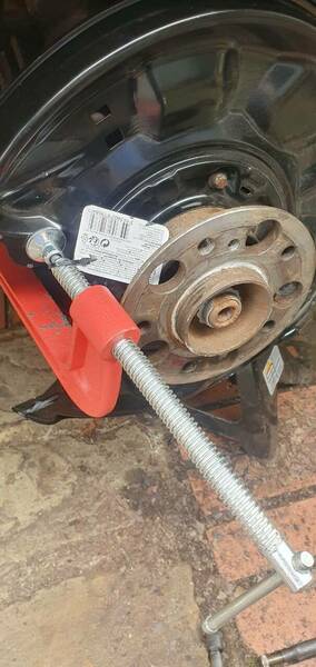

wesacosa Posted February 19, 2024 Author Posted February 19, 2024 thanks. I took the disc off this afternoon and it is indeed as suspected, plates rotted and springs snapped for good measure Sadly I can't weld so will have to try maybe some pop rivets and JB weld
Talbot Posted February 19, 2024 Posted February 19, 2024 the trick is to not cut all the way through. on the extreme left of the backplate as shown, it was not cut through. You make sure there are two bolts in each half, and if you're going to pop-rivet a repair back together, make sure you've worked out which bits of the backplate the brake shoes sit against, and avoid that bit (IE go for a non-functional surface of the backplate) wesacosa 1

wesacosa Posted March 3, 2024 Author Posted March 3, 2024 a mixture of waiting for parts, illness and shite weather meant I have only got around to starting the backplate job today given its been over 2 weeks without a car and I can't weld I went for the cut n shut and JB weld method with the thought that if it goes to shit I can look at maybe having it welded later can't say im too pleased with it so far. I think strength wise for the shoes it should be ok but the joint at the calliper ended doesn't look great so pretty sure its going to snag on the disk. will see what happens when the JB weld dries but not holding out much hope.
wesacosa Posted March 3, 2024 Author Posted March 3, 2024 seems like some of the mismatch was because I had the caliper resting behind it stopping it sitting flush. doh that said still not a great fit. Because I was rushing it I blindly followed a man on the internet where he made the cuts but he cut under the shoe footprint rather than outside it for some reason which I subsequently noticed. DOH. Lesson learned about using brain and not just half heartedly following Hoping once the shoes are fixed in and JB weld cured it might actually keep it all pushed together.....
wesacosa Posted March 3, 2024 Author Posted March 3, 2024 all back together. horrible noise gone but there is a small bit of scraping especially when turning so need to do some bending or snipping rob88h, SiC and Rust Collector 3
