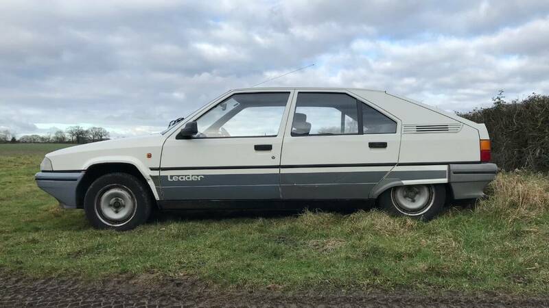

rob88h Posted February 23, 2024 Author Posted February 23, 2024 I never updated here. I think it was probably a sticking ride height corrector that put the rear into service height on the move. That or something to do with being packed up with luggage for Christmas with a full tank of fuel combined with the ride height levelling. It did it twice while I was away, but it was always corrected by cycling modes. I was then using it daily for a bit (and I took it on a longer trip to a LR trialling day hence it being parked in a field in the above photo – great fun, I was borrowing a friends Series LandRover and even managed a clear stage!) Since then, my Volvo has come back from the body shop and I’ve been using The Leader a lot less which is sad. I’m doing some servicing then hoping to take it to Rustival in a few weeks. stuboy, richardmorris, fatharris and 11 others 14
fatharris Posted February 24, 2024 Posted February 24, 2024 Big fan of the BX, and fair play, that welding is practically invisible on the arch!
