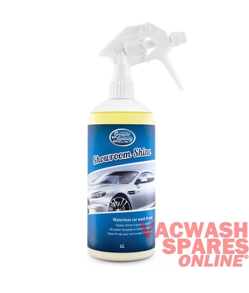

I use this on the Cortina, it works and leaves a really good shine. Found two bottles in my late Aunt’s garage, haven’t actually bought any:
IMG_5031.jpeg.0b33c4d6e4ea84a059669622edadc67d.jpegk
I've used Williams Racing wash and wax to good effect. No use on a properly dirty car, but storage dust and the general grime picked up by summer driving should be fine.
Both of these products are unfortunately not available in Norway and getting them shipped from the UK will be expensive so I will have to find something else but at least now I know what type of product I should be looking for.
