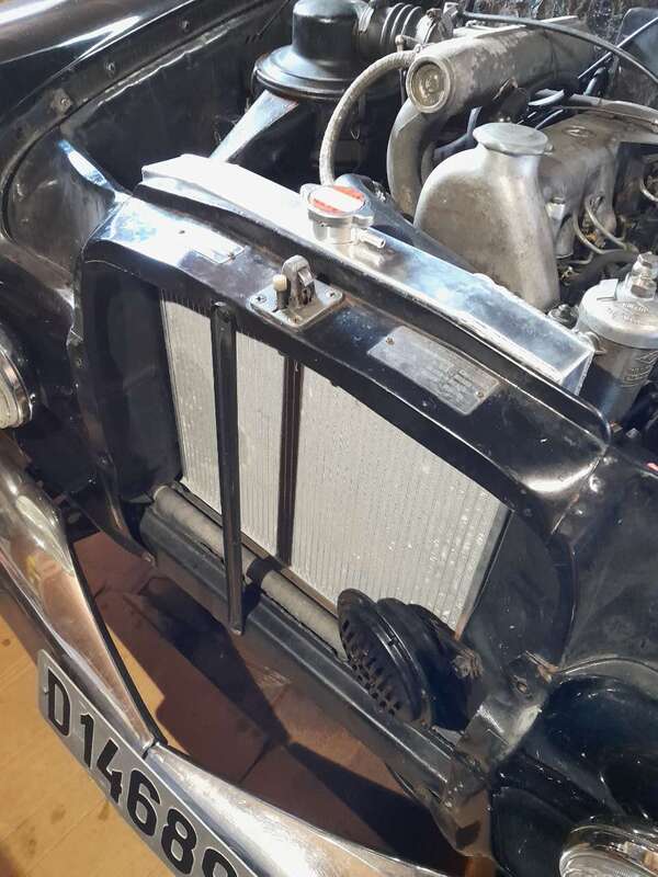

The package I've been waiting for arrived today. The radiator in this one is not good and is full of old repairs to the point I think it's not fixable so it needed a replacement.
But no one sells a new radiator for these, but I've been checking ebay on and off for a year now and suddenly an ad appears for a small batch of new aluminum radiators for these and seller had good feedback and so did the radiators they sell so I took the chance and ordered one.
So this is what arrived today and the impression is good, it looks well made and fits in the car well.

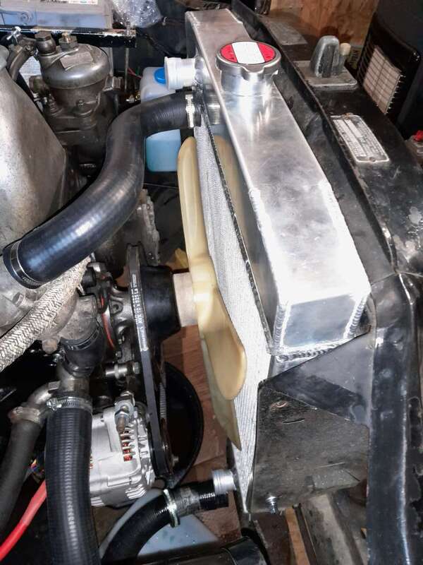

I have also changed to the newer water pump which is from W115/W123 and it fit well the only problem is that the fan to it sticks out too far which can be seen in the picture bellow. So the original spacer between fan and water pump must either be shortened or replaced.

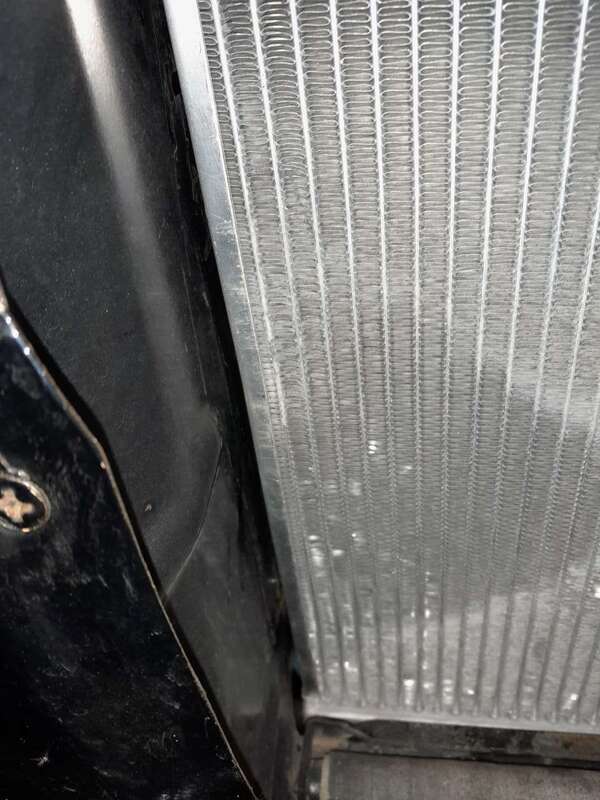

There is also a small gap between the new radiator and body that should probaly be sealed, not sure how to do that. And should probably stick something soft on the sides of the radiator, but not sure what.

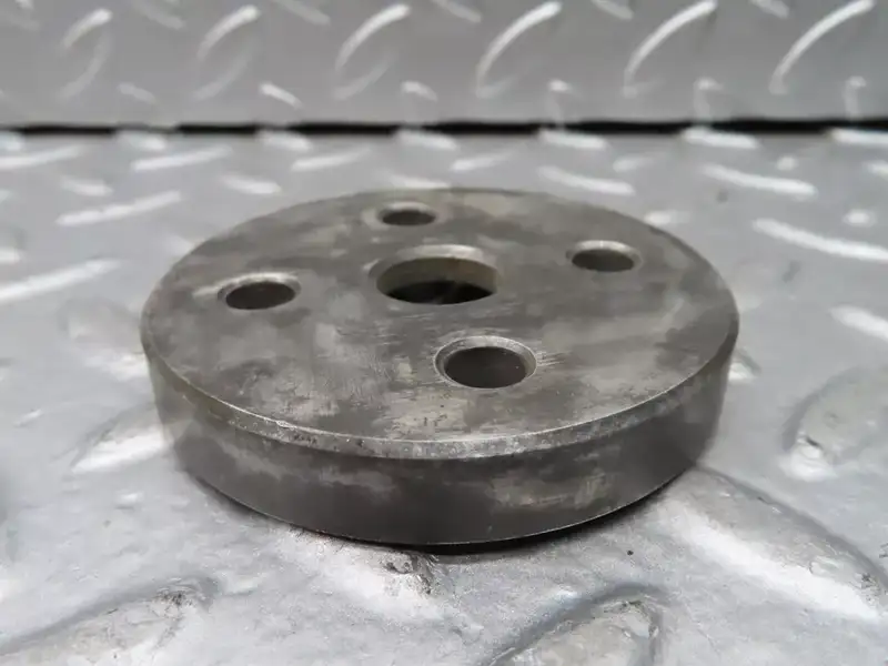

And it looks like the fan problem is solved. W114 is 6 cylinder with the same water pump and fan, so has a shorter fan spacer, so have found one of these and ordered it.
Provided the radiator is mounted securely, I wouldn't worry about that small gap. I doubt it will make any difference.
If you do pack anything in there, make sure it's not flammable!
It's an engine bay, it's filled with inflammable things? Foam rubber or foam plastic will prevent vibration if the radiator is not firmly held in place.

The Mercedes W114 fan spacer has arrived.
And with that, the fan is moved about 30mm backwards towards the engine and the fan is now about where the old fan was before.
The next thing was to install the new radiator. Got it in place but it's a little crooked but can't get it better, the car could have been hit in the front at a point for all I know but it's in.
