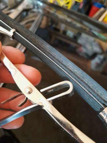

You might be able to get stainless steel wipers meant for boats.
I use stainless wiper blades on the Renault 6, but they're bayonet fitting - hook fitting stainless blades seem to be a bit harder to come by.  DV might be better off just replacing the rubber bits with a refill.
I tried to change the rubber part of the wiper blades but the rubber part was a little different between the ones I had and the black wipers I got hold of.  So I have put on the black ones and will look more into this later as I have more important things to do to this one now.
Force 4 Chandlery standard duty wiper blades in 11" and 14" flavours
I think I have got it wrong, re-reading @Wuvvum's post is it the hook type you need?
Yes, it is.

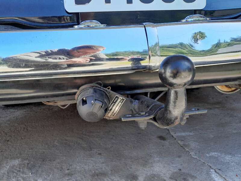

Have started to fix some of the MOT deficiencies.
And it became clear why the trailer connector did not work when I disassembled it. It had completely fallen apart.20230811_132655.thumb.jpg.9cb5c448a1e01c179e7e1cfca3d28fdd.jpg
Changed to a new one and seems to be working now with a test lamp, will have it tested on a trailer to be sure.
