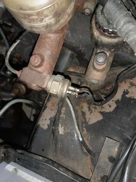

It is possible. But I checked the brake light switch and it has power to it but none out and jumping the terminals the lights come on. So I'm pretty sure it's faulty. But can check the trailer contact first as you have suggested.

The brake light switch doesn't seem to be the easiest thing to find but have found one from a newer Mercedes that looks almost identical and it's not expensive so have ordered it together with the brake hose and brake fluid and should get this next week. And all this was available from my usual Norwegian parts supplier.
And the brake switch on these is on the brake master, so it's easy to get to.

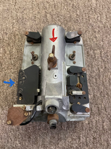

But fixing the lights in the instrument panel won't be fun as this has to come out and I suspect and hope the light bulbs are the fault.

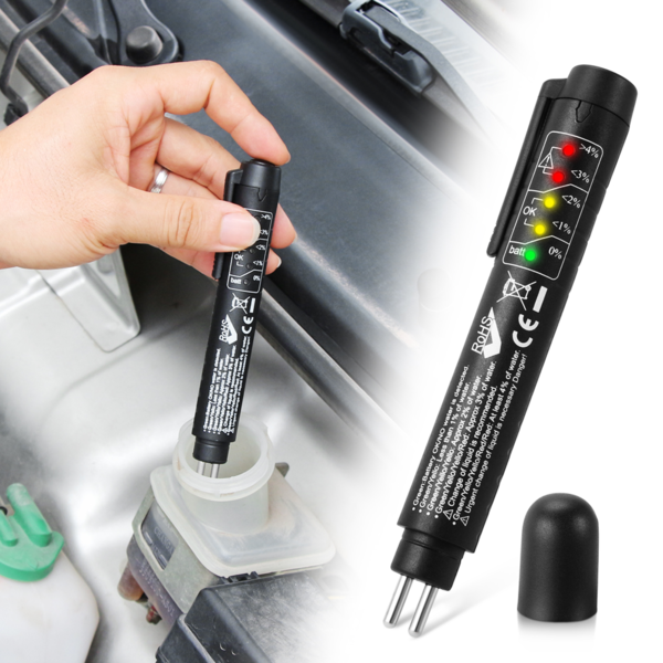

How do they measure the brake fluid boiling point?

I imagine they use a hygrometer, one of these:
You can get them for about £5 online, although I imagine the exact tool they use will be calibrated and more expensive
What it actually measures is moisture content/contamination which has a direct relationship to the boiling point of the brake fluid
The higher the moisture contamination, the earlier the fluid will boil (lower boiling point) and fail under operation - also causes corrosion in the system
Brake fluid is definitely a highly neglected service item on modern cars. Most cars on the road are probably still running around on their factory brake fluid if the system hasn't been opened up for repair.
I can say that pretty much nobody books their car in for a standalone brake fluid change, it's usually done as an "upsell" upon recommendation. And even then, most of the time the recommendation gets ignored 🤷
I tested some brake fluid a while back on a car that was 10 years old, it hadn’t had a brake fluid change, it still tested perfectly fine for the moisture content.
Sounds daft but do check the tester as they randomly stop working, I got suspicious of mine saying everything was "green" over the period of a few weeks. Dipped it in some water directly and it still displayed green. Oops!

I had the good idea to go on ebay and look at the instrument clusters on these.
And is a bit interesting, what I have marked with a red arrow on both pictures, I can't find any other explanation that that is the mounting / fastener to the dachbord?
And the blue arrow in picture one is where I may have to change light bulbs and there appears to be a hinged hatch there.

So there may be some hope that this is made for easy access/removal?
