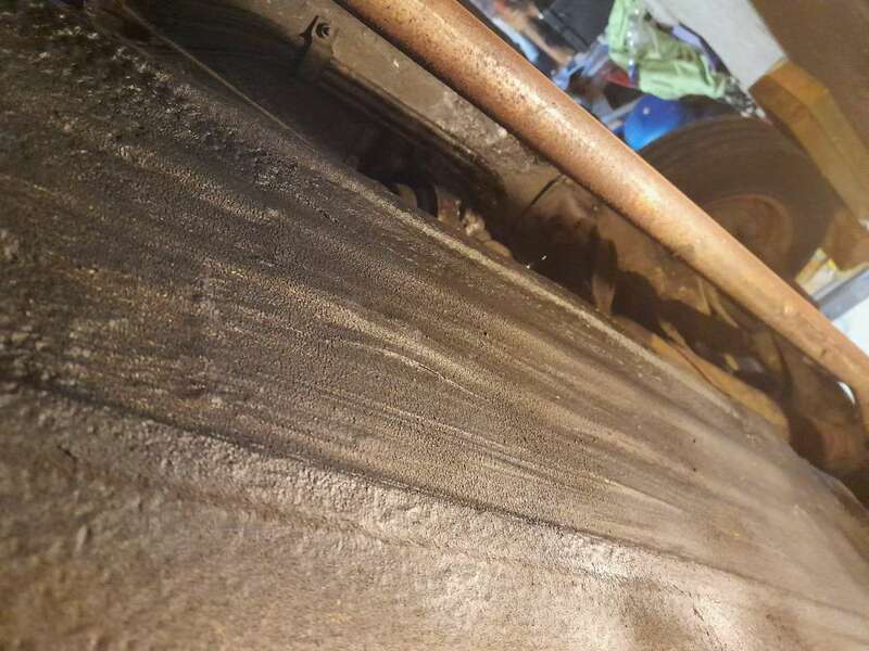

4 hours ago, danthecapriman said:
 Must admit I’ve never heard of fluid film - might have to have a look for some and see what it’s like.
I think Fluid Film is quite good, the only thing I don't like is that if it is on the underside of the car, it attracts dirt as it never fully dries. So if I can, I prefer a Swedish product which I think is wax and bitumen based that dries. But it's not such a big problem on this one, which is only used in the summer season, so it almost only see clean roads.But what Fluid Film is really good at is cavities. The main car was treated with the wax product underneath and Fluid Film in the cavities almost 3 years ago and it is still comming out in plate joints, drainage holes etc. But it is now starting to slow down. They say that Fluid Flim can soke/crawl out to 15 cm.
On an old Toyota with a lot of rust inside the sills, Fluid Film prevented them from rusting out for 5 years before the car was scrapped. And the one tractor here is very rusty and I have painted it with Fluid Film 2 times in the last 5 years and the rust has not developed and is stable.
So my experiences with Fluid Film are good. And on old cars I now always treat the cavities with Fluid Film as it can prevent them from rusting out or at least slow it down and if it were to rusts out then Fluid Film is not flammable  so it shouldn't  cause problems with welding.
It sounds very similar to the wax products I’m using already then.
I use Dynax UB or UC on underbodies which is thicker wax type fluid and sets semi hard so it can repel stones, grit and general crud on the road.
Then Dynax S50 cavity wax inside box sections, chassis legs, door cavities etc etc as it is very thin and can stay runny allowing it to soak deep into panel joins and seams. This continues dripping out for a while after you use it too.
Theyre all available here: https://bilthamber.com
Im not anything to do with them other than a customer, but the waxes seem particularly effective in my opinion. I’ve used them for years and never seen them fail yet.
The rust converter chemicals aren’t so good though! But not many of them are.
I’ll have a look for the Fluid Film and have a go with it though I think. It might well be better?
I have no experience with the products you have experience with, so it is impossible to say whether Fluid Film is better or not.
But Fluid Film is lanolin oil and doesn't contain many chemicals if any, so I think it's nice to work with.
This is interesting, but I do not agree with him about wax products and not washing cars underneath, that should always be done in the spring after a winter in salt.

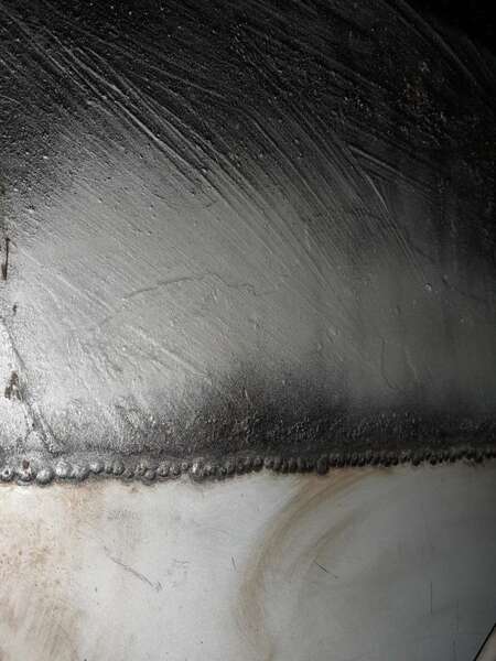

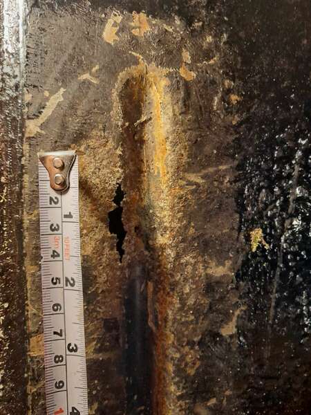

Got it back from welding today and I'm very happy with the result.
Driver's side floor rust hole.
Before
Now and one can vaguely see where new steel has been welded in.
Passenger side rust hole.
Before
Now and he cut away much more than the rust hole was. Was a plate joint here and that's probably the reason.
Same repair from the underside

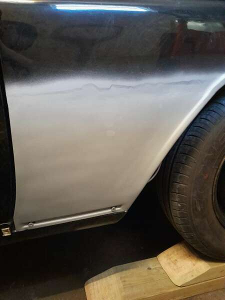

Passenger Side front wing.
Could probably wish he hadn't gone up so far. And I couldn't afford to let them paint it as this became expensive enough. So I'm going to paint it myself, which won't be perfect, but neither is this car.
At the back here, the joint between the repair panel and front wing is visible and it looks nice.
The arch liner / inner wing? also needed some welding
The next thing is the fasteners for the seat belts. These have been done in a way that some people here did not recommend, but those who did this work are professionals who do this kind of work every day and also fix crash damaged cars that will then have to be approved, so they should know what they are doing. So I agreed to do it in their way. And if this should fail in a crash, I'm probably dead anyway.
And they did this by drilling/cutting a hole, so the  welded nut on the mounting plate went into the hole. In the gearbox tunnel, this is visible from the backside. And they have paint and wax coverd this too.
So then this is done and I can now start gluing in sound dampening mats followed by carpets.

Tough looking welds on the seatbelts!
The other areas look very neat.

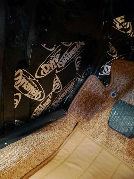

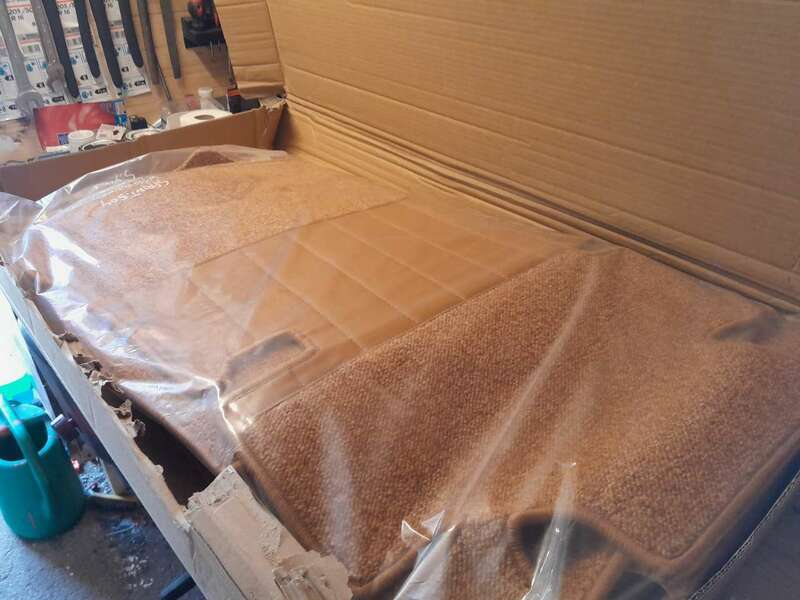

I've started with soundproofing and since I don't know anything about sound dampening, I've gone for Dynamat Extreme since many people who should know what they're doing use this.
I have also had the carpet set from Tapis Deluxe delivered and it looks very good, I am excited to see how well it fits. But if it fits, this is good value for money.

I have had the opportunity to spend the last few days on this and have got a lot done. Soundproofing has been done and was lucky to have enough Dynamat for the whole car and the boot. Forgot pictures of this but is not very interesting.
And have today started on the interior carpets from   https://www.tapis-deluxe.com/en/  and this has not gone so well. Either an apprentice or a child made this or this is how the products they sell are.
Some parts fit reasonably well but others do not and some are not cut as they should be. So I have had to cut and adapt a lot myself.
The piece for the parchelshelf seems to be too long.
You can see on the right here that part doesn't quite fit. And to the left where the dynamat is, there should be carpet, but that pice doesn't fit at all so i have to make i fit.
So this is very frustrating but I just have to make the best of it. And for the price I paid for this, I can live with it. This car is not perfect and never will be
So 9 hours spent on this today and I'm exhausted and broken and not done yet. Will come with more pictures and update when finished.
