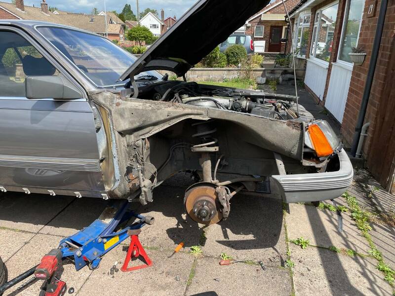

Work has commenced on the welding of this fine steed. The front strut tops (renowned for rusting) have been repaired in the past, and need doing again. Starting on the offside, I really need to remove the wing to get better access. Some hard to reach areas proved worth it, finding a 1/2 inch extension under the headlight.
dont you just love bolt on wings?
not when 2 are hidden behind the ECU inside.
here’s the previous repair.
it’s still quite solid, structurally but looks a mess.
wings off. Some clean up and treatment needed of high salt gathering areas. And the scuttle drains need unblocking while I’m here.

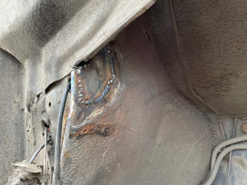

*disclaimer. I am in no way shape or form a professional fabricator or welder. I just have a stab at stuff. Better now 0.8 wire is used. 0.6 was shit.
Coulda' fooled me; the dimes on that last picture looked superb.

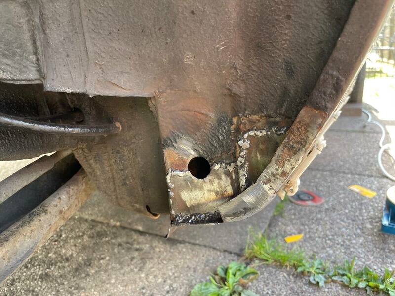

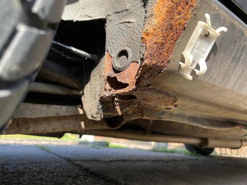

I’ve lost my tin of seam sealer. Almost certain I bought a new tin of it but can’t for the life of me find it. Going to have to buy another tomorrow so packed up early. While tidying up, and the sill covers are off, I’d better check the back of the sill……..
YAY more welding!
Loving the progress updates on this - a Carlton just looks right.
Sent from my VOG-L09 using Tapatalk

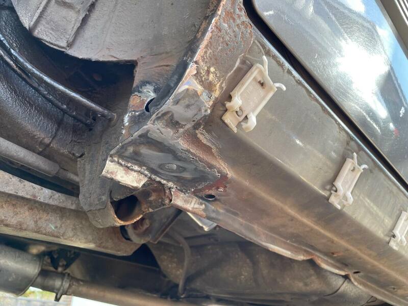

Mmmm less holy
luckily 90% of this will be covered up by the side skirt trims.,
Seam sealed. Chassis paint.
stone chipped
waxoiled then trims back on

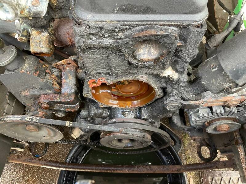

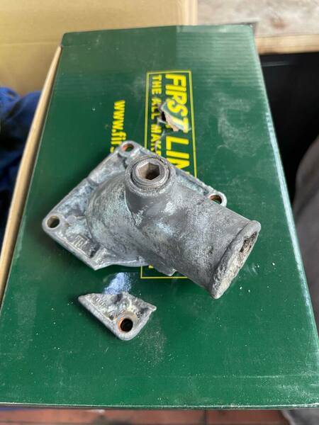

Aaaaannnnnnnd it’s broken.
the corrosion must have been keeping this together. It’s also gone thin in places and weak. Now the hunt begins for a replacement. That’s gonna set me back I recon.
thought I’d clean it anyway just incase I end up having it ally welded back into place.
F11B4FB4-3C75-438E-8465-4C4367028F49.thumb.jpeg.f4c2efacb1c86e0c552c98f17d06fca2.jpeg729042DA-1F41-4AEB-BC42-868698296D04.thumb.jpeg.b073ebb27ef63c6c1efb6233e92311cb.jpeg
this is some of the gunk that came out of it.
finding parts for these cars proves difficult due to its undesirable status and because no one really restores them apart from a couple of us 🤣
  • Sad 4
What’s all the crap that’s congealed inside the alloy castings?  Anti freeze beyond its sell by date?
