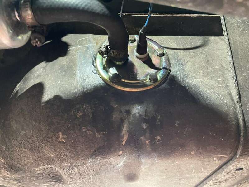

I have looked for you on various classic Opel parts websites and all the ones I find are different, they are all similar to the one I posted a picture of. So it seems the Opel and Vauxhall tank level senders are different. Don't understand what GM was thinking.
It could be that the Vauxhall factory used other suppliers for some parts? One of my Opels was built in Belgium, the other in Germany. You'd think that it wouldn't matter, but they are slightly different in certain details.*

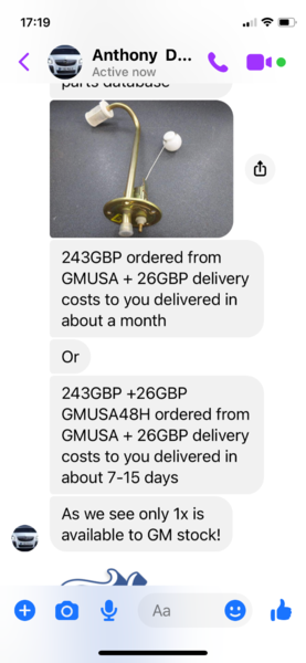

I’ve contacted someone in Holland. His reply is this.
so maybe this tank and sender isn’t a common fit? Or it’s been replaced somewhere down the line with a non genuine item?

The other sender unit has a very narrow feed pipe. The one on the car has a very much larger diameter pipe to the fuel pump! So how is that going to work? My brain hurts. I need alcohol.

the man from Greece has found a replacement sender unit. In America. How?

New sender on its way. £100. Not cheap, but also not expensive. And found by a lad in Liverpool who has 6 months ago cleared an old Vauxhall dealer parts department.
