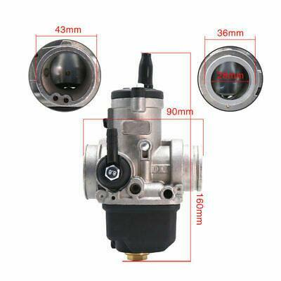

red5 Posted March 12, 2022 Author Posted March 12, 2022 13 hours ago, DodgyBastard said: I have a spare 28mm Dellorto going spare but it's also probably no use for this application. Got any more details?
808 Estate Posted March 12, 2022 Posted March 12, 2022 On 3/11/2022 at 9:22 AM, Talbot said: Performance upgrade: Meh. On 3/11/2022 at 1:55 PM, Crackers said: "Will this fit in my Miata?" Merely a toy. Now we're talking. 😃 Yoss 1
DodgyBastard Posted March 13, 2022 Posted March 13, 2022 6 hours ago, red5 said: Got any more details? It's from an aprilia 125 motorcycle. mercedade 1

Zelandeth Posted March 16, 2022 Posted March 16, 2022 I do wonder if there's a better suited carb to this engine. 90 degree elbow and a tiny SU maybe?
red5 Posted March 16, 2022 Author Posted March 16, 2022 Had crossed my mind. Also any number of generic bike type carbs etc. However... beko1987 1

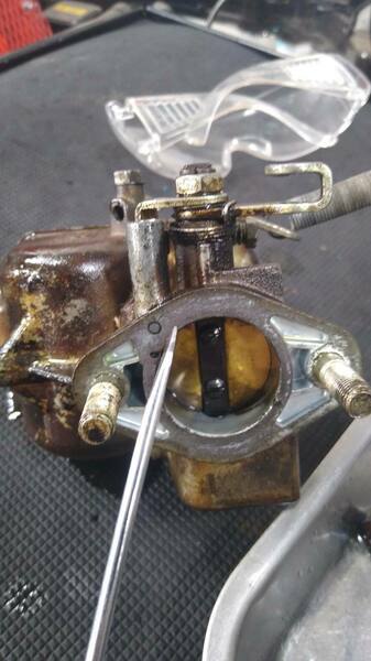

LightBulbFun Posted March 24, 2022 Posted March 24, 2022 On 10/03/2022 at 21:22, red5 said: Anyways, carb fun. Spindle bush has a gap you can get a rat through, acc pump doesn't and hasn't for a long time...need a new one pref, or one that doesn't have those two things. Hmm. On 15/03/2022 at 20:01, LightBulbFun said: @red5 is it the brass shaft thats worn or is it the casting it goes into? because I Have managed to find Half of a weber 32ICS, not sure if its the right half but heres a link anyway LOL https://www.johnrichardssurplus.co.uk/haflinger-carburettor-top-504-108-4011.html On 15/03/2022 at 20:14, red5 said: Nice. It's the body that's needed really chief. Found something that might be suitable. Need mount dimension though. where is this spindle bush in question? im just trying to figure out exactly what is worn and needs replacing/fixing is it this spindle the big brass butterfly valve in this photo attaches too? if thats the case, in the photo above it looks like it does attatch to the upper housing of the carburettor so I am just wondering, why its a main body that is needed and why the upper half I found is not suitable? as it looks like the spindle does attach to the upper half of the carb, so I was thinking that getting a replacement top half would solve the issue? https://www.johnrichardssurplus.co.uk/haflinger-carburettor-top-504-108-4011.html but I really cant claim to know stuff about carburettors so im just asking, incase your on about something entirely different that is in the main body? Im just trying to figure out and better understand whats going on and obviously try and help solve the problems at hand if I can! (like is a main body needed because of issues with the accelerator pump as well?)
Zelandeth Posted March 24, 2022 Posted March 24, 2022 It's the throttle spindle I think was being referred to, which is right down at the base of the carb. The butterfly at the top is the choke. LightBulbFun 1
red5 Posted March 24, 2022 Author Posted March 24, 2022 Yup, the base. And the acc pump/mech is , well, not. A carb or base would be preferable. LightBulbFun 1
LightBulbFun Posted March 24, 2022 Posted March 24, 2022 30 minutes ago, Zelandeth said: It's the throttle spindle I think was being referred to, which is right down at the base of the carb. The butterfly at the top is the choke. 15 minutes ago, red5 said: Yup, the base. And the acc pump/mech is , well, not. A carb or base would be preferable. 2 minutes ago, red5 said: ahhh my apologies! that makes sense now! I did not realise there was a 2nd butterfly valve like that thank you for the visual pictures helps me much better understand whats wrong
bobdisk Posted March 24, 2022 Posted March 24, 2022 I have heard of the throttle spindle hole drilled out, and a new spindle made a size bigger to fit the bigger hole, would that work?? LightBulbFun 1
