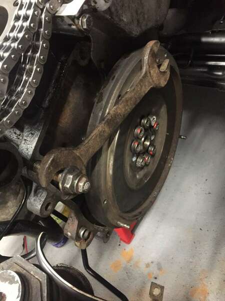

Here we have my happy fit of grandads spanner to save buying a flywheel locking tool and the position as we speak. Basically as disassembled as it’s going to get

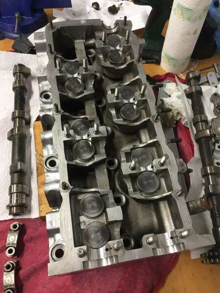

All the valves are now lapped in. This was part way through. Very therapeutic job, or at least to me

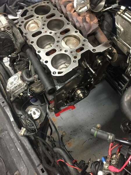

Nice work, it's not until you see a pic with the head off the block that I realised just how narrow an angle the V is on these. What is it, 15 degrees or something on these vr6 engines?
You know, after owning three different VAG 2.8 VR6s, I'd never actually realised that?! Looking at it, it's barely a V6!

15 degrees is right. Makes for a fabulous sound - WHEN IT BLOODY WORKS...! 😐😂

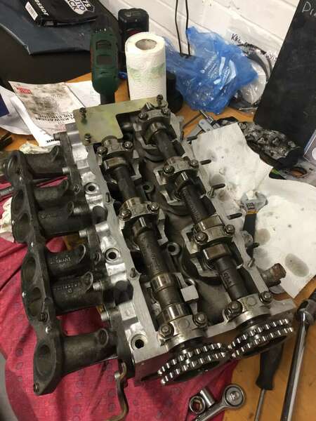

12D659EB-4D46-4752-8E56-78D9430EE844.thumb.jpeg.a7828846dffcf2515c4e49a15d7b4dd1.jpegAll valves in and the tappets fitted. I managed to do the valves with my Pain in the Arse compressor so happy days.
Cams fitted and torqued down (plenty of thick oil to lubricate!) Then i fitted the lower inlet manifold as it won’t bolt on the car with the alternator in the way.
So, fitting the new gasket and dropping this on the top comes next! @grogeeto the Garage for cups of tea and heavy duty thinking on timing, please!

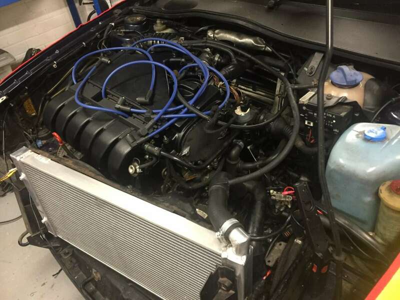

New HT Leads you say? Too fat for the routing strips! A bit of judicious filing will sort that:
And back together. At least sufficient to get her mobile and to the mechanic:
