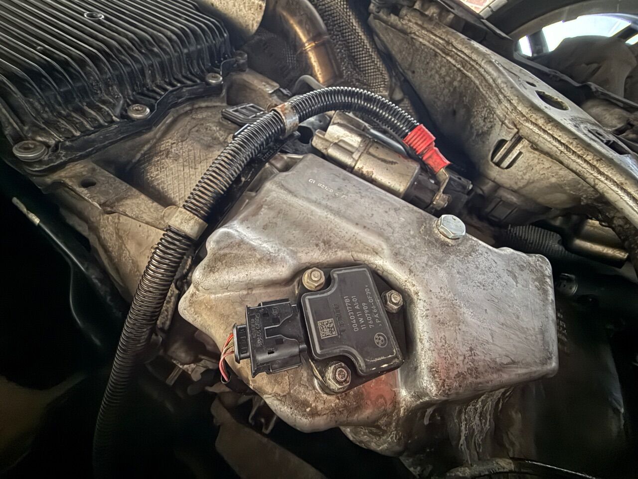

JJ0063 Posted May 24 Author Posted May 24 Oil leak is getting bad now so have ordered a complete new rocker cover, genuine BMW injector bolts and copper washers… and a torque wrench! One tool I’ve never owned, everything just gets done up FT but feel like this might warrant doing it properly. Also after the heat died down today I managed to give it another clean. rm36house, yes oui si, Matty and 1 other 4

JJ0063 Posted May 30 Author Posted May 30 Decided to give the rocker cover a go today, wasn’t terrible! New Febi cover, new injector seals and bolts Hopefully that cures the leak. I’ve taken the full undertray off which is huge and saturated in oil. Not sure how’s best to clean it other than a pressure washer and degreaser? Matty, Dave_Q, Jazoli and 1 other 4

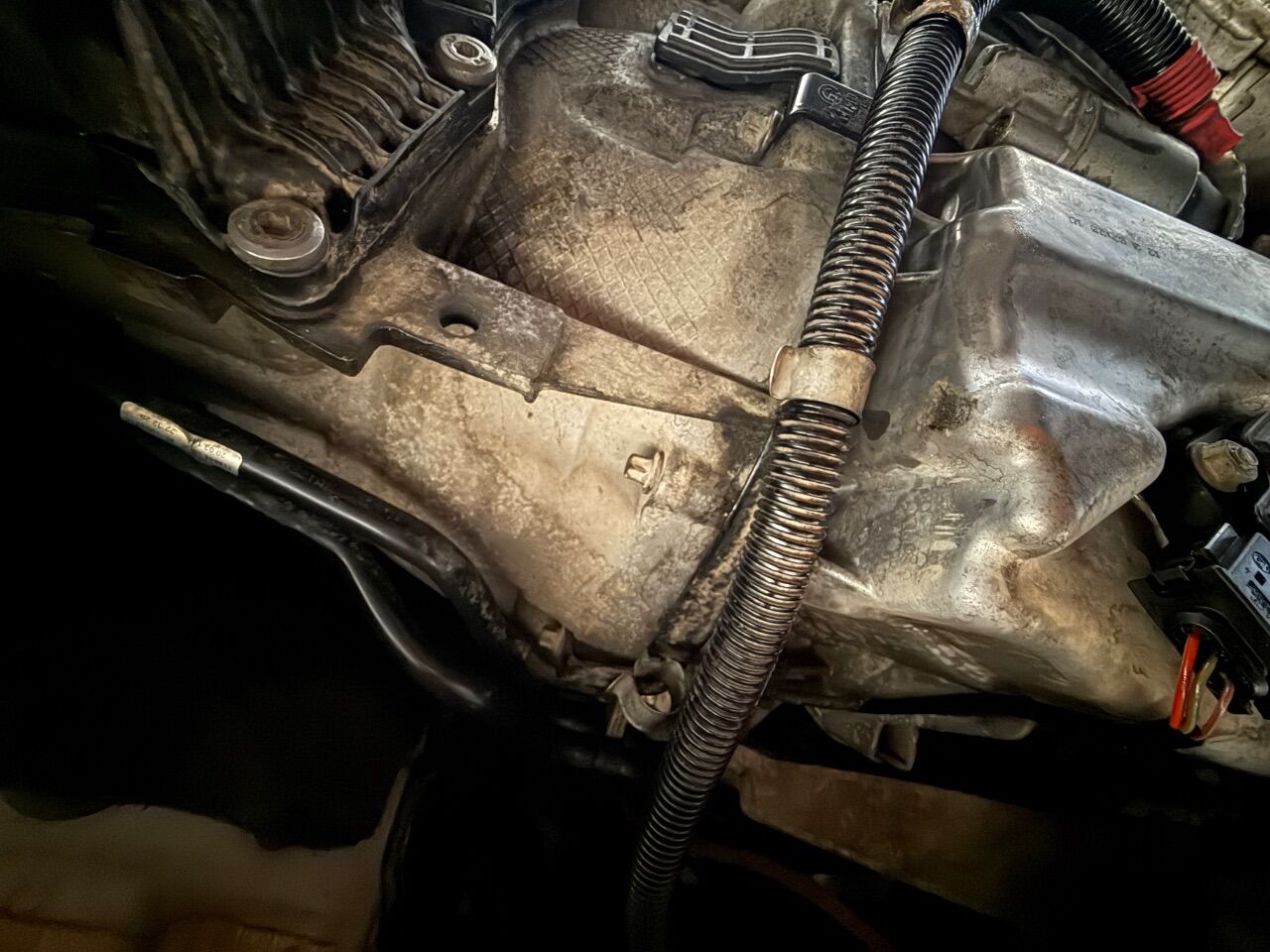

JJ0063 Posted May 31 Author Posted May 31 Thought I’d try and earn some love from the BMW by giving it a proper hoover for the first time possibly ever. Hoping maybe giving it some TLC will stop it leaking? Put an old boot liner under the engine and there’s a couple of drops there 🤦♂️ trying to be optimistic and say it’s probably just remnants I missed with the brake cleaner.. however I’m pretty sure the oil filter housing is also leaking which is another common N47 issue… yes oui si, EyesWeldedShut, GrumpiusMaximus and 2 others 5
JJ0063 Posted June 1 Author Posted June 1 Fuck it, determined to sort this. Oh and I had a low coolant warning last week, topped it up and it’s dropped slightly again so I’m hoping there’s a small leak rather than anything serious. Coolant flange is very common on these so whilst the manifold is off to do the oil filter housing gaskets, I’ll change the flange even if just for preventative maintenance considering how easy it is to switch whilst the car is in bits. scooobydont, mercedade, Wibble and 4 others 7

JJ0063 Posted June 7 Author Posted June 7 I didn’t take any pics as it was a SHIT job, but did the oil filter housing gaskets today. Pretty sure the gearbox cooler line is leaking now as it just didn’t feel like it would seat properly so I may have to revisit that but it’s one retaining bolt and can be accessed from underneath. Also the filter housing wasn’t that wet, but the sump was absolutely drenched. I’m now thinking that either the sump itself is the issue, or the rear main but that was changed with the timing chain a couple of years ago. Ready to sack it off now but can’t sell it as is. Wibble 1

JJ0063 Posted June 13 Author Posted June 13 It’s only stopped leaking oil! Sump had a stupid sound deadening cover round it that had been saturated so I tore it off and binned that. Cleaned everything up with brake cleaner, laid under it with the engine running for 15 mins and there’s no signs of any leak. Still selling it now I’ve got my mind set on changing car 😂 Wibble, Coprolalia, yes oui si and 5 others 8

JJ0063 Posted July 2 Author Posted July 2 Well, I’m surprised. Read up on this stuff and liked the fact it’s not your typical snake oil that blocks galleries etc. It only targets rubber seals and the reviews online are brilliant. So, ordered a service kit.. gave it a full service and put the above in. Drove it round for a week and the leak has now 95% gone. Can still see a slight dampness around the bottom of the gearbox to block mounting point but so minor you’d not even mention it. After almost no interest and a couple of timewasters, I’ve deleted the advert and it can stay. It’s a good car and I have no reason to change it now it seems to be behaving. Also no more coolant loss at all since changing the oil filter housing gasket. Coprolalia, Matty, Dave_Q and 8 others 11
