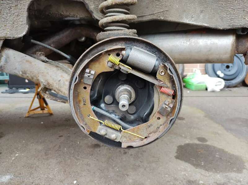

Rear brake back on.
It is, theoretically at least, driveable.
I re-read my 'help' thread on the Maestro forum about non functioning indicators - the advice was to check hazard switch because they gum up/get dirty. Worked it a few times and sure enough the indicators work again! Result!
I dropped it off the stands and went for a sneaky (slightly illegal) drive up and down the bypass. That's as far as I've driven it now.
Sitrep:
Good news
Engine is sweet. Well it's a bit ticky but that might be sticky tappet (does this have hydraulic tappers?).
Gearbox is sweet, good old Honda.
Clutch is heavy AF, but it didn't feel too bad once on the move.
Pulls to the left a bit.
Brakes stop but they are a bit shit. Will investigate upgrade (does Turbo use bigger discs and calipers?)
Bad news:
There's a nasty noise from the rear, something is scraping something else. I'm wondering if the brake I put back together is rubbing on the drum? Kinda looks ok though.
I haven't fixed the exhaust blow yet.

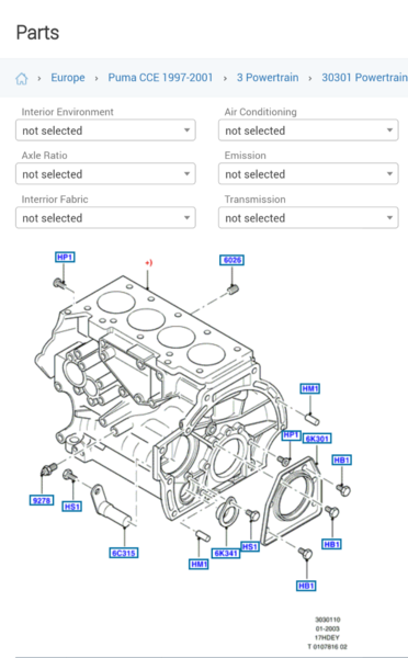

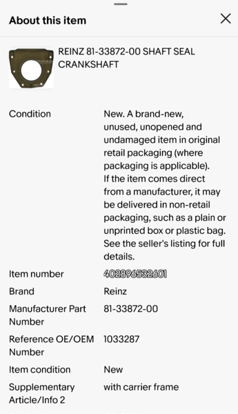

FACK! Farmed out the clutch job and provided parts. But as it turns out, the wrong parts. Or so it seems. Either that or faulty. Either way, a massive pain in the arse, and I've got to pay double labour.
The crank seal I bought (Victor Reinz) is listed as same part number shown on Ford parts catalogue.
But, he's bolted it all back together and it's now leaking from the crank seal. So - box has to come off again, flywheel off again and change seal again. For FUCK'S SAKE! (Pictured is my workings out for why I bought that seal.)
Of course garage asked where did I buy the parts (eBay of course, always eBay) and now they think I'm a clown.
