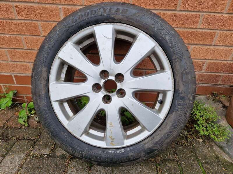

Unfortunately I did a cock up today. I decided that I'd be clever, and instead of buying a new tyre for it, I'd buy a wheel and a good part worn. That way I could replace the space saver with a full size, and get all the tyres to 'good' tread.
Sourced the wheel and tyre, and I've just picked it up from the garage who have put it on for me - in total about £110. Went to put it on... And that's when I discovered the Avensis T250 comes with two different hub specs depending on engine spec.
Most of the range gets a 5x100 stud pattern.
2.2D models get a 5x114.3 stud pattern.
Toyota has gone to the trouble of producing the same alloy wheel style in both hub patterns
Guess which one I bought?

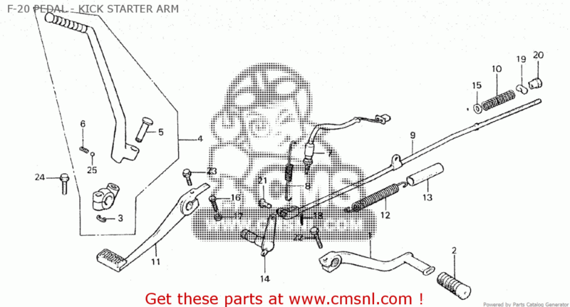

I'm a bit confused about the brake light switch. The switch looks to be a sprung plunger that connects to something on the rear brake linkage but I can't see what.
Having said that, the brake works as it should, so that's a full compliment of slowing down devices on the bike.

There should be a long spring (although not very springy one) from the eyelet in the brake light switch to a point somewhere on the brake pedal
Looks like it goes to the little eyelet on part number 14
Thanks @Stinkwheel that diagram is very useful and also tells me I'm missing two other springs on the assembly: 12 is the return spring and 10 is required to keep the adjuster mechanism taut so that it doesn't self-undo.
I'll have another look in the bucket of bits to see if I've got it, otherwise I'll have to obtain the part or cobble something together.

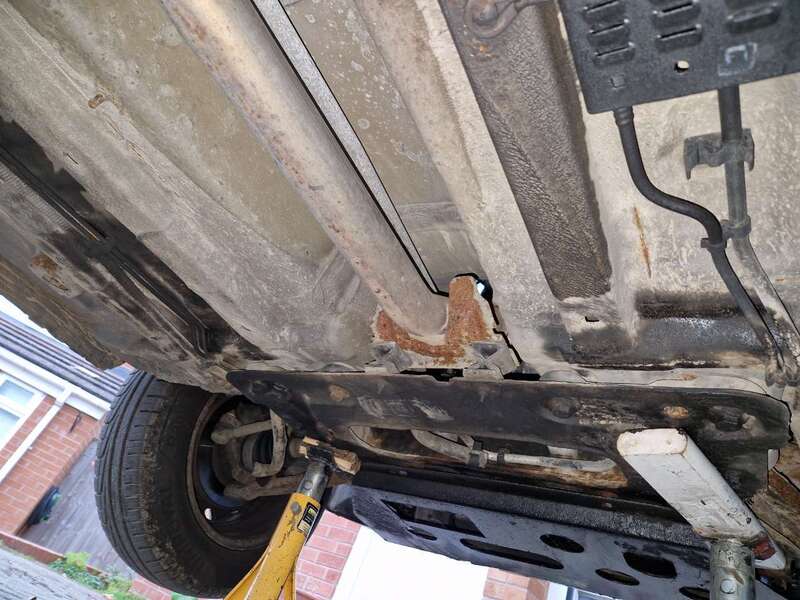

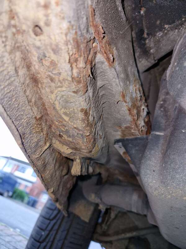

Oh, re: your photos of the underside: the first place for rust to break through is usually at the triangular interface between the wheelarch/rear of the inner/outer sill that is a bit scabby in your photo.
