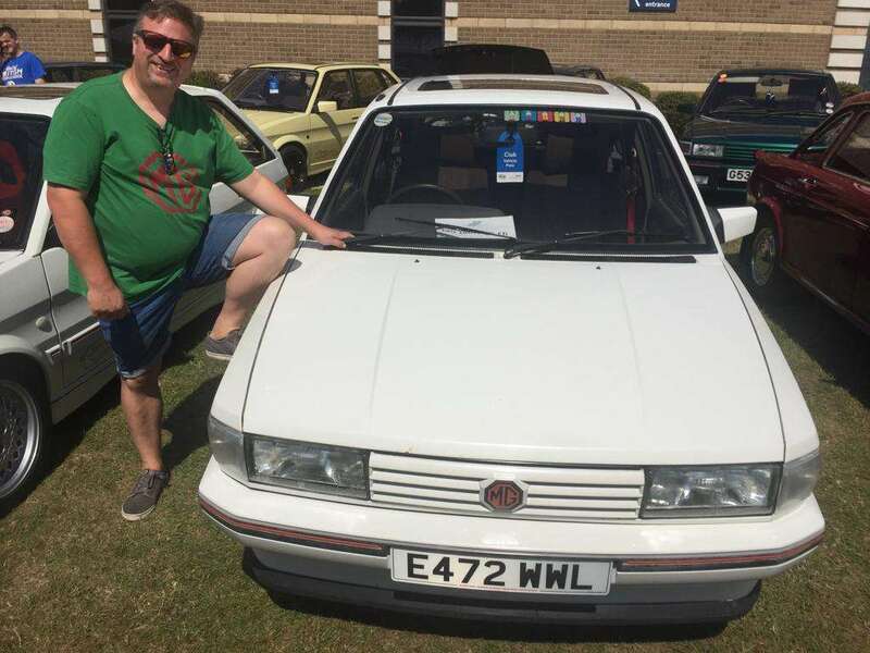

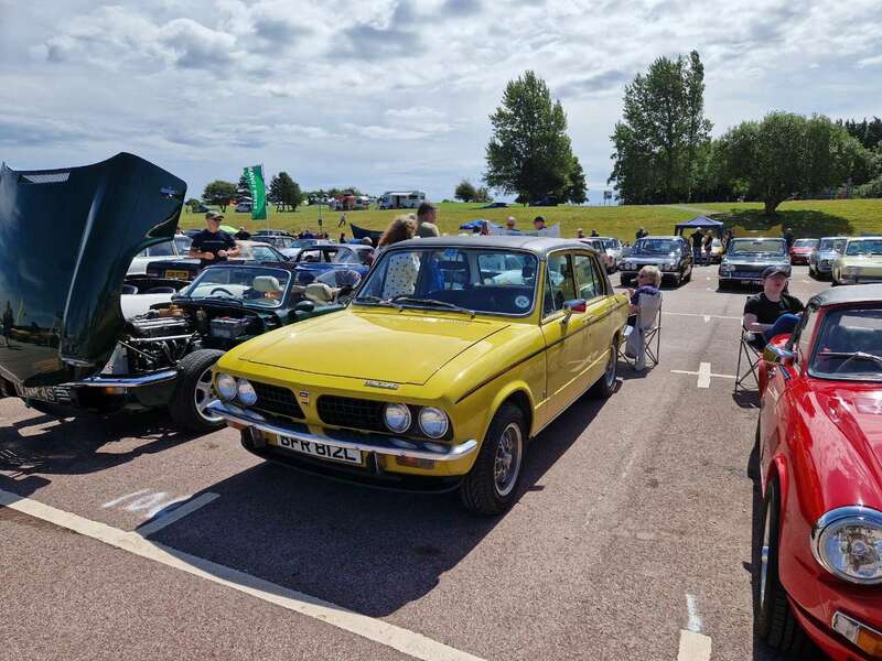

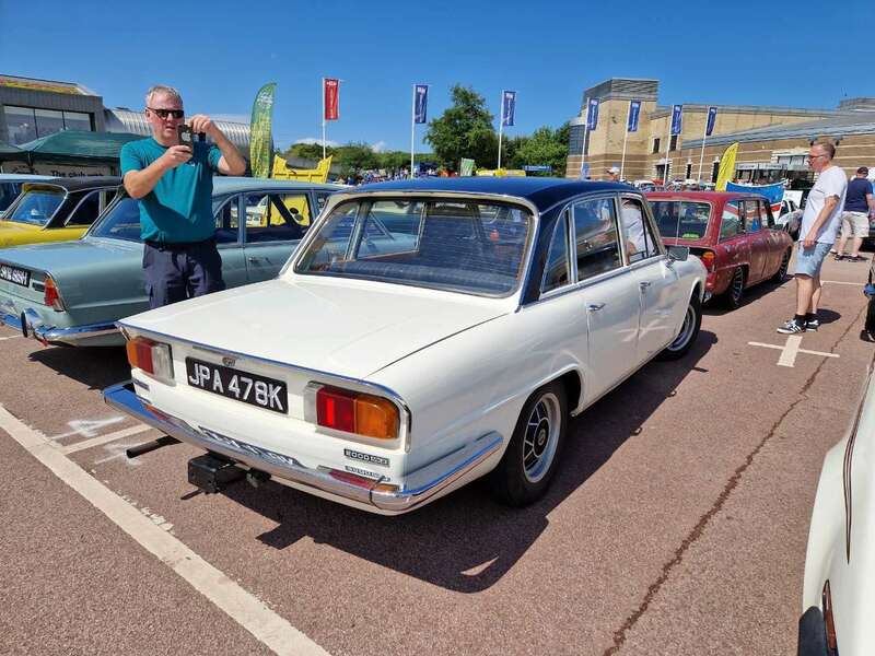

grogee Posted July 9, 2023 Author Posted July 9, 2023 Triumph turnout was good. @Cluffyand I realised we wanted all of them - TR7, Dolly and 2000/2500 PI. AnnoyingPentium, Dyslexic Viking, Shite Ron and 2 others 5

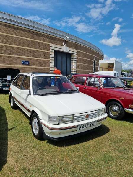

grogee Posted July 9, 2023 Author Posted July 9, 2023 If I'm truly honest with myself, this Mk1 Astra has aged better than the Maestro. Values probably back this up. 500tops, JMotor, Cookiesouwest and 3 others 6
grogee Posted July 9, 2023 Author Posted July 9, 2023 Some Maestros Sunny Jim, Geoff Smith, JMotor and 3 others 6

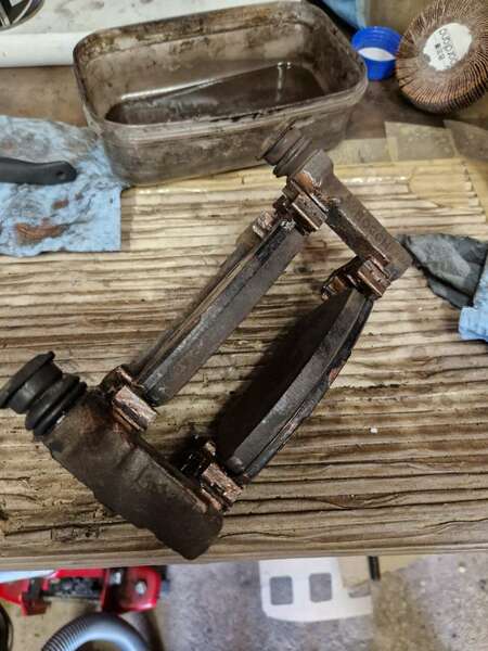

grogee Posted July 10, 2023 Author Posted July 10, 2023 Corsa repair day today. I was just about to go outside and attack the scrape on the rear with scratch removal paste, then the heavens opened and priority changed to getting the washing in. Pah. The good news is that I've cured the brake squeal (for now). Not really knowing a 'killer' solution, I just took it all apart and re-[copper] greased it. Not before giving the calipers a damn good going over with the wire wheel. The weird thing is that it looks like previous person (maybe @SmokinWaffle, maybe his chosen garage) did exactly the same to a greater or lesser extent, so I wasn't confident my tinkering would cure it. It wasn't just an occasional squeal either, it was a loud 'everyone looks at you' kind of squeal and mostly impossible to drive around. Also on today's list was the glovebox replacement, a few Torx screws and a broken clip substituted for a cable tie later and the new (2nd hand) one is in. Unfortunately it's from a car that had Something Big behind the glovebox so it's smaller in capacity, but it does now open and close as Adam Opel GmbH intended. Service bits are coming this week so I'll get onto an oil and fluids change sooner or later. Popsicle, rainagain, SmokinWaffle and 1 other 4

Noel Tidybeard Posted July 10, 2023 Posted July 10, 2023 doesn't copper grease help brakes seize up? i'm sure one of the tame AS garage monkies mentioned this very fact this week

grogee Posted July 10, 2023 Author Posted July 10, 2023 2 minutes ago, Noel Tidybeard said: doesn't copper grease help brakes seize up? i'm sure one of the tame AS garage monkies mentioned this very fact this week We'll see. It's what my garage boss told me to do in 1991 so I've done it ever since, progress be damned. I am considering it a 'win' seeing as they don't squeal any more. I had a similar conversation with a JLR engineer regarding lubricating door locks and hinges, apparently received wisdom is now to leave them the fuck alone.

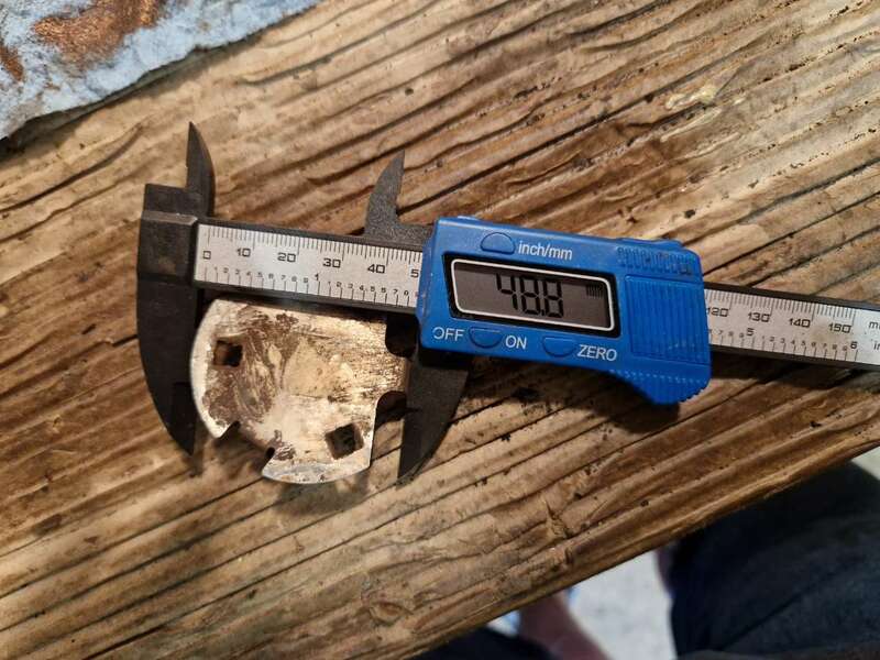

SmokinWaffle Posted July 10, 2023 Posted July 10, 2023 1 hour ago, grogee said: Corsa repair day today. I was just about to go outside and attack the scrape on the rear with scratch removal paste, then the heavens opened and priority changed to getting the washing in. Pah. The good news is that I've cured the brake squeal (for now). Not really knowing a 'killer' solution, I just took it all apart and re-[copper] greased it. Not before giving the calipers a damn good going over with the wire wheel. The weird thing is that it looks like previous person (maybe @SmokinWaffle, maybe his chosen garage) did exactly the same to a greater or lesser extent, so I wasn't confident my tinkering would cure it. It wasn't just an occasional squeal either, it was a loud 'everyone looks at you' kind of squeal and mostly impossible to drive around. I did indeed - the garage did sweet FA - and it did solve it for a few weeks and I was chuffed - but it came back eventually. Although I didn't clean up the callipers as much. I noticed also that when it is squealing if you put your foot lightly on the pedal so it *just* chirps and hold it steady - it'll do it intermittently (rotationally?) so I did wonder if it was a slightly warped disk - but I couldn't consistently reproduce that either! Fingers crossed for you. And yes, the squealing is very much more of a screeching and really can be heard for a considerable distance. Not fun to drive.
grogee Posted July 10, 2023 Author Posted July 10, 2023 1 hour ago, SmokinWaffle said: I did indeed - the garage did sweet FA - and it did solve it for a few weeks and I was chuffed - but it came back eventually. Although I didn't clean up the callipers as much. I noticed also that when it is squealing if you put your foot lightly on the pedal so it *just* chirps and hold it steady - it'll do it intermittently (rotationally?) so I did wonder if it was a slightly warped disk - but I couldn't consistently reproduce that either! Fingers crossed for you. And yes, the squealing is very much more of a screeching and really can be heard for a considerable distance. Not fun to drive. The only thing it might be is a missing shim on the offside. When I looked at the nearside, this piston shim thing was present, but it's missing on driver's side. Unfortunately I've not been able to track one down yet, mainly because I don't know what it's called!
grogee Posted July 10, 2023 Author Posted July 10, 2023 As for the scratch treatment, I'm delighted with the results. There are a couple of bits that need touch up paint, which I've ordered. But it's a whole lot better than it was. Before and after pics: Erebus and beko1987 2
somewhatfoolish Posted July 10, 2023 Posted July 10, 2023 2 hours ago, grogee said: The only thing it might be is a missing shim on the offside. When I looked at the nearside, this piston shim thing was present, but it's missing on driver's side. Unfortunately I've not been able to track one down yet, mainly because I don't know what it's called! Usually called an anti-squeal shim. High Jetter and grogee 2

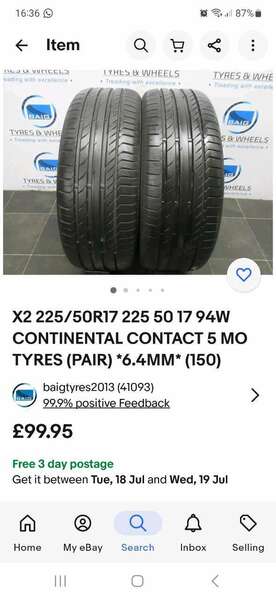

grogee Posted July 15, 2023 Author Posted July 15, 2023 Also bought some tyres for the Beamer. I think I'm going to hedge my bets and go for 2 (good) partworn and 2 new ditchfinders after payday. These Conti tyres for £100 posted look OK and they've both got 6+ mm of tread. Do we think it'll chew its rear tyres faster than the fronts?
