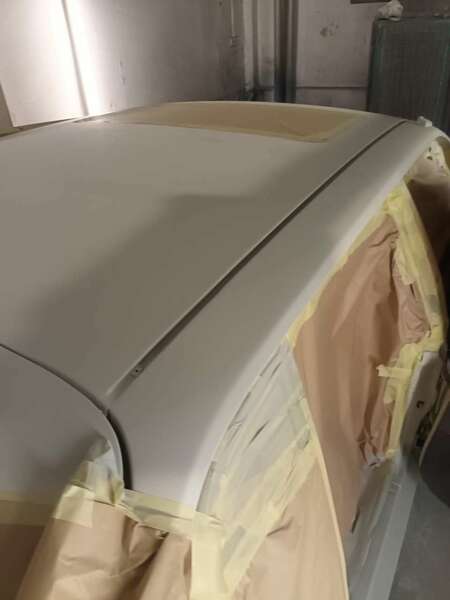

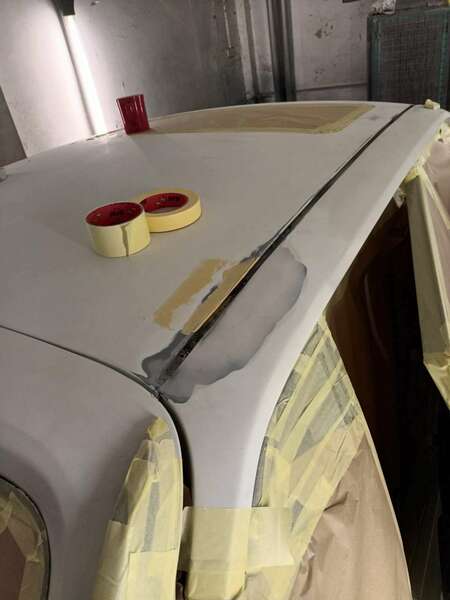

Moar bodywork. Looks like Kevin has the wind in his sails. Encouraging for me too, I'm itching to get it back and get it MoT'd.

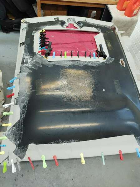

@Cluffy has very kindly given me a corner of his garage and an old table to get working on the headliner. We've already given it a coat of PVA, although perhaps not necessarily as it's polystyrene, not fibreboard stuff.
The other day I'd had enough of being scared to stick the fabric on, so I went gung-ho and just threw it on there. It's contoured and there's quite a lot of shape to it - not just 'flat' as you might expect. The fabric hasn't really sat in the curves along the corners but I'm hoping the grab handles will bolt this down and save my blushes.
Also, I ran out of pegs, so I'll have to do the other corners tomorrow and next day.

2/3rds done on the headliner.

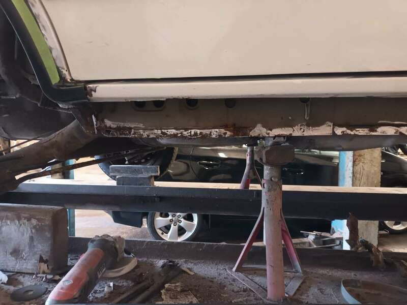

Not a silly question. It was a combination of pictures I sent, plus then another assessment when it got there. I provided panels and doors needed: 2x sills, 1x rear arch panel, 1x front wing (to provide rear arch section for opposite side), 2x doors.
When he took rear bumper off there was a lot of rust around the rear floor so there was an additional piece of work to repair that which neither of us knew about.
So, in summary: provide as many photos as possible. Be prepared to source hard to find panels. And be ready for the bill to go up beyond what you might have expected...
In addition I've had to get @worldofceri to transport it. I could risk driving it back to a booked MoT but the tyres are a million years old and the handbrake doesn't work.

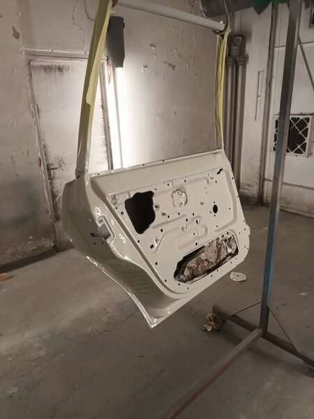

He's sprayed up the drivers door I provided which is good because the current one has quite a lot of wob in it. Saying that I might save that job for next year.
