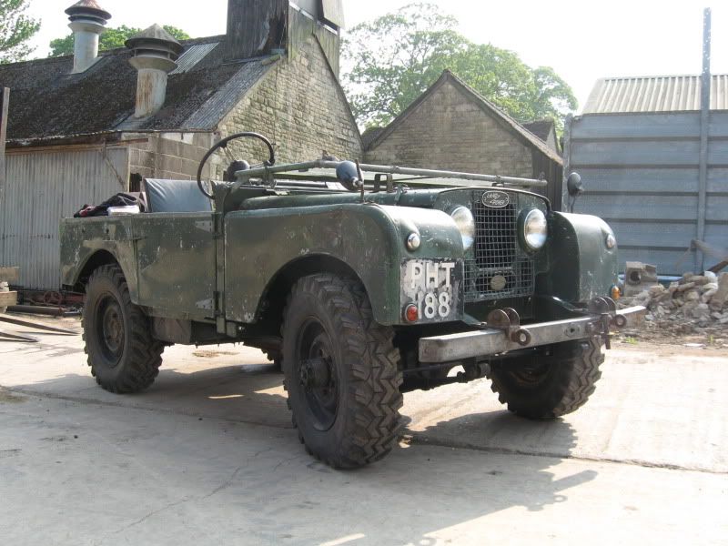

Hey I've got my Land Rover back together! Just need to borrow a radiator from a friend as I'm too skint to get mine recored, finish putting the new wiring loom in, machine up a couple of adapters for the rear brake cylinders and I can try and get an MOT :shock:
Brought the 3 door 900 out of hibernation, new mot and louvre bodged onto back window. GR8 to have it back on the road.
That Land Rover looks fantastic!

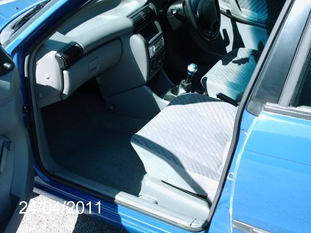

Right, a few hours with a jetwash, polish, G3, buffer, sponge, car shampoo and water, hoover plus copious amounts of elbow grease and an 8mm spanner have seen a bit of a result with the Astra...
Fog light fitted, car gleams almost as good as a new one, interior/exterior have come up superbly. Just needs the door mirror spraying to match the other side and a couple of touch ups in places. Well chuffed with the result even if it was like polishing a turd and probably no one else would be sad enough to spend hours on an old Ashtray.

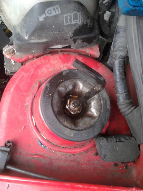

Don't feel so bad Cavette, I've been spending hours on the autoshite favourite* MK3 Golf.
I'm slowly getting it up to an MOT standard. I replaced the CV boot which went nicely but the strut mount is a wobbly mofo and I can't get the strut off.
It has a hex bit in the middle and a 22mm nut. If I turn the 22mm nut on its own the whole strut turns. I tried turning the 22mm nut with a spanner and the allen key in place but it's impossible.
How's it supposed to be done?

Just the strut mount hopefully, what a horrible setup. ALL VOLKSWAGENS R SHIT.

They're a bastard. Try these, [in increasing order of desperation]; 1]Fill the top mount cup with penetrating fluid of your choice [keep topping it up] for at least a day. Stick rattle gun with allen key attachment on the bastard. 2] Weld the nut to the srrounding metal cup. 3] Split the nut [messy] You're supposed to hold the nut, and turn the allen key, which is doable if you have one of those "hollow" socket sets, otherwise, it's a bastard, and you WILL round the bastard off.

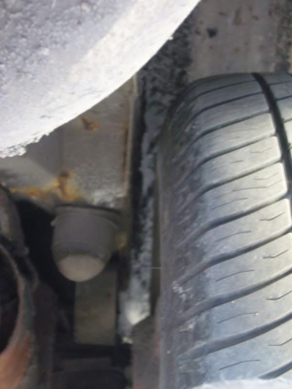

the creak is from the back.
Probably rear arm bearings then, are the wheels leaning in at all at the back.
Yep, that's what I guessed:
An occasional slight creak, and a tiny hint of negative camber is leading me to suspect the trailing arm bearings
Thanks for the links, I'll do more reading. Earlier today:
This is with the car set high.
The mudflaps don't help the illusion, but...

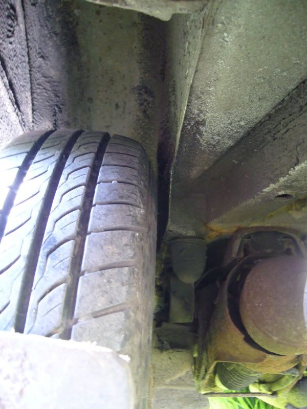

I'm sure they're leaning a bit, esp the near side:
I can only just get my fingertips between the tyre and the chassis rail there. Off side:
Did I read there should be about an inch there? Enough to get most of my hand in?

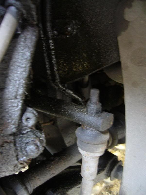

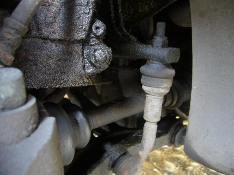

...and dampness in the the nsf hub area show a leak there too.
Viewed from the front:

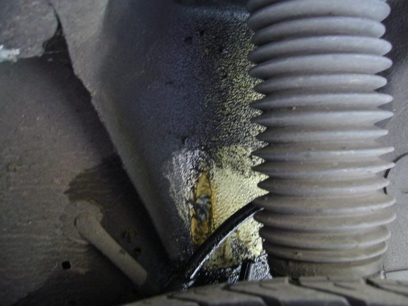

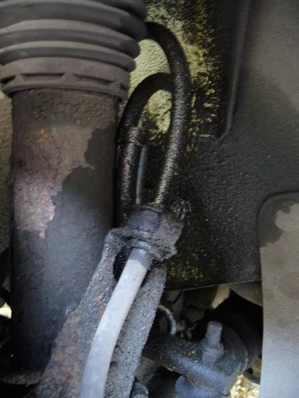

Now there's fluid on the tyre so it must be more than a slight 'weep'.

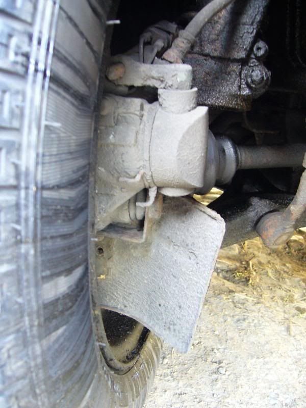

From the splatter pattern, it looks to be coming from the free end of this pipe.
Viewed over the wheel:
Bastard.
Does anyone have a more informed diagnosis / treatment / prognosis?
Thankyouplease.
