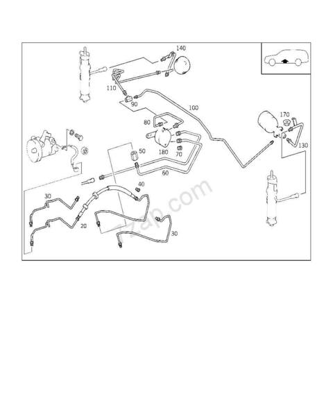

Erebus Posted October 19, 2021 Posted October 19, 2021 8 minutes ago, Nullzwei said: Surprised no one has mentioned how quick the straight six diesels are. The om613 in the 320cdi is a great engine. Massive torque and great fun to drive quickly. Sadly my 02 s210 320cdi is probably going to be scrapped soon as a mercedes only (read expensive) hydraulic pipe has burst after having spent £450+ in the last year on the bloody self levelling suspension. The estates are great cars but the rear suspension is their achilles heel, imho. That's a pisser. Couldn't somewhere like Pirtek make you up a pipe? Nullzwei 1
Nullzwei Posted October 19, 2021 Posted October 19, 2021 1 minute ago, Erebus said: That's a pisser. Couldn't somewhere like Pirtek make you up a pipe? When i had 6 hydraulic pipes replaced at Staithes Garage, a Mercedes specialist in the NE, he joked that the only pipe left to replace was a Mercedes only one and that it was expensive. About £300 quid to replace including the fluid. Along side the other things the car needs doing come MOT time it is probably getting too expensive to justify although this thread is making me think again.

Talbot Posted October 20, 2021 Posted October 20, 2021 11 hours ago, Nullzwei said: a mercedes only (read expensive) hydraulic pipe has burst after having spent £450+ in the last year on the bloody self levelling suspension. The estates are great cars but the rear suspension is their achilles heel, imho. The rear suspension on the estates is actually very simple. Even more simple than a citroen system that this is based on. The spheres are very long-lasting, and not even that expensive new. Almost all the hydraulic pipework can be replicated by a specialist. Most of the time the easiest thing to do (if possible) is to take them the old pipe, they'll then re-use the ends and put them on a new pipe. In the vast majority of cases, that pipe can be kunifer/copper/cupronickel rather than the original steel too. Nullzwei 1
Talbot Posted October 20, 2021 Posted October 20, 2021 10 hours ago, Shite Ron said: I love how they ride with Citroen rear suspension but the advantage of RWD, also the single front wiper is nice. Space inside is ample, towing capacity is great, turning circle is good, visibility great compared to modern rubbish and they do not feel big to drive or park, it is immeasurably better in every way than the mk4 Mondeo I have had for the last 10 years. Funny you should mention that. Between my saloon 210 and the estate ones, I briefly owned a Mk4 mondeo, and hated it. There was nothing wrong with it, I just could not get on with it. So I shoved it back at the dealer I bought it from (as it had a dangerous undisclosed fault), got my money back and went out and bought a S210 that was 9 years older than the mundaneo. "Aaahhh, that's better" I thought, as I got into it. Says it all really. chodweaver, GrumpiusMaximus and Shite Ron 3
Nullzwei Posted October 20, 2021 Posted October 20, 2021 26 minutes ago, Talbot said: The rear suspension on the estates is actually very simple. Even more simple than a citroen system that this is based on. The spheres are very long-lasting, and not even that expensive new. Almost all the hydraulic pipework can be replicated by a specialist. Most of the time the easiest thing to do (if possible) is to take them the old pipe, they'll then re-use the ends and put them on a new pipe. In the vast majority of cases, that pipe can be kunifer/copper/cupronickel rather than the original steel too. The hydraulic pipe that has burst on mine is part number 20 on this diagram. A Mercedes only part according to my local MB specialist. It lives under the near side plastic front wing liner so a well known rot spot on 210's. Luckily i replaced the near side front wing less than 2 years ago so it will be easy to take the wing off to investigate or keep the new wing when/if i have to scrap the car. Twiggy 1
Erebus Posted October 20, 2021 Posted October 20, 2021 I'd be very surprised if that couldn't be replicated by a hydraulic hose and pipe specialist like Pirtek or similar much more cheaply than the Merc part. Gotta be worth a try. Nullzwei 1
Nullzwei Posted October 20, 2021 Posted October 20, 2021 9 minutes ago, Erebus said: I'd be very surprised if that couldn't be replicated by a hydraulic hose and pipe specialist like Pirtek or similar much more cheaply than the Merc part. Gotta be worth a try. Cheers for the tip. Might see if i can take the hose off and take it down to them to see what they can do. Erebus 1

Talbot Posted October 20, 2021 Posted October 20, 2021 1 hour ago, Nullzwei said: The hydraulic pipe that has burst on mine is part number 20 on this diagram. There's options available. Is it the steel section that has split? If so, it will be absolutely possible to cut back to a good bit of the pipe, put a joiner on and the replicate the rest of the pipe. You've got the threaded ends, so it's just a case of getting some pipe that is near-enough the correct diameter and shaping it to fit. I have done this successfully in the past with compression fittings, steel tube from a stockist and a brake pipe flare too. Either that, or there are people breaking 210s all over faceache, so I'm absolutely sure someone will be able to send you one. Or, if it's the flexible bit that has gone through, you just cut the hose and shove a joiner in it. Did that as a bodge on one of my cars... which then lasted for about 30k miles until I scrapped the car for unrelated reasons.
Nullzwei Posted October 20, 2021 Posted October 20, 2021 22 minutes ago, Talbot said: There's options available. Is it the steel section that has split? If so, it will be absolutely possible to cut back to a good bit of the pipe, put a joiner on and the replicate the rest of the pipe. You've got the threaded ends, so it's just a case of getting some pipe that is near-enough the correct diameter and shaping it to fit. I have done this successfully in the past with compression fittings, steel tube from a stockist and a brake pipe flare too. Either that, or there are people breaking 210s all over faceache, so I'm absolutely sure someone will be able to send you one. Or, if it's the flexible bit that has gone through, you just cut the hose and shove a joiner in it. Did that as a bodge on one of my cars... which then lasted for about 30k miles until I scrapped the car for unrelated reasons. Thanks for the top tips. Not sure where the split is yet as i just parked the bugger up and left it after it dropped all its hydraulic fluid. Good work out trying to park with no power steering. I have owned the car for just over 3 years and this is now the third time it has lost all its hydraulic fluid. Dont' suppose you have an ebay link to a 'joiner' if it is a break in the flexible pipe. Thanks again. Just read your 210 thread - great stuff. My back box has broken at the same side mount on the near side. Currently held in place with a ratchet strap.
Talbot Posted October 20, 2021 Posted October 20, 2021 41 minutes ago, Nullzwei said: Dont' suppose you have an ebay link to a 'joiner' if it is a break in the flexible pipe. Anything like this will do: https://www.ebay.co.uk/itm/202135611474?hash=item2f1038a852:g:SnsAAOSwk5FUt6C0 There are dozens upon dozens of listings for things like this. Brass, steel, Stainless, plastic etc.etc. Huge choice, low price. Use a couple of good quality jublee clips on each end of it and it'll last forever.

Nullzwei Posted October 20, 2021 Posted October 20, 2021 1 hour ago, Talbot said: Anything like this will do: https://www.ebay.co.uk/itm/202135611474?hash=item2f1038a852:g:SnsAAOSwk5FUt6C0 There are dozens upon dozens of listings for things like this. Brass, steel, Stainless, plastic etc.etc. Huge choice, low price. Use a couple of good quality jublee clips on each end of it and it'll last forever. Thanks again Talbot, much appreciated.
