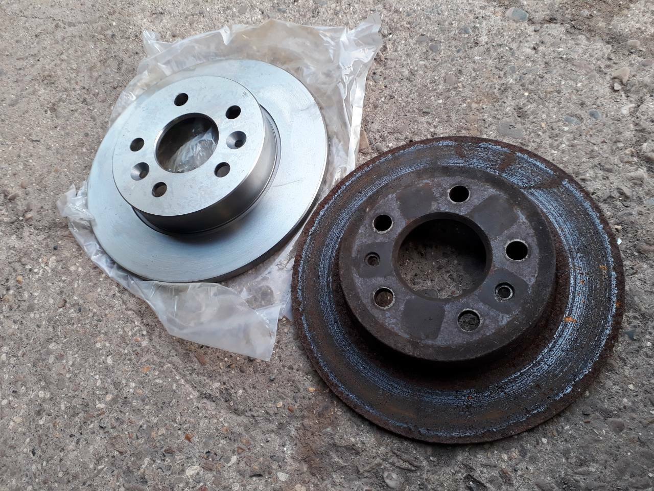

Those rear discs were really F**ck*d.
Certainly were, no bringing them back around with 80 grit on a DA.
Not that i do that . . . obviously  .
New discs all match fine but theres a smidge more centre bore om the new ones . Maybe half a mil. So ill need to pick up some retaining bolts. Will have a rummage in the box at work.

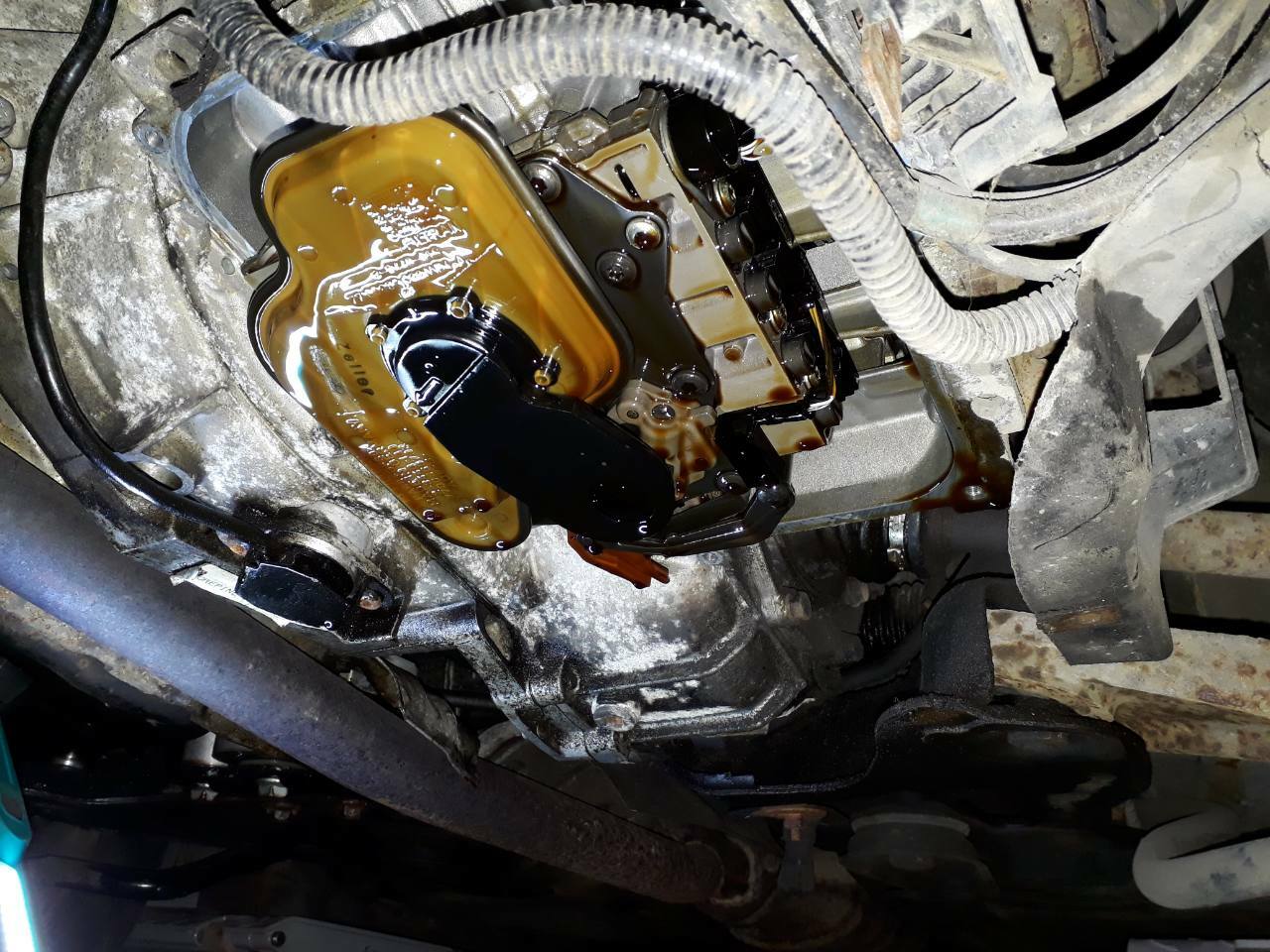

Hopefully you'll enjoy quite a few to come this month as id like to kick it out the door for march. Brakes should be done this week possibly tomorrow evening, also at the weekend the auto box is getting the filter and sump dropped. Cleaned and fresh fluid.

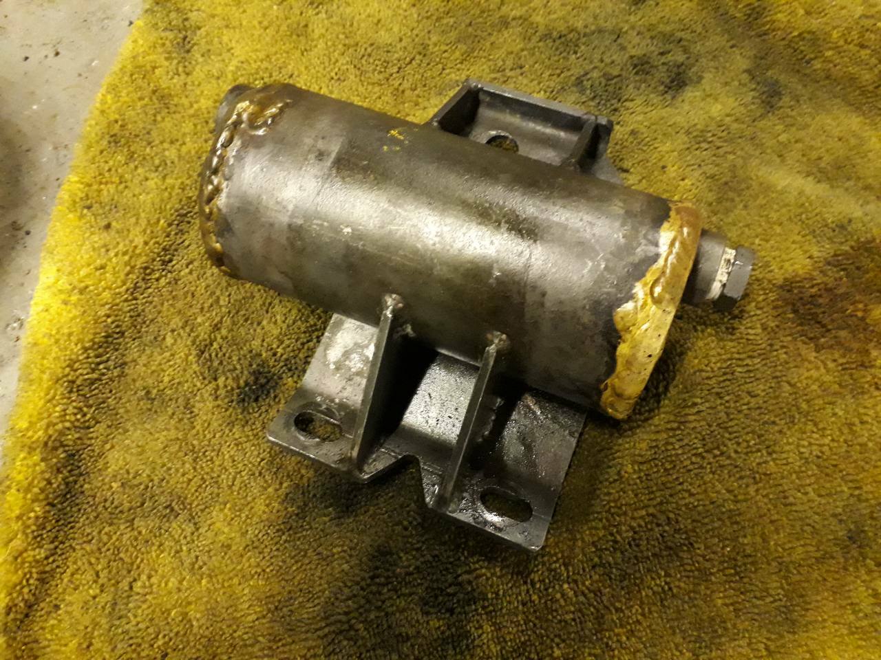

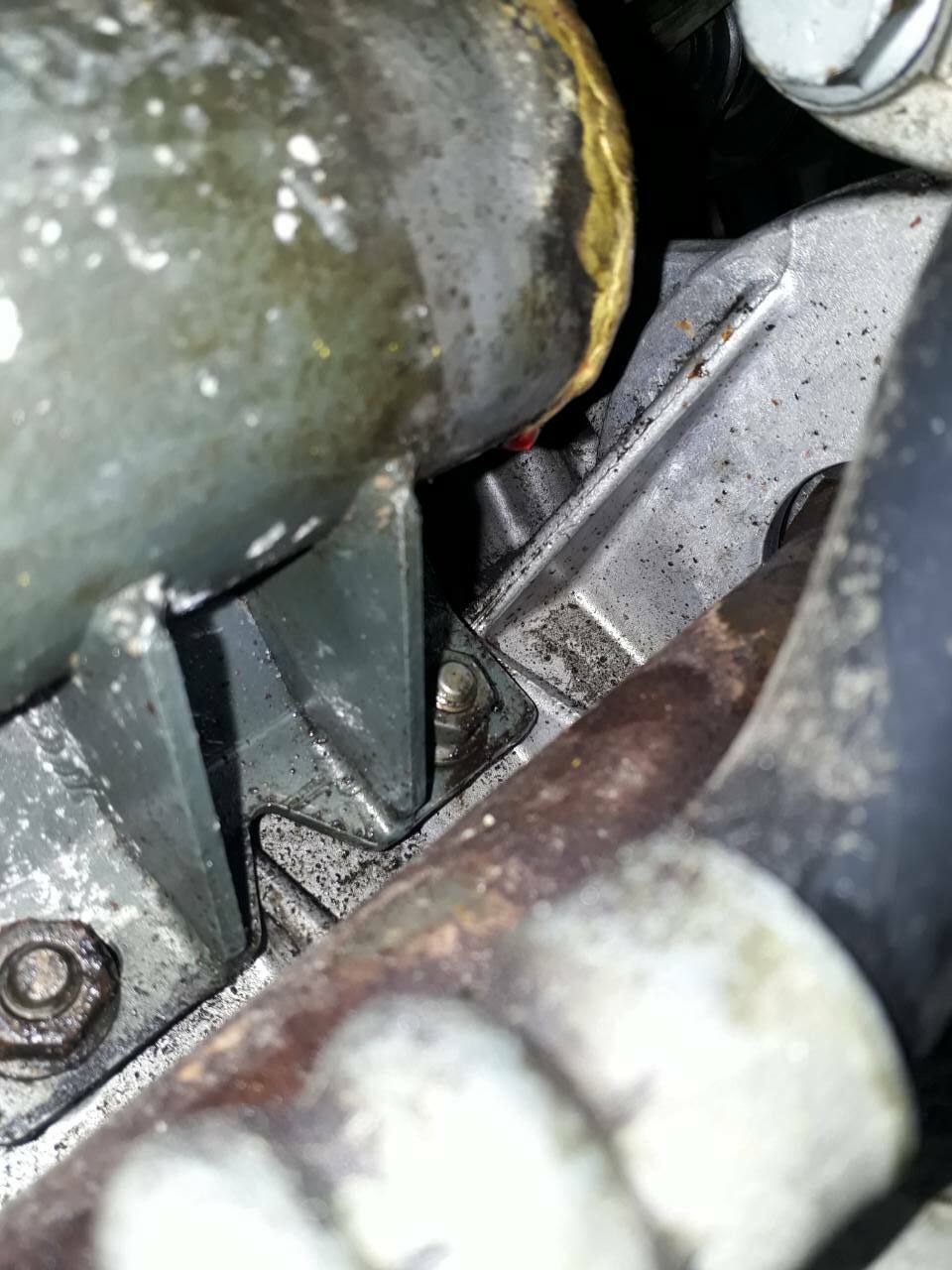

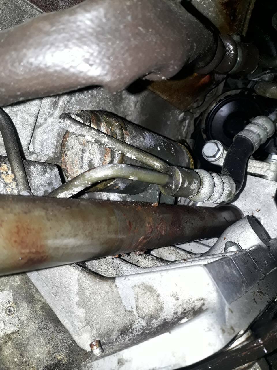

Ah ha! I see you now you little leaky bastard!
That reserve tank thats clearly been fixed in the past is the final leak i think.
I cant say i understand exactly what it does to be honest.
All it does is tie into high pressure line.

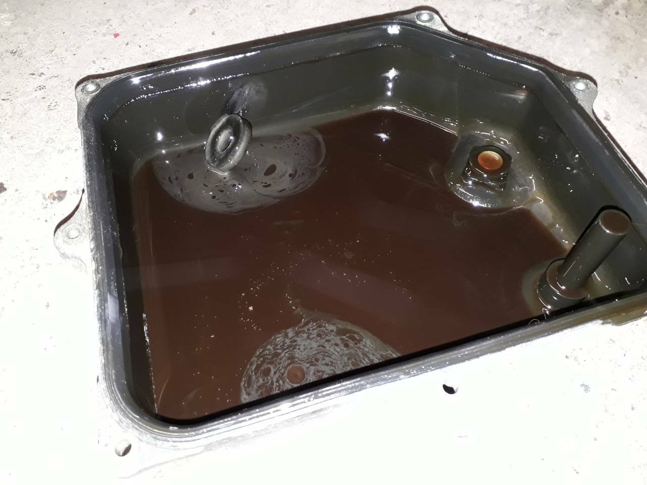

18 minutes ago, Schaefft said:
Service looks long overdue!

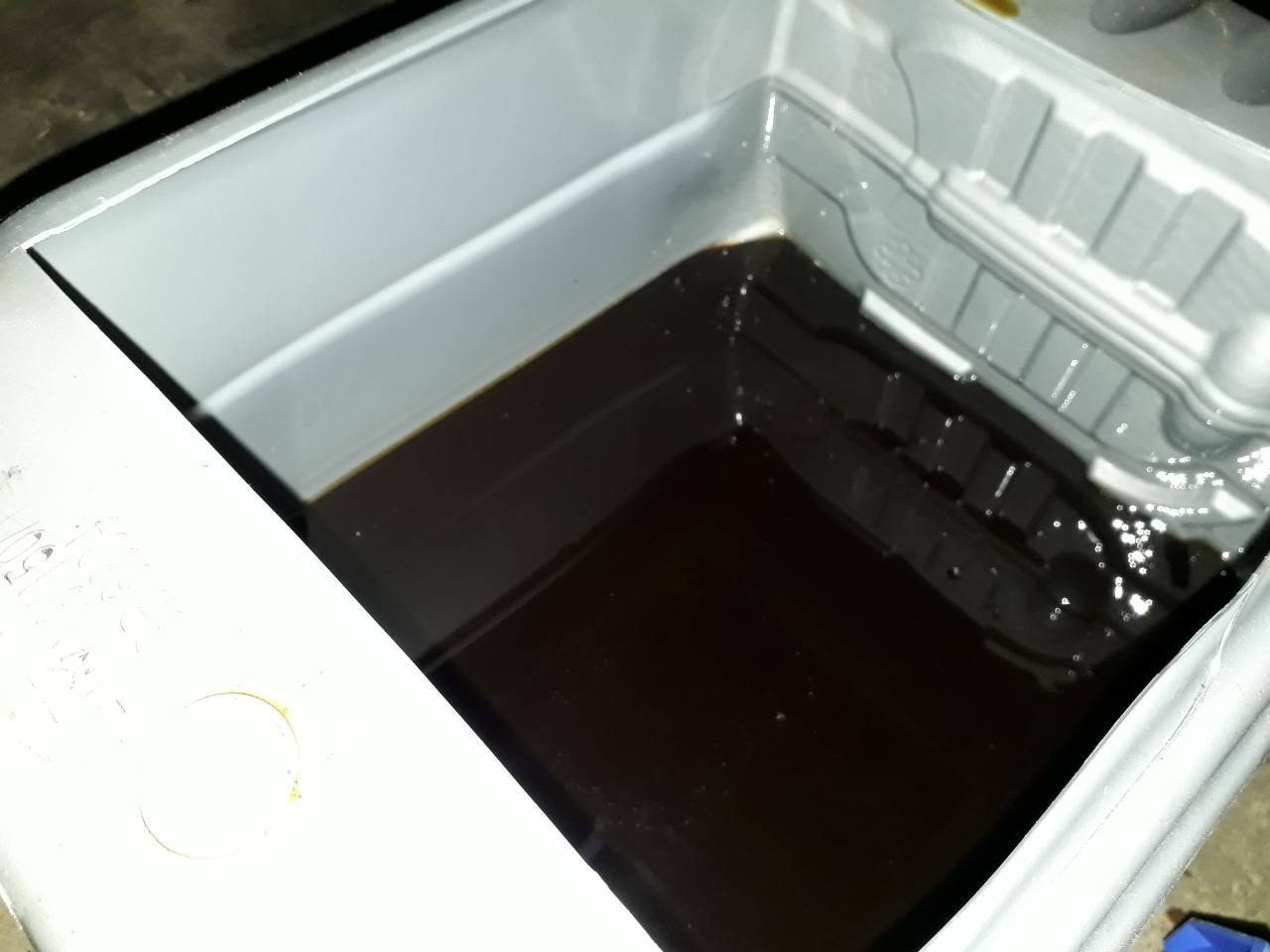

The filter is dated 1997 so its been changed at some point. Fluid isnt too bad but could be 20+ years old so maybe a bit thin now.
Filters been flushed out with brake clean. The pan will be cleaned and all will go back ln with fresh Atf. Will repeat again shorly after a few runs.
Not sure this is the cause of the problem but its the most basic place to start.

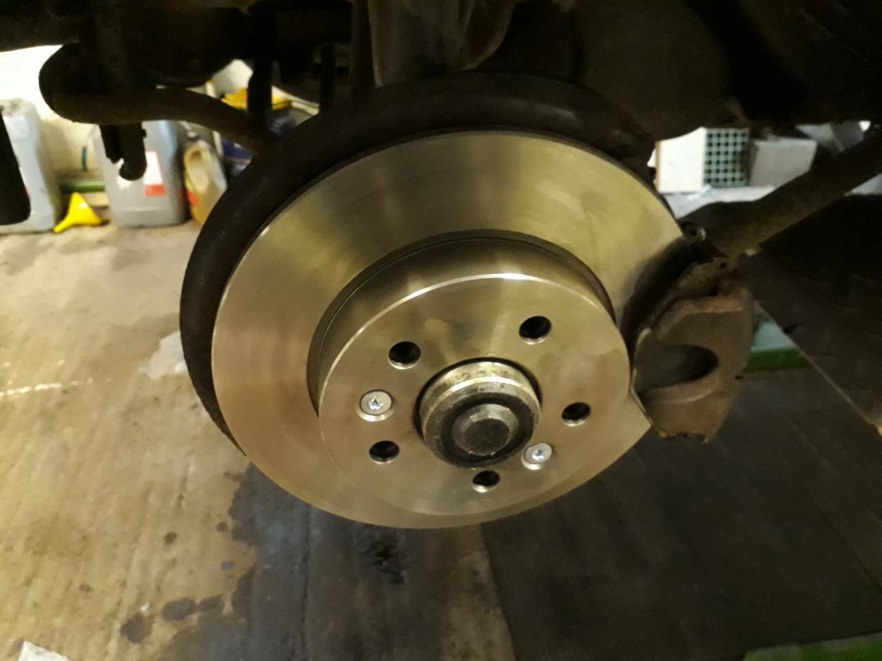

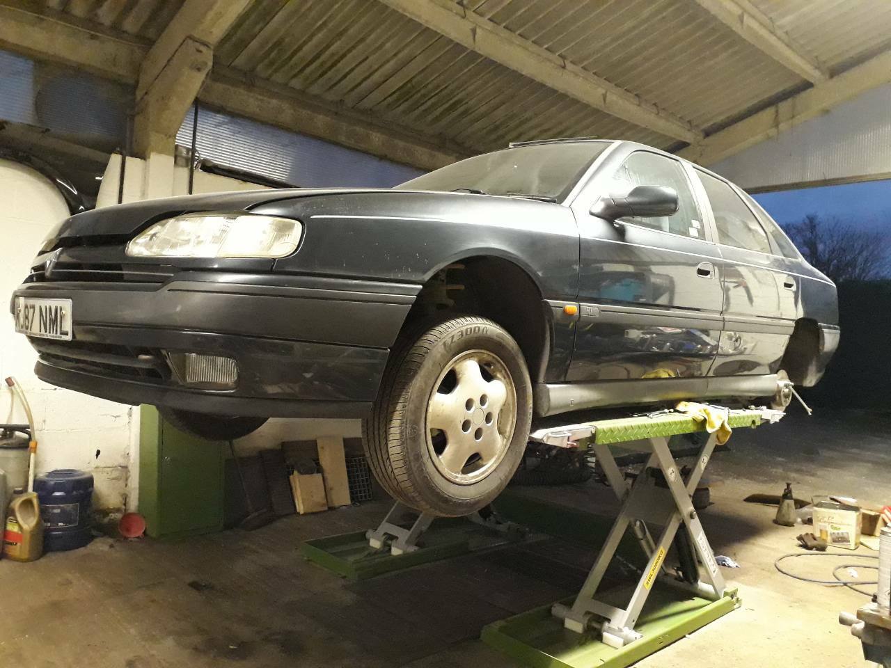

Today see the safrane up on the table again, wheels off and the O.s rear disc changed. The other retaining screws had been snapped many moons ago it seems so i ground them flush and drilled them out, followed buy a quick run through with the tap. I didnt swap this caliper over as it seems fine. I just fitted the used pads that came with the bundle of brake bits @Schaefft sent over. Hand brake cable was adjusted too.
Upfront the damaged caliper on the offside was changed for the good used one. I also swapped the new old stock recon unit for the other good used one.  Figured the new unit can be kept as a spare with the car. I pulled the new pads off and fitted the hardly used ones that were in the replacement calipers (genuine renault fancy!)  Figured the other pads can be kept for if the car gets new discs in the future.
Gravity bleed and a test drive up the yard shows all is well.
Next thing is to get that leaking tank thing out. Hopefully i dont have to drop out the driveshaft.

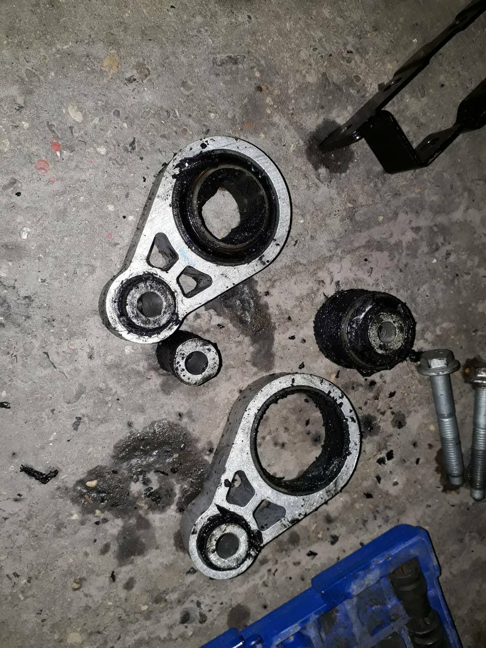

Those engine mounts are shockingly bad considering I can't remember the engine moving much with throttle.
The PSF leak was dripping onto them and had destroyed the rubber, turning them jelly like and peeling away.
