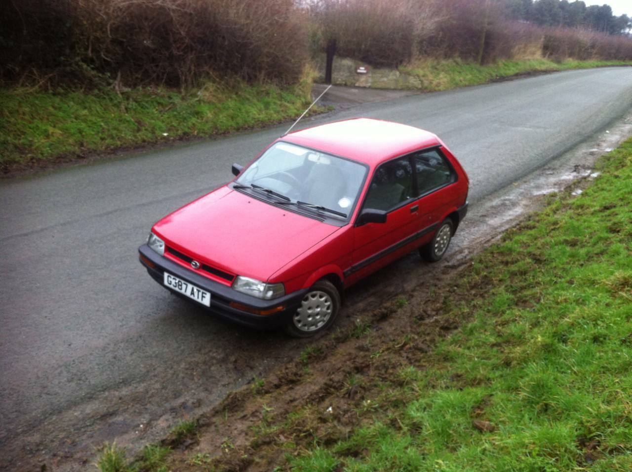

The next was my Suzuki Justy 4wd - bought with slight hesitation problems. I chucked some of that fuel treatment stuff in it, and it promptly never ran properly again. Could not get it running right and it used to keep running when turning off the key ending with an abrupt and very loud explosion from the exhaust. Neighbours got sick of it every night so I put it on ebay.

Saved from a banger racer only for it to refuse to accept my help to get it back on the road.
Eventually fixed by @BlankFrank by checking the timing belt 🤦

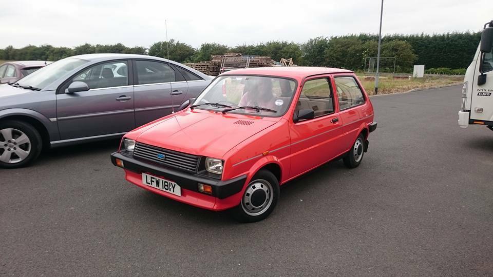

This Metro. The one car I've owned that I wish I hadn't sold. Absolutely immaculate, 20000 miles from new, spotless interior, perfect new paint job, faultless hydragas, and above all, absolutely no rust. The first tank of fuel I put through it, it ran like a dream. Then, it decided to be a prick. It started misfiring horribly. Checked and changed every ignition component, made no difference. Stripped and cleaned and re-jetted and re-tuned the carb, made no difference. Compression test came back perfect, of course. Eventually I got it running right from a jerry can of fresh fuel. Figured it must have been a bad batch of fuel. Drained the fuel tank, filled it with new stuff. Drove off, a few miles later, same problem came back. It turned out that, due to spending most of its life not being driven, the inside of the fuel tank was an utter mess, and it was essentially contaminating any fuel put into it. To get the tank out, you have to drop the entire rear subframe. I should have done it, but I was utterly sick of it after several months, so I moved it on to a Mini enthusiast who did eventually fix it. It's now in an indoor car collection I think.
