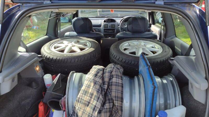

I started by collecting these:

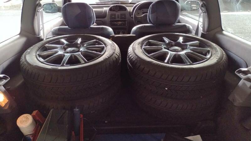

The tyres then got moved across to these:
The grey wheels were very very cheap. Because, despite all 4 tyres being absolutely perfect, one of the alloys looks like this:
Anyway, I now have some winter wheels sorted. Not just any wheels but another design of factory spec alloys for a mk2 Clio!

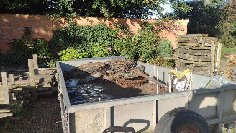

I put this much scrap metal into the 6ft x 10ft twin axle trailer in the space of about half an hour this morning. Ok, a few wee bits are mine...

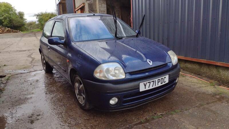

The Clio is officially doing my fucking head in.
Since buying it I have replaced:
- idle control valve
- spark plugs
- throttle position sensor
- manifold pressure sensor
- intake air temperature sensor
- crank sensor
I've also cleaned out the throttle body and checked for vacuum leaks, on at least the pipes I could see.
Yet, it still tries to idle at 0rpm when cold. I don't want a car that does this over the winter!
Are there any vacuum hoses on these Renault 16v engines that typically give trouble but are hidden from view?
It's booked into a local shite friendly garage on Friday, but any tips welcome at this point!

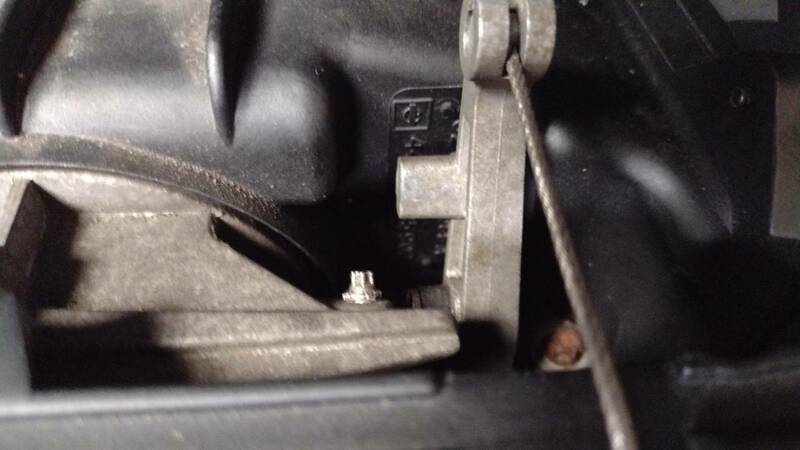

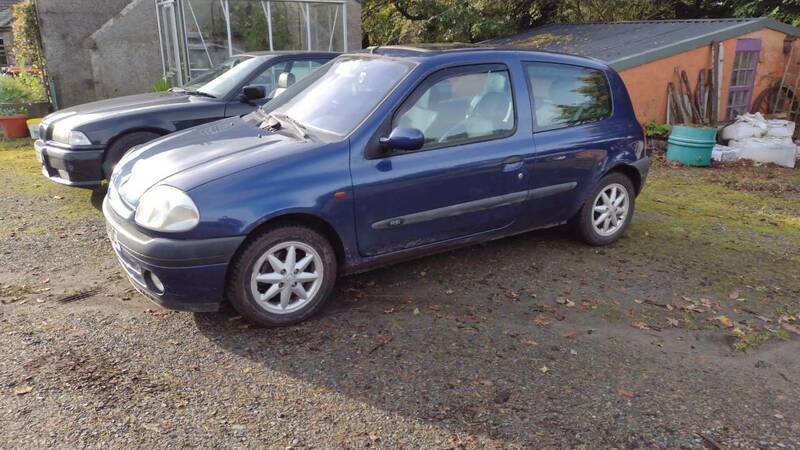

Well, that was easy.
You see that little star headed screw there?
That seems to act as a sort of pre tensioner on the throttle body. It was all the way out.
I walked out to the car when it was stone cold (switched off for almost 24hrs) and wound that screw in a fair bit.
Cranked it over and instead of cutting out, it sat at 1100rpm. So I backed it off a tiny bit with the engine running so it idles at just under a grand.
Took it for a drive to get it up to temperature and the idle speed has remained the same, so the expensive idle control valve is doing its job too. Back when I had a cheapy shit ICV on it, the idle speed would creep up as the car got warmer, y'see.
It seems to me like the car relies on having a fair bit of pre tension on the throttle body...

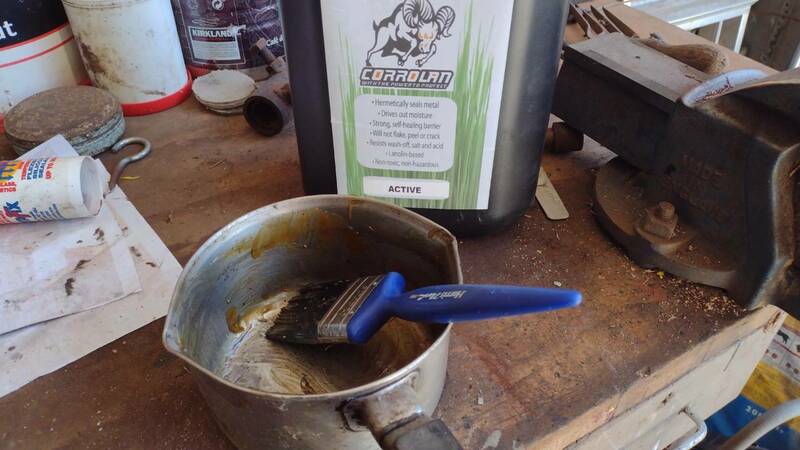

In the meantime I decided to throw some of this along the sills and inside the wheel arches.
It's really rather tidy underneath though. The body has many years left in it. At this rate I'll be researching engine swaps, however...
