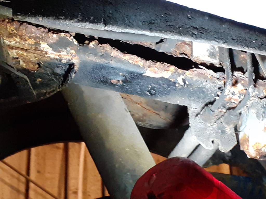

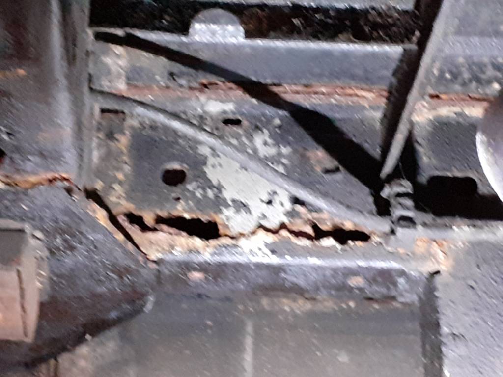

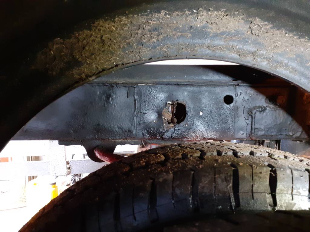

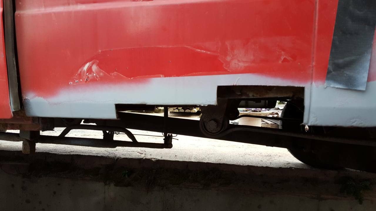

Joseph Posted August 15, 2021 Posted August 15, 2021 As per my title, I'm in a bit of a problem area. I have an old LDV Convoy recovery truck, which is in need of a lot of welding. Or plating. I can't weld, or plate, but I can pay for both. My issue thus far has been finding anyone to even look at it, I've been let down three times with local welders not turning up, and most recently the garage consensus has been that it's too far gone for them to even look at, after prodding with a screwdriver it is bad. Specifically, both chassis rails near the suspension points, and both inner arches and sills. One hole at rear chassis (which has been a factory hole rotted out). It is located on the west coast of Scotland, and I can assist with transporting it to wherever it needs to go, or picking up whoever wishes to look at it. I'll not have anyone out of pocket who can help me. Finally, please hold any 'set it on fire' or 'bridge it' jokes. If scrap is where its headed then so be it. But I'd bought this in 2019 to start a small business with, since then I've had my ramps stolen, a 'friend' badly rewire the lights and knackered the wipers, both of which I've sorted myself, and then covid hit. So I've lost a fair amount of savings with this. Please see pics, some aren't great but I can try and get more. Thanks for anyone who can help. Sent from my SM-A105FN using Tapatalk GingerNuttz, BorniteIdentity and TrabbieRonnie 2 1

jonathan_dyane Posted August 15, 2021 Posted August 15, 2021 I hate to say it but it would be considerable cheaper to buy a new truck that wasn’t rotten than it would cost to fix this properly. The danger is you pay £££ to get it repaired but they just plate over the rust and it doesn’t last. Or the chassis snaps at an inconvenient moment and VOSA tear you a new arsehole. Sorry. BorniteIdentity and twosmoke300 2

Mrcento Posted August 15, 2021 Posted August 15, 2021 As others have said, finding anyone to weld anything on a car is a nightmare/nigh on impossible. It really is DIY only now. You strike pretty lucky if you find a garage even willing to plate something now. Most just say no, get rid. Almost nobody will touch that sort of work professionally, Too much time involved, too much labour, too much cost to the customer by the time a can of worms is opened and the customer has a 2k bill instead of a £300 one, all at a time when garages could be using the ramps to do 8 or 9 simpler, less risky jobs that they know they'll get paid for. Honest opinion on that LDV? Too far gone. Anything is fixable with enough time, skill and money, but that's a massive undertaking. Can see bits have already been plated before etc, realistically by the time everything was taken back to really good metal, you'd be near enough fabricating a new chassis for it. For someone suitably skilled, it's probably not the worst thing ever to fix, but you're still looking at so many hours to get it done right, it's just not that realistic. I really hope you can find somebody, though.

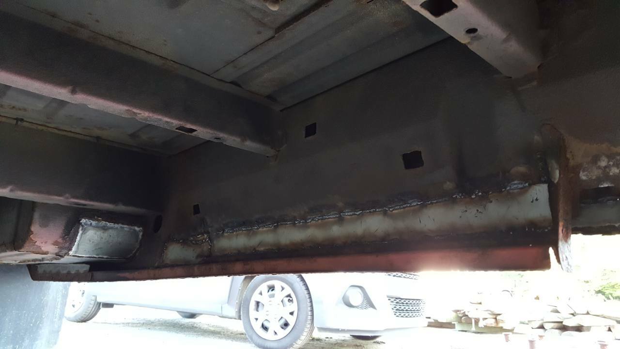

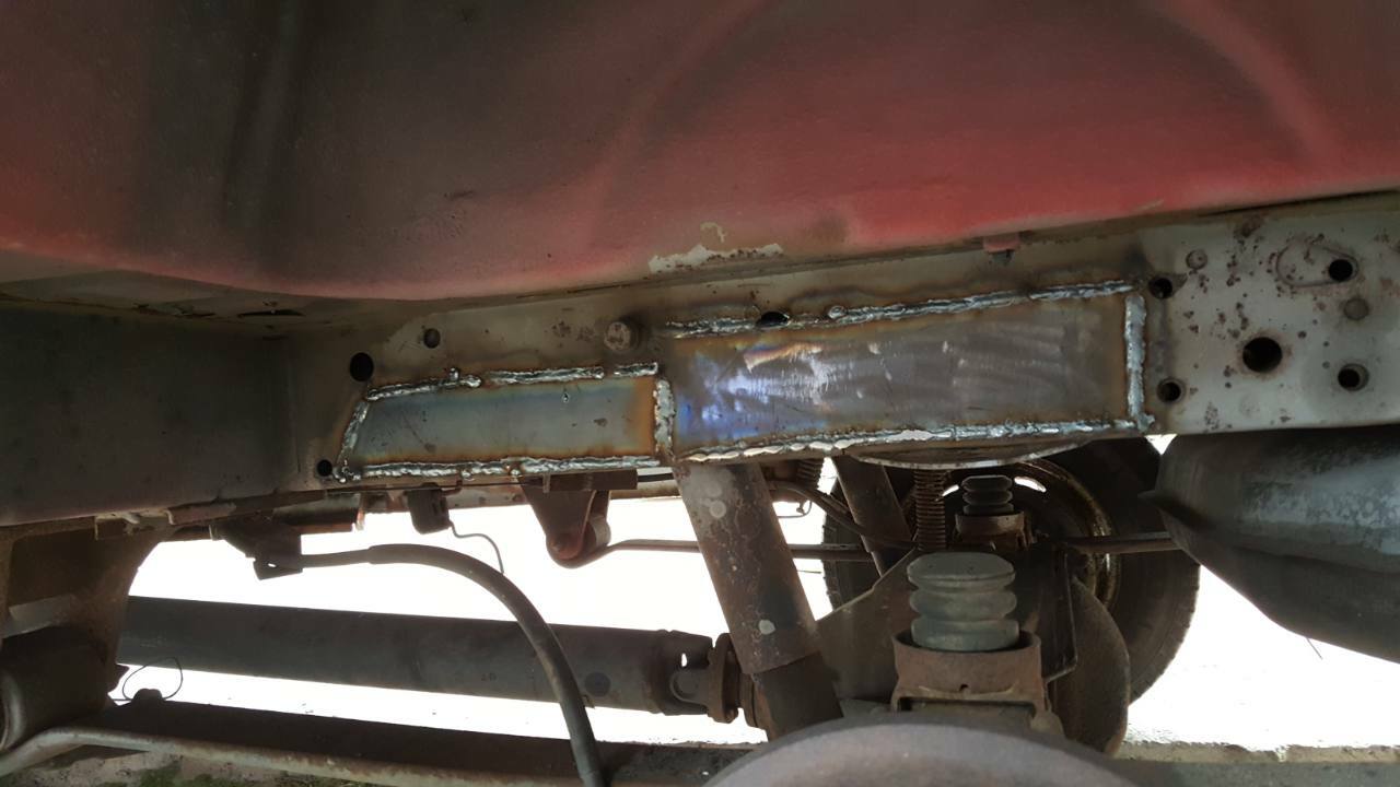

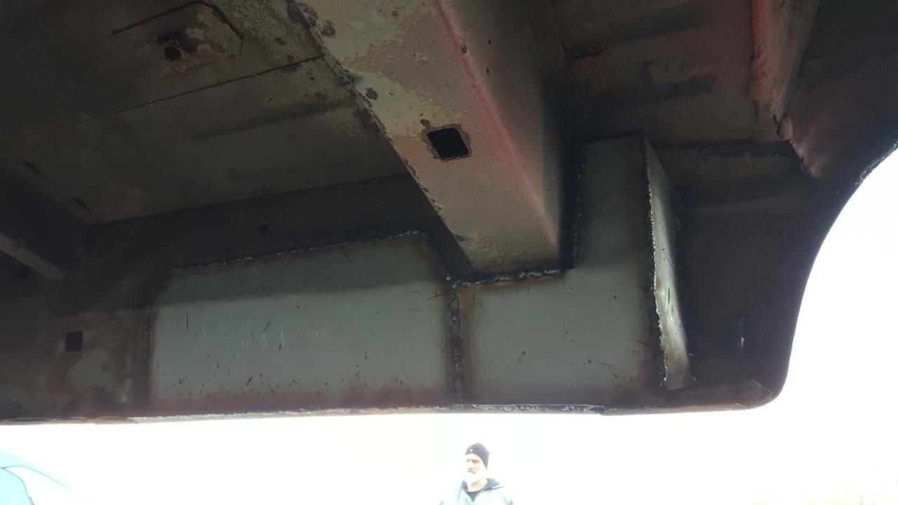

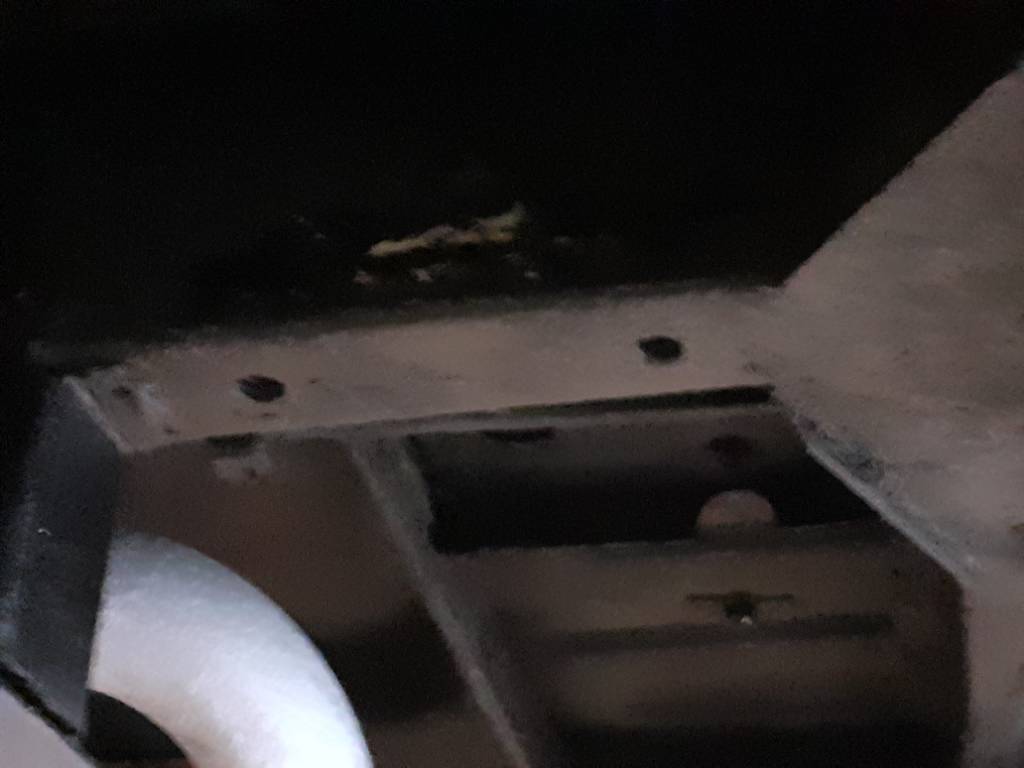

Scruffy Bodger Posted August 15, 2021 Posted August 15, 2021 LDV chassis are double thickness in places. Water gets inside and they delaminate between the layers, it blows itself apart. The 6" of visible rot ended up being an over 2' repair. There's actually 2 more plates under the ones you can see there. If you do find someone to do it get it shotblasted first so they can actually see what they are dealing with and the welding job will be night and day better with all the shit removed. They can be repaired but it's not an economic decision. Plus it's got to be said, looking from just those few rough pics you've put up that one is pretty far gone I'm afraid, you need something somewhere that's good to weld something to. sdkrc, Leyland Worldmaster, rml2345 and 3 others 6
Scruffy Bodger Posted August 16, 2021 Posted August 16, 2021 He likes it. Had it getting on 15 years, lived in it for quite a while on and off. He blew a couple of grand on getting it welded and tarted up. The vast majority would have scrapped it. The banana engine being its saving grace. Split_Pin 1

captain_70s Posted August 17, 2021 Posted August 17, 2021 There's a fair few days worth of work in getting that sorted, even before prodding. The issue is that where it's holed is one thing, but the area surrounding the holes is likely going the same way and will be too thin to weld to. I deffo can't see it being economically viable, even at "mates rates". It's fixable, but only if money/time aren't major limitations... Scruffy Bodger, Split_Pin and sdkrc 3
