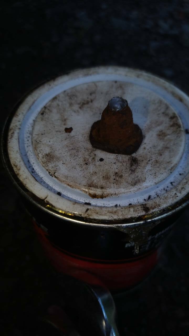

Well I thought I'd remove the discs today and give the slide pins a greasing up.
One was sliding fine and the other absolutely solid, no problem , I'd just rotate it and it'll be loose in no time....where's that 17,, spanner?
Take that!
It does look somewhat corroded under there but appears to be relatively solid?

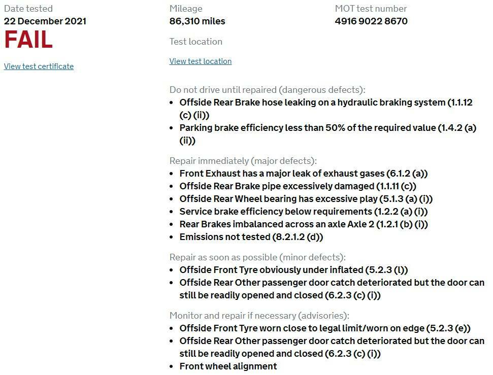

This was the outcome of the MoT.
Not as bad as it probably sounds.
The rear hydraulic hose has collapsed restricting the flow of fluid - a new one on eBay is £10.
The wheel bearing needs replaced, roughly £12 on eBay
Exhaust front section is £24.75 online but it's possibly a clamp that's required.
Door handles are about £3 on Aliexpress.
I looks quite a long list to me but no reports of corrosion, which is something...

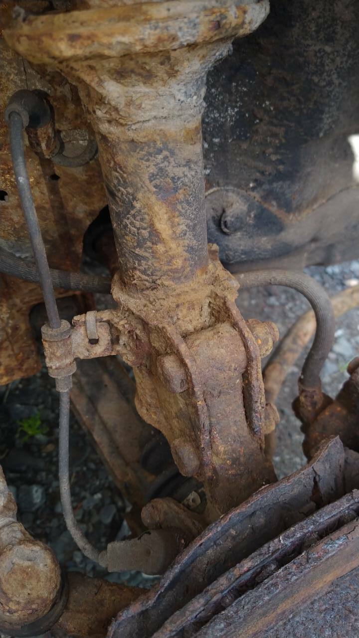

Today was meant to be the day my little 55 plate Alto was being re-tested for the MoT.
I've just been told that the jack has gone through the rear end of the car and that basically it's toast!
I find it strange that there was no mention of corrosion during the first MoT for this to happen but that's where we are now.

I'll be getting the car back next weekend and will have a decent look at the underside.
The chap that wanted to borrow the car for his daughter, popped in for a cup of tea today and I'm wondering if it was more a case of being sensible, rather than terminal rust now.
The garage was going to charge him around £400, on top of the MOT fee to do the repairs, which, would be somewhat mad for a car he wanted to borrow for a few months use.
Looks like a scrap car goes for around £150  right now, so I'm still at roughly half that value with the work that I've done.
