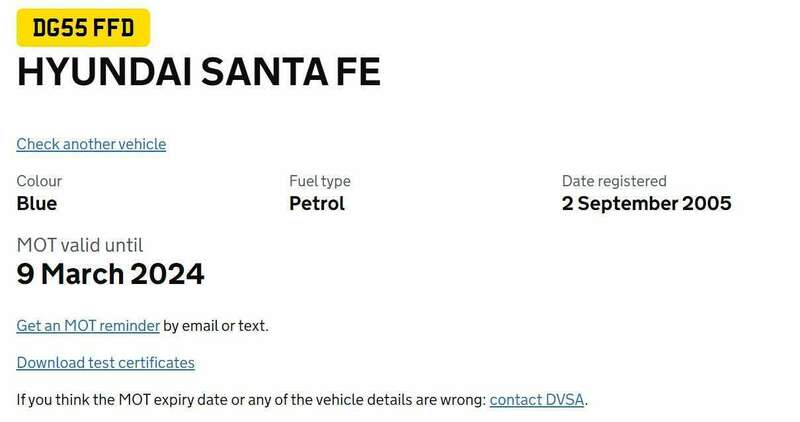

The Santa Fe was in for its MoT test today. Good news, a pass with only one advisory which was the same as last year (play in a ball joint).Capture.thumb.JPG.30c61b88d59294760608abf7c72c57fc.JPG
I have had a problem with squeaky suspension. There must be a dry suspension bush somewhere on the front end. I've sprayed all that I can access easily with GT85 and it has made it quieter but I know that it is not a long term fix.
Suspension squeaks can be caused by ball joints, makes sense if you've got one worn out that's been advised
Jack up each corner and then very slowly lower the jack, you'll often get ball joints to creak when doing that, if they're going to do it
Other possibility would be anti roll bar D-bushes

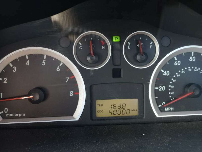

So this happened today, 40000 miles. Possibly the lowest mileage Mark 1 Santa Fe in the UK?
Thought of the day....we know that speedometers have a -0/+10 % tolerance on them so does that also mean that the odometer does too? So 40000 miles could actually be 36360 miles?
No, the odometer is more accurate, it's only the tyre diameter that mucks that up if you fit non-standard sizes.
