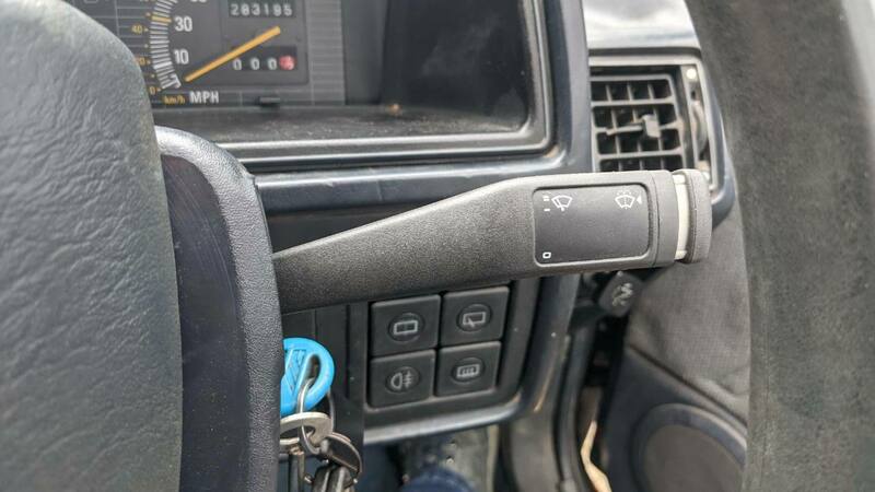

In with the... Wait a minute... That's not right... Why are the washers on constantly...
Bugger. Got to love eBay listings. Basically I've ended up melding the two together using the base plate from the old stalk cleaned up with a light sanding, rubbing alcohol and conductive grease and then used the new stalk with the old base plate. The eagle eyed may notice the new stalk is without a downward position on the stalk. I bought a stalk that was advertised as Metro/Maestro/Montego and did spot it was a non-intermittent stalk. As this car doesn't have intermittent wipers anyway I didn't see it being a problem. The down position on the original stalk was actually the same speed as the slow speed up on the stalk.

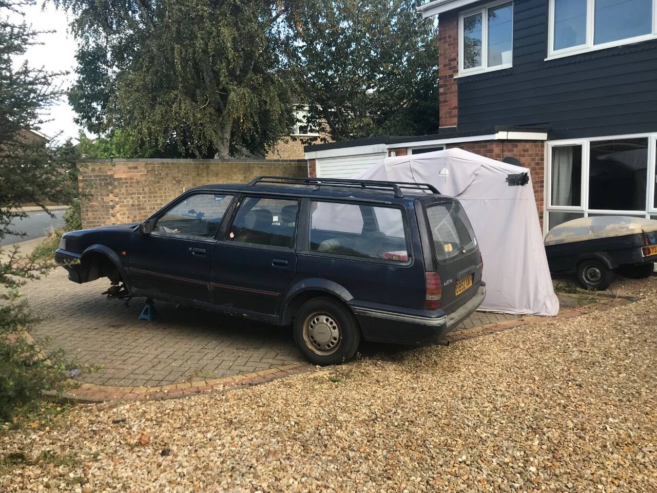

This morning I set to getting the hubs fitted again. I also changed the track rod ends as I had some and they were a bit loose. Treated it to some new discs too.

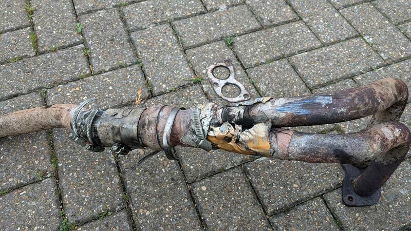

Finally I risked the manifold studs and took the down pipe off. It came off quite easily but I did preheat the studs with a blow torch before I even tried them. It's definitely showing a few battle scars from our trip!

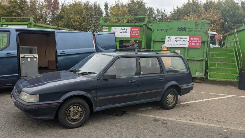

And once it was all back together I treated it to having a load of crap thrown in the cavernous boot and a trip to the local tip! Ran really nicely and it's nice to not hear the exhaust or any ticking from the Speedo!

The downpipe was my doing after it blew on our trip up the country. It just kept blowing and blowing the further up the country we went 😂

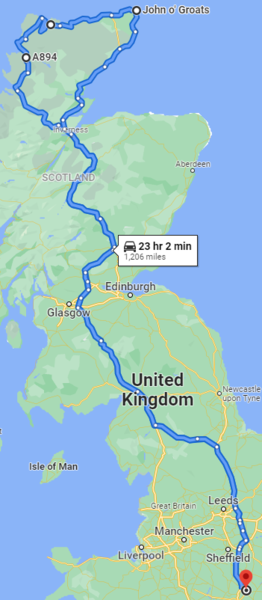

So @sharley17194 and I are in conversation about finishing our LeJog trip properly. However we are both short on holiday so.... JohnO and back in one weekend including getting to the point I broke down? Seems reasonable...

Honestly I enjoyed the overall experience, especially as we took costal roads through Cornwall/Devon/NC500, but I would say that it is A LOT of driving if you do it in one person per car. Obviously actual LeJog can be considerably shorter if you stick to the motorways and a direct route but its not particularly interesting if you do that. The blast up the M6 to Glasgow was a quite tedious day. The advantage with this go is that @sharley17194 and I will share the driving which obviously halves the load!

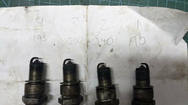

Despite all the work I've done to the car I never did a compression test. Thought I'd check the compression and plugs before we do lejog part two. Needless to say it's pretty good! 190-200psi across the board. Plugs are quite sooty, although 3 and 4 have a slightly browning to them, it clearly runs rich so I've dialled a little bit more fuel out.

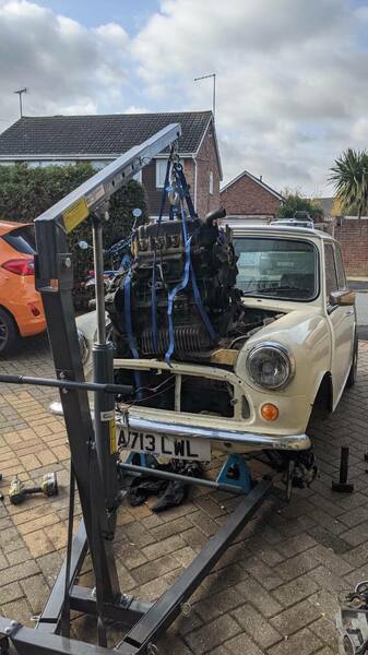

  • Tommyboy12 changed the title to Austin Montego 1.3 Estate - More Mini action

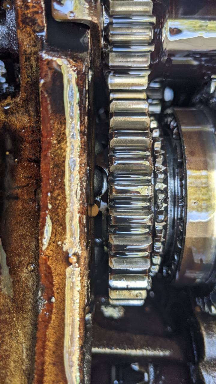

So what I really needed to do today was replace the throttle cable on the Montego. Which is about a 10 minute job. Instead I spent three hours doing this.
  • Like 9
The reason I did it was several fold. This is an 80k engine now so a bit long in the tooth for a non-rebuilt engine. I've abused it some in the last 6-7 years of ownership too and only ever fed it the finest quality bottom shelf oil of random viscosity.
It smokes, blows headgaskets on the regular, has very positive crankcase pressure, and the gearbox was whining in 4th which is a really bad sign on these.
I found the following.
Cracked.
Ruined.
Collapsed.
The block is scrap. The crank needs a regrind as the mains are shocking and the big ends are no better. Might explain the suboptimal oil pressure. That bearing in the gearbox is the main double roller bearing that supports the entire motion shaft. Needless to say it should not be poking out the side with a cracked cage.
However, I will say one thing. The A series is a damn tough engine. It had no right in running with a cracked block and that gearbox whined but was otherwise fine.
