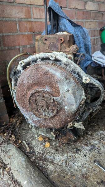

So I have a spare Mini 998 auto I am stripping for spares for my budget build. I was told it was seized. Needless to say I didn't expect it to be *that* seized.
I'm hopeful the crank is salvageable as it's only a 44k miles engine but I'm not 100% convinced. Things like the timing cover and bracketry will be used as well as the manifold.

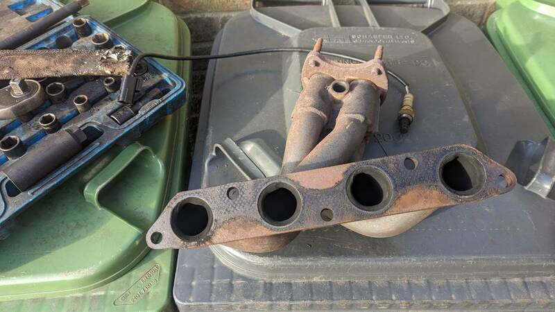

Busy day of MG Rover licking. I started on the MGF. I swapped the lambda sensor (again) and fitted new exhaust gaskets (again). Now it runs even worse! It's gone from hosing fuel into the bores to running on 3 cylinders. I suspect the plugs are fouled up. I've ordered another set rather than clean them up as I don't know the age of them anyway. Failing that the coil packs are buggered. Why that has happened after changing the lambda I don't know but ho hum.

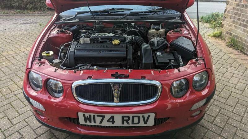

After much cursing I moved onto the Rover. I continue to be impressed with how clean it is considering it's a communal bike, I am the 17th owner!
First off I was told about an oil leak from the cam cover. Which I can 100% confirm that was the case.
Thank you for whoever fitted three different bolts on the coil cover. I salute your efforts to find bolts that fit. An 8mm, 10mm and a star head! 😂
The cam cover leak might have something to do with the fact that every bolt removed in this image was finger tight. It was held tight by 4 of the 15 bolts for the cover...
I did change the gasket as it came to me with one anyway. I also tightened all the bolts so it hopefully won't leak anymore!

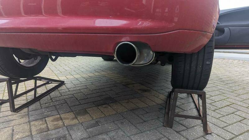

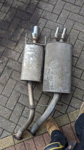

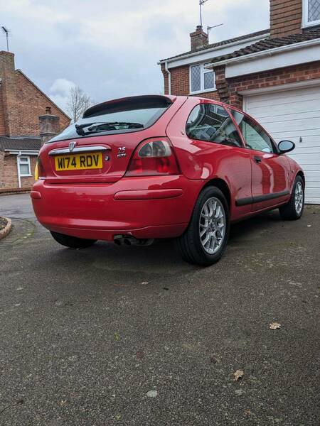

Then I set about making the car 'worse' by refitting the sports* exhaust it came with. It's got no mid silencer and a much smaller rear silencer and it sounds very rorty! Really easy job compared to some cars I have done this too.
Big boooore
Don't worry. I'm not throwing the other exhaust out, or any other parts I remove. It'll go to the next unfortunate soul winner of the roffle.
I also fitted a hot air intake for extra intake roar.
Again, I'll keep the standard air box for whoever has it next.

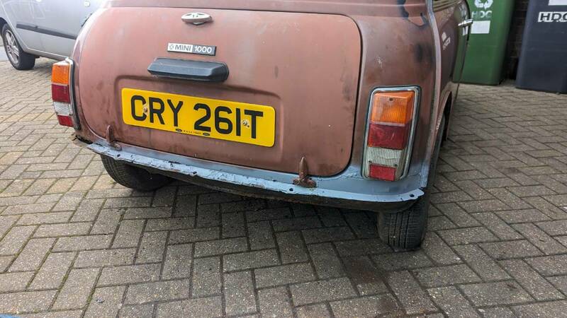

The weather was half decent today so I cracked out the welder on the brown Mini. I'm meant to be driving this to Germany in 112 days. It needs a lot of welding and an engine building for it first 😬
Started at the back cause it's a fairly easy repair. The subframe mount is in good nick it's just the floor around it that's gone. Same on both sides. It's had a new valance and closing panels in the past so they're pretty solid. Its also taken a knock on this corner at some point and the panel is dented. Thankfully the car came with plenty of panels.
In progress
It's not finished but it's water tight again. It needs a bit of weld dressing, filler and paint and that should see that corner done. It needs the centre hinge panel replacing as well as grinding some of the paint off revealed plenty of holes. But for now I only had time for the corner.
Next is the centre hinge panel and left side. Hoping to do that done over this next week. Then I need to move onto the rear floors.
Had to sweep up after myself also. Typical Mini...
