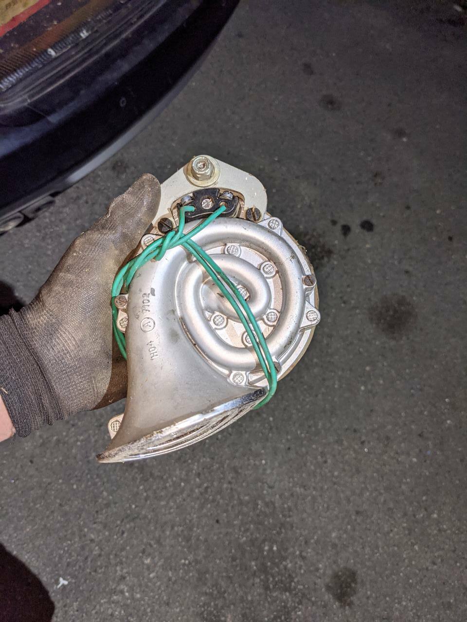

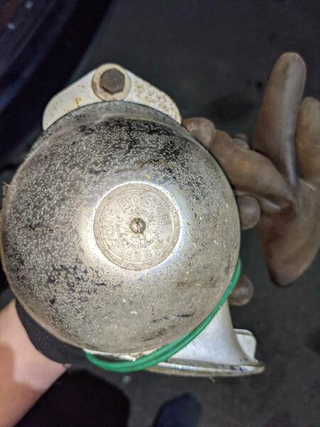

While I've got your attention and I know you're pretty clued up on really old stuff, do you have any idea what this Bosch horn and what it could be off? It was in the stash of parts that came with my Moggie.
Markings say Bosch HO/ESA6B16.

Scrolling back, that horn looks almost identical in casting to the Delco horns I've got on my Pontiac.
An A/B pair sound good, a deep, oboe sounding parp from each at a slight discord is enough to wake most people out of their driving slumber.
Requires a relay
