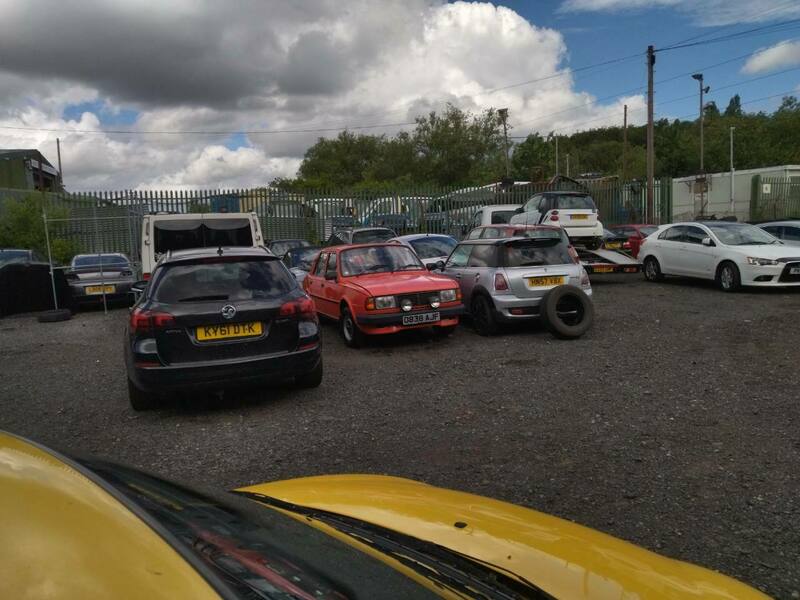

Bit of a mini collection caper today. Always nice to collect from somewhere with a car park like this:
very nice.  I really need an Estelle in my life at some point
