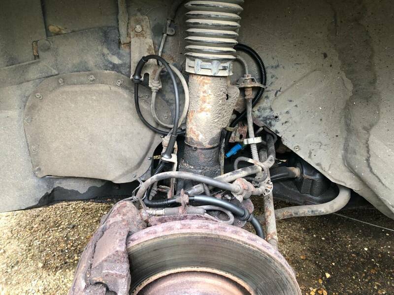

Even more of a result! That’s the replacement abs sensor for the front of the XM - that was the one that was open circuit.
Best get it swapped out then.
First though, I noticed a pool of green as I jacked up that corner.
I found that the clip holding the return line onto the strut had somehow come undone:
It’s held on by a clip that’s like a CV boot clamp but worse, so it’s got the default treatment for now:
On to the sensor then.

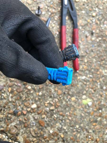

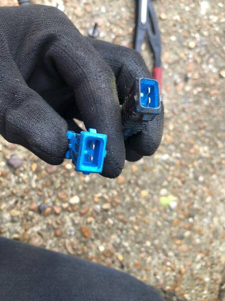

The old one was grotty:
But came out no bother. It’s a replacement part itself, which probably helped.
for anyone doing this who use replacing the original green connector sensors with blue ones, note that you have to shave off one tab from the plug. I didn’t see this mentioned online and initially I thought I’d bought the wrong thing.
I tested the resistance and read the codes from the ECU before swapping the whole thing:
plugging the new sensor in cleared the code for that corner immediately, so I carried on and fitted it properly.
The air gap isn’t right, but I can sort that later with an angle grinder.

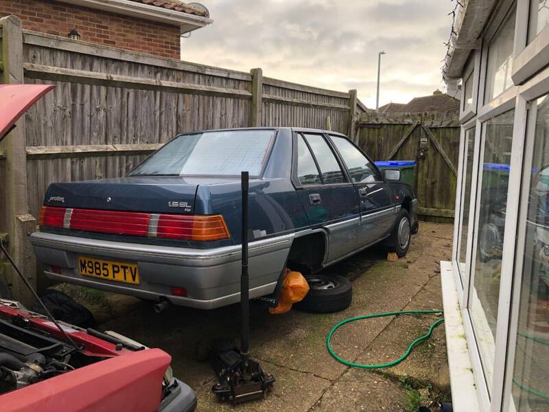

The rear sensor looks like a fucker to replace, so I wanted to get the car stripped down ready for the replacement. This is the corner that has continuity but the resistance is out by about a thousand ohms.
I don’t like stripped down cars sat out the front of the house, so I needed to swap the XM with this
luckily it only took 5 minutes to throw the proton back together, and it fired into life no problem.
Then, after reversing the XM into its place, I noticed something odd:
The ABS light has cleared.
Ive tested it on a few ignition cycles and currently it clears without fail.
No idea why, as I’ve not don’t anything else apart from clean the rear sensor connector the other day, but I’ll take it.

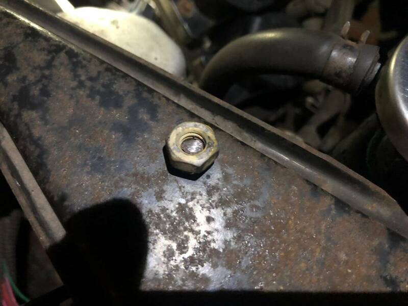

XM update:
I’ve chucked the nut back on the linkage and it’s now good enough. Job done for MOT time and I’ll definitely revisit it later when I can be bothered to sort out the park position 100%

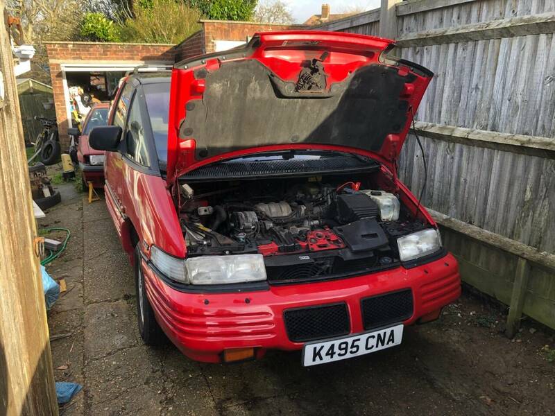

Pontiac update:

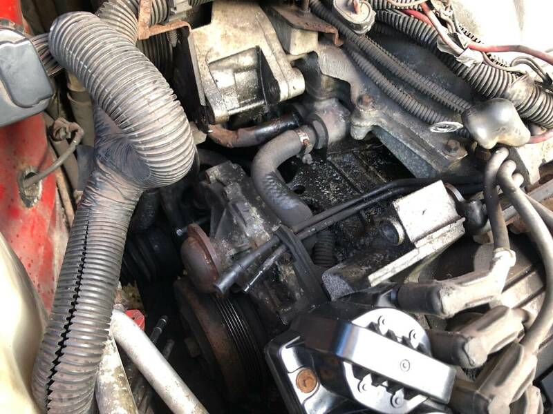

The water pump arrived the other day.
The pump is held on by 4 large bolts and 4 small bolts. The new pump comes supplied with 4 small studs. That’s ominous.
Theres definitely coolant leaking out the weep hole though so it needs to come off.
My suspicions were correct and the small bolts are torqued down pretty tightly and bound pretty severely with corrosion. Despite my best efforts, one sheared. That’ll give me something fun to do later then. I then let a second one shear, as I was fucked off and thought if I’m removing one snapped bolt anyway then I may as well do it twice. Fucking exceptional logic.
Seeing as this would likely involve the welder and loud swearing I decided that I’d do some car shuffling to put the Pontiac in a place where neighbours can’t stare at me out the curtains.
I pulled the alternator out to make some space
Out with the old
You wouldn’t believe how much that resisted parting from the engine. A drift on that cast ear eventually got it free.
My secret shame:
Whilst looking for a spanner I dropped, I noticed something flapping around by the cooling fan.
NOT NOW EXHAUST SHIELD! I’ll sort that later. By sort, I mean possibly jubilee clip on or more likely launch into a corner as it has completely dropped off.

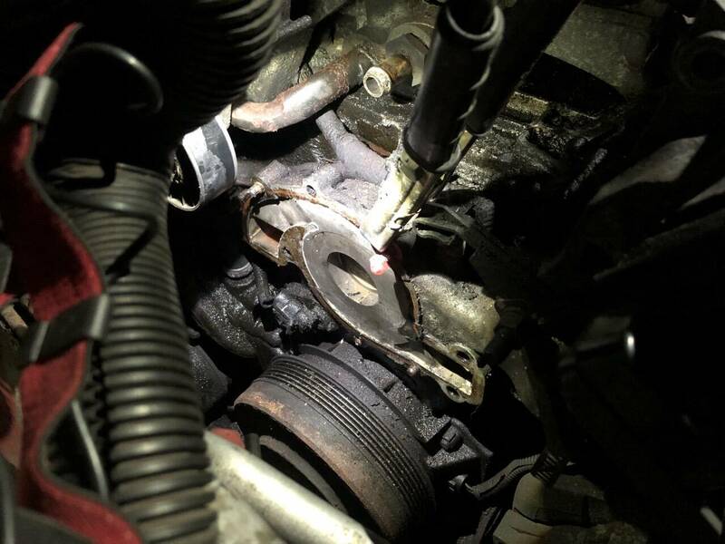

I had a half hearted bash with mole grips but no dice. Not giving up, I armed myself with the welder and a the remains of a bottle of gin.
Wanker:
Each time I welded a nut on, despite working the remaining stud gently with a spanner, it shears in line with the nut.
The studs are getting shorter and shorter, soon I’ll be at the point of no return…
I’ve welded on the last pair of nuts that I reckon I’ll get on there, and they can sit overnight.
I really didn’t anticipate the Pontiac giving me more grief than the XM.
Wish me luck for the morning!

Might be worth getting the blow torch out before snapping it off further. Heating them up and a few strikes with a hammer can knock them lose enough to hopefully come out without further pain.
The space looks bigger than it is in that photo - there’s no room to hit the studs along their axis unfortunately and I’m loath to strike the aluminium casting around them. I was really surprised the heat from the welder didn’t break the bond, it normally it pisses it. The state of the shite on the threads of the other bolts was pretty bad to be fair though, looked like they’d been dredged out the channel. Imperial sizes too so I’ll have to get new taps and dies.
Using a 1/2 inch extension held against the studs that you can hammer on might be all you need. Anything that sends a few shocks down them really.
I’ve been out and given everything a shock as best I can with a drift. Still shearing off a few mm at a time sadly.
I’ll keep going (but not today as I’ve got to go and see family) and maybe once the protruding section is gone then I’ll have more luck with welding onto the seized section in the housing.
If not then I’ll have to take a look at 90 degree drill chucks and see if I can drill them out in situ.

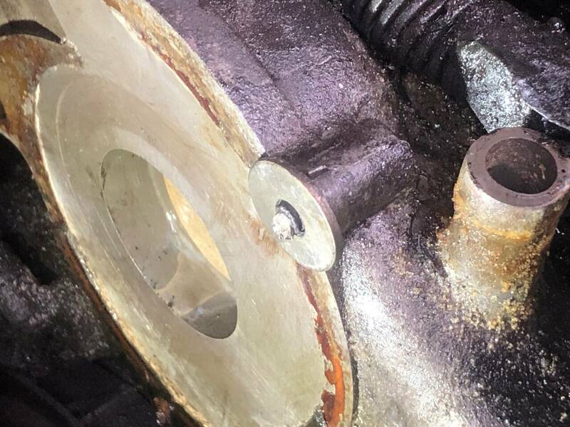

The family visit got pushed back slightly so I thought fuck it, it’s time to break something.
Persistence with the welder has begun to pay off.
That’s one out. One left to go.
And let’s not think about how much heat I’ve put into a machined aluminium face that needs to seal watertight.
Could a grown up tell me if this is a bad idea or not?
I’m thinking to weld a large washer onto the small amount of protruding stud, as this should be easy to weld to. I can then build the weld up so that I can put a nut on and weld that to the washer and stud combo.
It'll be the heat cycling that will help...... The contact to the stud itself will still be the same area - you'll get more leverage perhaps.
The washer idea will at least cycle the extreme temperature more often - but you're putting a larger amount of heat through the casting...... How thick/thin is it?
That's probably not a bad idea in my books!
What *sometimes* works is if you cut a vertical slit into it and then try to gently undo it with a flat head bit in a 1/4 drive ratchet.
Unfortunately it doesn't look like you've got as much to play with there as I'd like when trying that method
If you go as far as drilling into it, to save having to create new threads afterwards I would try one of those screw extractor bits as one final attempt of extracting it
I'd try heating the casting up with something like a small blowlamp (I have a chefs one)  you might find it will then unscrew with a pair of pliers.
Surely that is a separate casting - how difficult is it to unbolt it from the block?
I couldn’t leave it alone earlier so I did have a go with just a nut again earlier. No dice - this time it’s lack of penetration.
 @Back_For_More @RoverFolkUs yeah that was my thought, should be able to get some good penetration on the stud by blasting it with the washer around it so that I’m not worried about hitting the aluminium. Added bonus of heat cycling as you say.
Those things give me The Fear, big time. I think they’ve shattered every time I’ve used one and they’re wankers to drill out.
I think there’s a propane torch in the garage somewhere so I’m thinking to get some heat into the stud before welding it next. Then let it cool and blast the casting with some heat before giving it a go at undoing.
I’m not 100% sure but it’s gone through my mind. It’s one of the nuclear options if the welder doesn’t bear fruit tomorrow.
Have you tried swearing at it?
Seriously I had similar japes with my Maestro exhaust manifold studs and ended up drilling them. Although with hindsight a welder probably would have been the best approach. I think it's a perfect storm of rust expansion and aluminium corrosion.
Is there any room to drill and tap to slightly larger metric size?
Don’t worry, I tell it how much of a cunt it is every time it doesn’t come out 😂
If I can get decent penetration into the bolt then I reckon it’ll either come out now that most of the stud that could twist/flex has snapped off, or it will snap flush with the block.
Along with decades of galvanic corrosion (the pump has a manufacture stamp of 1996 on it) there’s also a load of RTV in the threads for good measure.
I reckon there’s space to use a 90 degree chuck but not sure how conducive that will be to drilling accurately* and not more on the piss than normal.
The current bolts are something approaching M6 size, I’m sure there’s enough material in the casting to go up to M7 or M8 if I drill it and tap it.
If you were really up shit creek then I reckon you could drill out the back of the casting and use a nut and bolt on it.
