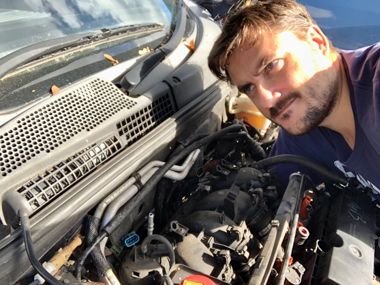

The top:
If you have x-ray vision, then you’ll be able to see that the alternator is under here:
After taking the dress-up cover off, I noticed that two of the injectors are a bit wet. I’ll be replacing all these o-rings anyway, so I’ll keep an eye on this once the car is in use:
All the clips are this type, I’m not sure how I feel about that - I reckon it might be worth buying the right tool to refit them:

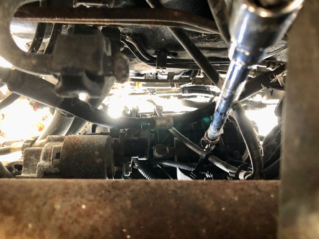

The top of the manifold is held on by 13mm bolts at either end. One is ok to get to:
The other is one of those bolts that’s so cleverly* laid out that you can only access it by laying across the engine bay and giving the engine a reach around:
But wait, there’s more! Grab every extension you own, roll under the car and remove two 15mm bolts that are holding the bottom of the intake to a bushing:

Jumping back to the Alfa again, seeing as I ran out of distractions, I pressed ahead with looking at the fuel lines. The line is a single run from tank to fuel rail, with no return, and is nylon up to the engine bay, then steel up the bulkhead, before switching to rubber as it crosses to the rail. It is of course absolutely buried in the engine bay as it makes its way through.
The start of the metal section is exposed to spray from the offside wheel, and looked most suspect. I wire brushed the rust off, and this caused the evap line to disintegrate:
I moved it, gently(ish), and it snapped.
Oh well, it's just the evap line, looks like the fuel line is saveable at least... Let's just prime the pump again to check.
Mwahp-mwaaaaaaahhhhh.
I went under it last night to try and remove both lines - I failed due to poor access, and I also got a fair old glob of petrol in my left eye. That really hurt, and I'll definitely wear safety specs next time. Probably. Maybe.
I'm pretty sure that at the very minimum, I will need to remove the inlet plenum again in order to make enough room to get the fuel lines out. I will also need to remove the track rod end. I will also also need to get my head around how I'm going to replace these lines which are made out of a mix of materials - not knowing how the car was put together when I got it, I was assuming it would just be a case of splicing in some cupro-nickel and being away. My plan is to remove the lines from where they transition from nylon to steel, look at how the originals were assembled and then see what can realistically be done at home. Replacement used lines are £150, which I'm just not ready to put into it at this point.
