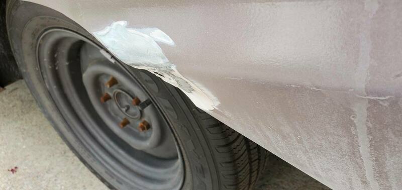

PhilA Posted June 30, 2021 Author Share Posted June 30, 2021 Yesterday started like this: I decided to take a look at the "repair" to the left rear quarter, as from inside there was less of the original metal left. I uncovered the seam where the new metal had been added. Very strange, right on the top of the swage, but looking inside showed the swage was still there underneath. Couple of pounds of filler on the floor and the whole seam is available to view. Tack welded on. Zip, clatter. Cleaned up a little, you can see the original coachline of the car, albeit wavy. Much better. Worse, but better. The whole back end of the car was filler as I worked my way up. Really quite thick, too. It continued, in geological looking strata. That's as far as I got, ran out of time and my angle grinder was getting too hot to hold. Sprayed a bit of gloss on, and that shows the story of the panel. Best I can come up with is someone put a ratchet strap all the way around the back too tightly and dented it all to hell. That's going to be fun to bring back to shape. I'll carry on pulling the Bondo out before I start on that... Phil CGSB, Dick Longbridge, loserone and 15 others 16 1 1 Link to comment Share on other sites More sharing options...
sutty2006 Posted June 30, 2021 Share Posted June 30, 2021 Holy crap that’s a lot of cag……. PhilA 1 Link to comment Share on other sites More sharing options...
eddyramrod Posted June 30, 2021 Share Posted June 30, 2021 Looks like what I found in my Cyprus A40! PhilA 1 Link to comment Share on other sites More sharing options...
danthecapriman Posted July 1, 2021 Share Posted July 1, 2021 You’ll massively improve the cars gas mileage too if you keep grinding out all that plop! The thickness and sheer amount of filler must be adding an awful lot of weight! It’s similar to what I found on my Capri, someone had replaced the rear arches way back whenever but instead of cutting the old ones off and seam welding new ones in they just cut the old rotten edges back then put the new arches over the top and tack welded them in place (lap jointed!) then plastered the rear quarters in filler to hide the joint. The thickness of the filler in places was incredible. How it didn’t just fall off under its own weight I don’t know! Anyway, keep it up. It’ll be a great car once your done. eddyramrod and PhilA 1 1 Link to comment Share on other sites More sharing options...
PhilA Posted July 1, 2021 Author Share Posted July 1, 2021 So far I've pulled about 30 lbs from the back of the car- old metal, new metal, overlaid new metal; quite a lot of filler too as you say. I'm going to offset that by installing sound deadening, however at least that weight serves a functional purpose. Phil danthecapriman, somewhatfoolish, LightBulbFun and 1 other 4 Link to comment Share on other sites More sharing options...
somewhatfoolish Posted July 1, 2021 Share Posted July 1, 2021 Not so much Plymouth Fury as Plymouth Pudding. 😁 PhilA, LightBulbFun and adw1977 3 Link to comment Share on other sites More sharing options...
bunglebus Posted July 1, 2021 Share Posted July 1, 2021 I don't know if you're planning to upgrade, but flux core MiG isn't the easier thing to get nice welds with. Normal wire and argon or argon/co2 mix is much better, especially working indoors. The cored stuff is ok for welding bits of angle iron outside and that's about it PhilA and Talbot 2 Link to comment Share on other sites More sharing options...
AnthonyG Posted July 1, 2021 Share Posted July 1, 2021 This Plymouth’s going to be getting 30 mpg by the time you have finished all this filler removal! PhilA 1 Link to comment Share on other sites More sharing options...

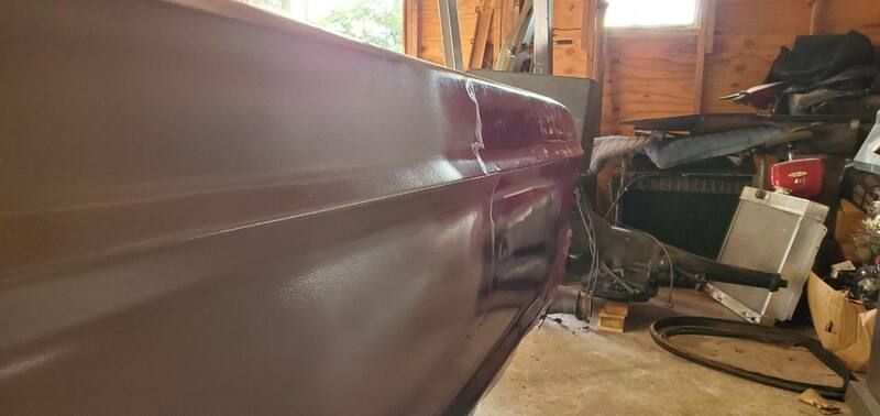

PhilA Posted July 5, 2021 Author Share Posted July 5, 2021 A hot half hour with hammers. Overall profile is much closer to what it should be. Now comes the finesse to remove the wrinkles and waves. Phil 3VOM, Tickman, mercedade and 7 others 10 Link to comment Share on other sites More sharing options...
