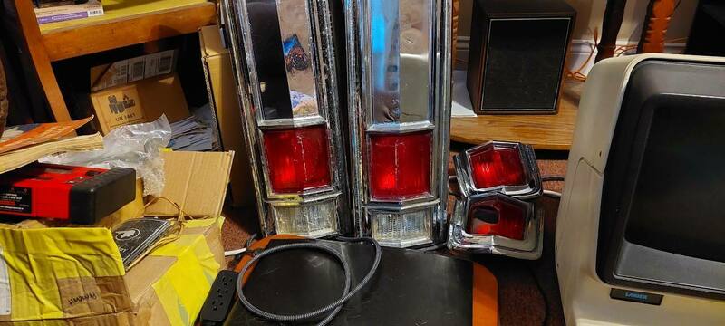

Sport Fury outer tail lights! They smell like Texas.
Scrub scrub.
Yeah, that'll be good enough. The chrome matches the ones I have for the trunk lid at least. (Aka terrible).
Phil
  • Like 11
That's about as good as they're gonna get.
They do at least line up with the inners.
Got those to clean up now.
  • Like 10
Shiny shiny.
There's a NOS inner L/H red lens on eBay right now for the low, low price of $119.

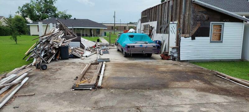

Moved the car.

With the car outside I have been able to stand back and look at a few things critically from the side.
First, I noticed that the H was on upside down.
Then I took a look at the drip rail, which I'd had a bit of a go at but was noticably bent in two places still.
So that got beaten with hammers because it stopped raining long enough to stand outside and do it. There's a small hole at the base so I'll have to attack it with a wire wheel and see how much of it turns into dust.

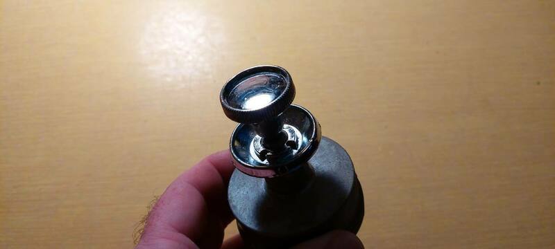

Next task, investigate this switch, which makes click-ping-scrape noises if the knob is pulled. It has no detents and I guess doesn't work because someone has wired a toggle switch in under the dash on a length of speaker wire, which appears to turn the lights on.
It's also bent in the most curious fashion. I think someone tried to remove the shaft without depressing the release pin.

Nope.
Inside is not very happy.
That piece isn't meant to be welded to that piece and this piece isn't meant to be in two pieces.
Catastrophic failure. New switch time.
